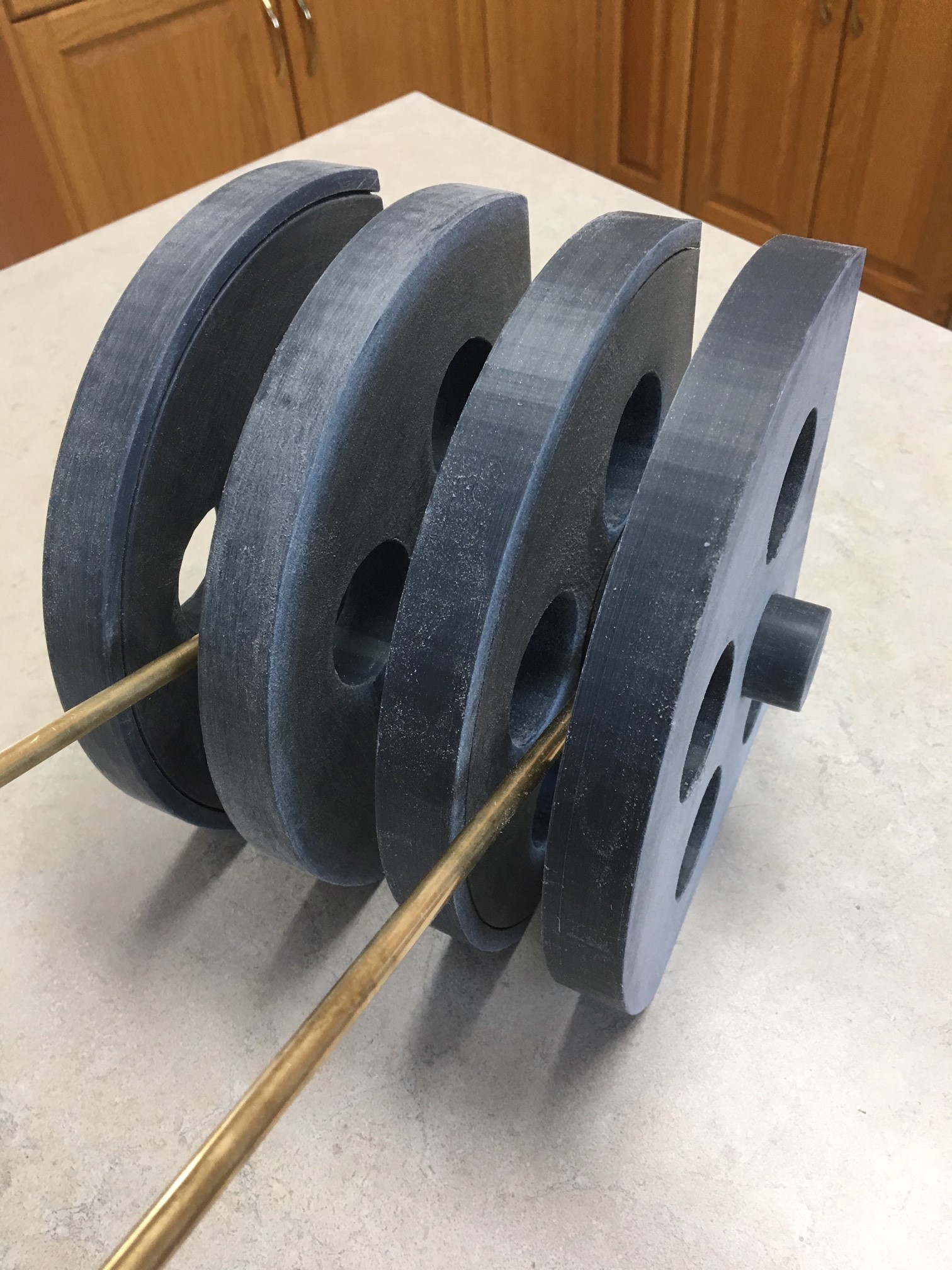

My kit will be a little different as I am incorporating gun elevation mechanism with a 3D print. Slots cut out in the kit set the position of the external elevation gets with inserting a styrene cut out.

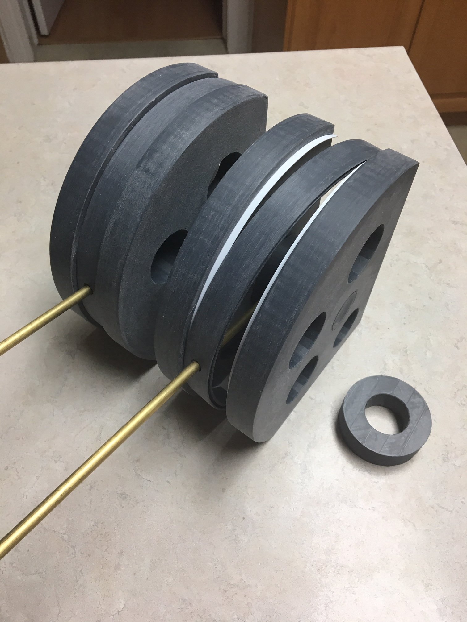

For the most part, it followed a circular path, but at the ends it flatted out to the superstructure. This also showed everything underneath as in wires and motors, which to me took a bit of the realism away from it. Since, if this was real, there would be thick metal and perhaps a seal that would prevent any debris or bits of destroyed ships from getting into the elevation mechanism. So I decided to design something a little different. I measured the arc and created a simple 3D elevation mechanism in TinkerCAD. The round "hubs" fit the cut out arc precisely. There was one problem though. The axis was lower than on the filming model. But the gun can elevate with its arc of rotation aligned with the gears. A trade-off toward film accuracy. Probably the first of many.

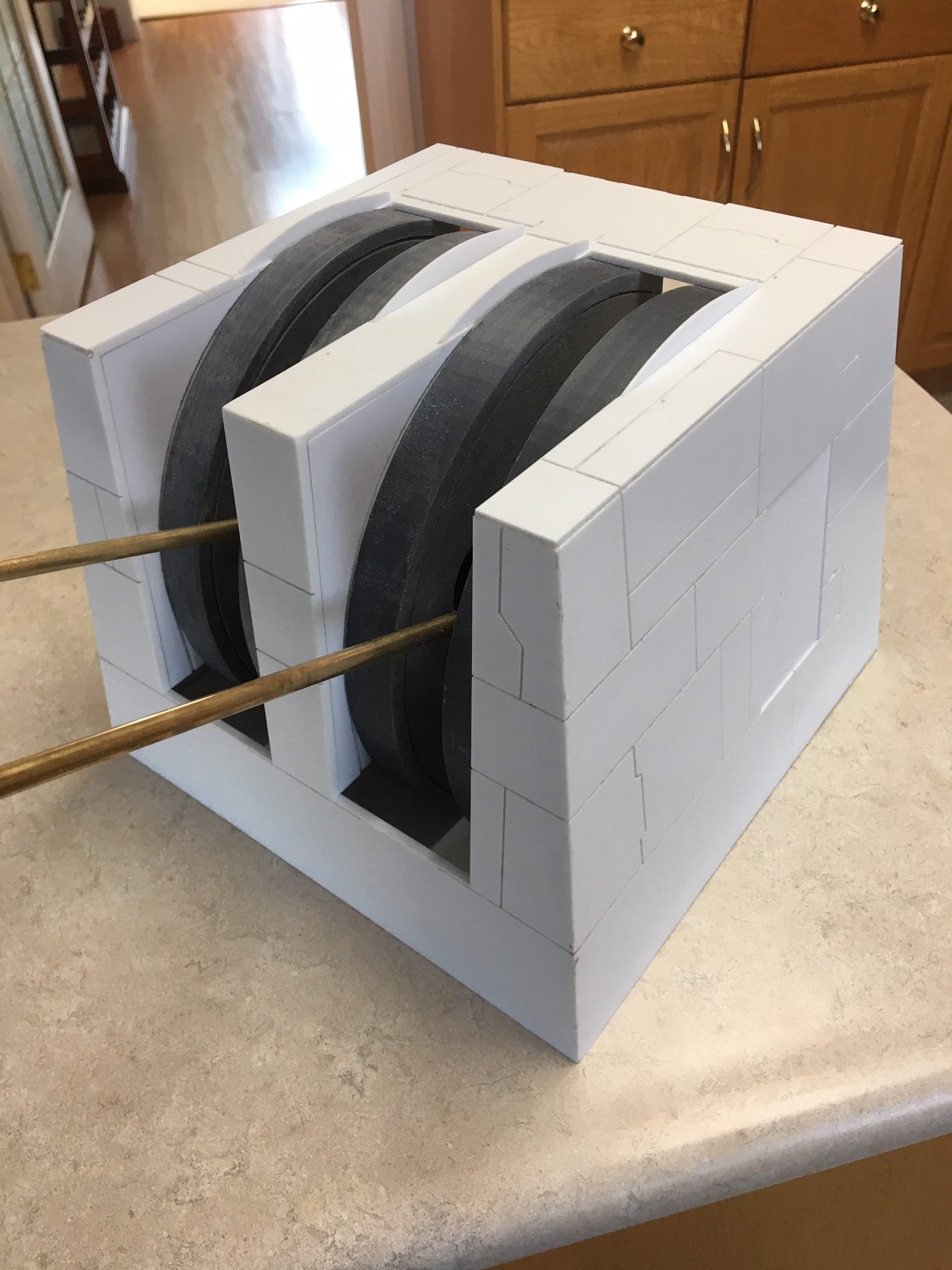

Internal components finished. Shield is in place and rotates smoothly when installed. Parts loosened to show the rail the shield rides on.The barrel elevation can only go up to about 45 degrees, then the internal components will be visible, but that shouldn't be a problem, since the turbolaser barrels rarely elevated past 30-35 degrees. After I glue the elevation mechanism in, comes the fun part of greeblying.

The internal components are just the mechanical ones I printed out, as the Turbolaser kit never came with the elevation mechanism, axle, or anything inside.

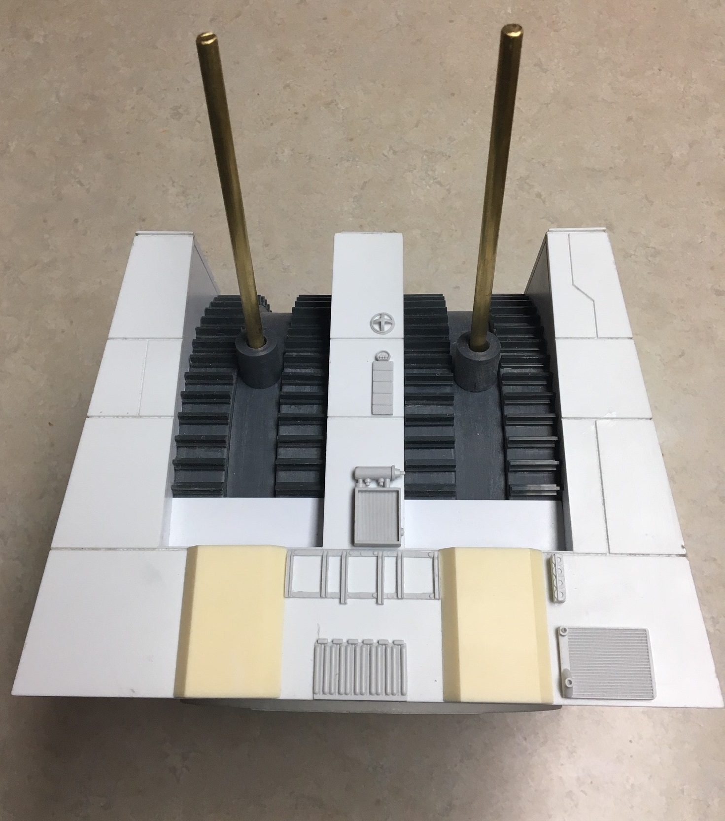

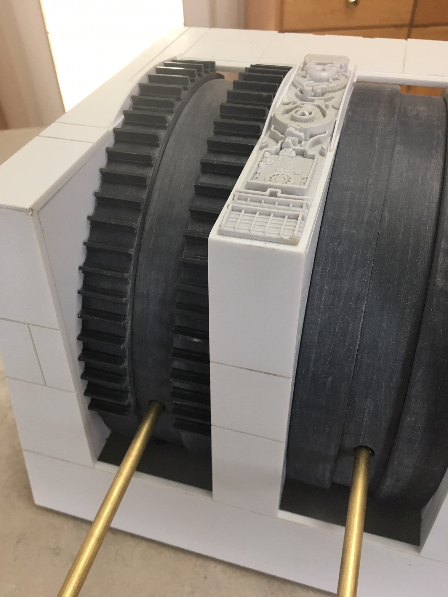

I had to tweak the 3D printed elevation mechanism to make it fit properly so as not to have too much separation or binding when moving. I also glued a turntable bearing to the top of the lower tower and printed a ring to hide that part. The gears, pictured below didn't take as long as I thought, but I still have to do the other side.

Not a big update. I 3D printed the gun mounts so that they sit centered on the tube (only partially seen in the photo). There is a LOT of Salzo casted parts that have to be sorted. Looking at the actual prop photos you really don't realize all the detail that went into it, until you start finding the one part that you need and gluing it to a particular spot. Generally the castings are good and picked up a lot of intricate detail, but there is always a need to fill in large bubble holes.
