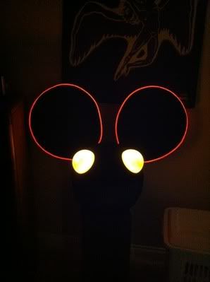

This was my quick build for Halloween this year. I hadn't built a mau5head since last Halloween, and had only 24 hours to complete it. I think it was my best yet. The eyes shine bright green, but hard to see in these photos due to the exposure.

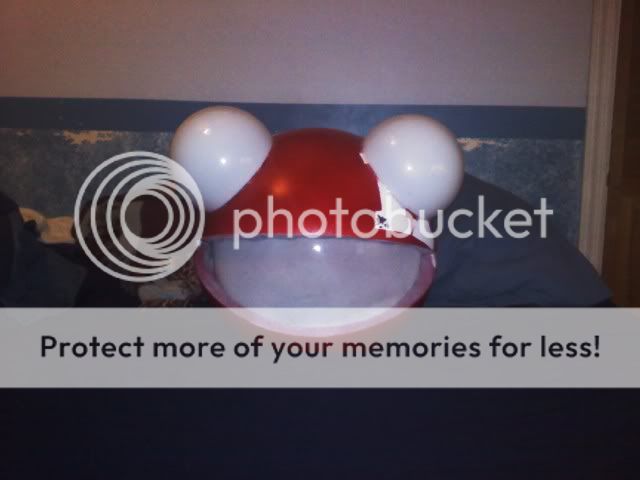

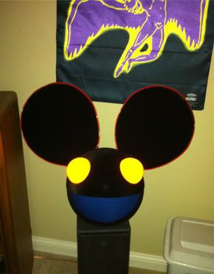

Ended up re-doing the eyes on my mau5 head. Had to rewire the L.E.D.'s and paint the eye half-spheres. So far it is turning out pretty well. Just a few more tweaks and it is done.

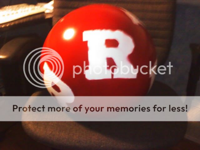

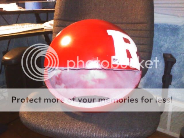

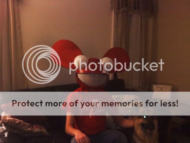

hey guys, just finished a Rutgers themed mau5head for my girlfriend.

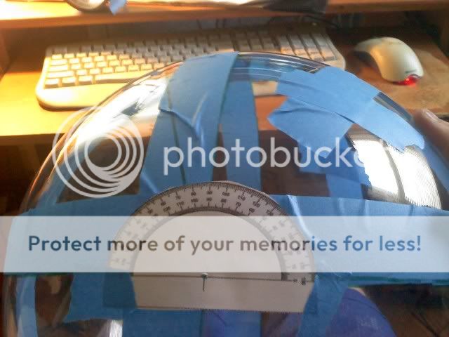

First i did all the measurements. Printing out paper compasses helps immensely to get the angles

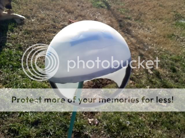

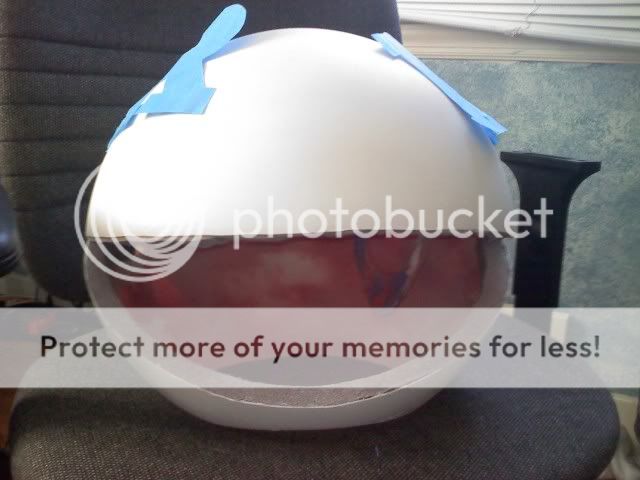

Cut the mouth out, with some white primer

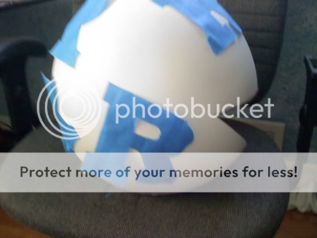

More white with the stickers cut out for the Rutgers R's
Red paint, peeled off stickers
Eyes+ LED's
Final
It's really rough, but for my first project i think i did alright.
