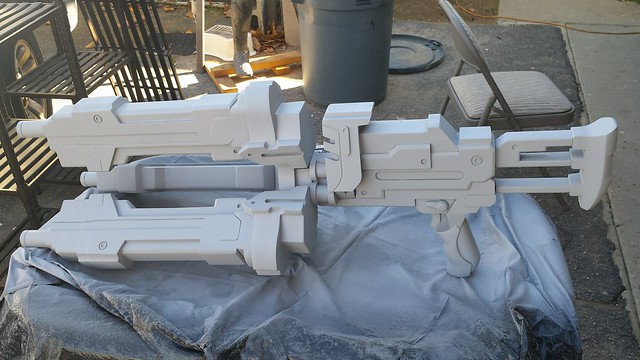

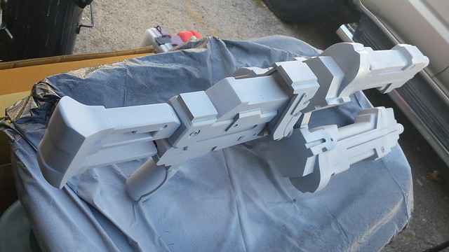

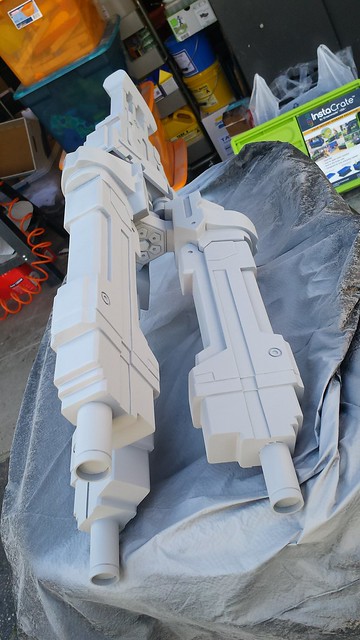

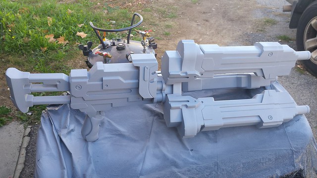

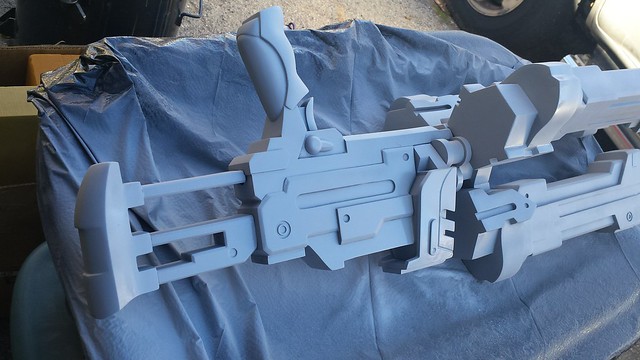

UPDATE! - Wow, more than a year has passed, I really need to pick up the pace on these things, lol. Well a few things happened, molds were made, and parts cast, but then an armature was needed and that almost killed the project. But after months of work, I finally got the thing together. Here it is before paint. newly primed. Anyone still watching?
20161228_131606 by Mal Keller, on Flickr
20161228_131622 by Mal Keller, on Flickr
20161228_131630 by Mal Keller, on Flickr
20161228_125046 by Mal Keller, on Flickr
20161228_131648 by Mal Keller, on Flickr
20161228_131613 by Mal Keller, on Flickr
