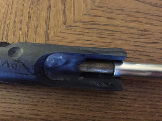

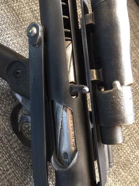

I recently got the E11 kit from Dday, need a good blaster for the Anovos Stormtrooper I ordered.

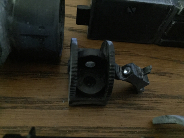

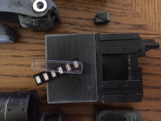

By now I have filled and sanded all parts and added small details here and there. I have added a barrel, a inner and outer pipe, and made a hot glue receiver for the end of the pipe. I also made a sticker and a lens for the counter. The metal parts have been blackened with aluminum black, figured it would be a good idea having them black under the paint in case of chipping.
Next step is a test assembly and then paint.

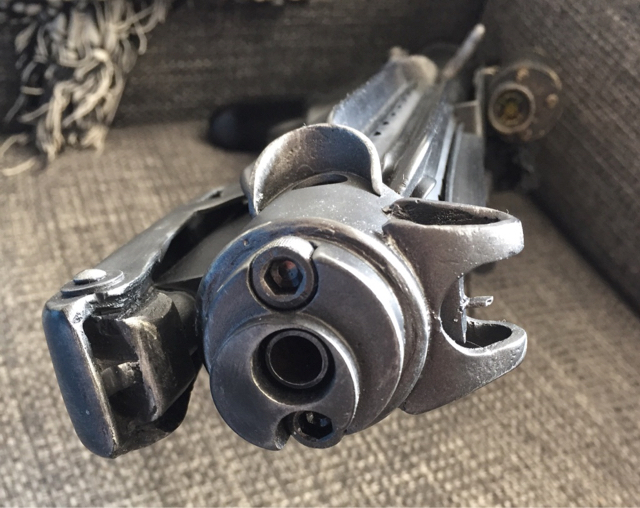

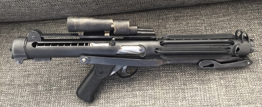

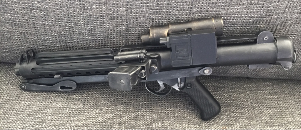

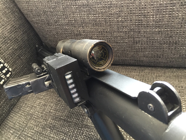

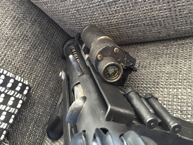

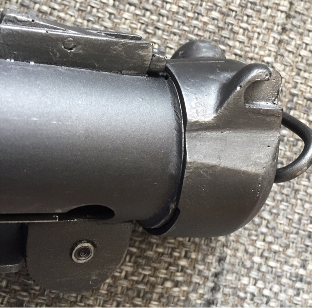

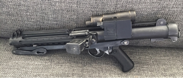

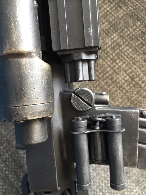

I'm just about finished with the blaster. Here's som pictures showing the current state. I had some problems with the stock, broke both sides of and had to reinforce them with some flat steel springs at the inside. They broke a few times more but it was relatively easy to fix because the steel kept them in place. All parts attached to the body had the seams filled with black milliput before painting. Distressing was done with Alclad chrome and polished brass. A combination of dry brush and airbrush.
kontherun

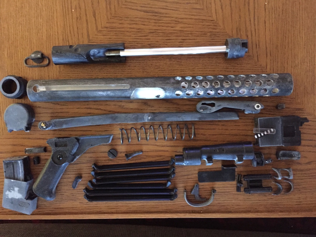

Thanks. It is a very good kit. The main body is aluminum with all holes drilled and and machined small flat area where the bayonet goes. All other parts are cast from an original Sterling. I added inner barrel, lenses for the scope and a small flat lens for the counter.
Dday did a great job with this kit.
