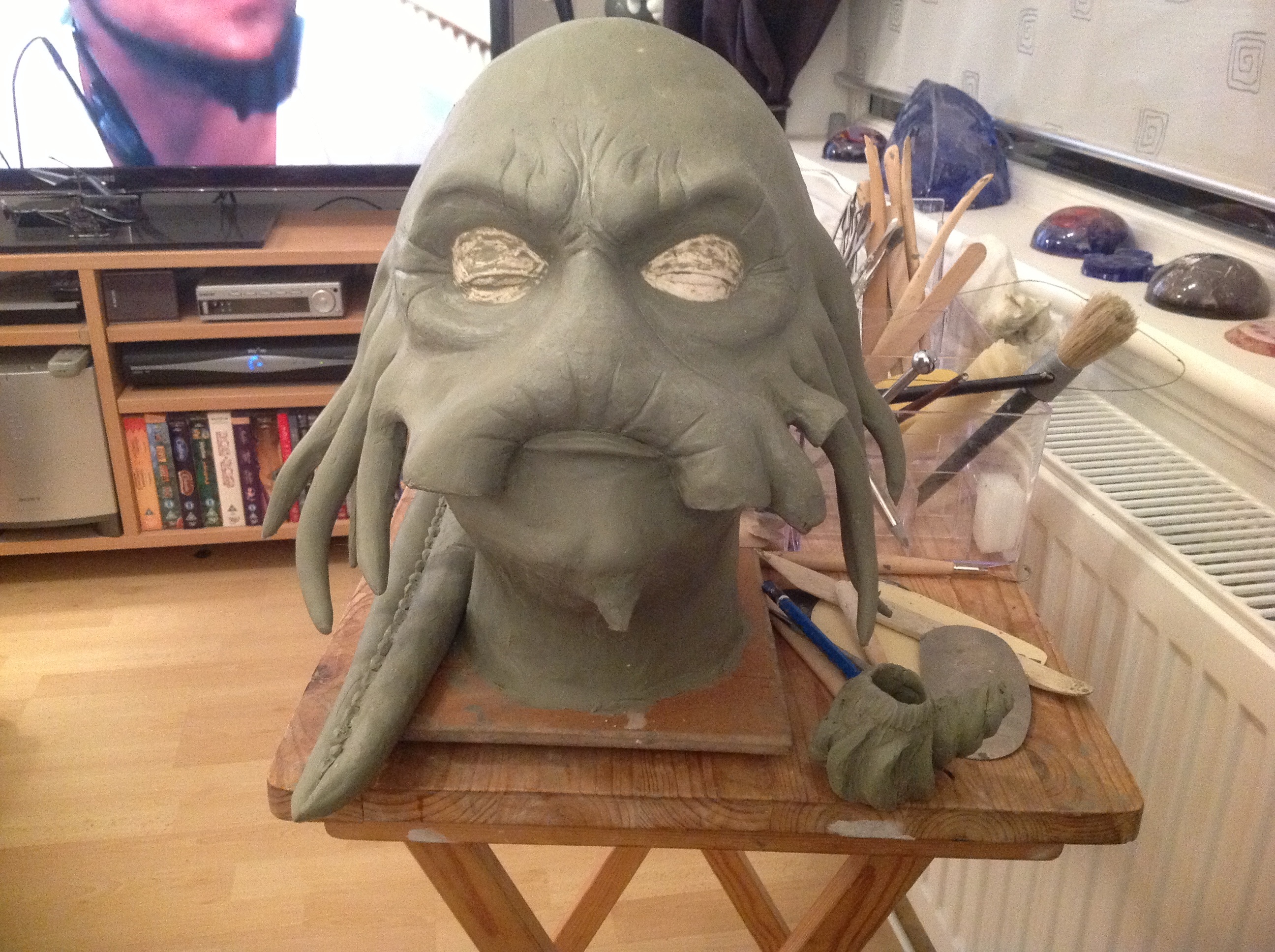

Hi guys,
Due to work commitments and working on my new basement workshop, I've not had time to get much done on my Davy Jones sculpture / mask.
I've one awe bit and started making the pipe.
I'll keep you posted, but I'm conscious of the timescale is rapidly diminishing, as I need to get the whole costume finished no later than mid August.
But here's a wee picture to date, with a couple of tentacles and the pipe bowl at the front.
Ive only just started the pipe bowl so there's very little detail yet.

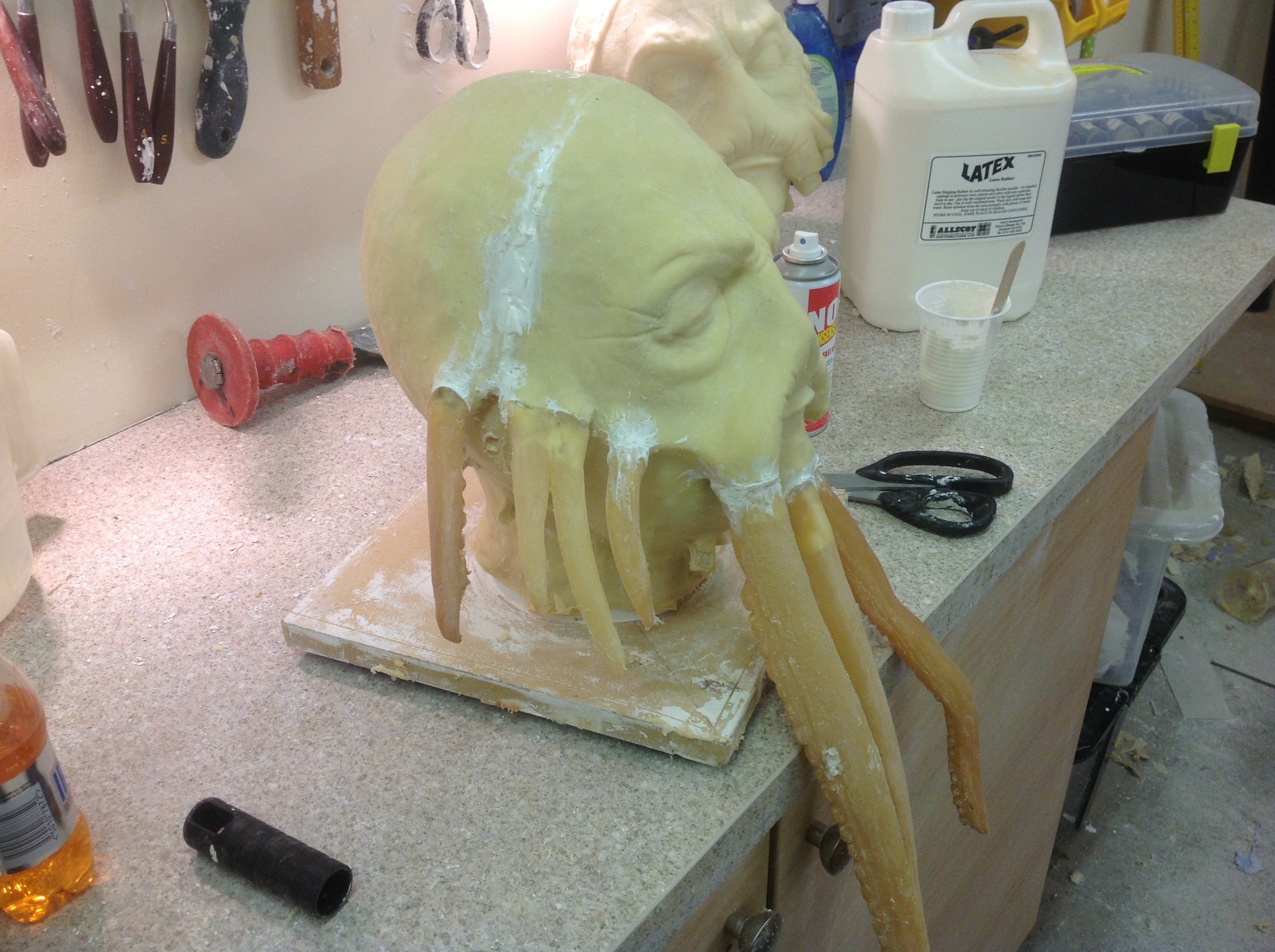

Disaster strikes :sick
having spent ages doing the sculpt, and casting the plaster mould, i cracked the mould.
Obviously, the original was destroyed, getting it free from the mould.
so ive stuck and filled the crack, which luckily enough, is at the back, and can be dressed later, and started the latex pour.
i decided on latex, for costs as this mask will only be worn for one night then probably given away to someone.
Moral of the story ......?
listen to the forum,
Dont scrimp on the materials,
take more time checking for undercuts.
On the plus side.... I learned some new unpronouncable swear words, and found out I can say them at 140 decibels
Ya gotta laugh :(
I'll post the results later

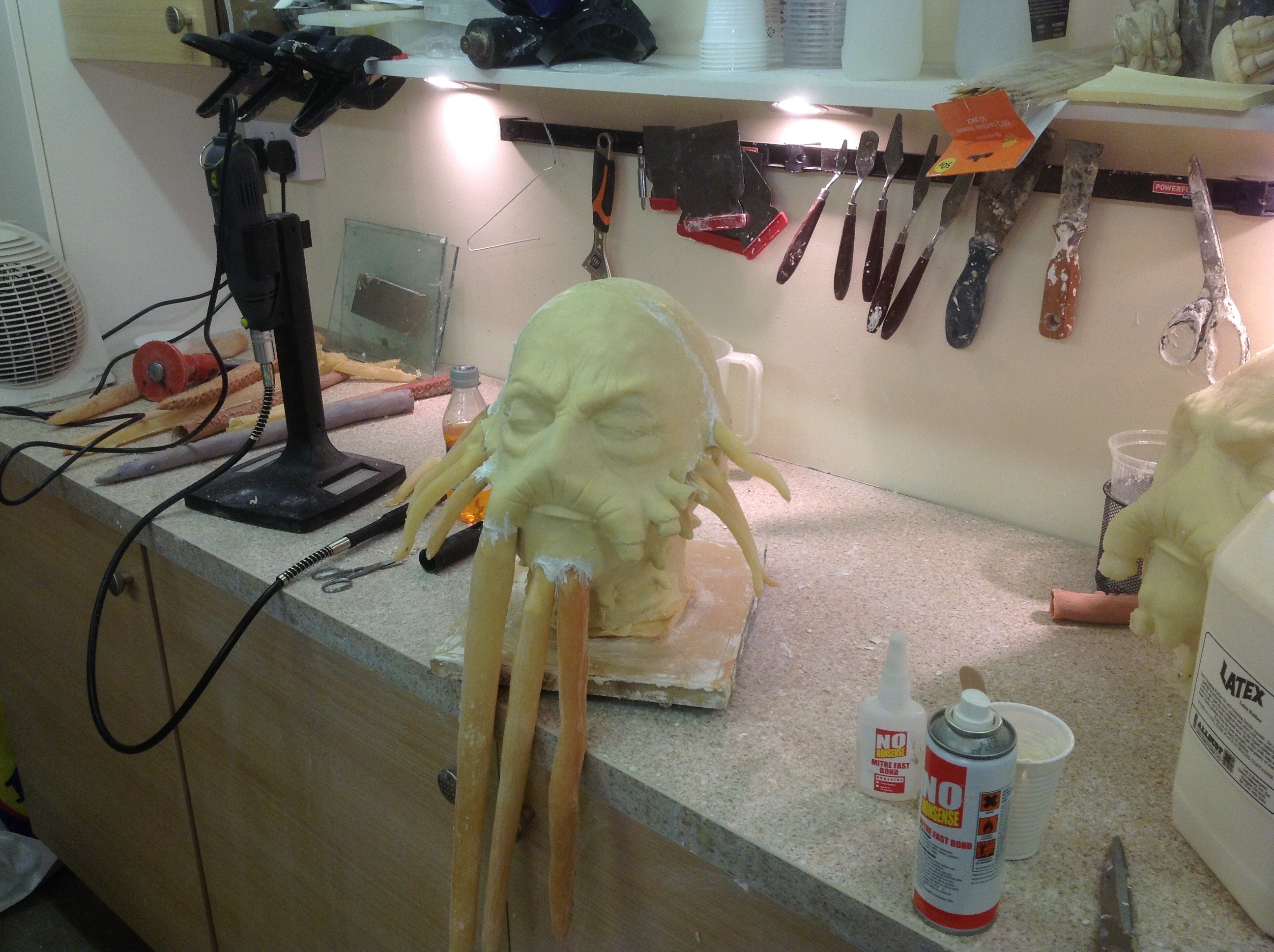

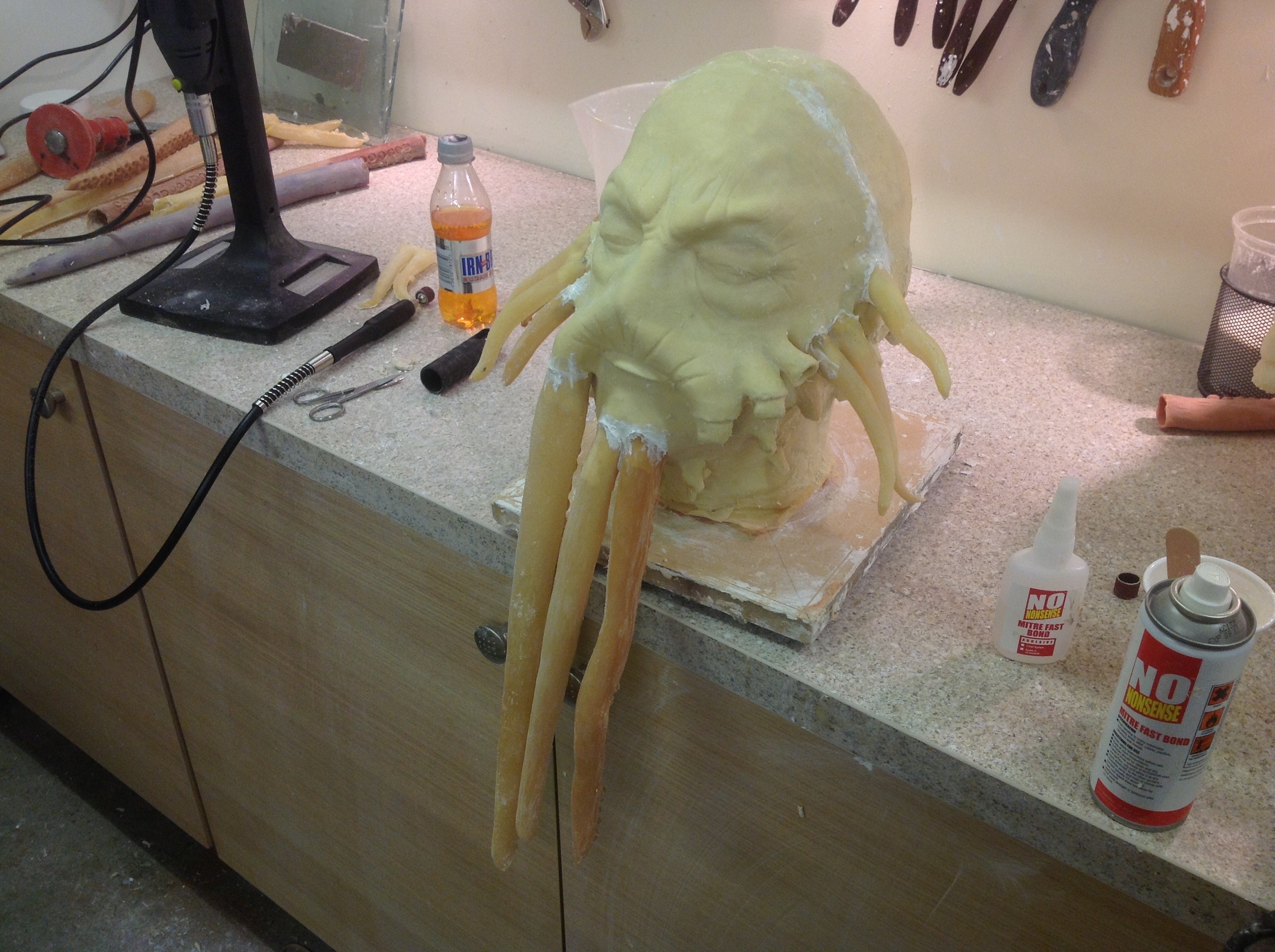

So here we are,
The first "pull" and starting to fit the tentacles.
The was some damage by the crack in the mould, but it was dremeled off and behind the ears anyway, so if anything remains, it will be hidden by the hat,
The one next to it is a silicon one, filled with foam , just in case I have to recast, at least I've got a start.
I'm going to make a couple, for as long as the mould holds out, just in case, I makes job of it and decide to try and get some costs back :D
Anyway, as usual, comments welcome

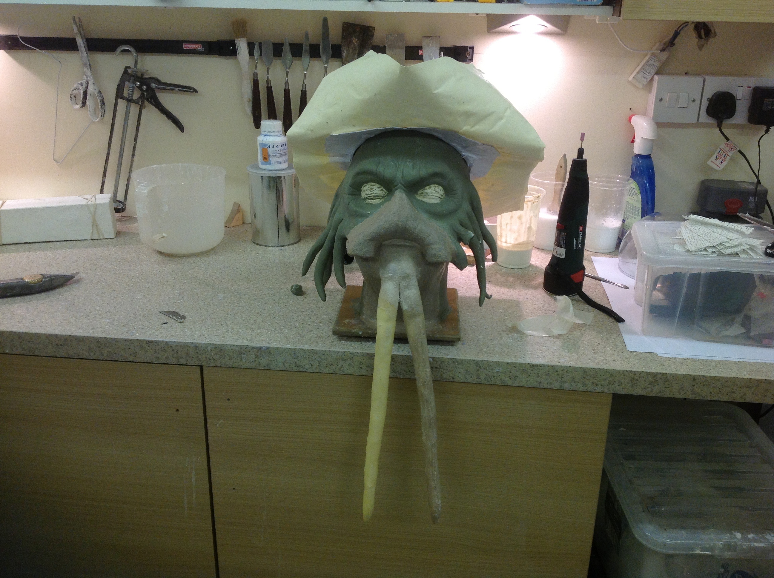

I've been working on the hat which is felt etc, and because of work,pressures, I've been unable to spend a lot of time.
I've only got 5 weeks to finish lol.
I'm actually thinking of creating a silicon bust or something, but I think a chose a hard subject for one of my earliest sculpts.

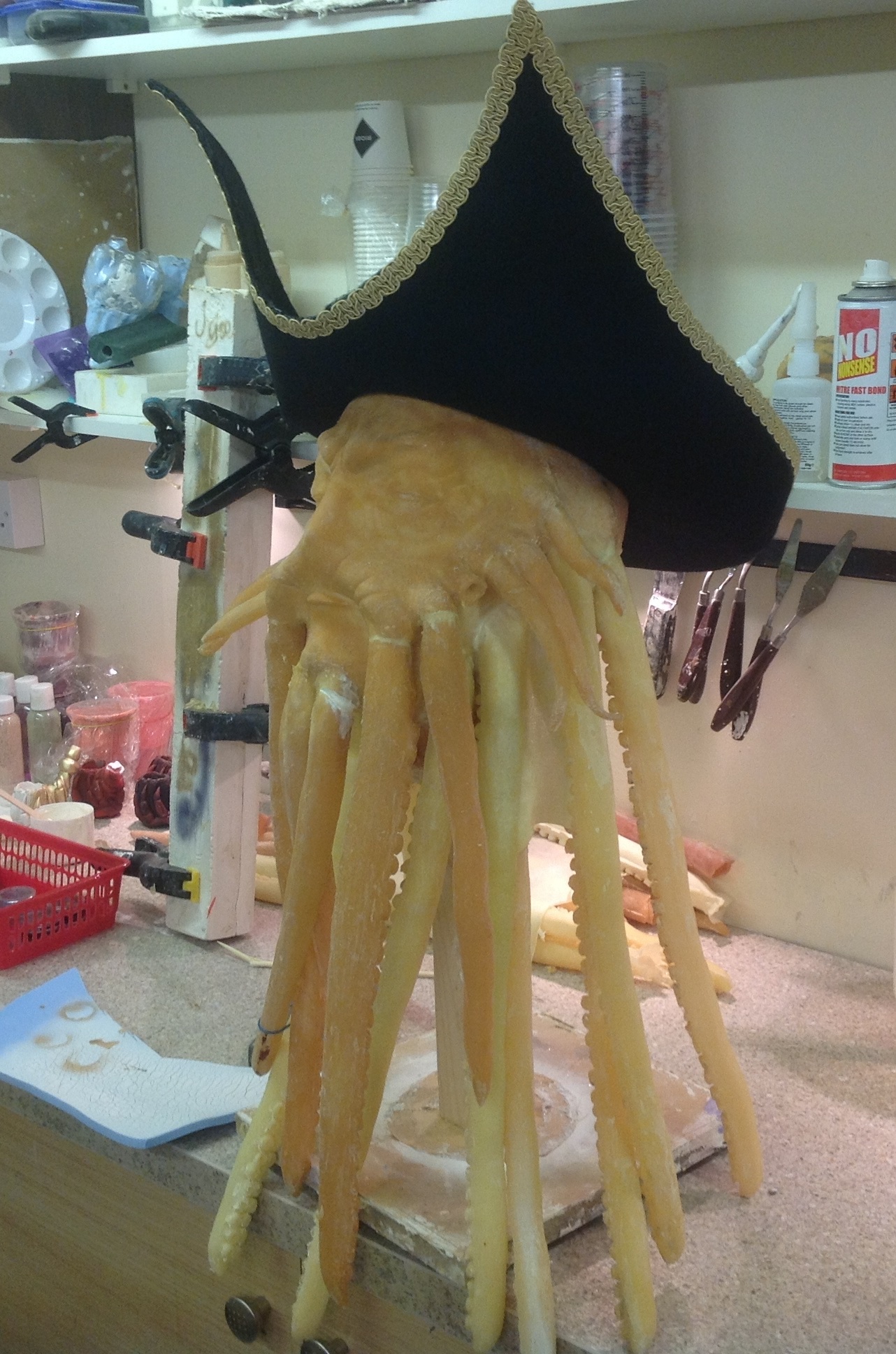

A wee update for the mask.
I'm still fixing tentacles on, and still need to paint, but getting there.
Also made the hat, so I've put it on to try it for size. I'll need to glue some shells etc on to the hat to complete the effect.
I've nearly finished the pipe and the claw, so once I get it nearly done, I'll put some more pix on, but maybe taken with a camera rather than the iPad.
Comments welcome, but bear in mind it's my first mask :D
I think I picked a difficult one for my first but I'm in there now:D
