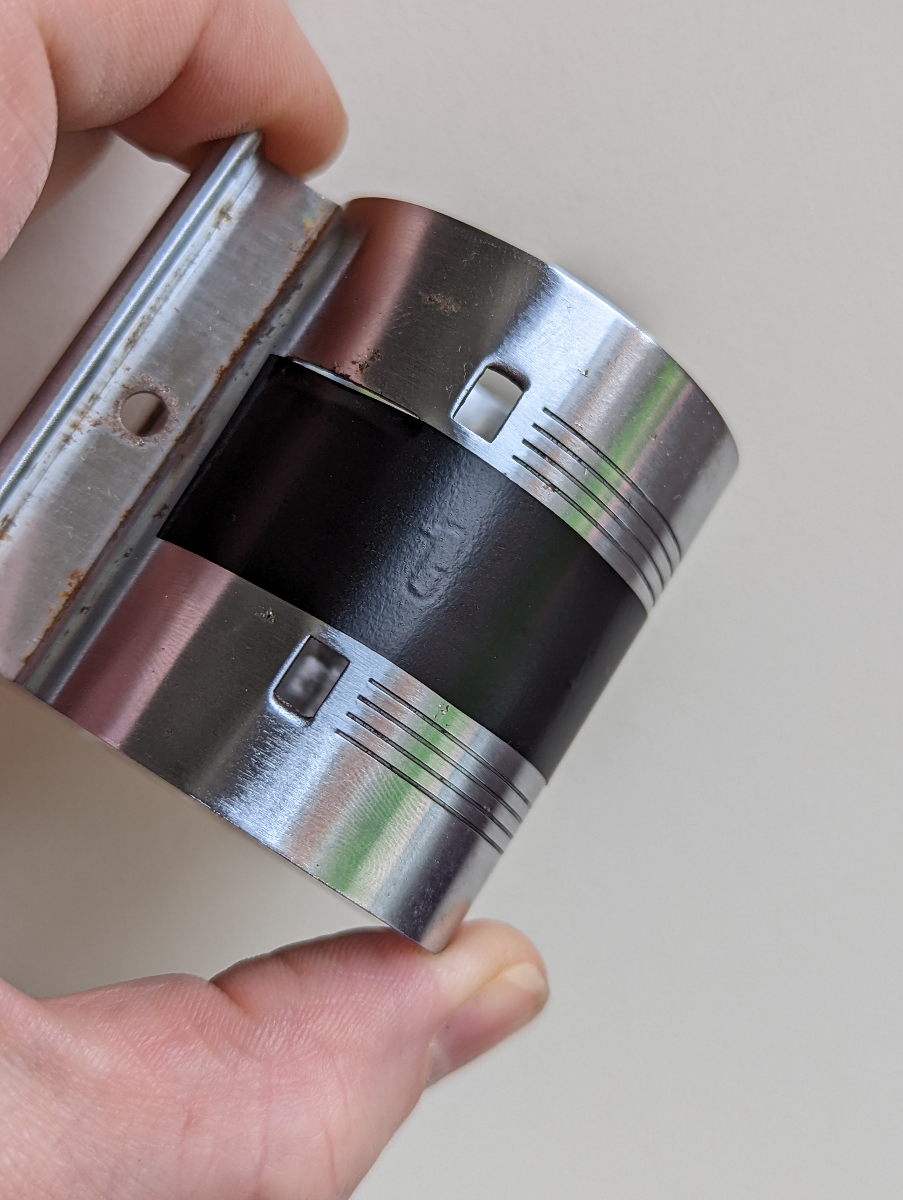

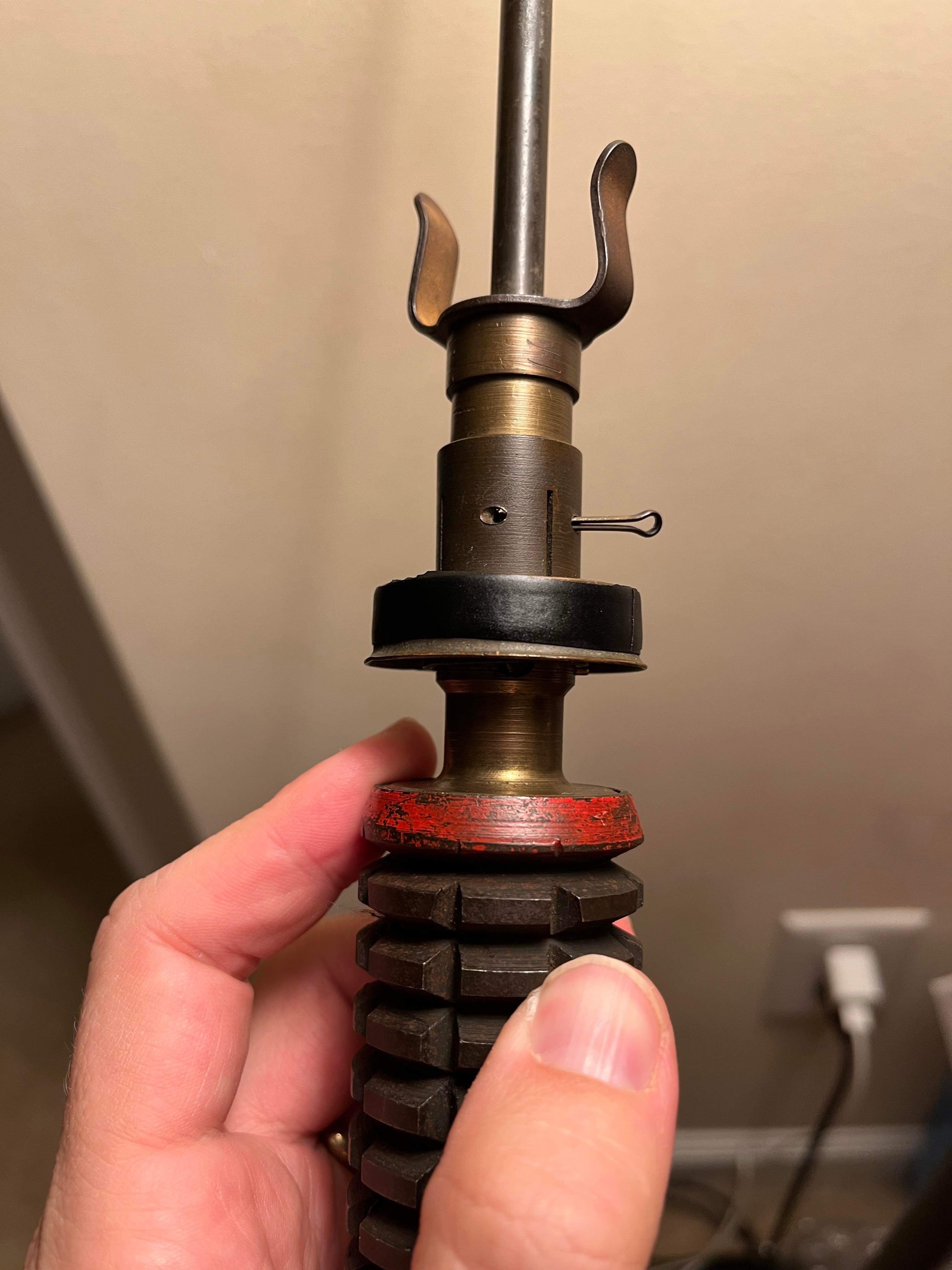

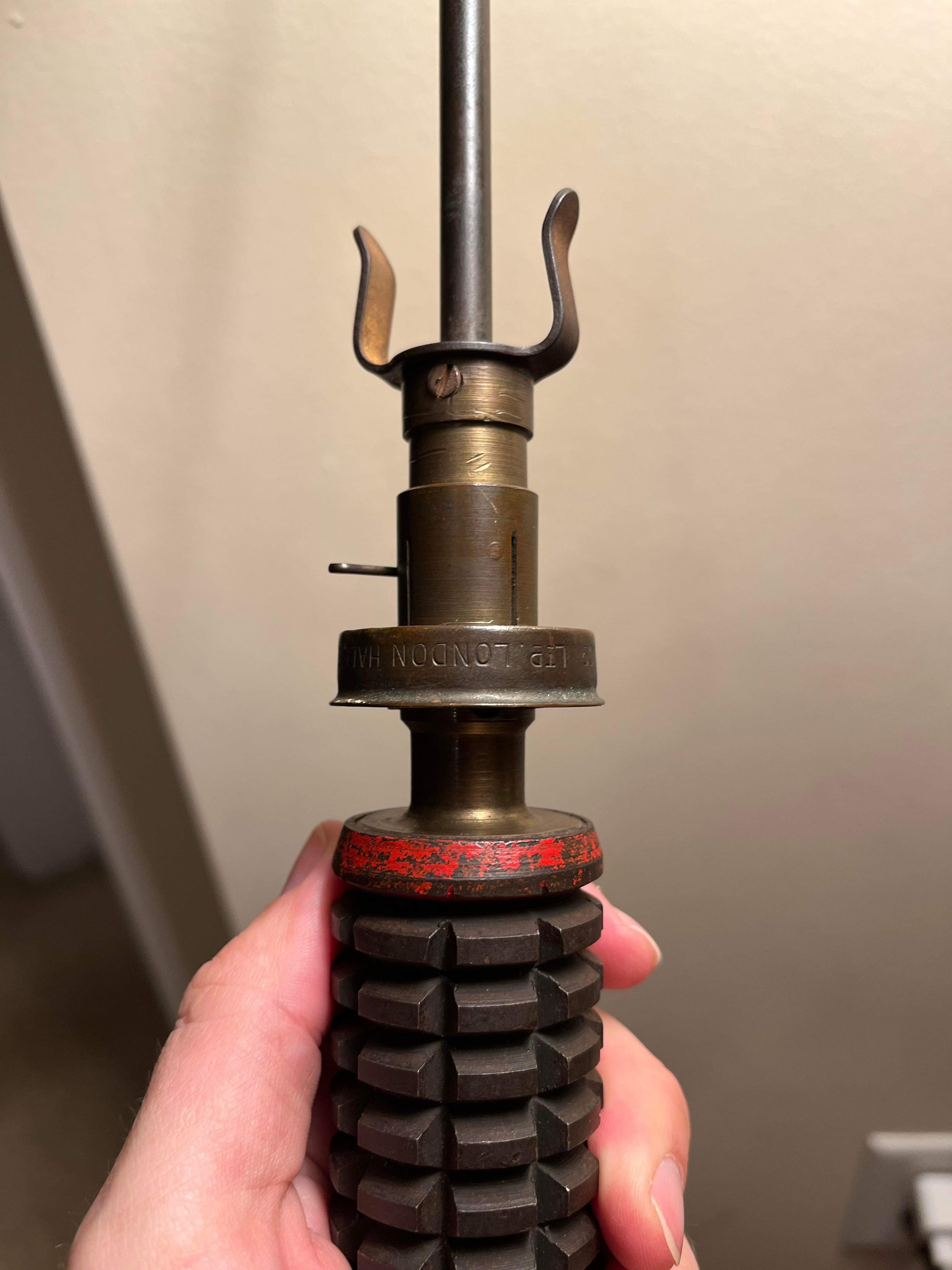

There is also a discussion around the idea that tape was wrapped to cover the lettering on the ring. I'm all for healthy debate, and even disagreement. I've given my reasons for believing that there is indeed tape present, and tried to demonstrate why I think so the best of my ability.
At the end of the day though, it's a removable, easily added detail, that people can choose to go with, or ignore.

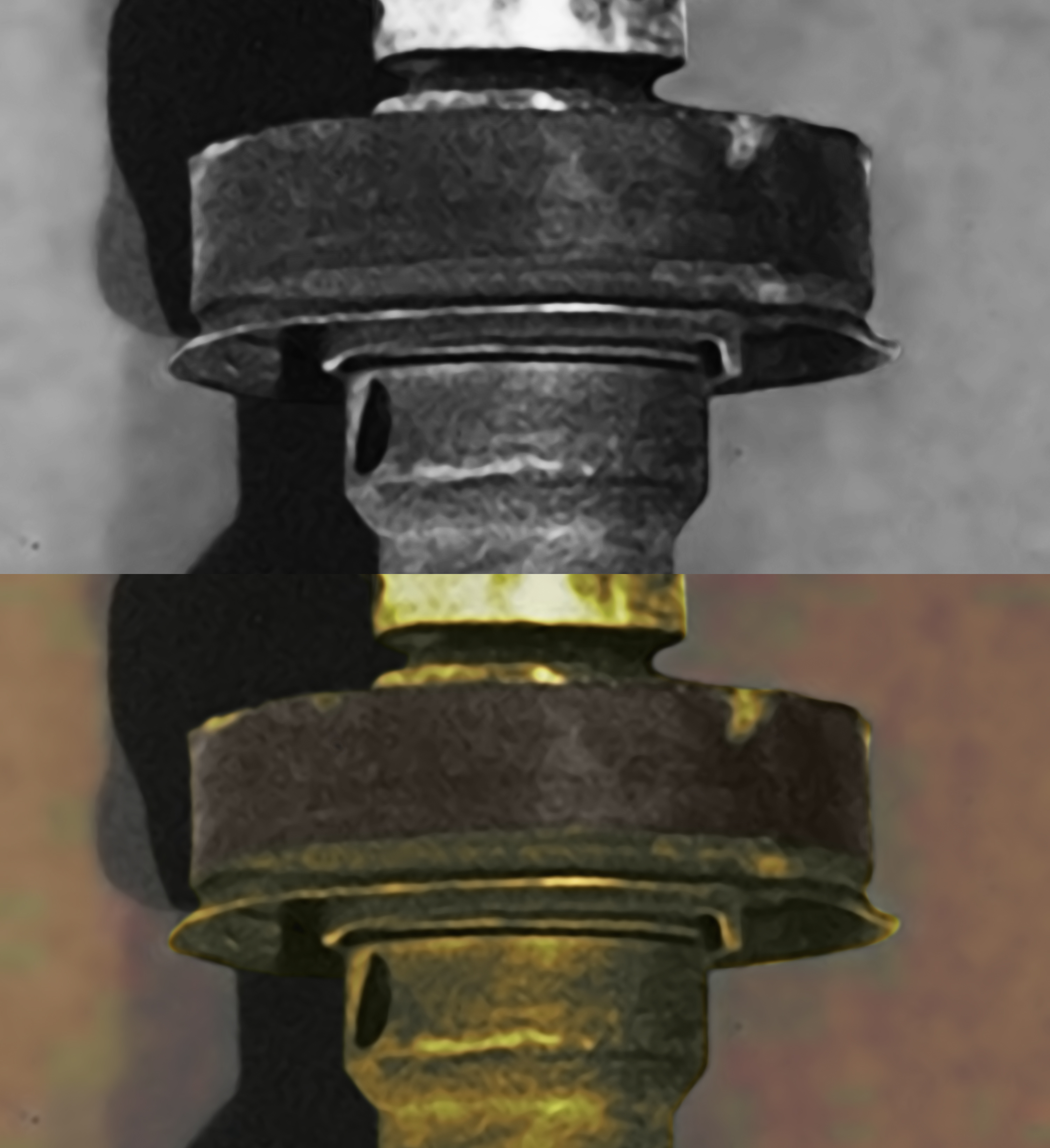

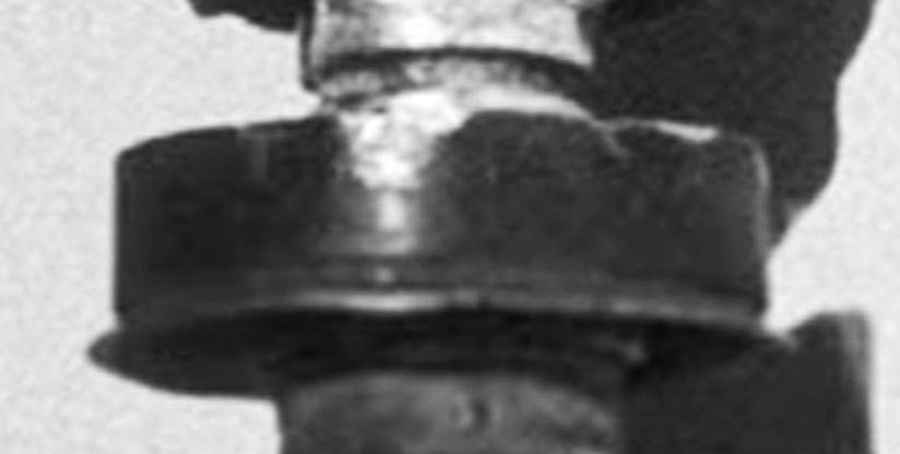

Here's the best I can do to at least show what it is I'm seeing, using the best images that I'm able to share:

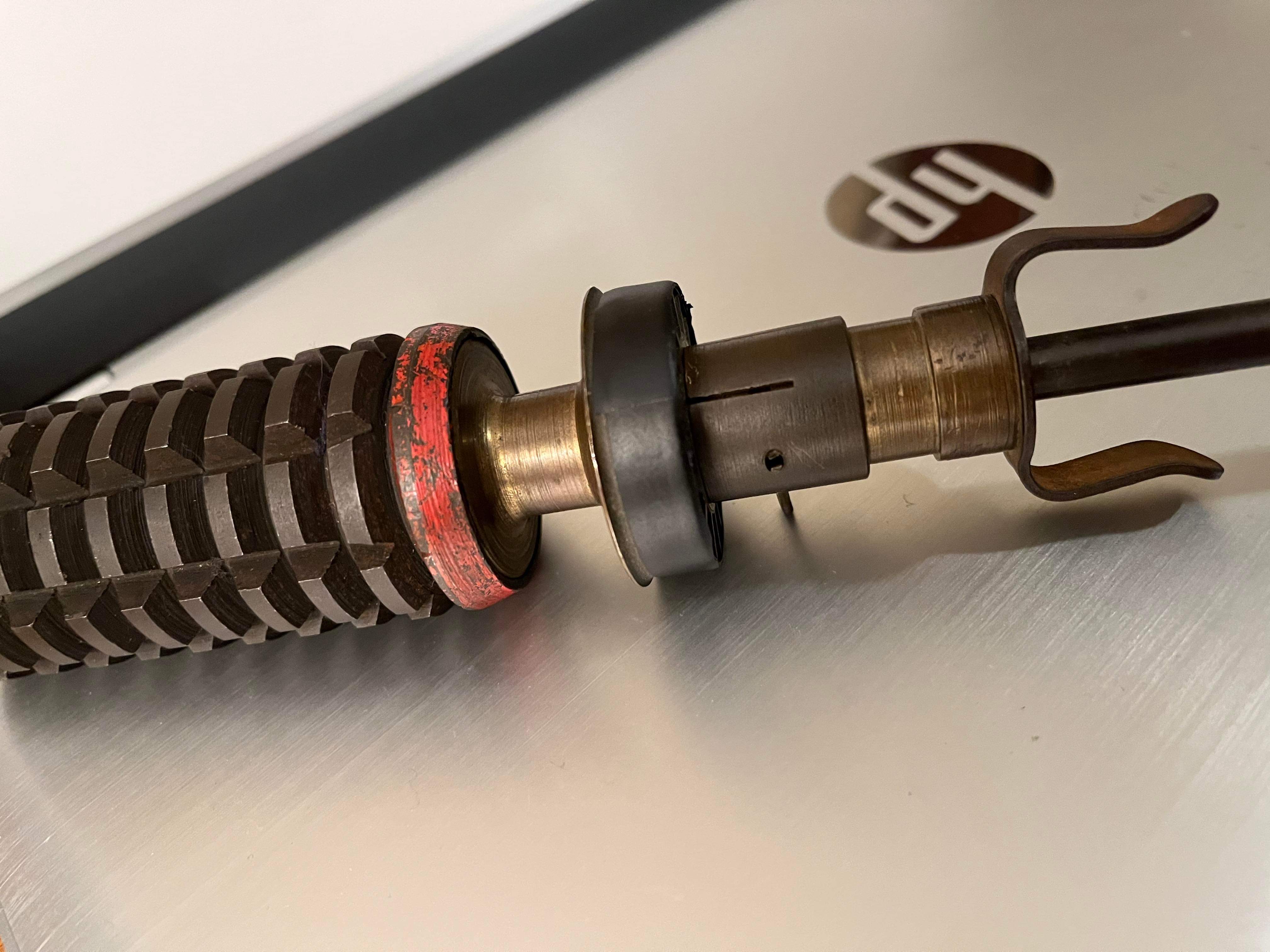

As for the very faint lettering and whether or not it would be visible through the tape, here's my vintage (therefor stamped) Graflex clamp, with PVC tape applied:
Interestingly, the letters are visible, but only at the point where a strong highlight crosses the tape. Exactly what we see on the prop reference:
That's the best I can do to at least explain MY own thinking on the matter. I'm happy for people take it or leave it though. (y)

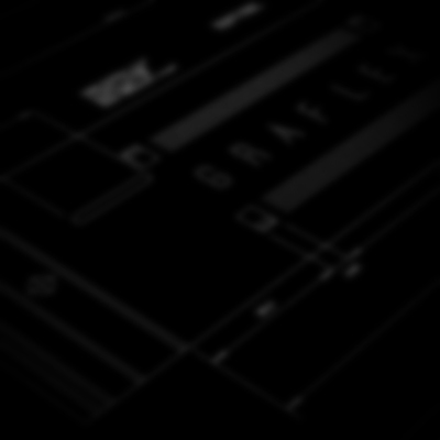

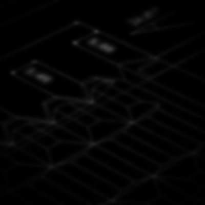

Work continues on the CAD drawings and STEP models... Most of the trickier parts (which I've tackled first) are done. Hoping to be finished by the end of this week and to get them off for quotes!
For that reason, I'm dropping off the radar (and FB!) completely! I'll be back on here with another proper update at the beginning of next week!
Thanks again for your patience everyone! So many parts to get through, and NURBS modelling isn't my usual method, so getting everything converted for manufacture, and drawn up in CAD is always a bit of a headache when it gets to this stage in the process.

Just to show as an example, I have Hale’s here with a deep stamp little/no groove. I added tape, overlapping on one half, just to see if the lettering was visible. This does not prove anything regarding what was done to the original, just can be used as a proof of concept should someone want to add it.

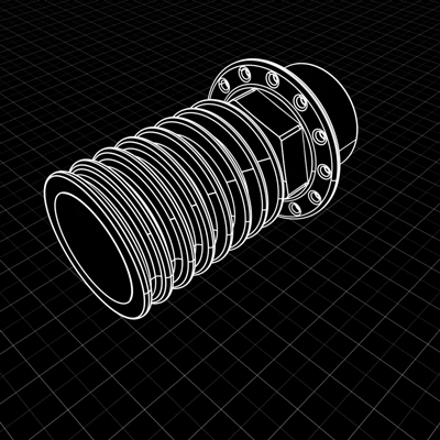

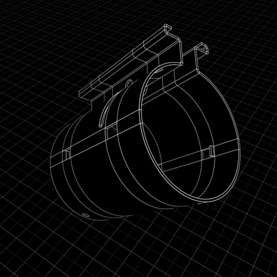

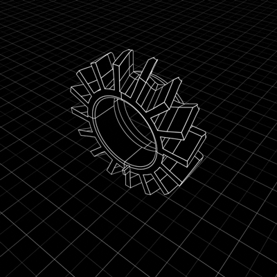

**Update**
Hi Everyone. A little later than expected, but I just wanted to update you all on where things are up to...

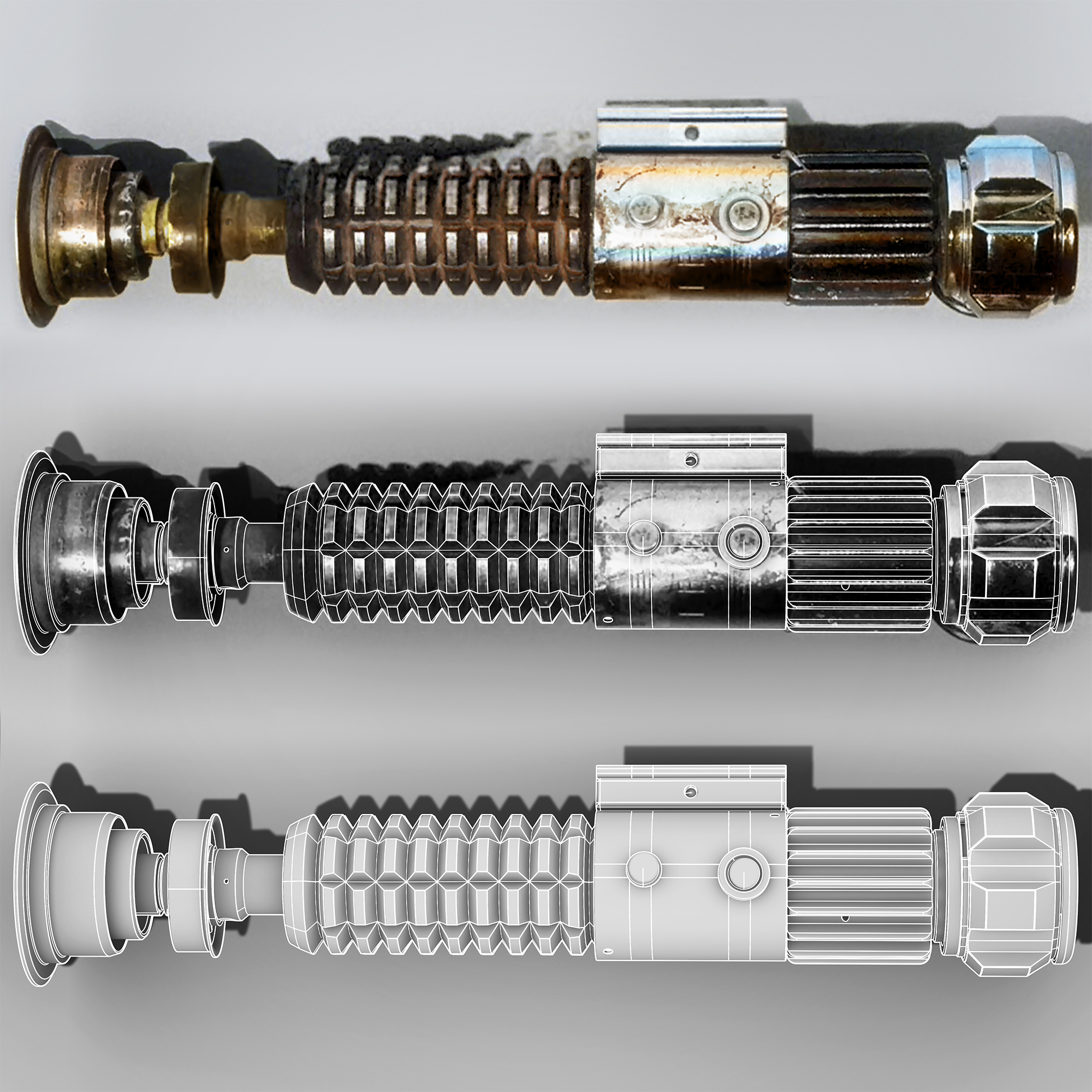

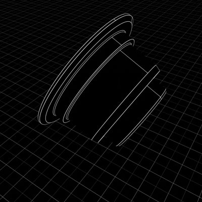

ALL final production models are finished, and lining up wonderfully with the prop reference image:
This has been a mammoth undertaking, and has required every part to be pretty much re-modelled from scratch. I have, as you would expect, AGONISED over every detail of every individual piece (of which there are many), which is why things have taken a little longer than planned:

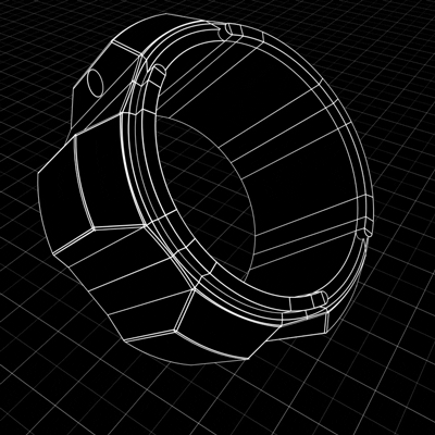

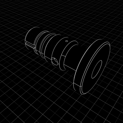

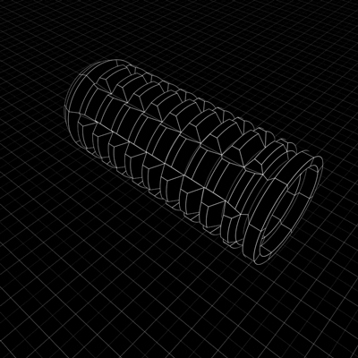

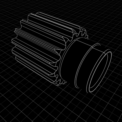

Just a preview of some of them. All the models are now finished and ready to go. I'm just in the process of finalising the 2D CAD Drawings, with a few still in progress:

And thanks for hanging in there everyone! I'm just about done with the technical drawings now, although not all of the components have been sent off for quotations yet...
I've been juggling finishing things off with the outstanding drawings with communicating with local manufacturers this past week or so.
I've made tech drawings many times, but never for sheet metal manufacture. This was a bit of a learning curve, and something I absolutely want to get right! Working out the bend allowances in order to draw up a flat pattern is not as straight forward as you might think! I'm happy to say that that's all now sorted out, and can chalk that up as another string to my bow.

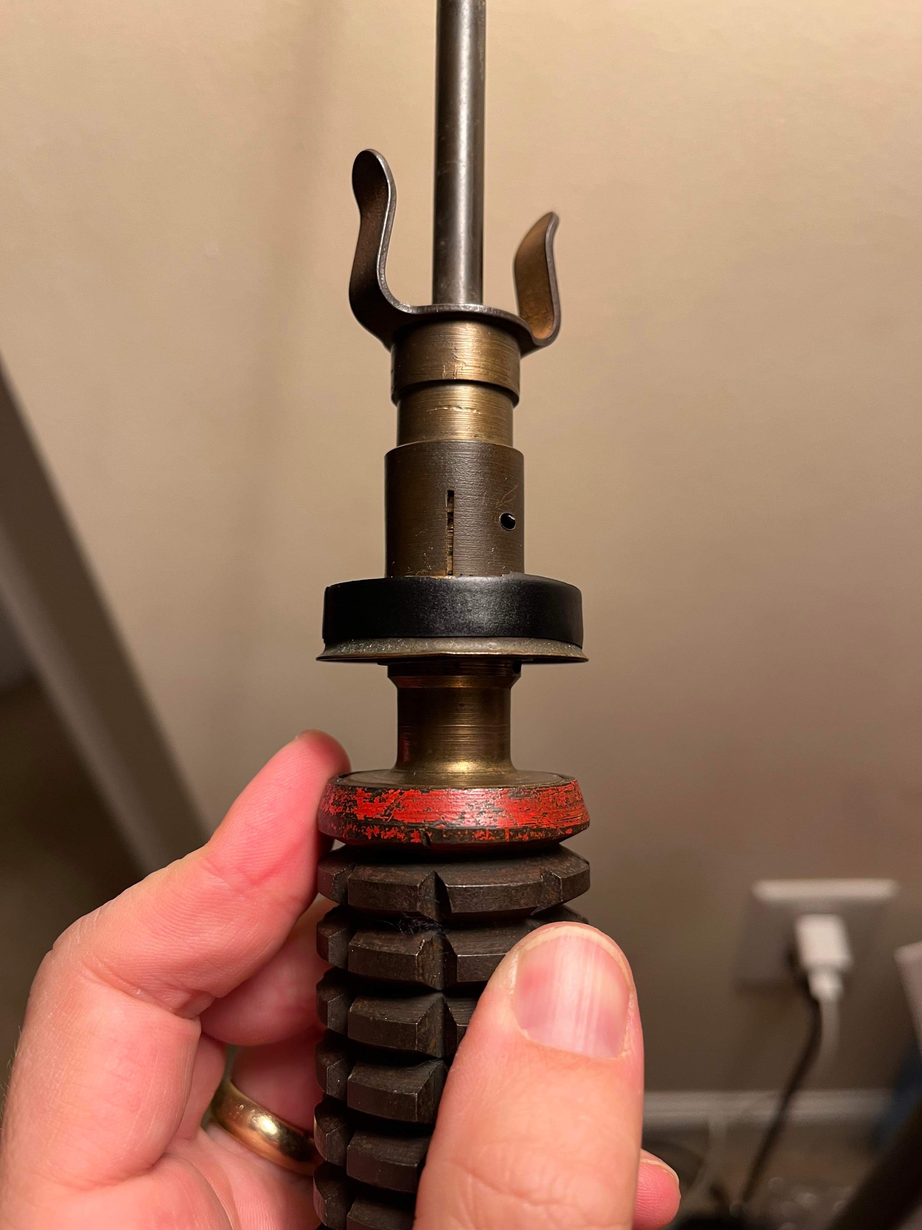

Forgive my ignorance here, but what will secure the balance pipe (emitter) onto the windvane? Does the threaded rod extend from the sink know/handwheel (pommel) all the way through the windvane and into the emitter? Is there a confirmed source for that threaded rod or does the community just come to that conclusion that it must have been used in order to hold it all together?
Finally, in regards to the windvane lettering and whether or not tape or paint or some other substance was covering the lettering: does anyone think that if there is indeed something covering the lettering, it could have specifically been added postproduction for those photos so that no discernible markings could be identified (by people like us)? I just find it highly suspect that they would bother to cover the markings for shooting when those markings would be impossible to see on camera.
Personally, I don't believe there is anything at all trying to cover any lettering, at least not during filming. I think the original stamping was either just super faint from when it was manufactured or time/wear and tear had worn down the brass to the point where you could barely make out any markings to begin with. From everything I see in photos, on film, etc. the color of the windvane is consistently the same weathered brass up and down.
