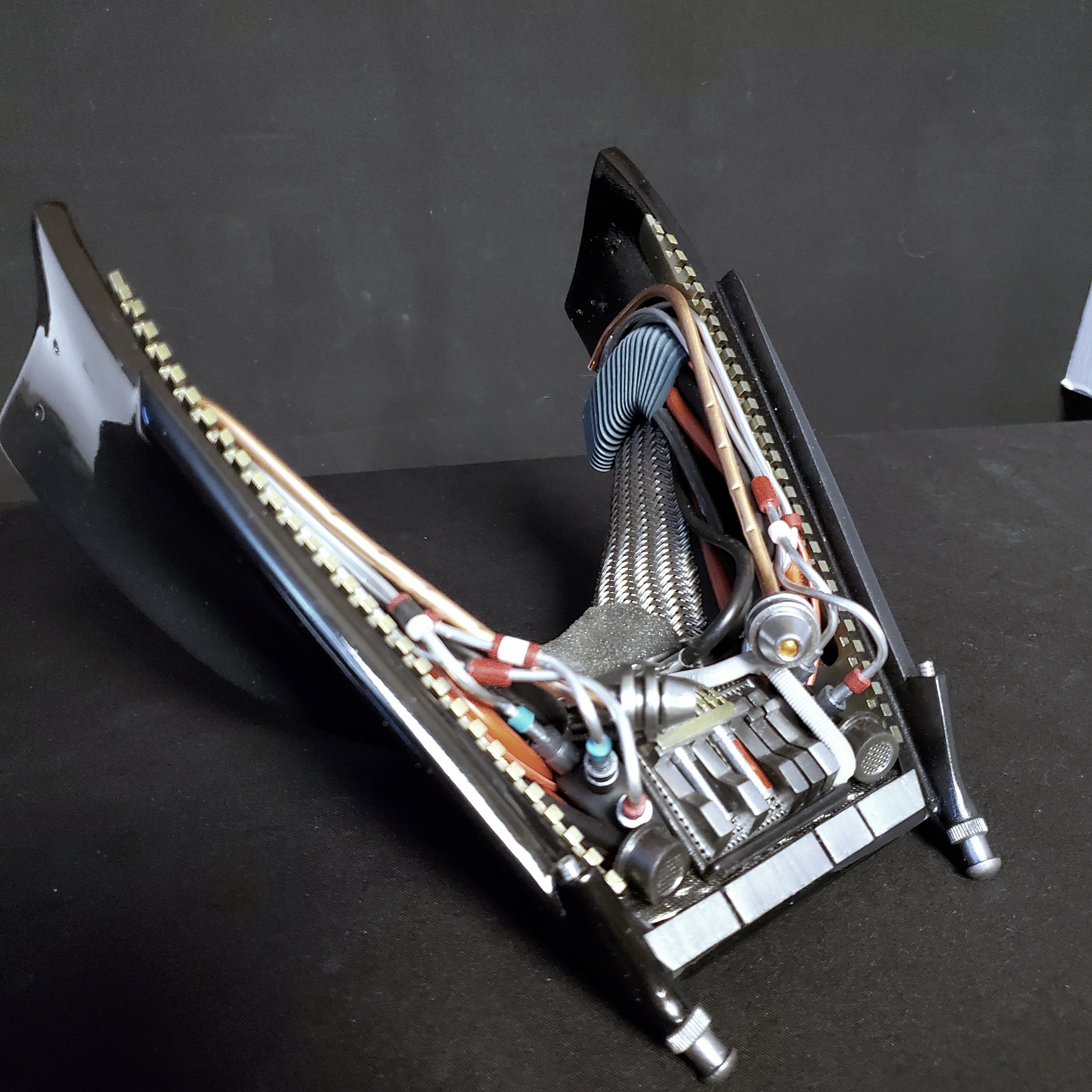

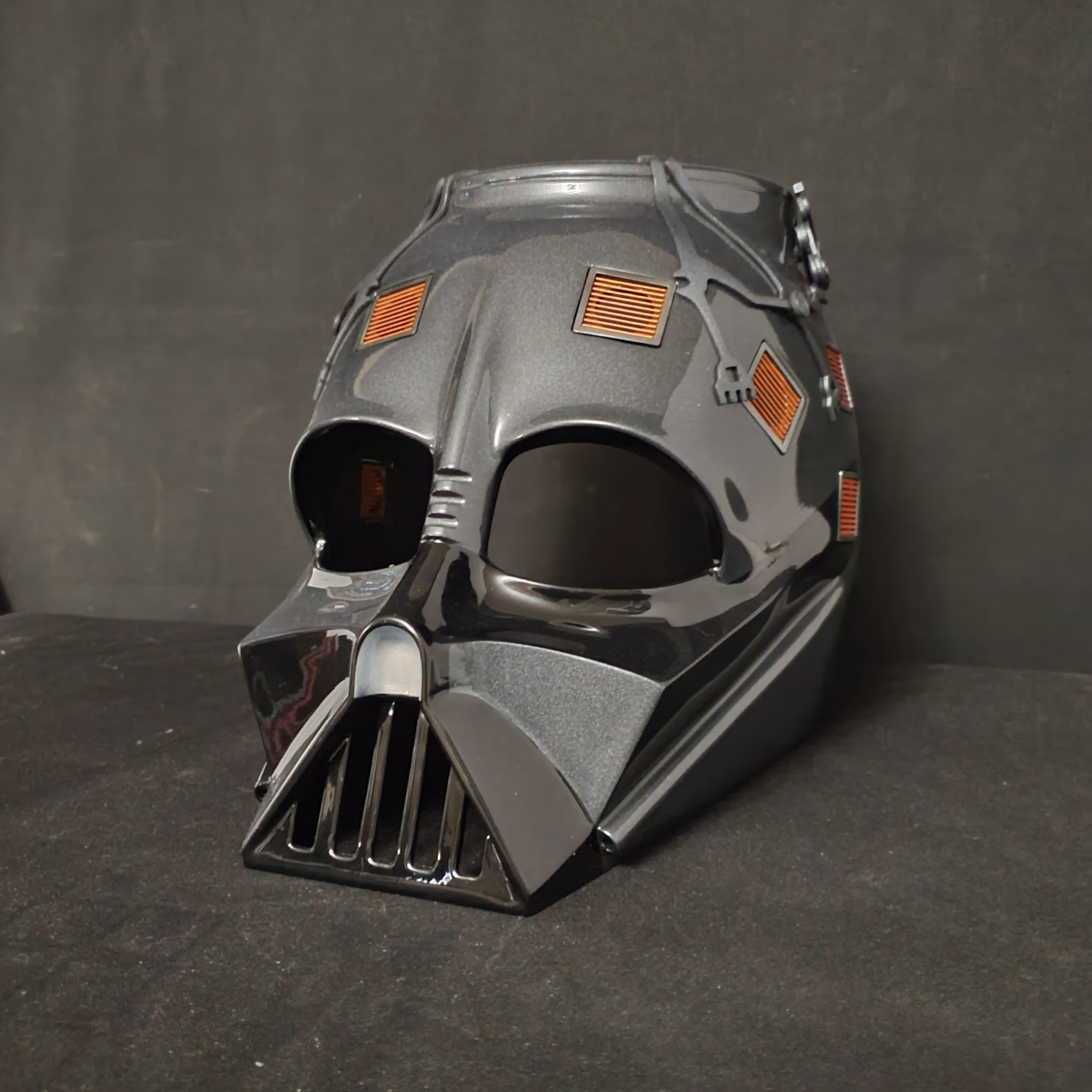

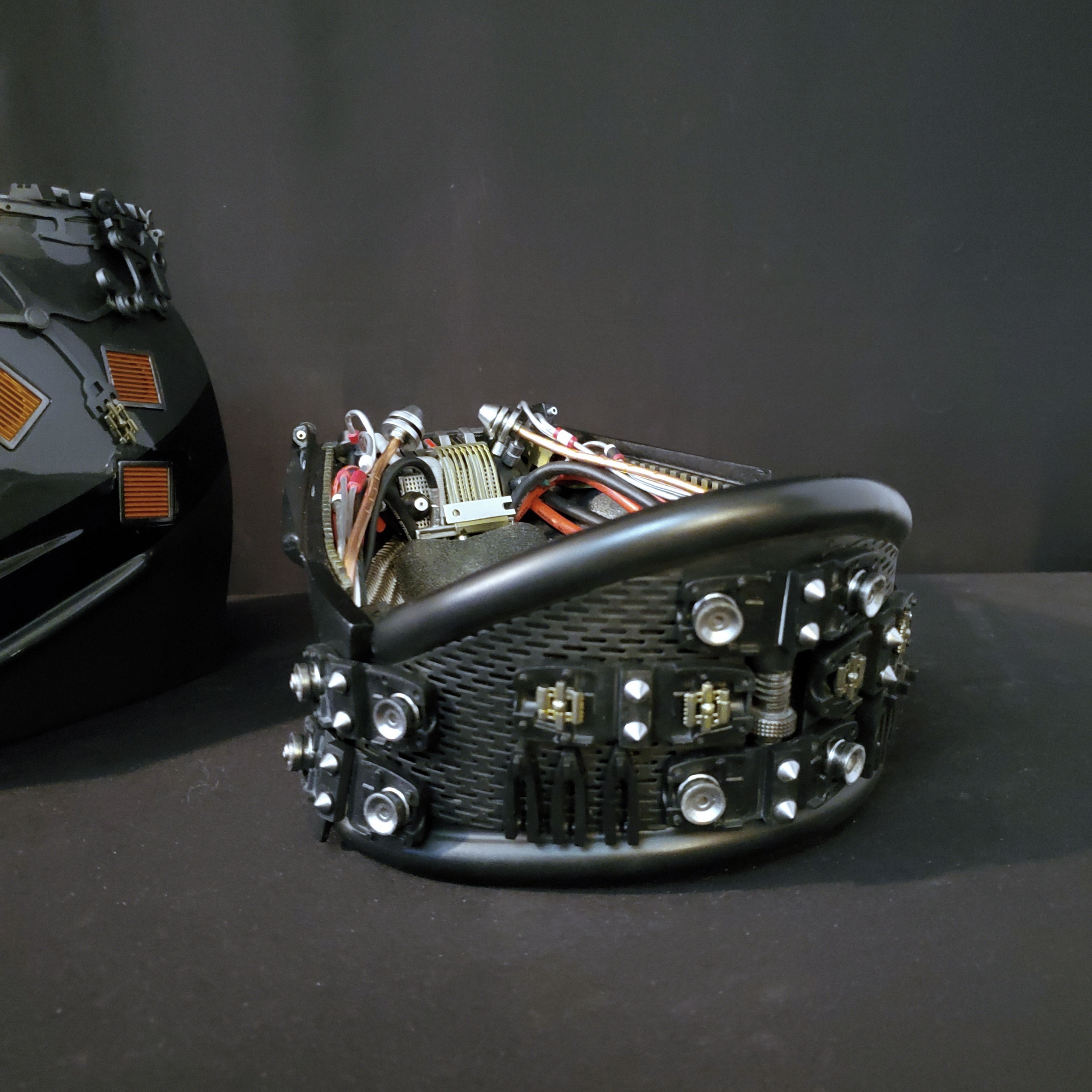

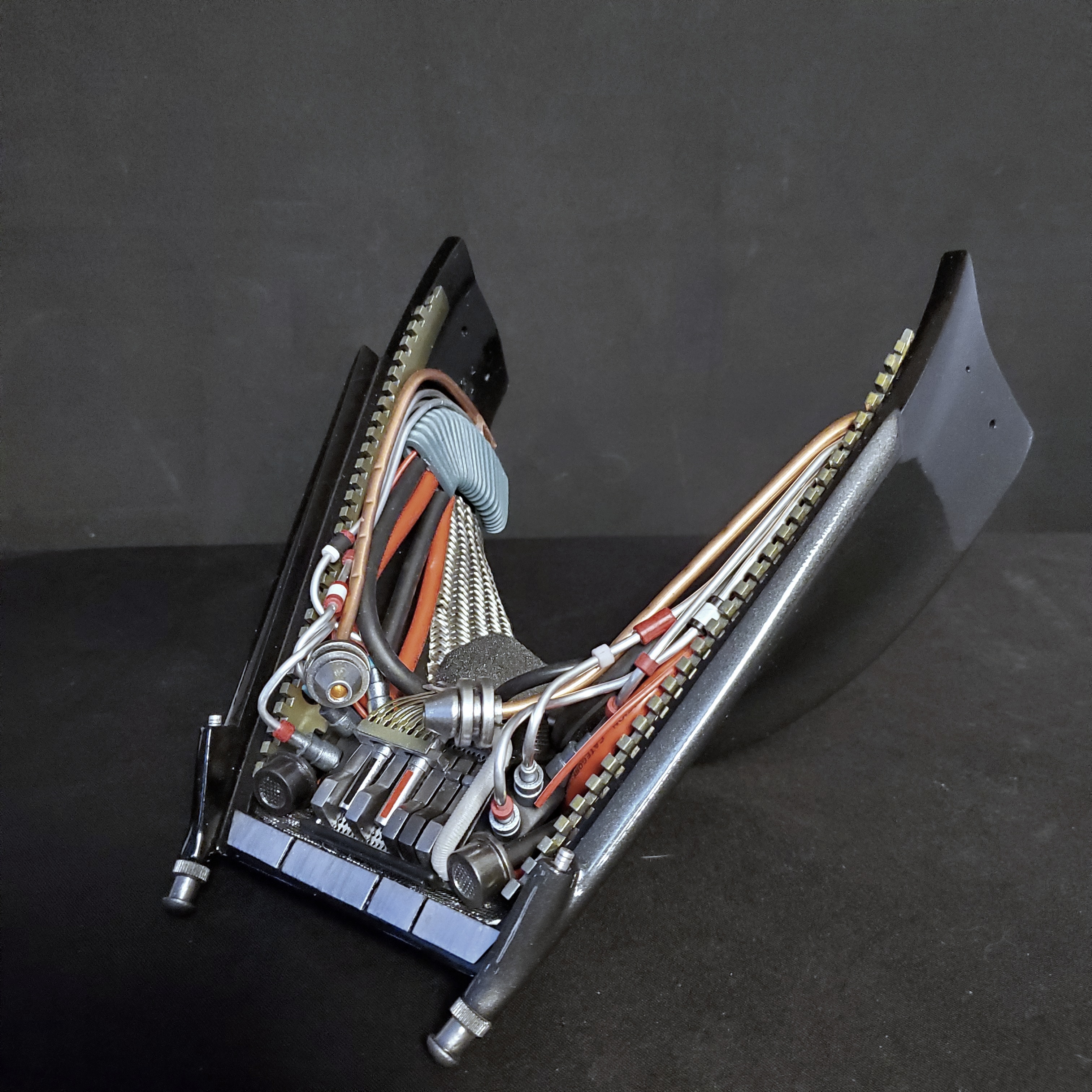

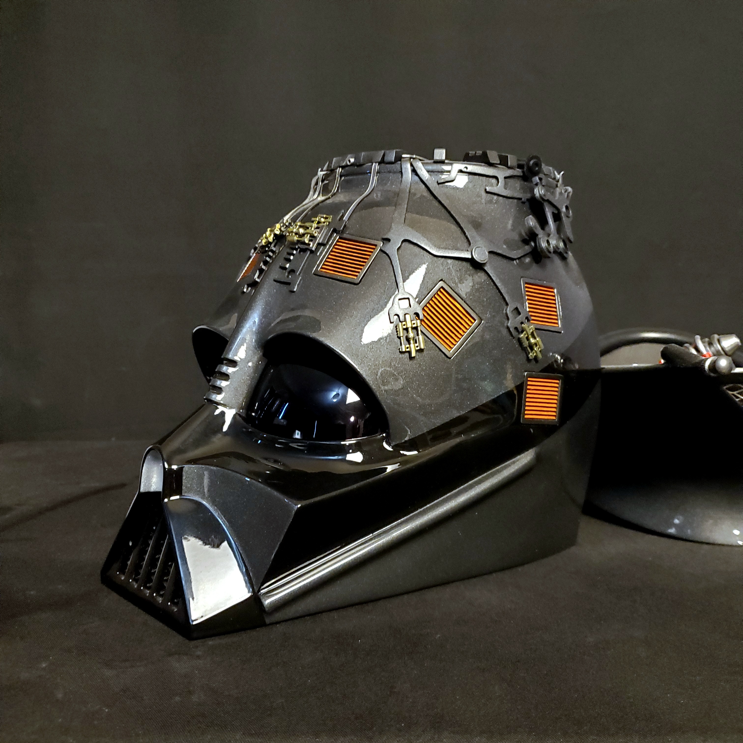

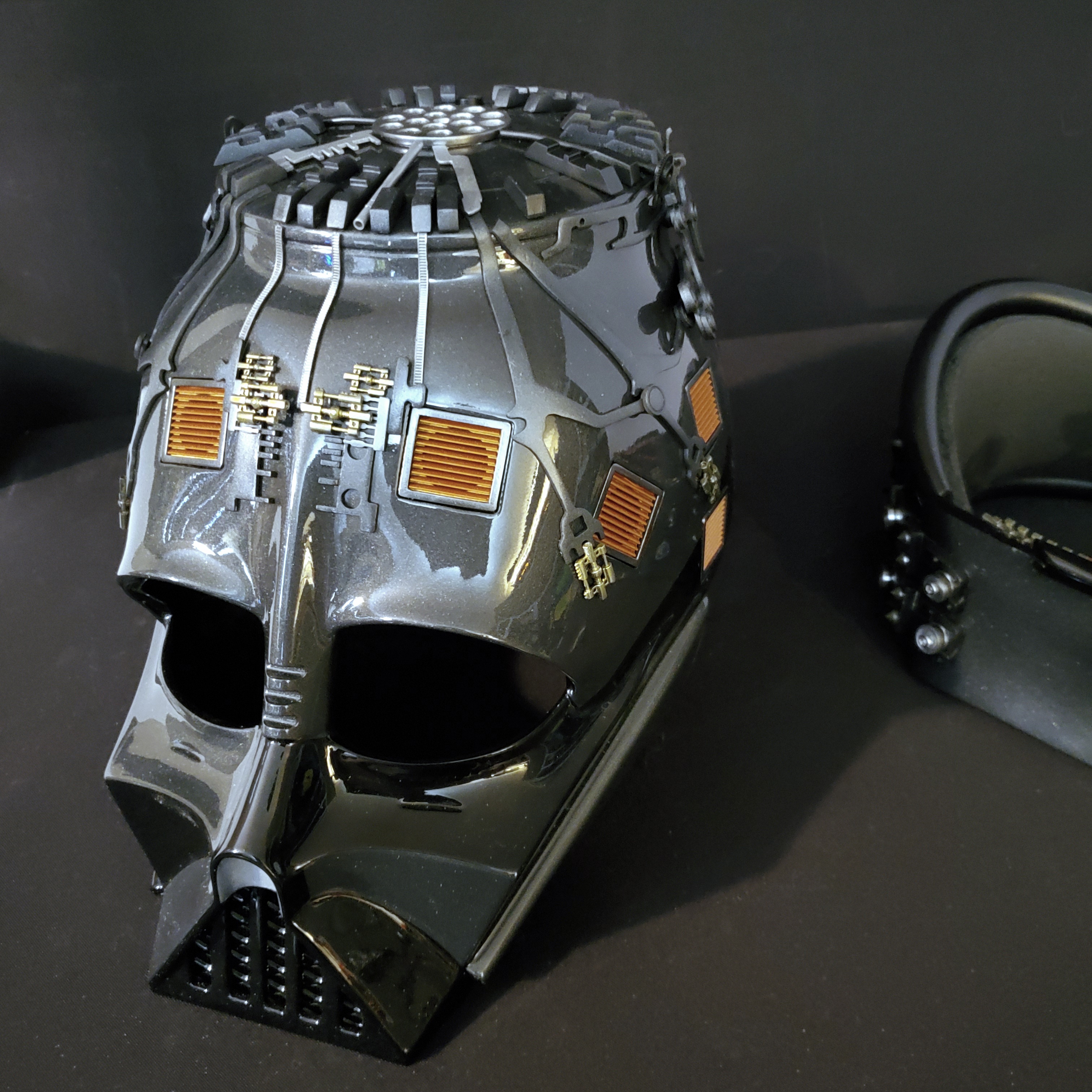

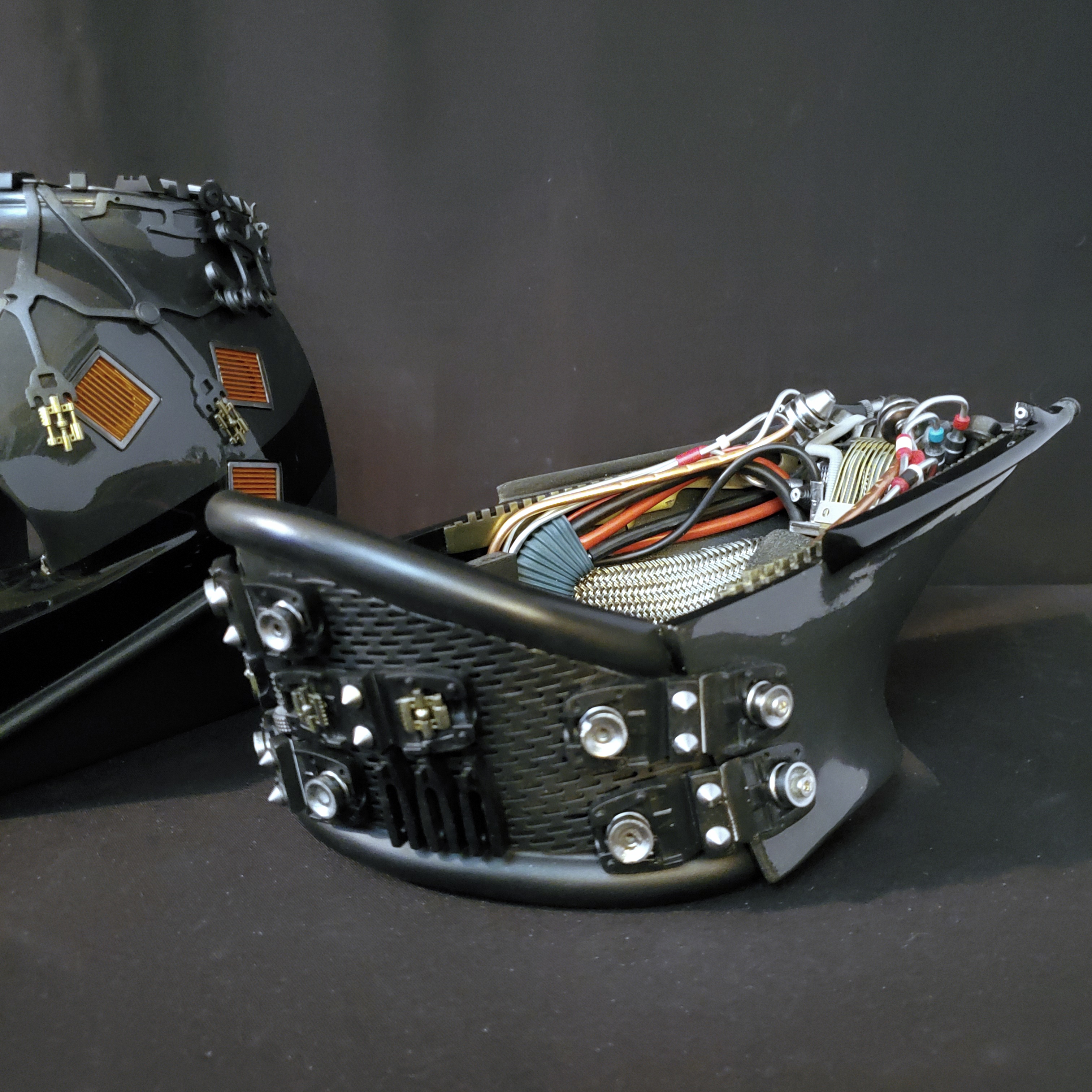

A project I've been wanting to do for a long time. I'm very close to the end now with the dome, lenses and a sith styled stand for the helmet remaining. As for real parts, yeah no, not happening lol. I tried finding parts but they seem scarce, or I just didn't search in the right areas, no matter, using real parts wasn't the objective. I just want a Darth Vader reveal helmet for my display. I've built everything myself including the model of the helmet and 3D printed it. I did my best to match reference photos of the original so overall, I'm happy with how it's going! :)
20220212_171901.jpg 20220222_111043.jpg 20220222_111057.jpg 20220222_111115.jpg 20220301_102113.jpg

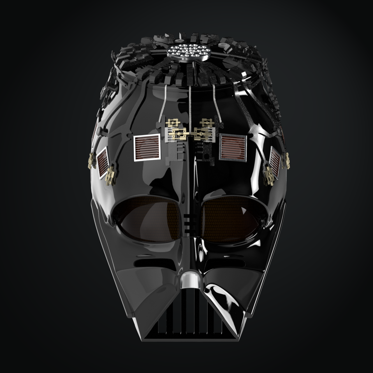

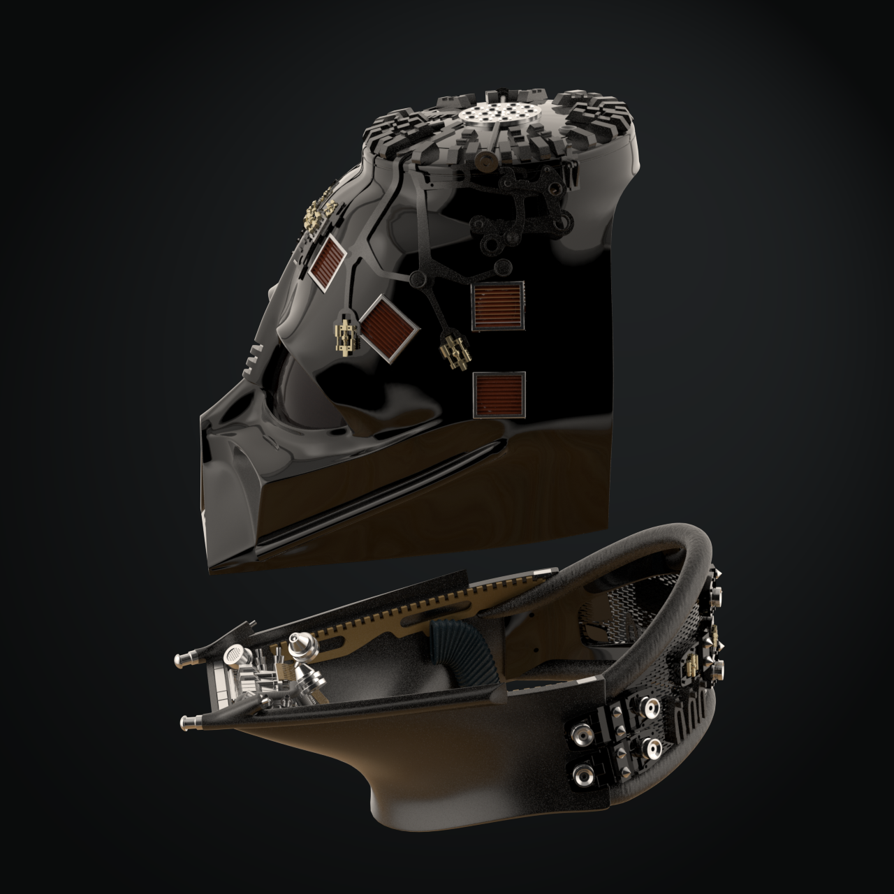

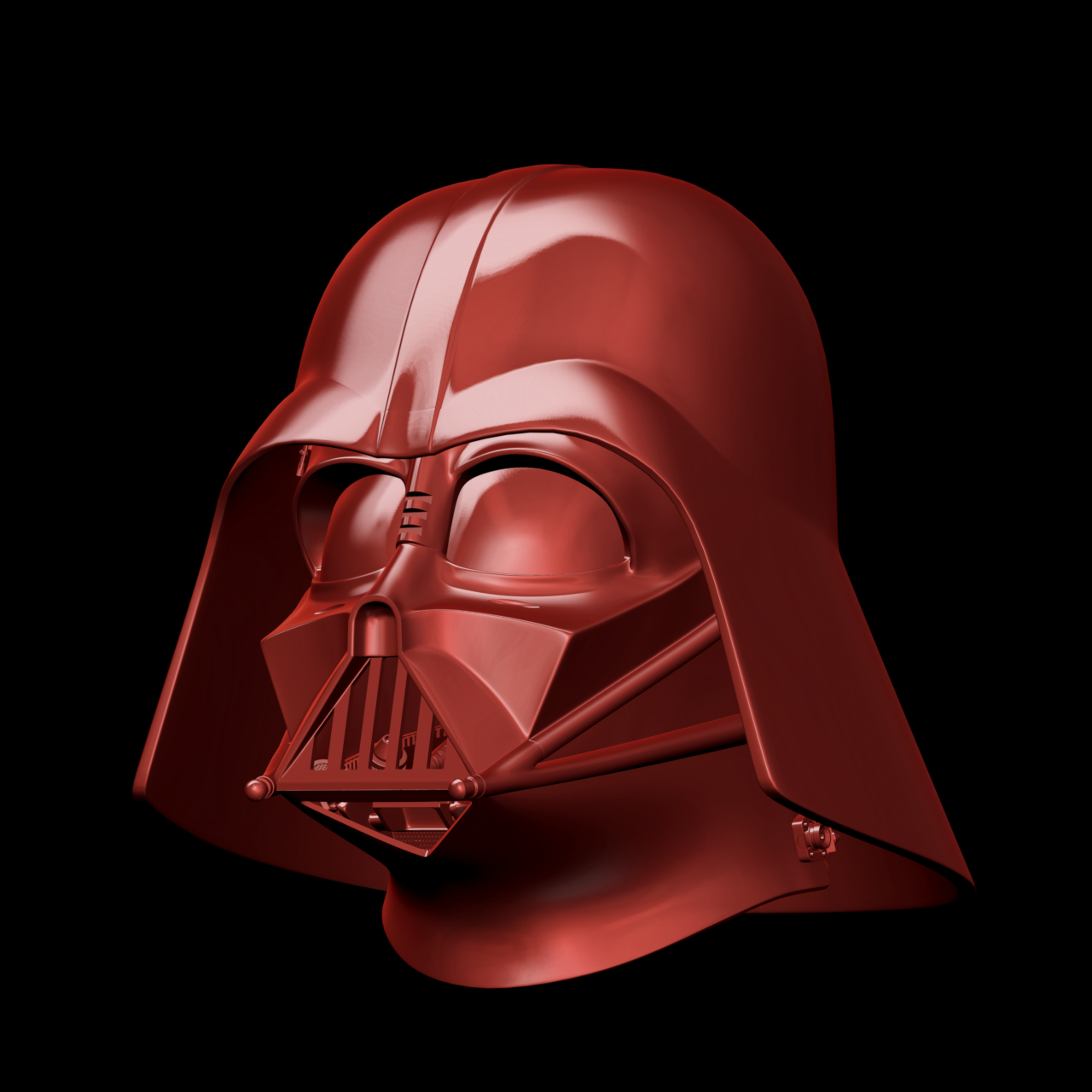

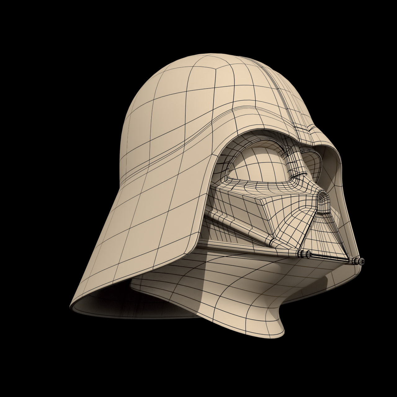

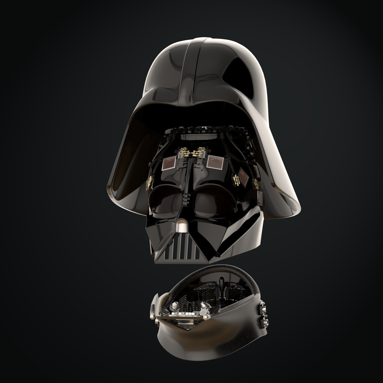

Here are the images of the 3D work

Pretty amazing! I’m assuming you’re printing in resin by the detail and cleanliness of it all?
Indeed! All of the exterior bits are resin with most of the interior as well. The helmet itself is PLA filament printed on the Creality. I used 2mm and 3mm aluminium and copper tubes for the interior. I also cut a braided hose line in half for the chin area. The trick of course was getting all the printed parts modelled in 3D accurately! I did manage to use an old digital cable box for the perforated steel on the neck brace which was nice.
I also used a small stainless mesh sheet laid in behind the larger steel mesh for the mouth and chin area.
