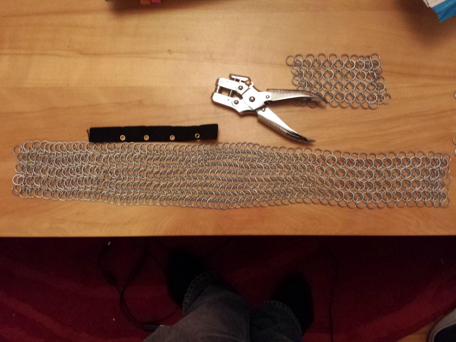

So, finally getting round to adding some of those photos I've been talking about.
A nice big length of chainmail now coming together with the eyelets I've been using. The section here is my original test. Followed by the full belt length.I've got a buckle on there temporarily at the moment.

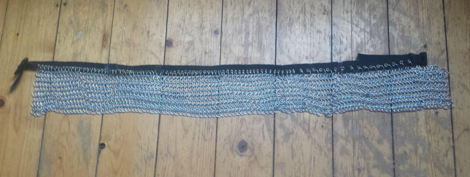

In belt form along with one shoulder strap for a test. I need to order some more strapping but the length looks pretty good otherwise. The side section isn't held up at the moment across the buckle as I can't add the eyelets there but once it's held in place it should match the rest of it. Managed to get a bunch of the buckles in the last image in the John Lewis clearance sale so I can hold the mail together down the side which will be concealed by the side armour.

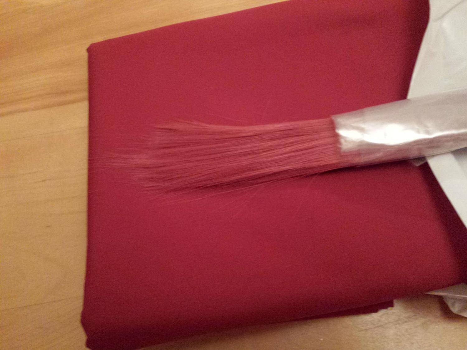

Final image for the colour match I managed to find with the helmet plume and the fabric (also from the John Lewis clearance).

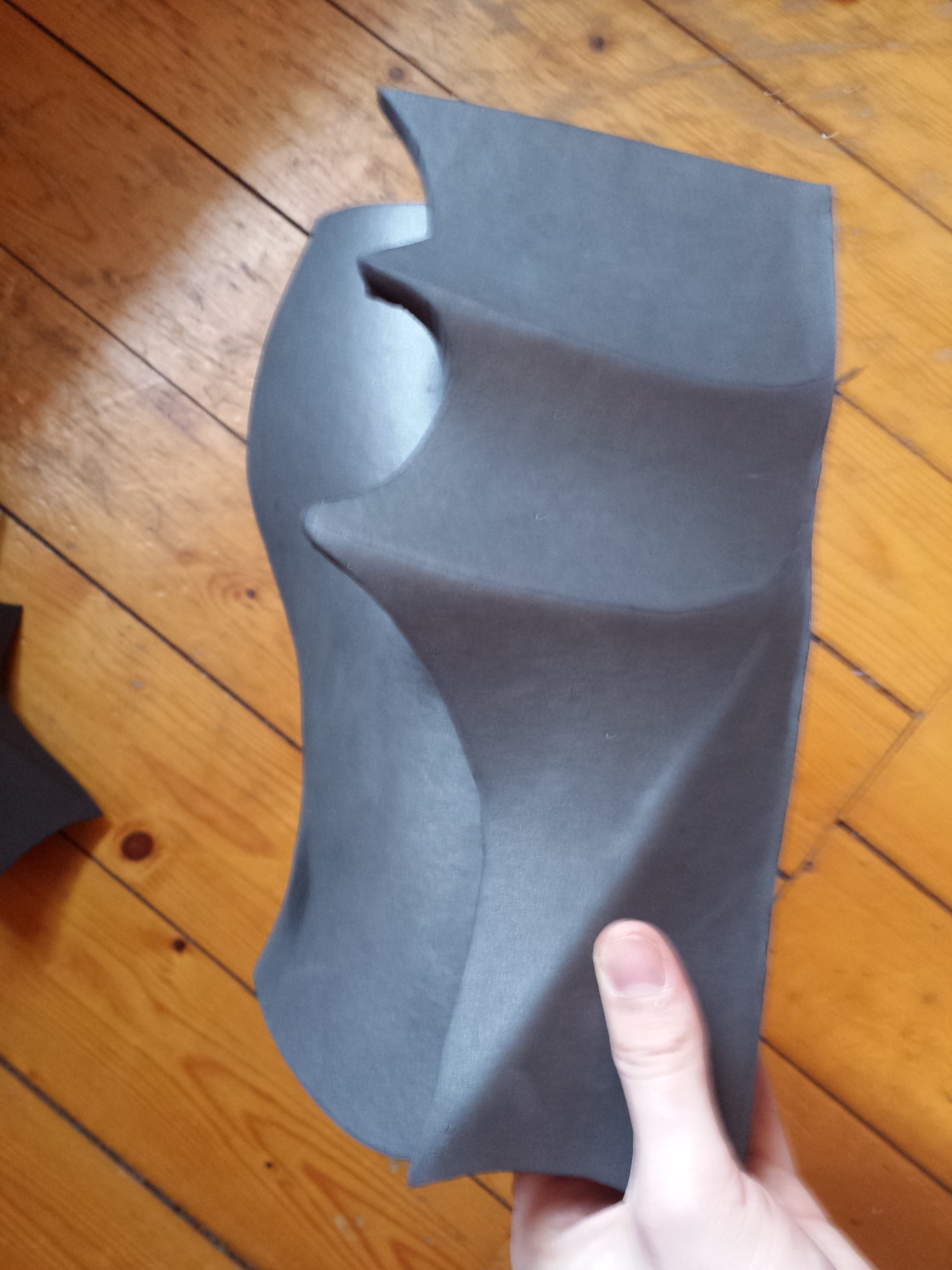

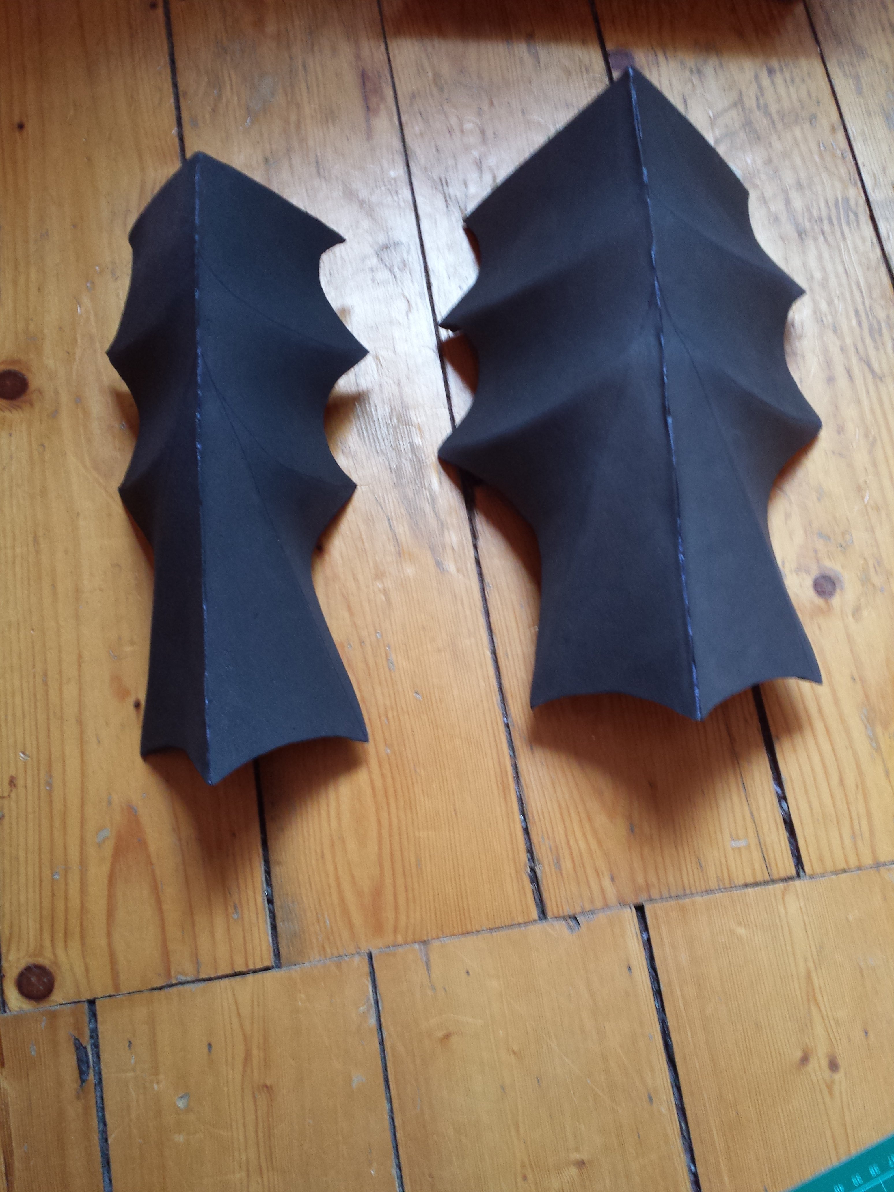

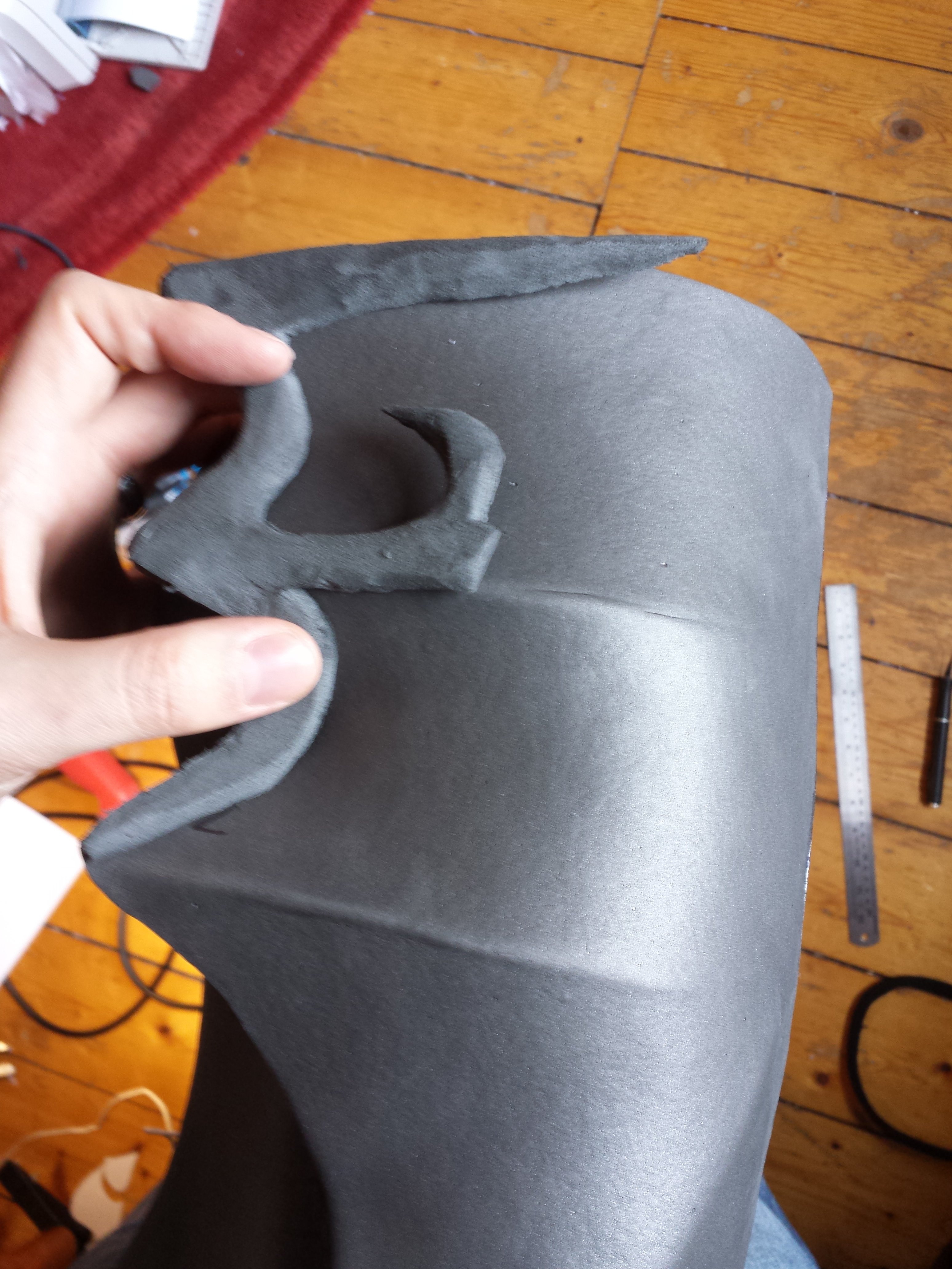

Attempt two was in thicker foam and larger. Assembled it with many undercuts and a lot of heat shaping. Had a lot of fun and was pretty satisfied.
You can see the two side by side here for comparison.

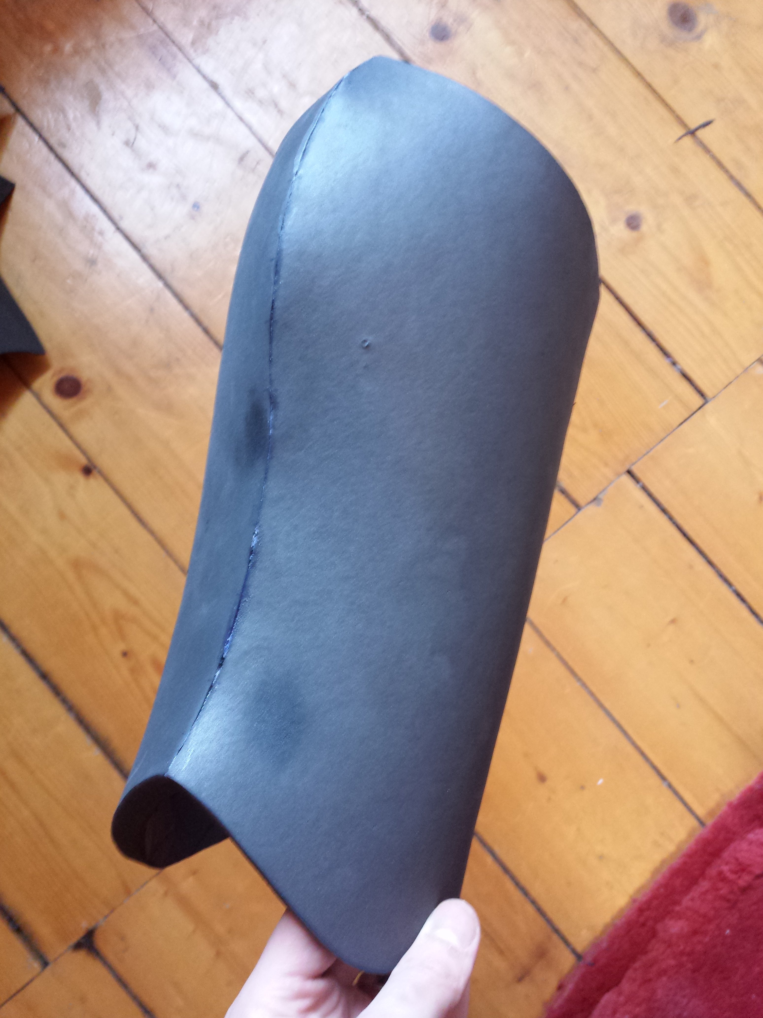

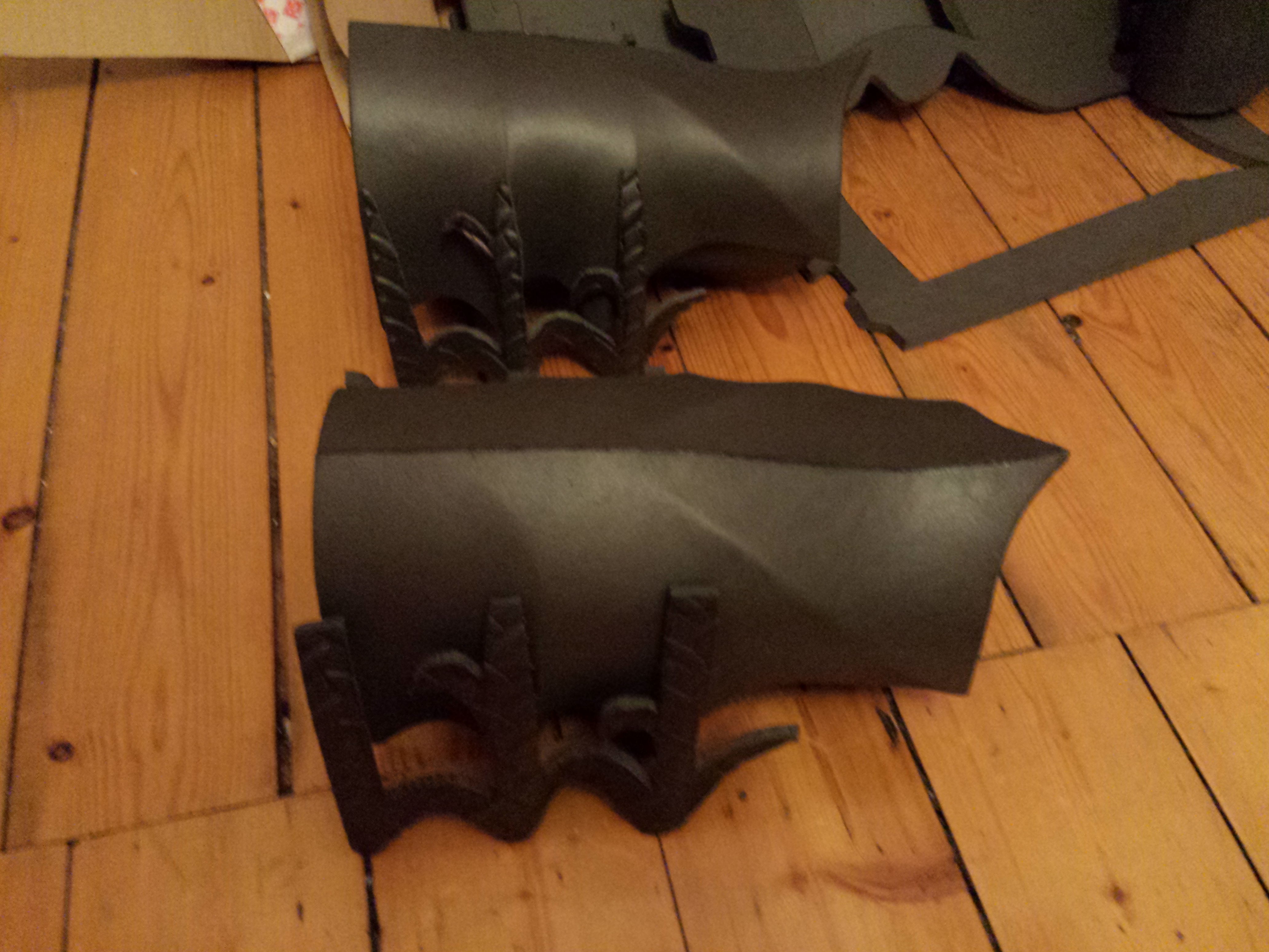

At this point things were looking good so I moved to the back of the shin. Again sticking with good old 10 mm I adapted some templates I found online to get what I was looking for. All in all I was pretty pleased with the result.
The plan at this point was to work out where to put the velcro on the front section to hold the parts together and attach some elastic straps to the front of the back section meaning it would all close nice and tight around my shin.
First things first, I realised that the front part wouldn't wrap round far enough for my happiness. Secondly, I began to have doubts about how close a fit the velcro would offer. Thirdly, I wasn't so satisfied with the angle and join on the front part.
At this point I have a fairly reasonable redesign of the front planned. I'm going to glue it on, having realised that my foot will have enough space to get through if I put it on back to front then turn it around. I'm going to extend the front panel horizontally also so that it gives a more compete wrap.
I have both of the backs of the shin fabricated, awaiting the redesigned fronts now.

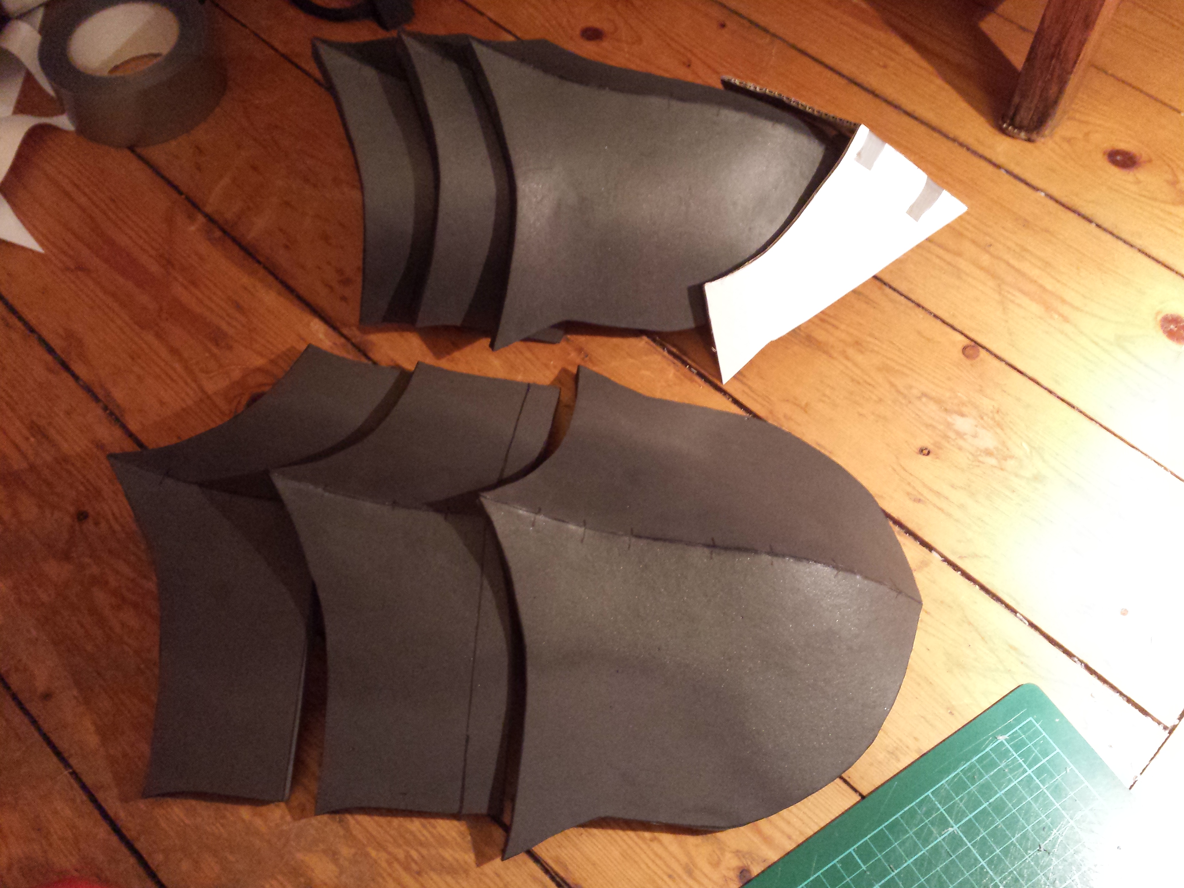

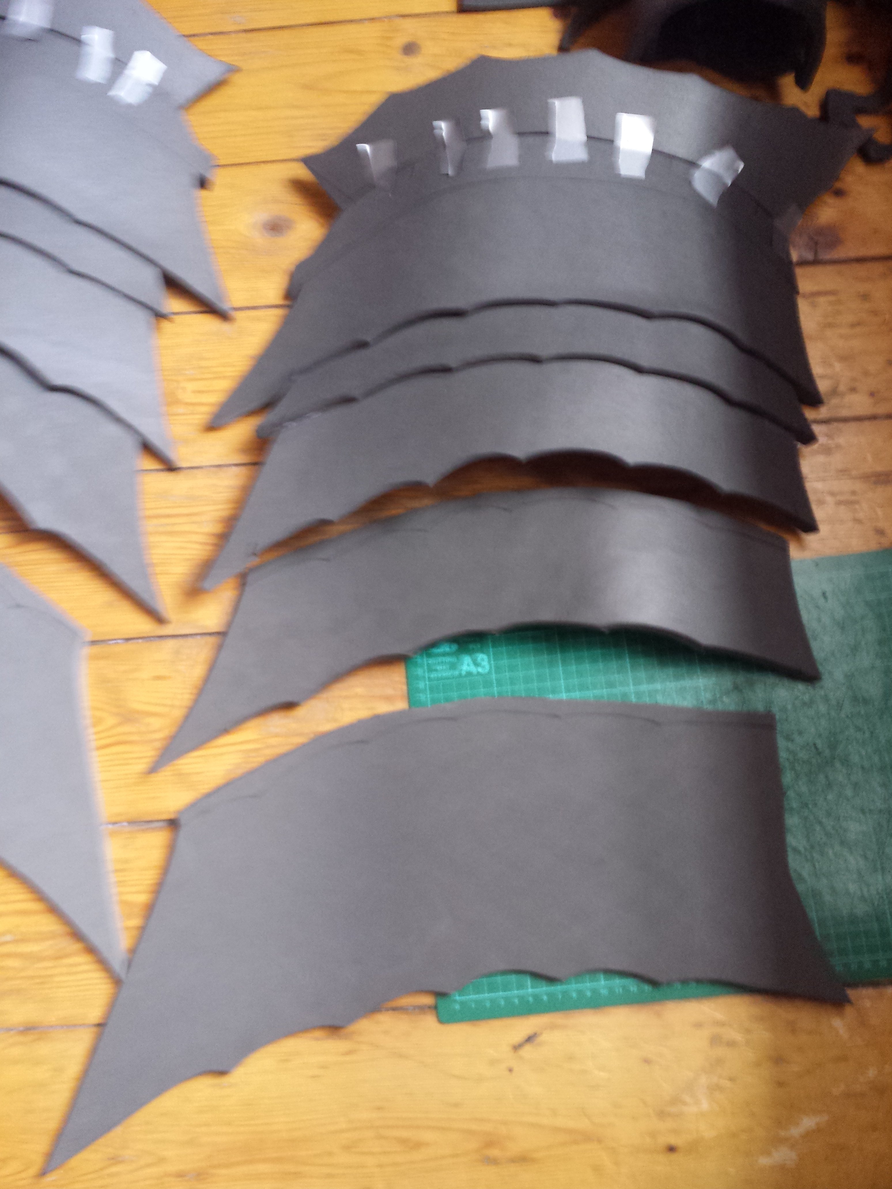

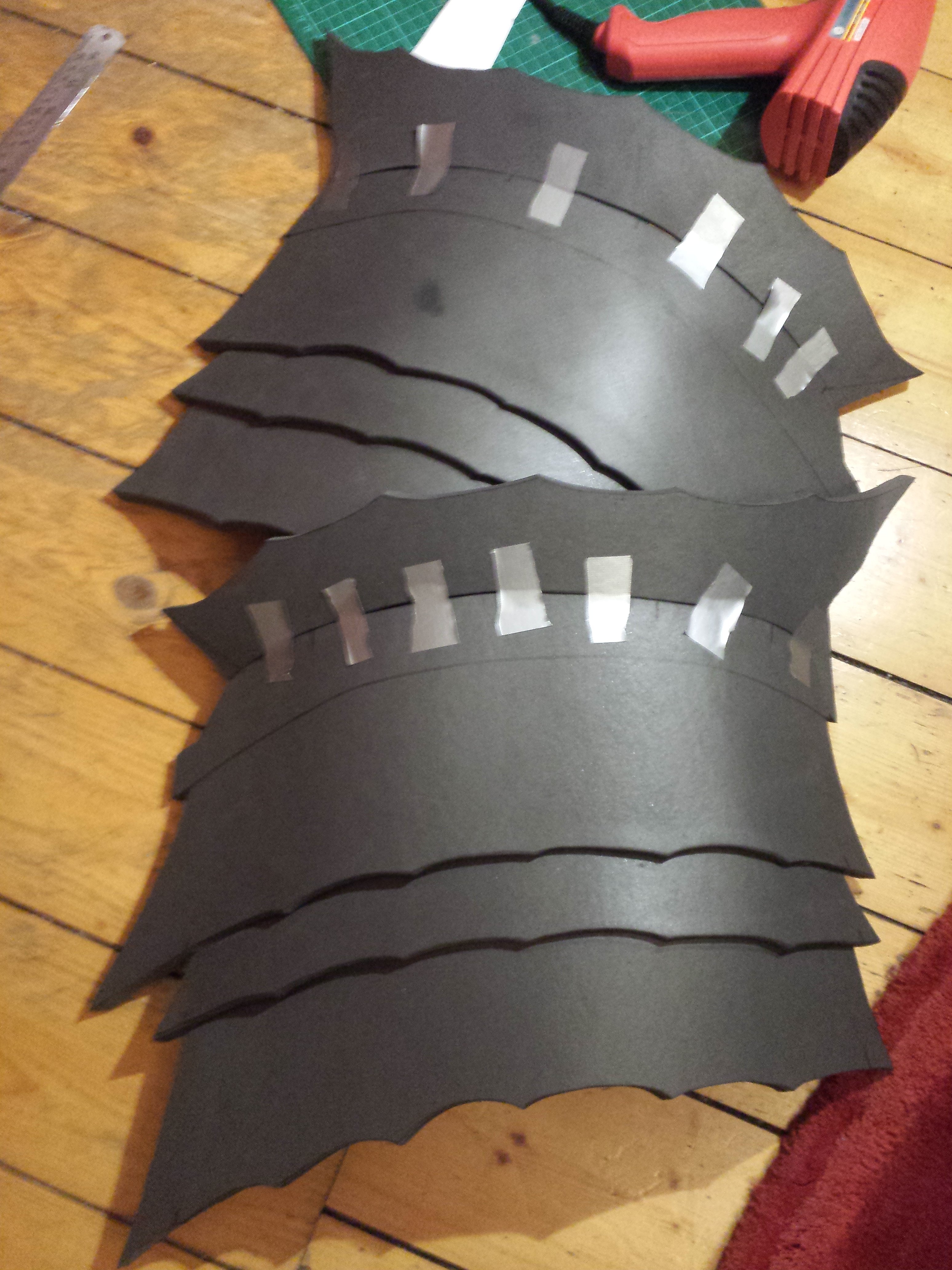

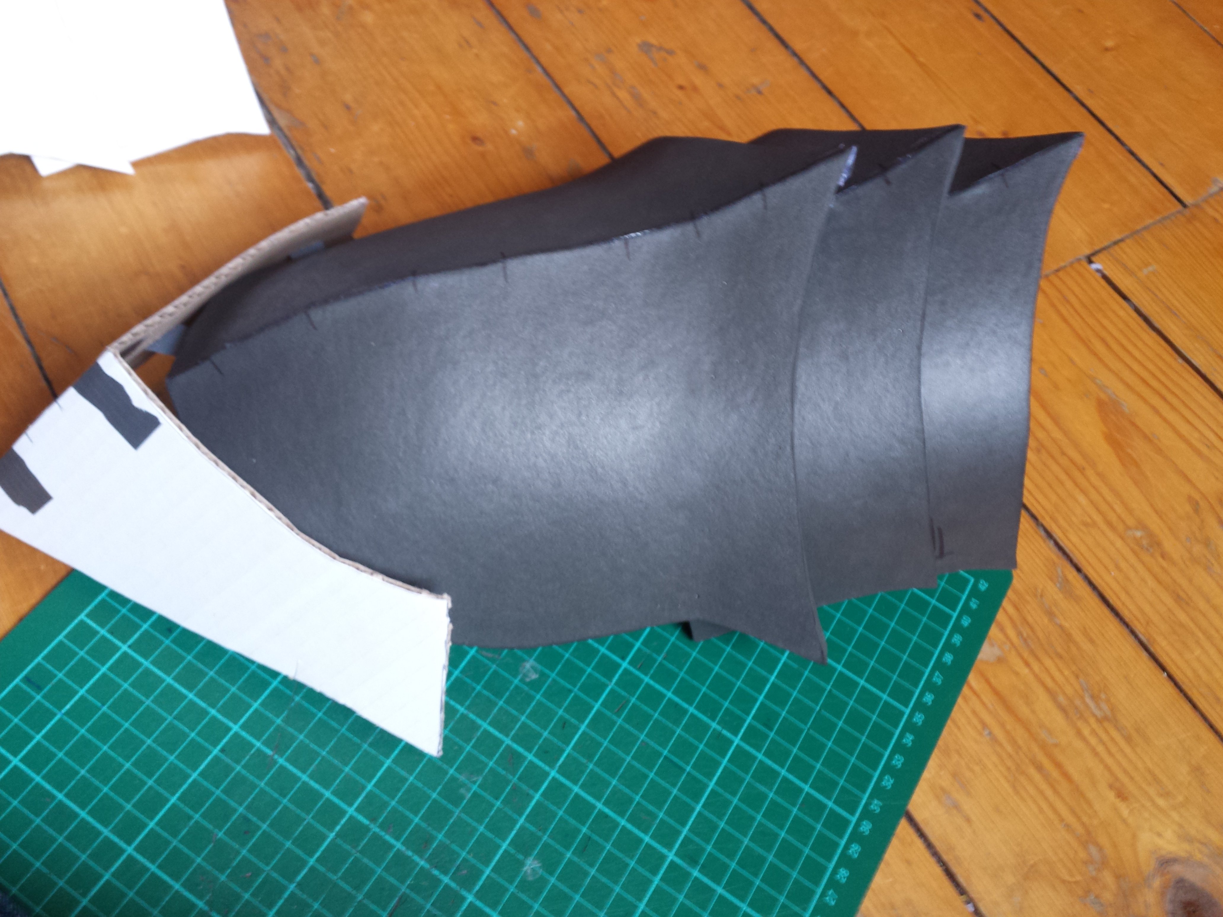

As promised, here are the thighs. The general structure of these isn't too bad. A set of layered plates on the front of the thigh only.

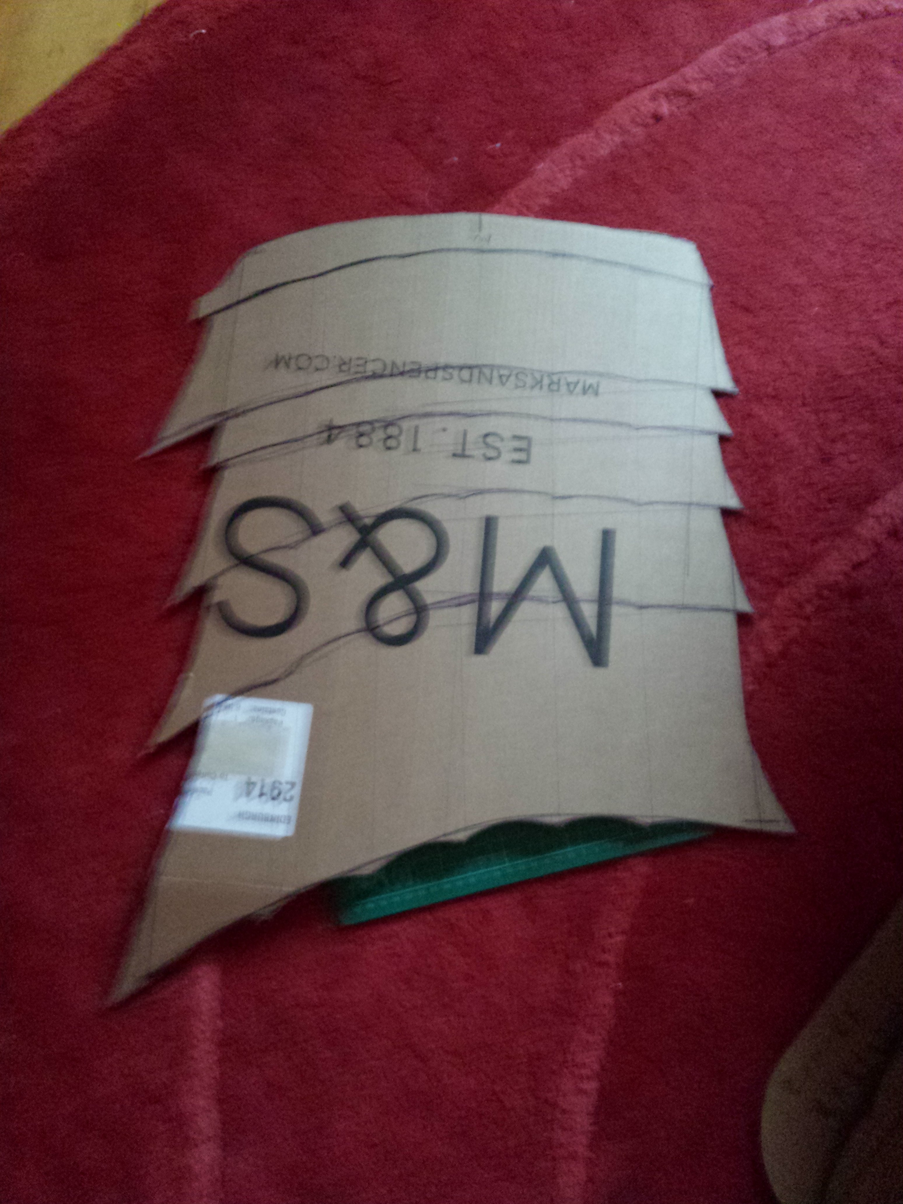

This time round I was a bit more intelligent and made more templates, thought about the thickness of the foam (well...more than last time at least).

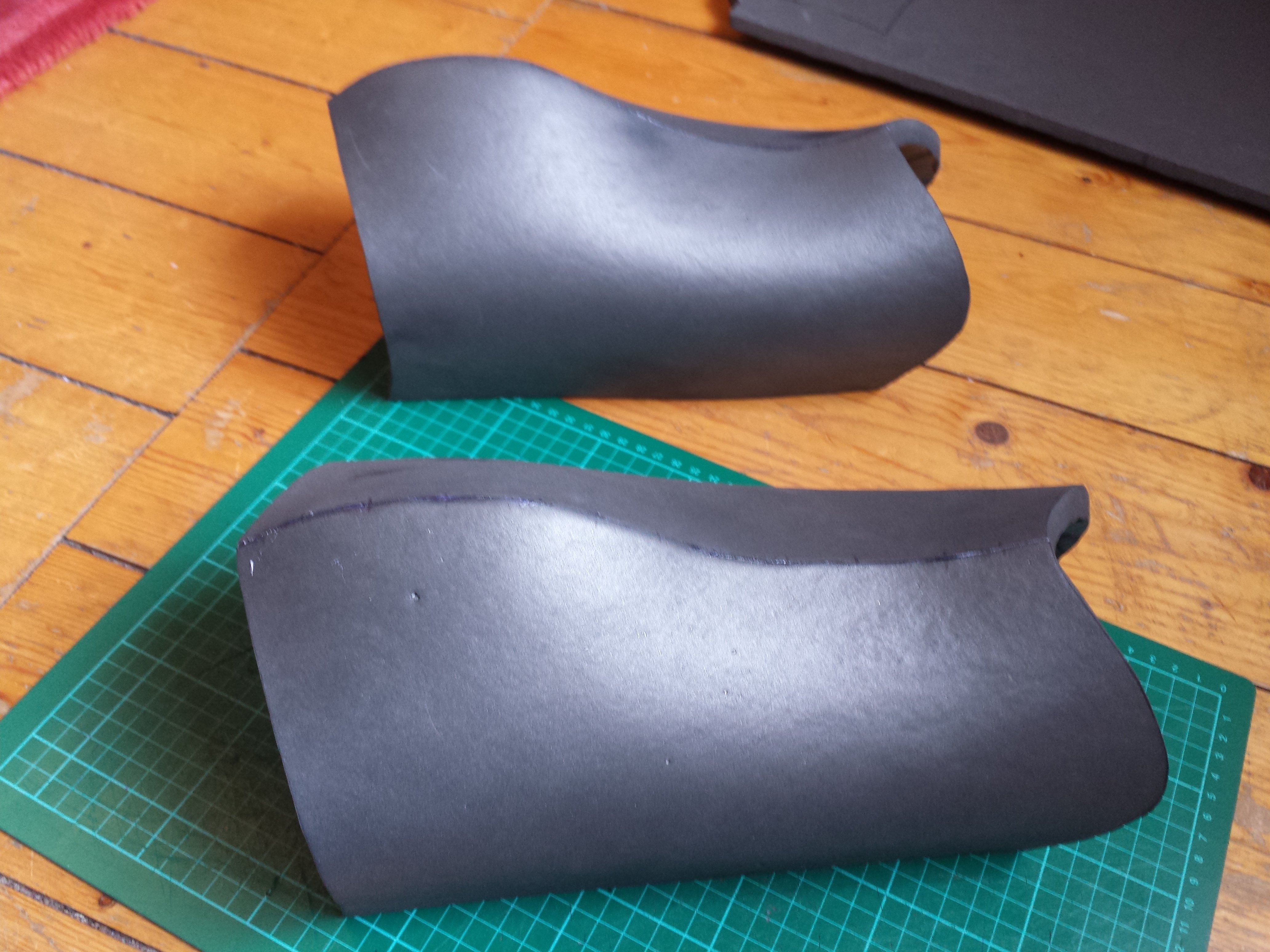

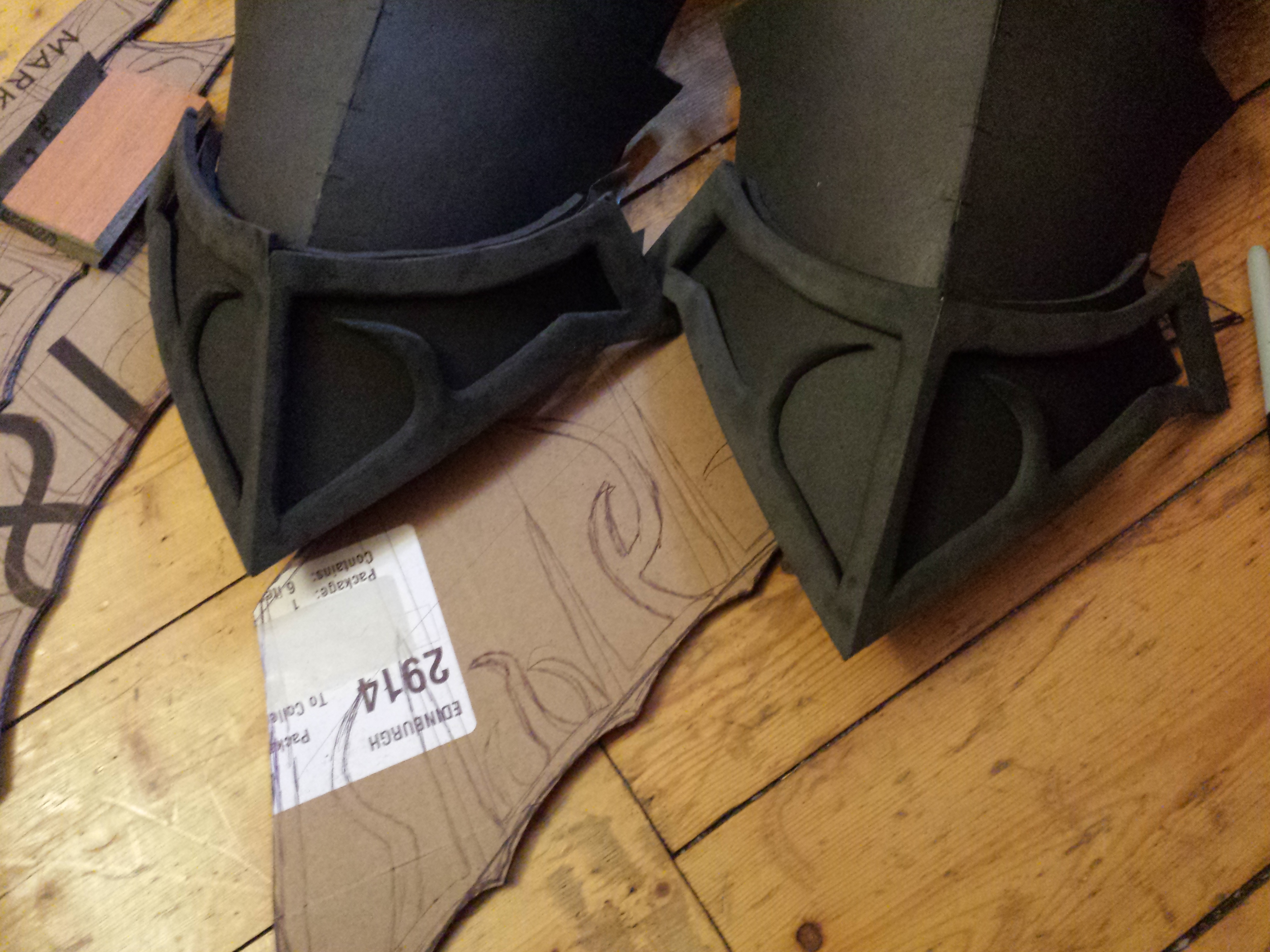

After a bit of reducing the size of the knee cup I went ahead to foam and I'm pretty pleased with the results.
Put the second one together after proof of concept worked out five. Trying to match the curves between them was one of the hardest parts.
I've made a card mock up of the knee overhang but haven't put it into foam yet as I began to think about the 'height'/angle of this plate compared to the shin. I wanted to be sure that there wouldn't be any issues with them both trying to occupy the same space.

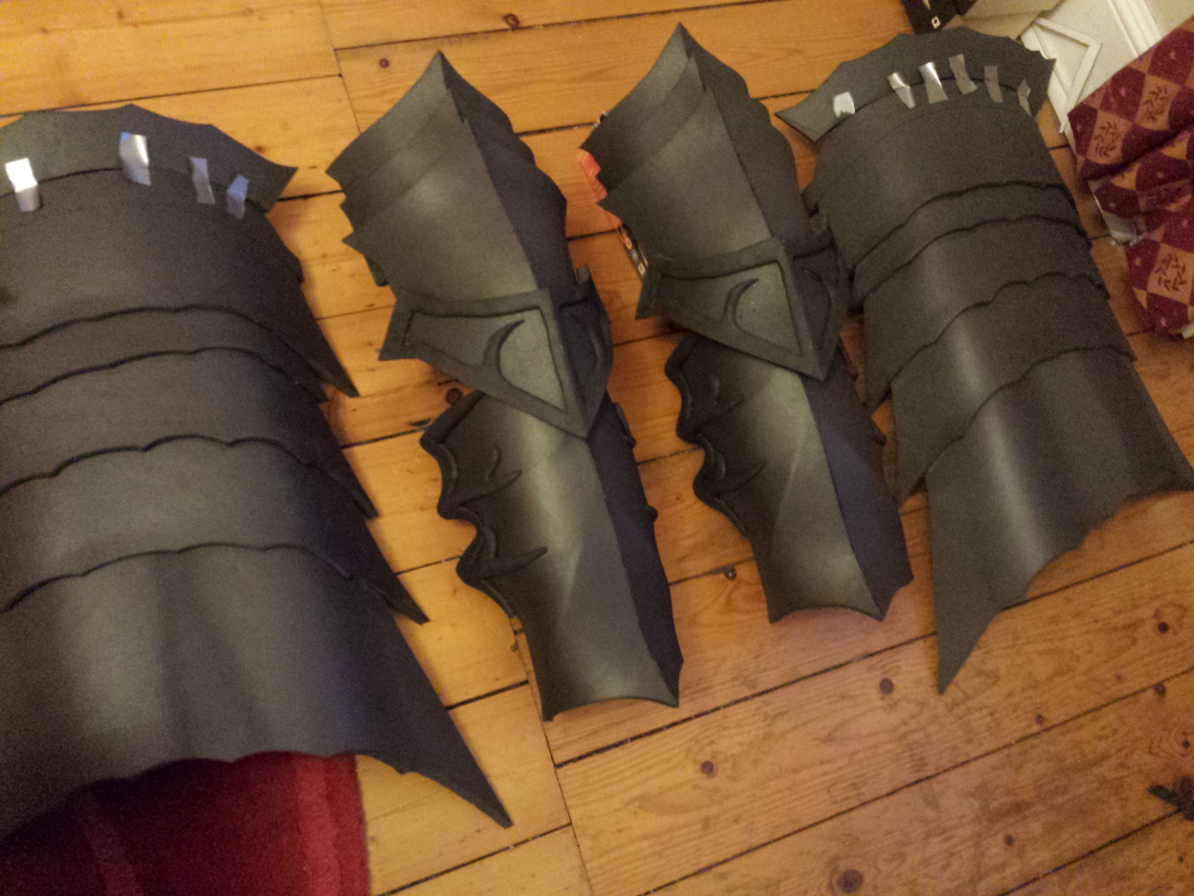

So, at this point I have the backs of shins and the thighs. Fronts of shins come next surely...?
Nope, started to think about the heights of the shoe covers and making sure that the shin wasn't too long.
So...next update will be the shoes.

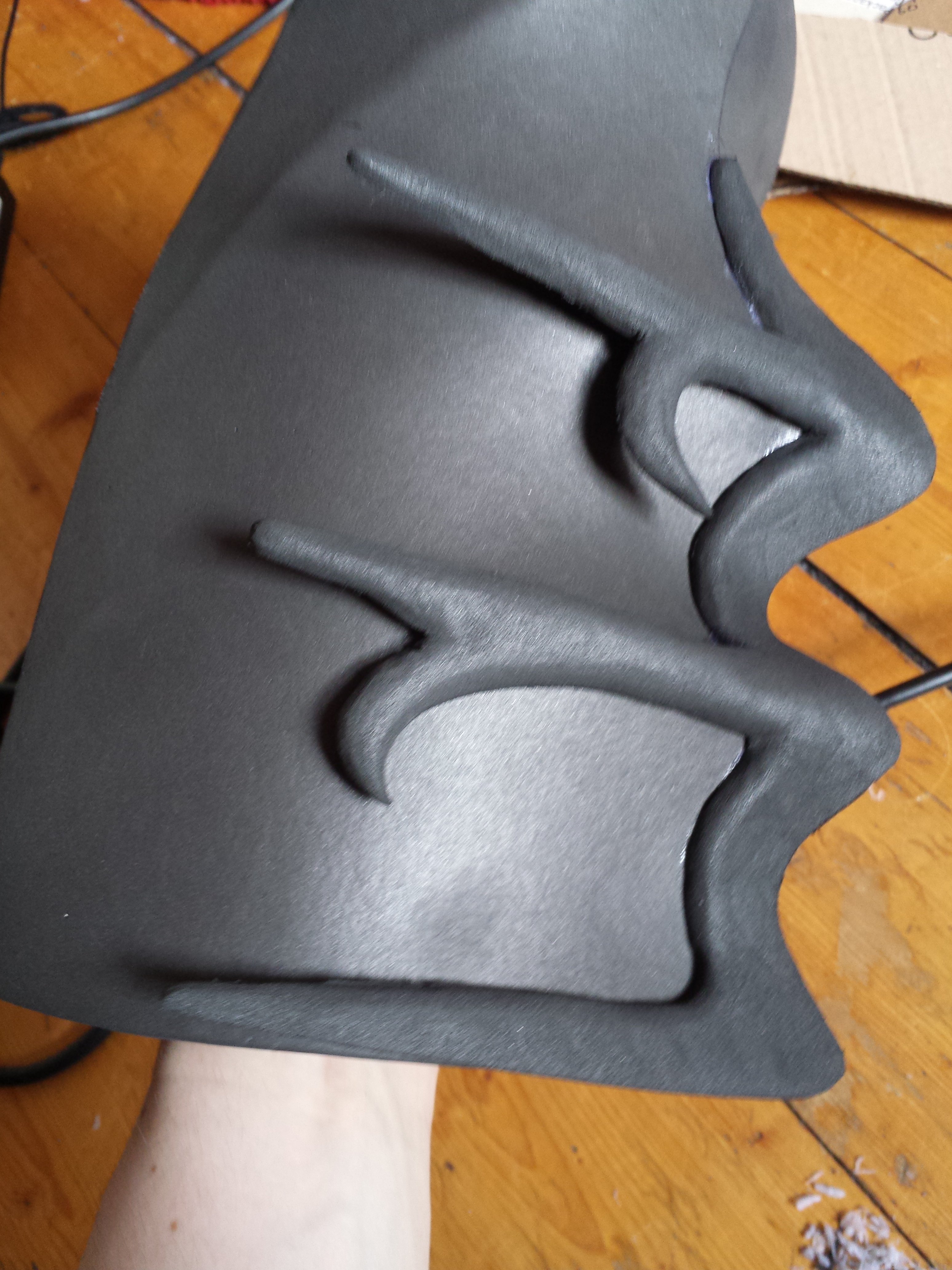

So things have been silent for a bit of time but I have been busy. As always I've been flitting around some parts as I realise orders of doing things that make more sense than what I had initially planned.
So, first off, I actually stuck to continuing to work on the leg details and getting that all together. I came across a tip on Facebook from EyeofSauron designs which I've been making full use of. When doing beveled sections, use the back side of the foam as the upper face. This means that you don't need to worry about smoothing out the patterned side for gluing to the armour section and you have a nice flat backside to start from. The patterned side is getting sanded down anyway so it's all good.

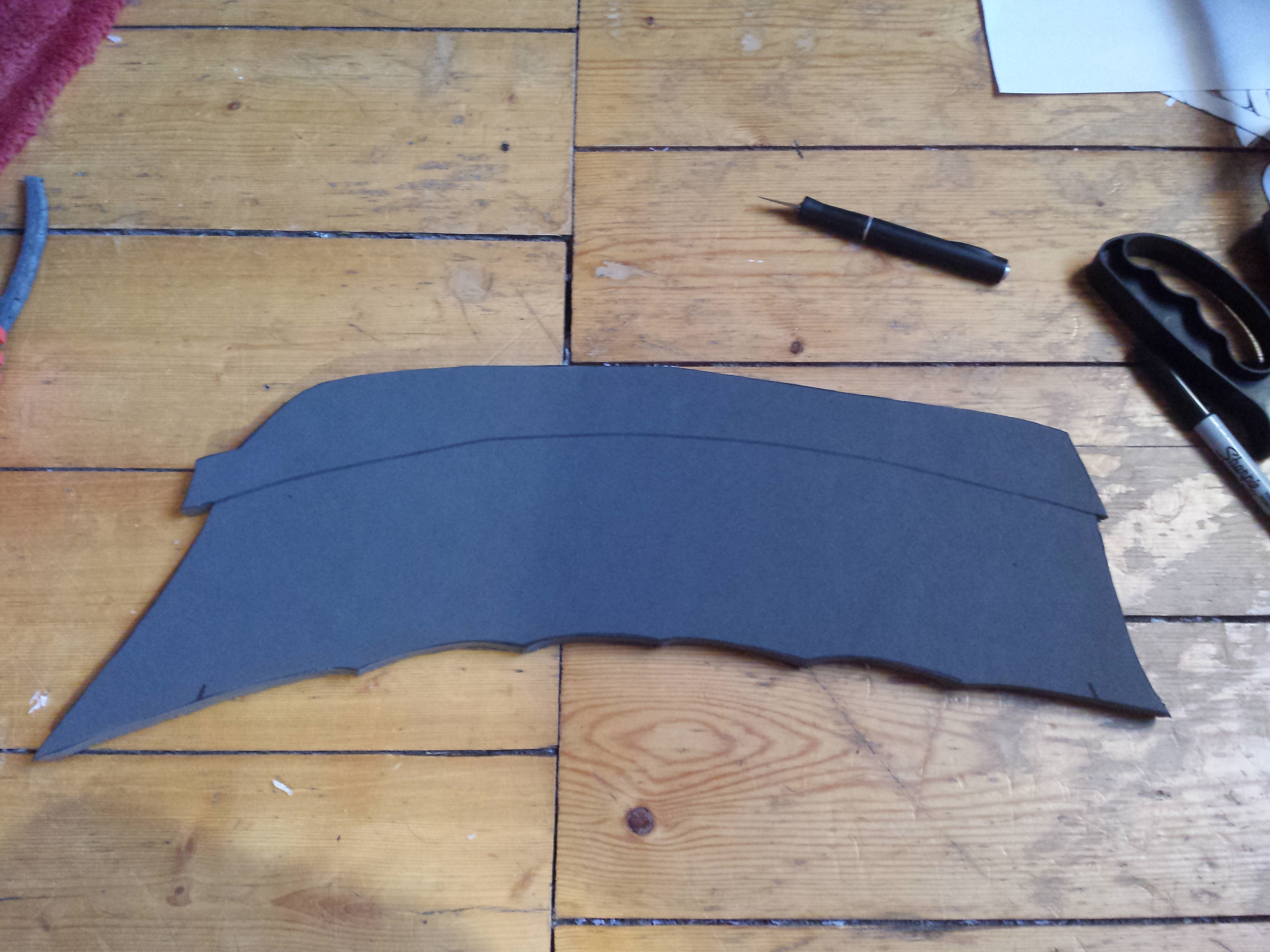

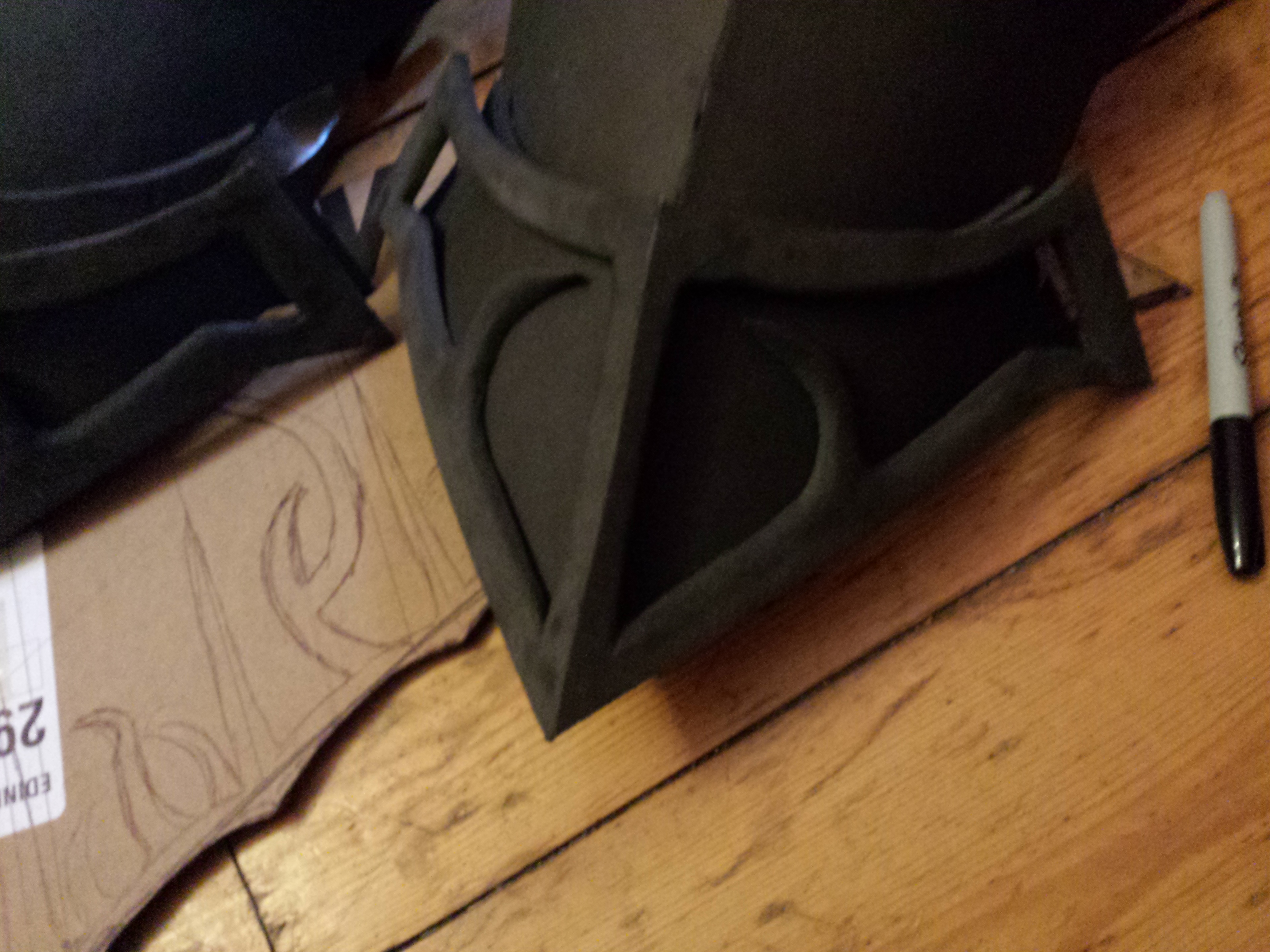

So to make things as simple as i could I started off cutting out the sections to be used for the shins and heat shaped them to match the curves I already had made.
I just cut a general area at first and then drew the further designs on after as I couldn't think of an easy way to template it. In other words, these sections started as rectangles, were heat shaped to match the shins and then cut to the approximate final shapes you see in the picture.
I repeated this for the thighs/knees next. They were simpler to do in some ways but had their own issues.
Firstly, less heat shaping to be done, excellent. Secondly, however, it was much more interesting trying to match the lengths needed for the angled cuts and trying to get a smooth edge along the front due to the pattern. You live and learn. In the end I managed to match it using the flatter areas of the mat and by holding the angles relative to the section it was to be glued to. With that sorted, I then went about cutting out the inner edges for the pattern.
I was pretty pleased really with how it was shaping up. This method does take a fair bit of foam that you can't reuse too much and I could have done it with strips glued at strategic corners but I decided I would rather be less efficient with this so as avoid having to sand any hot glue and wrecking my sanding drums (it just melts into them, making them all smooth and useless).

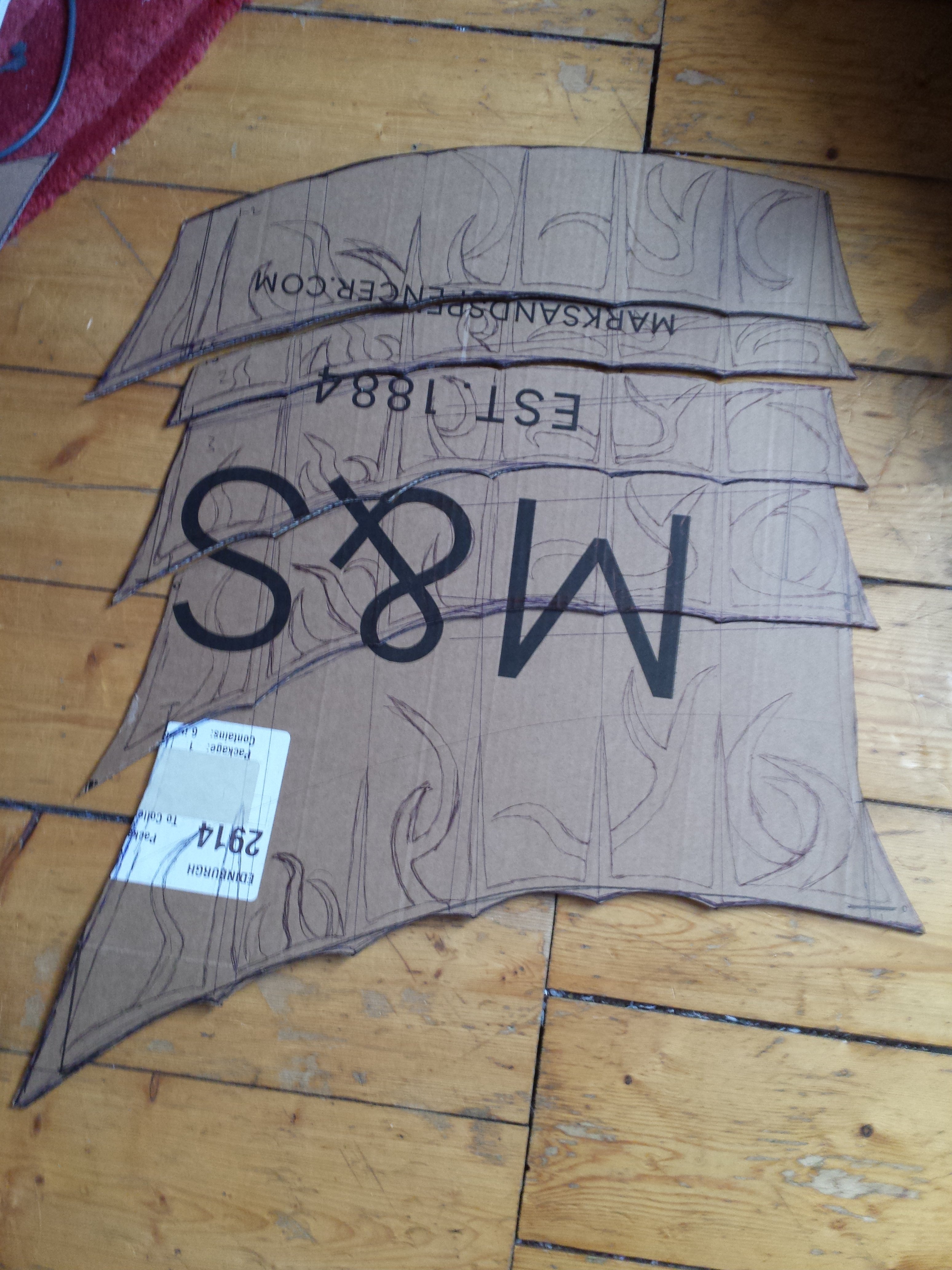

At this point in time I decided I would be clever and try and do as much of the sanding as I could in one sitting. So, these sections were put to one side for now and I started work on the side plates for the legs. I started these templates directly on the card this time after a lot of test sketches trying to get a feel for the shapes. I went full maths on it as well and loaded up the images on gimp so I could get relative pixel sizes between each layer. I used these ratios to determine the real world sizes for my panels after deciding on a length that seemed good. The resulting cardboard chunk certainly looked the part to me.
I cut this along each division line and then traced it onto my foam directly. For these parts I went with 10mm to try and maximise their free standing rigidity. Initially, I had thought to put them behind each other but I rapidly came to realise that would add too much of a step at each level and the relative curvatures would have caused nightmares for me.
I ended up taking a method I had used in my iron man helmet and actually cut a thin strip out of the back of the bottom edge of each layer. I didn't measure it exactly but it was close to 5mm. This allowed me to inlay each level into the previous panel. In order for this to work, it required an extra 'tab' above the top edge of templates I made but it wasn't too bad to add this in.
The next challenge was to decide on a curvature for it all. I cut out just the top panel and started to play with my options trying to match something reasonably well. I wasn't entirely sure how best to do this so decided to make the trim that goes at the top to get a better feel for it. I've just taped it for now while I still play with curvatures but they weren't too bad in the end to build up.

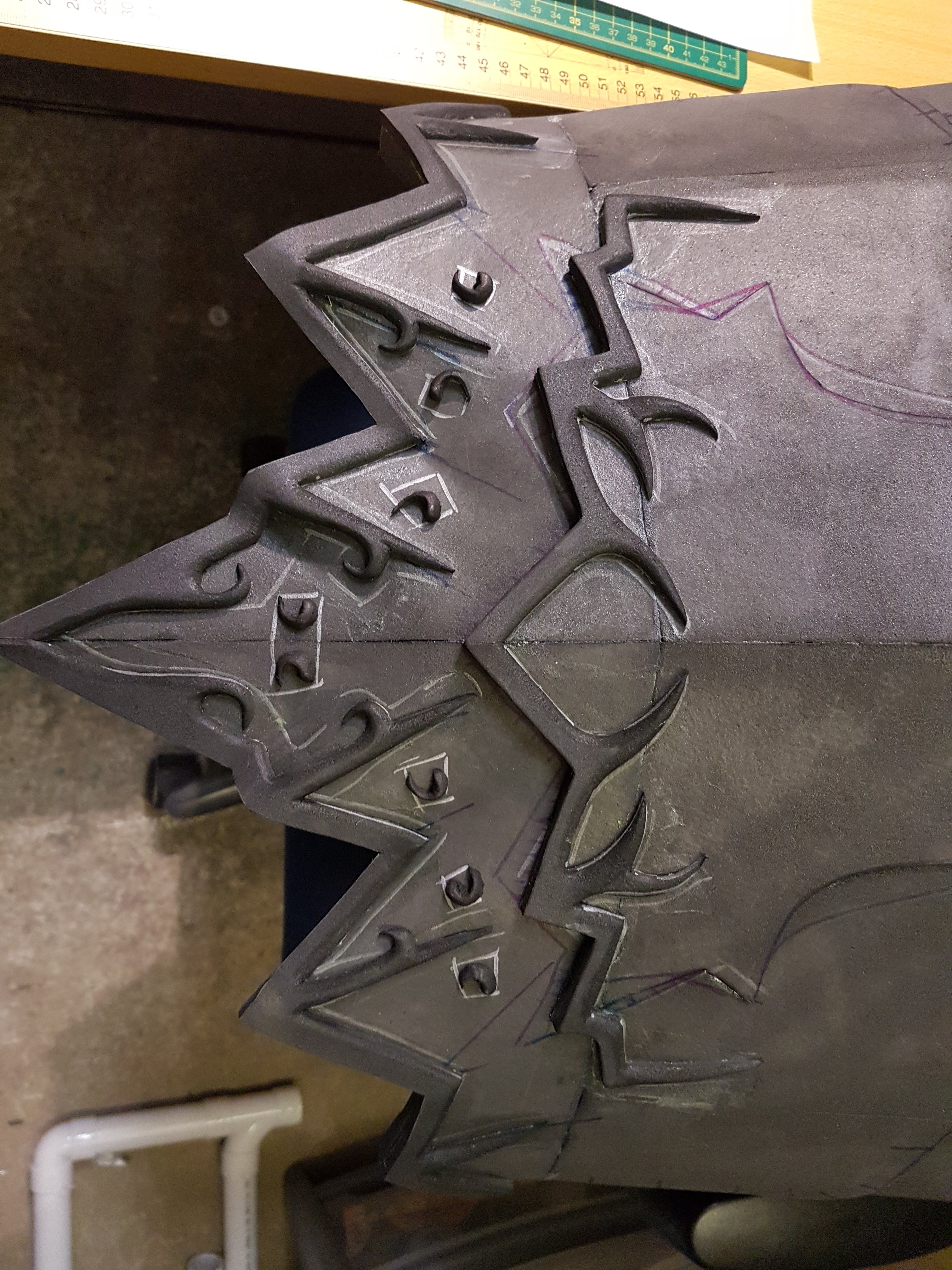

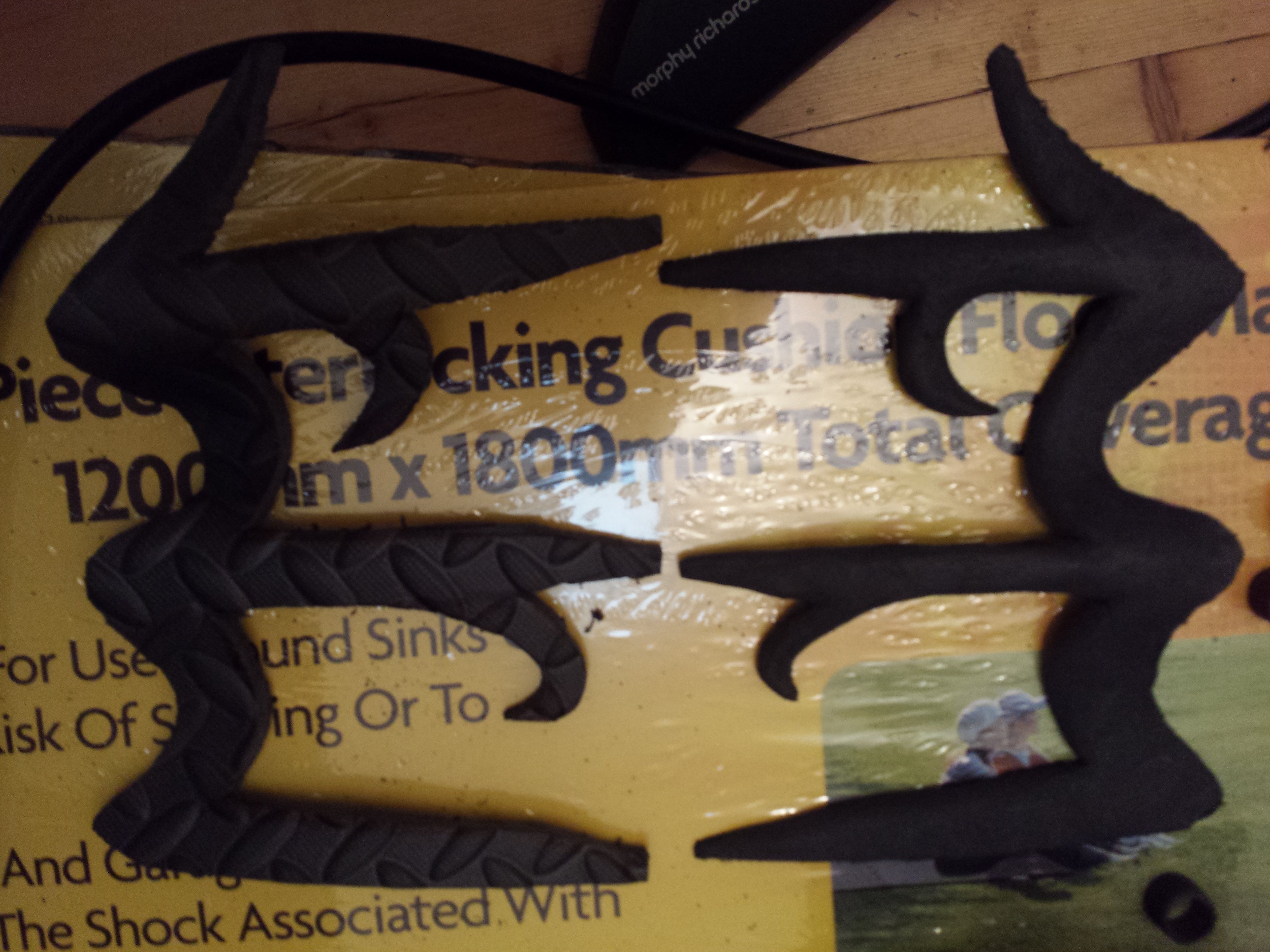

The next stage was to try and a) work out what the designs on the legs were and b) decide how to transfer this to the panels. Well, I had these card templates already made so I made use of them once again and started to trace the designs.
I was all set to head into this when it occurred to me that maybe I should try out my planned method on the parts I had already before putting time and effort into something that may not have been any use.
So... back to the thighs and shins we go. A whole load of dremelling later and I had some lessons and discoveries and some rather nice detail sections.
20160520_070714.jpg 20160520_070723.jpg 20160520_202311.jpg 20160522_174518.jpg
A touch of hand sanding later to tidy them all up and I glued them on to their respective sections.
At this point I went through a load of tweaking with the leg panel curvatures, trying to get them matching and working out symmetry before i actually cut anything for the detail. In the end I decided that I really just needed to make a start on the strapping and then I would actually be able to decide.
So one set of straps and a lot of temporary tape to make sure it looked OK before gluing, we have

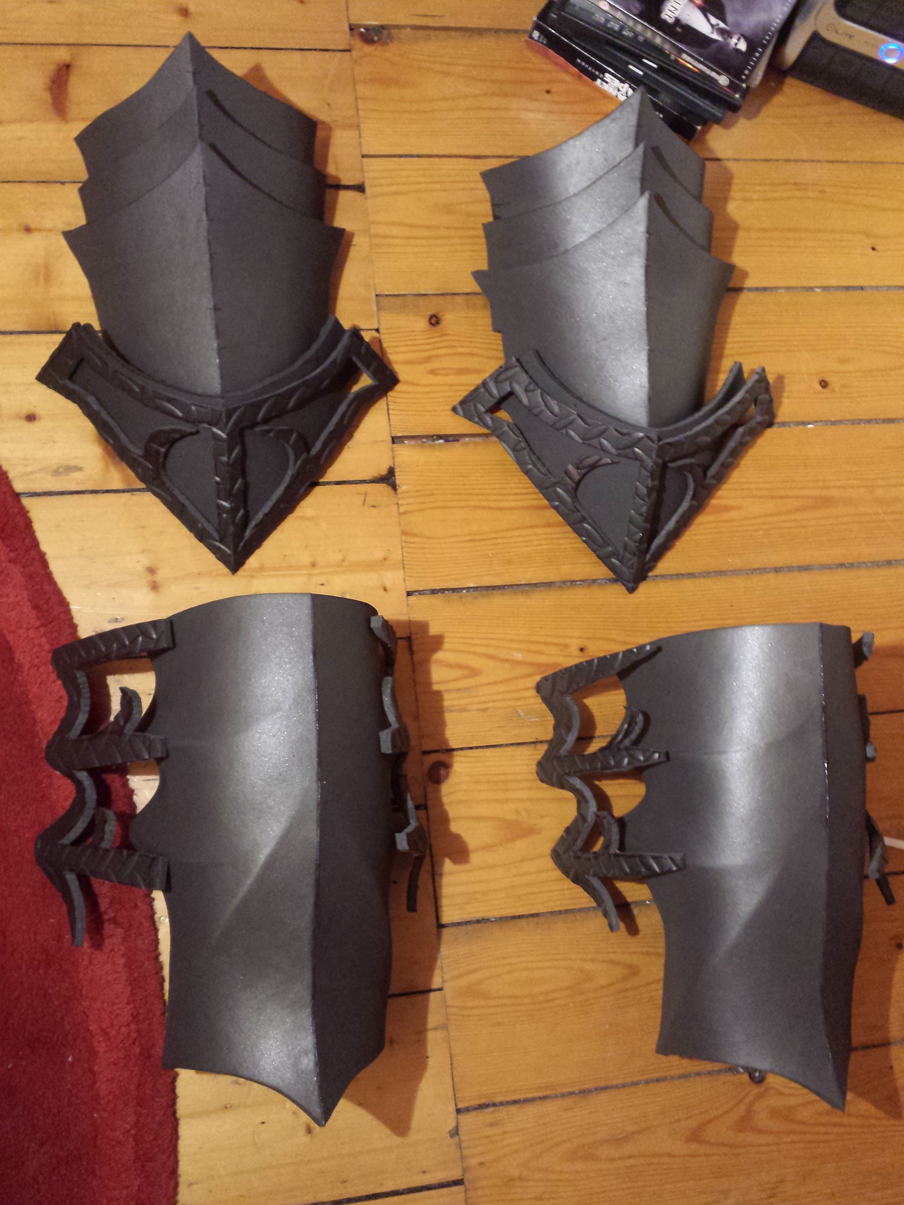

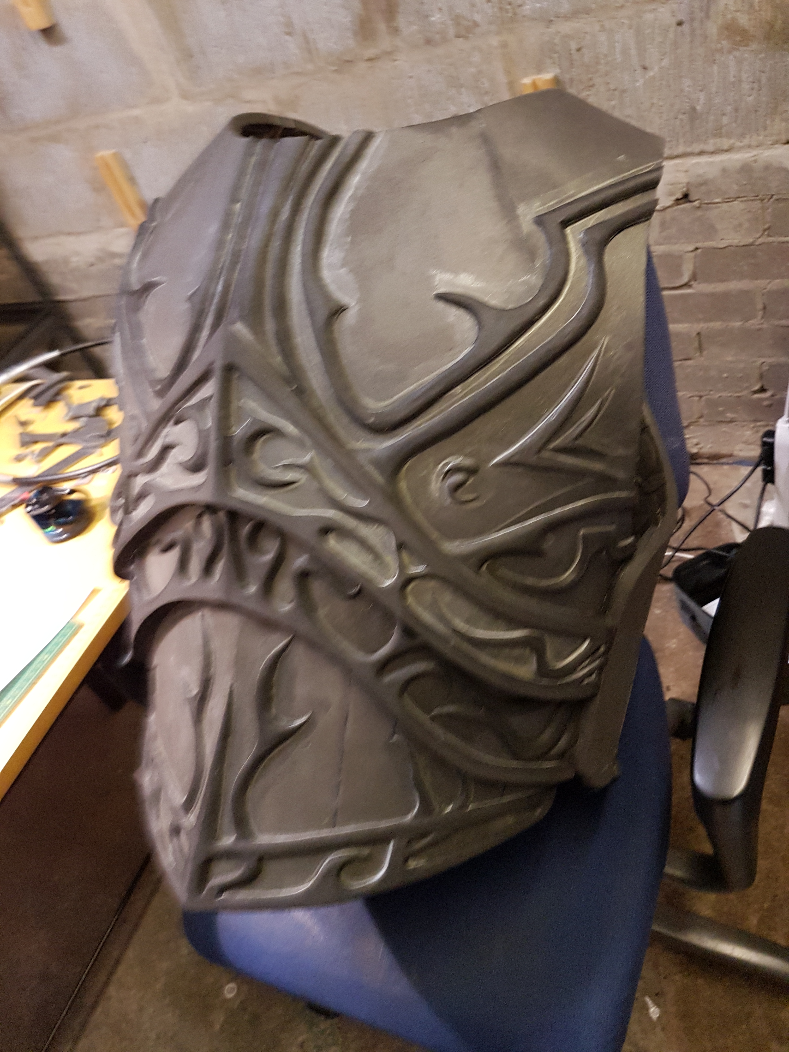

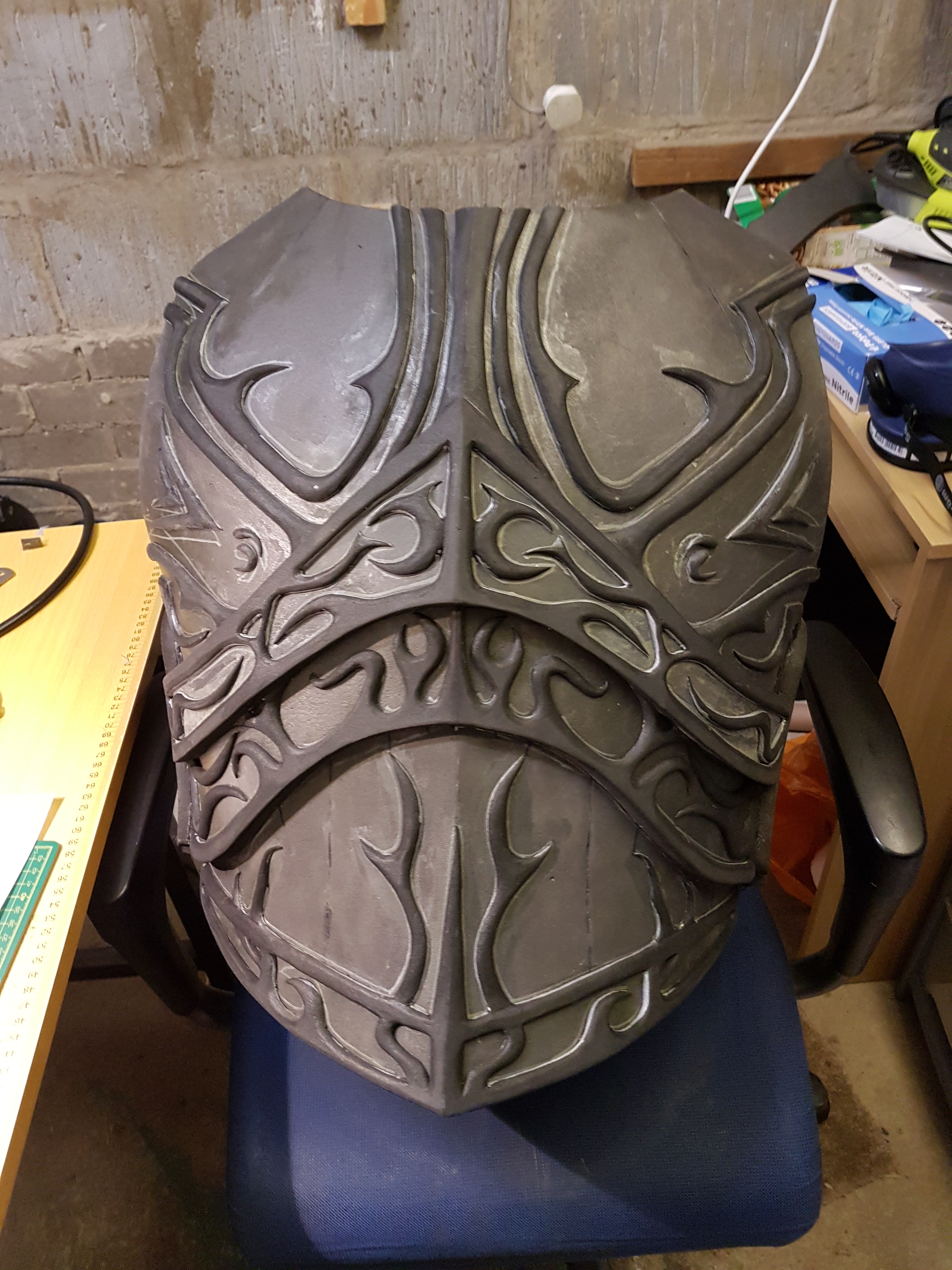

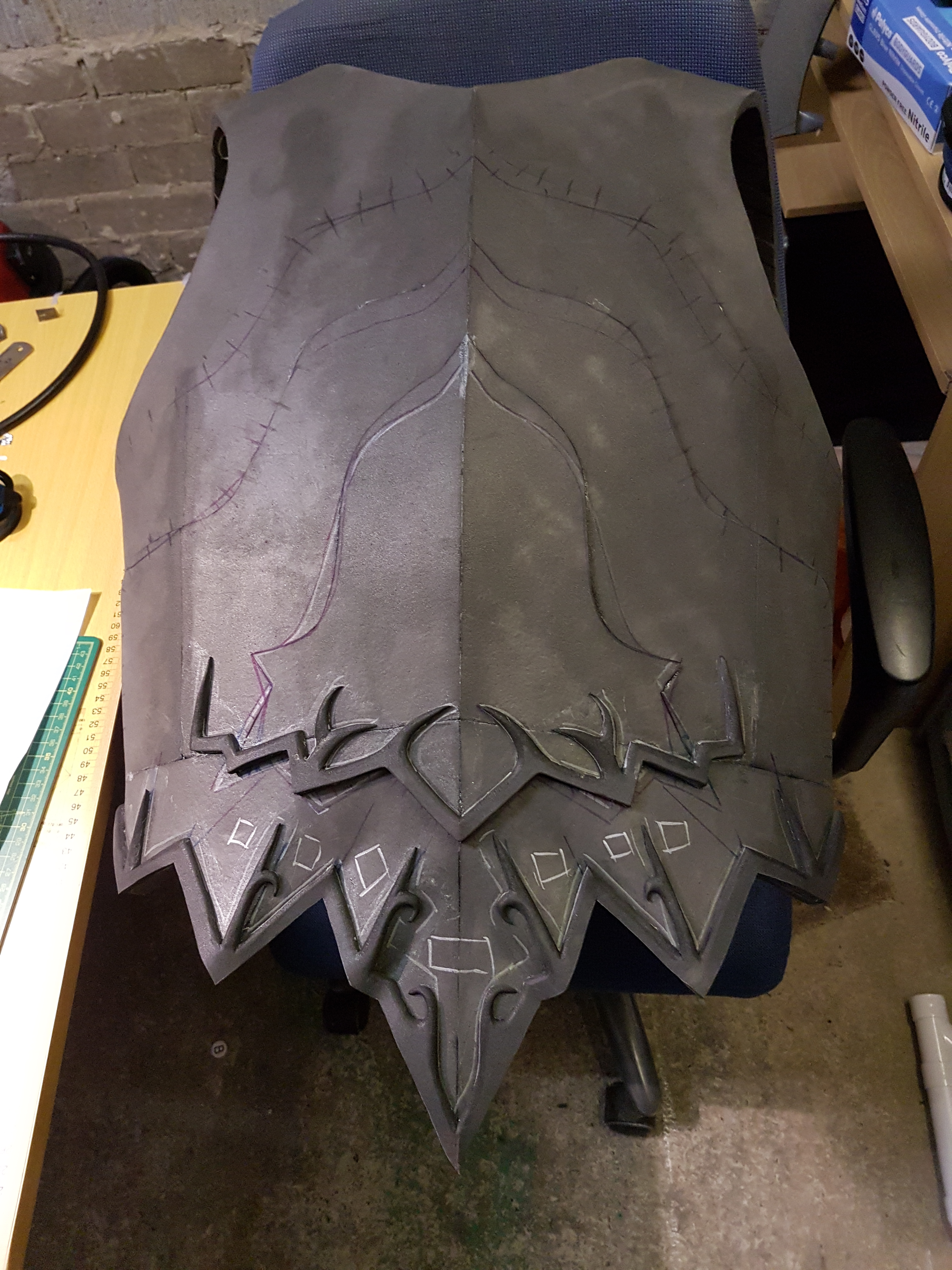

Ok. It's been a rather long time since my last update. This project is not dead though and I have been making a lot of progress still.
There's still plenty more to do as well. The biggest thing that I've achieved is to have essentially completed the chest piece. So, as it stands currently, this is what it looks like.
20171204_154218.jpg 20171204_154221.jpg 20171204_154230.jpg 20171204_154512.jpg
I'm not entirely happy with the little curls in the last photo so I may well redo them.
Other things that have kept going:
All the detail sections for the leg panels are sanded and need glued.
I've remade the thighs as the original ones were too thick.
I've made a good start on the shoulders.
I've essentially made the bicep sections.
I've started to draw up plans for the forearms and the spear.
