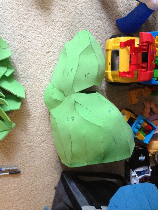

Since I have some experience building foam costumes I thought Bowser would be a perfect choice. I started off with the model from Smash Brothers and then modified it so it would fit a human proportions. From there I unwrapped all the pieces in Pepakura and printed them off to trace onto the foam.
Having an almost 2 year old at home meant there was little time to work on the costume so I could only work on it after we got him down to sleep so for 3 months I spent a few hours a night before going to bed cutting and gluing pieces. I chose to use EVA foam for the majority of the pieces, the only thing that wasn't foam was the back. I wound up using cardboard for the shell, initially because I had run out of foam and didn't want to buy another roll, but I think it actually works better with a hard shell instead of a squishy foam one.
The last 2 weeks was a real race to the finish. I was up until 2am almost every night trying to get all the pieces finished. I coated all the pieces with a layer of white glue to seal the foam. Then I used an elastomeric paint to build up a skin. I wanted to use latex but it was too cost prohibitive to coat the entire costume. The elastomeric paint provided a good alternative. It goes on really thick and has a lot of flexibility. I used regular interior house paint for the colors and airbrushed in the final details. For the shell I used wood filler along all the seams to try to mask the corrugated edges of the cardboard.

Here are some build pictures:
