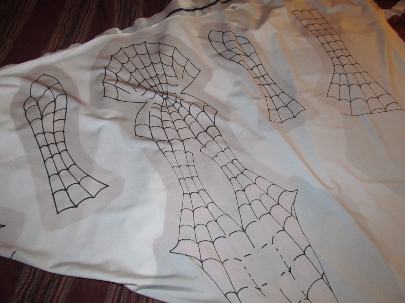

I then went about coloring the webs with Pigma Micron marker pens (point size “08”). It took six full pens (plus part of a seventh) and the better part of a month to complete - partially due to my own scheduling/skipping days due to other commitments, as well as choosing only to work on a small part of the suit per day. The fact that lunaman was able to color his entire suit over the span of 10 hours is impressive to say the least!
I used a piece of cardboard to lean on as I colored in the webbing. This was what it looked like after finishing.
The coloring really is worth it to make the web lines more prominent and stand out. The only part I did not color was the chest spider, which I left untouched, but may still color at some point. As you can see below, the archival ink goes right through to the other side of the lycra.

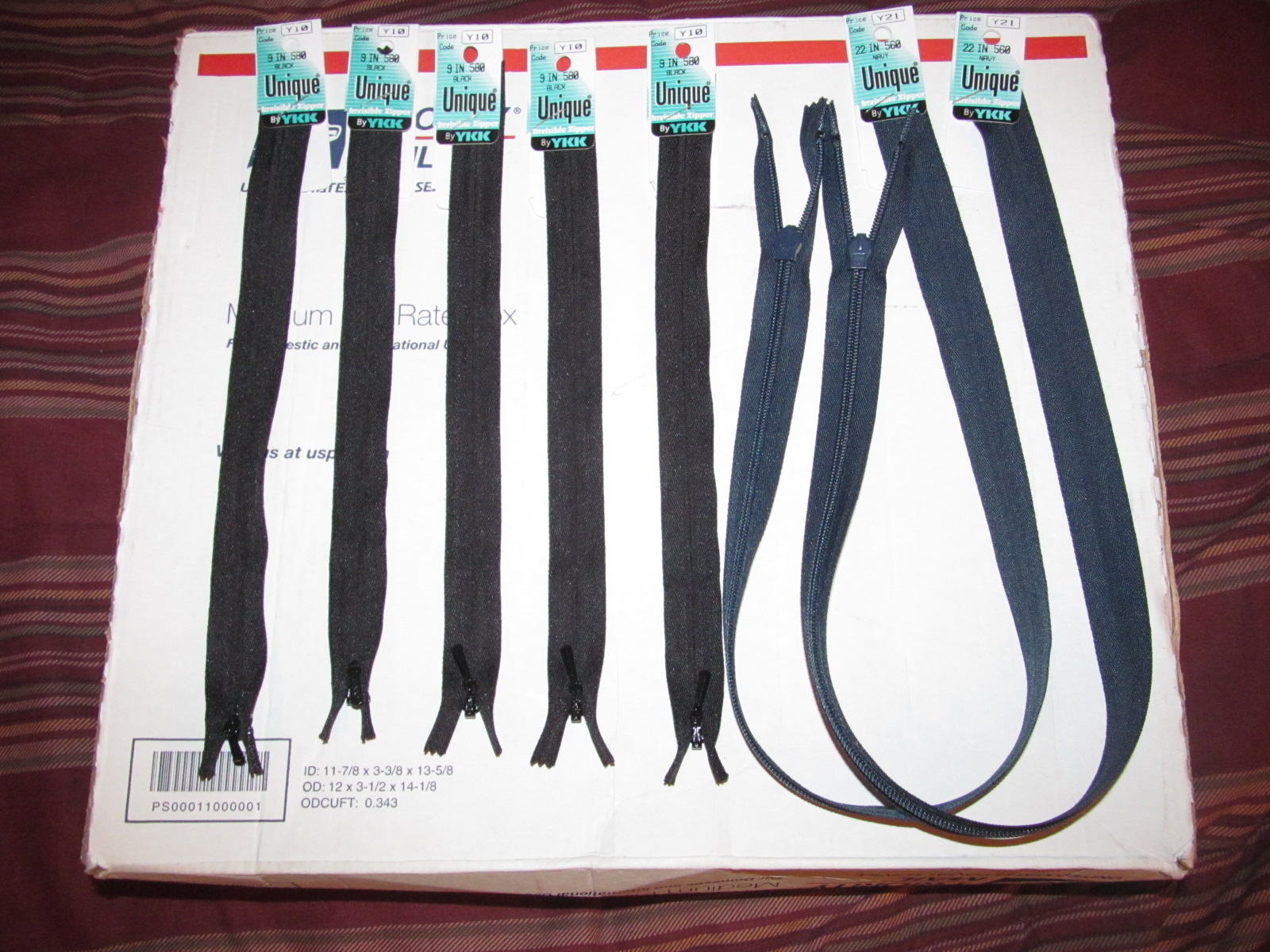

I provided the invisible zips and thread (three rolls of Gutermann black):

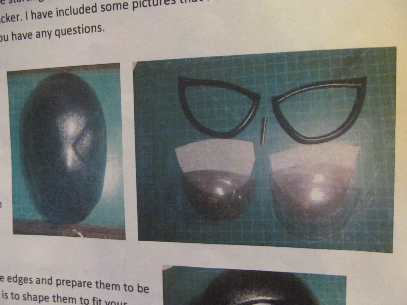

Next came the eyes. I got an ASM2 faceshell and lenses combo set from TJack. I originally wanted to go with the Steve Ditko-style lens minus the faceshell, but decided the combo would be a better investment. Plus, the ASM2 lenses are probably the closest to resemble Sal Buscema’s Spider-Man, the first artist who I grew up with reading the books. Here's how they look unassembled:
I’ll admit: the eyes were the toughest part of all, especially clearing all of the holes of material in the white mesh. Every time I thought I was done, I held the mesh up to the light only to see that I had barely made much progress! Tedious, but again, worth it. I used a pin to poke the necessary holes in the mesh.
To shape the frames to fit my shell, I heated them on a cookie baking pan over the stove with tin foil underneath. I found this did the trick over boiling them in water, but be careful - I definitely noticed the back of one my frames beginning to melt a bit from leaving it on there too long. No photos of these moments unfortunately.

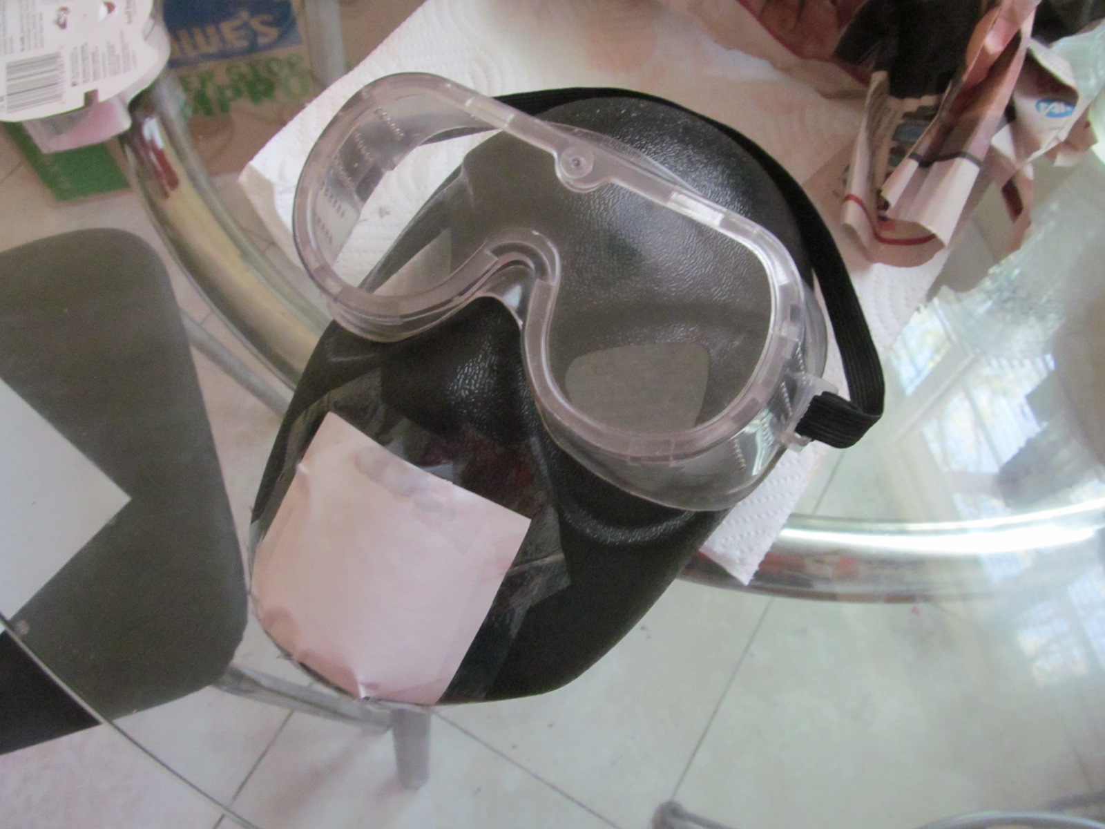

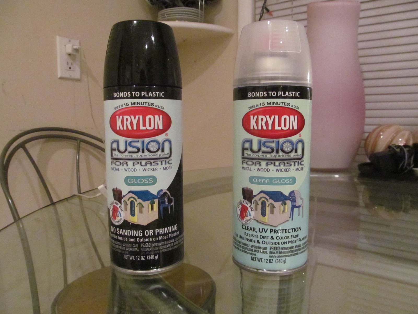

After shaping the frames, I spray painted them with Krylon Fusion Gloss Black spray paint, following by a few light coats of Krylon Clear Gloss spray paint.
I used the faceshell, some paper, and a pair of safety goggles as a makeshift mask to protect my face during the painting process. It wasn’t a perfect shield from the paint smell, but it helped. I’d recommend getting a legitimate mask if you can afford one.

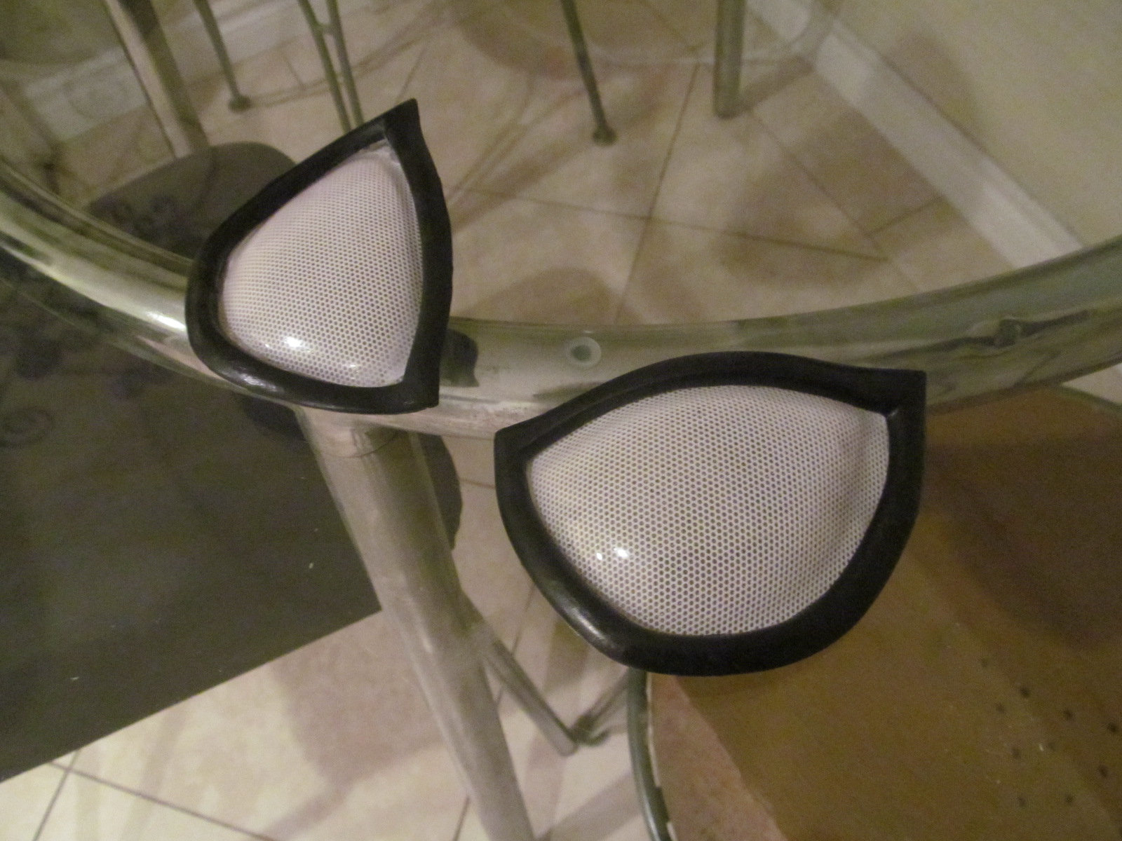

Finally, I began gluing the lenses and frames. It took a bit of time to line everything up properly. Once I was satisfied, I used cyanoacrylate glue to put it all together.
It definitely takes patience and can get messy - I was cleaning glue from my hands for days after finishing these. The final results:
