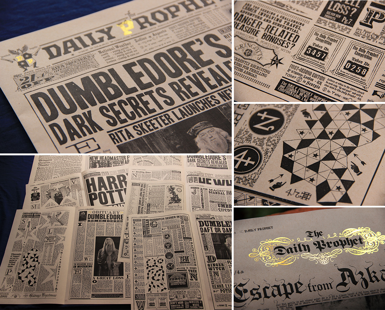

These are my replicas of the Daily Prophet.
Printed on recycled paper, and with gold foil applied.
All pages where made in Illustrator and Photoshop.

Thanks my friend! I forgot to say the size of them! :D
They were printed on A3 sheets, on both sides. Then, I bind 2 sheets together to form folios,and crop a bit... So the final, open, size is almost an A2, don't know if this is the full size...
These were printed on a laser printer (toner), don't know the model,but the ink have a matte finish, really pretty :3

May i ask what process you used to apply the gold foil? Did you get a full foil block made or have you found an interesting method of producing short run foil? Apologies if this is a trade secret, i'm just curious.

Thanks Krats! Not a secret at all!
I don't know if this is the best method, but it worked for me:
I print all in black a laser printer.
I use a clothes iron (cotton temperature) to apply the foil.. don't have a laminator...
I cut small pieces of foil and carefully pass just the tip of the iron for small details. sometimes I use a "greaseproof paper" on bottom so the toner on the back doesn't glue on the floor.. and on the top, so the heat isn't too direct. pretty handwork
I also use some extra paper pieces to protect some parts from the foil..
For the gold "P" on some editions I actually used something like this picture:
Then I apply the foil and draw a little line on it, with nankin so it looks like this:
Don't have pictures of the whole process, but next time I'll try to take some,
Hope I helped!
