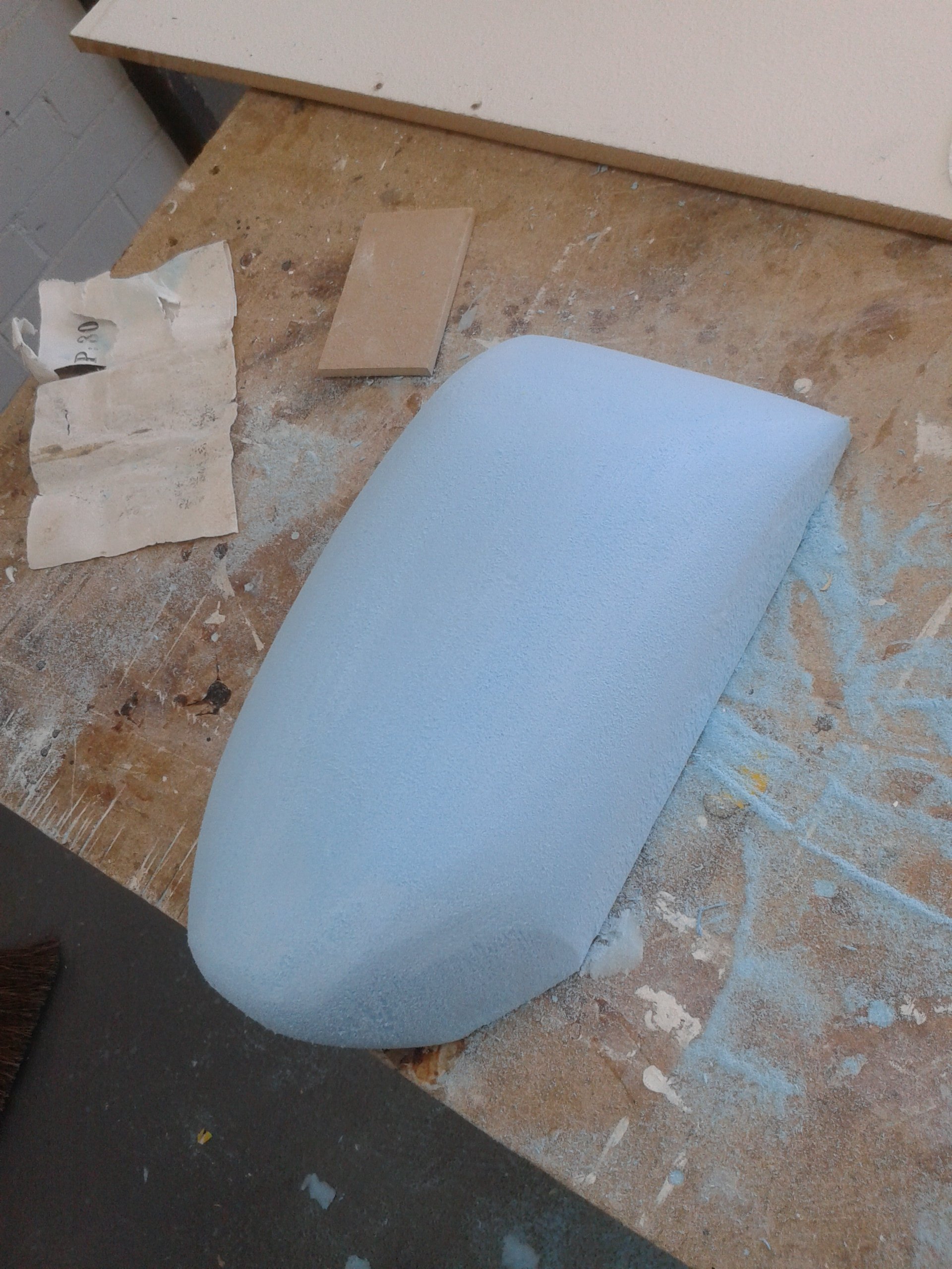

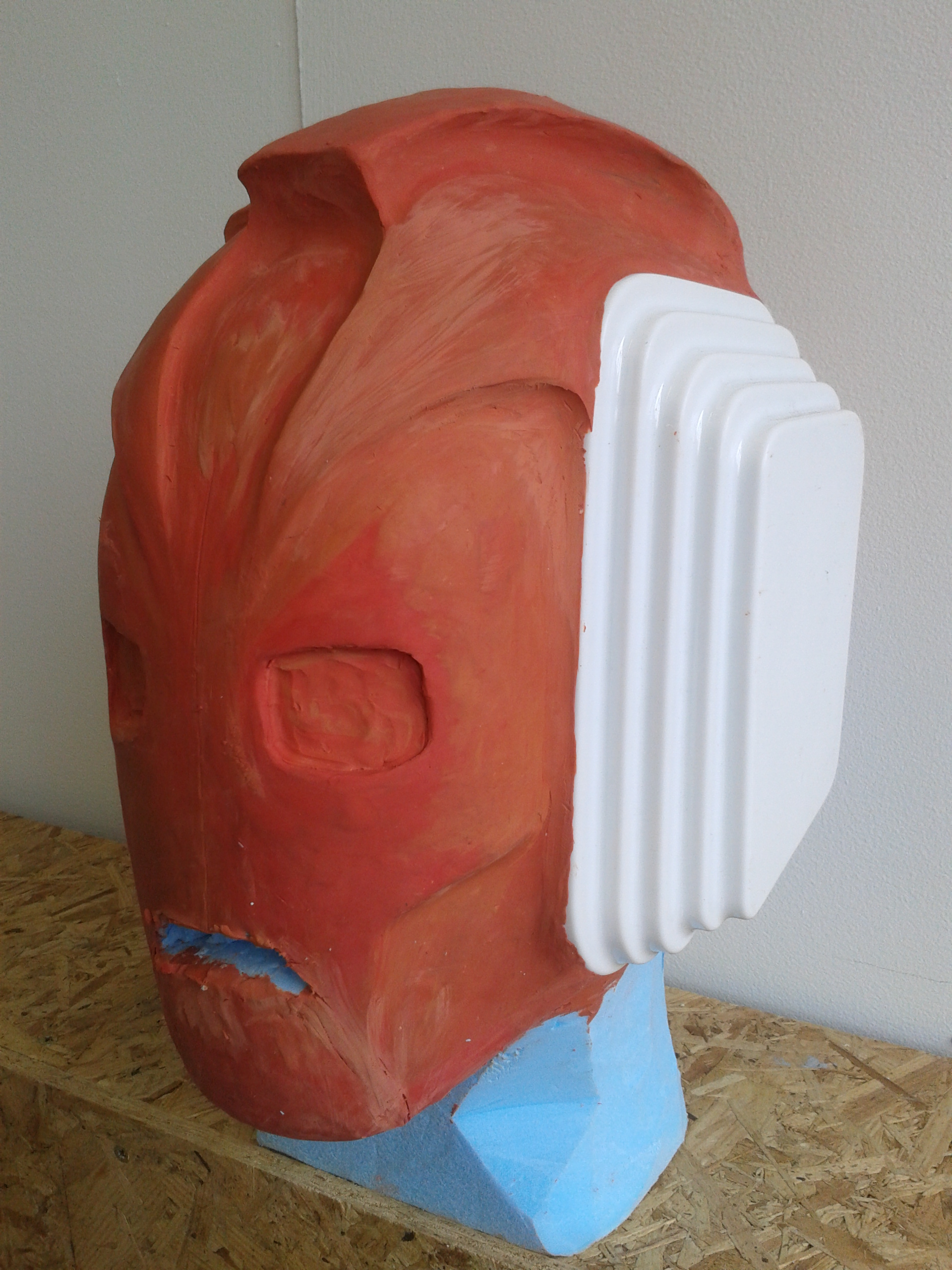

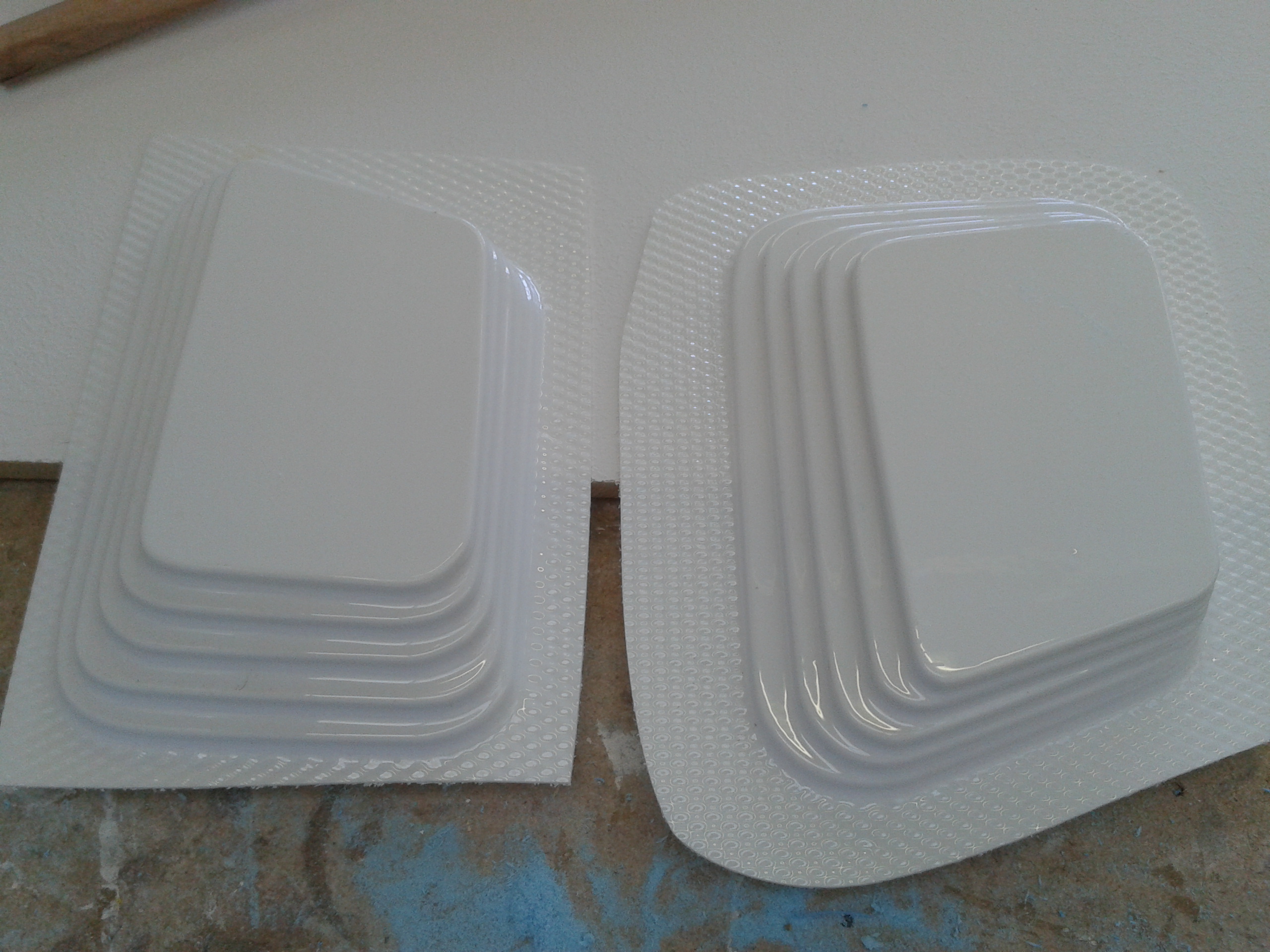

I started with the ear muffs. Vac formed in plastic. I made MDF blocks that stacked together. All I had to do to made the opposite side was to flip them over and do another draw.

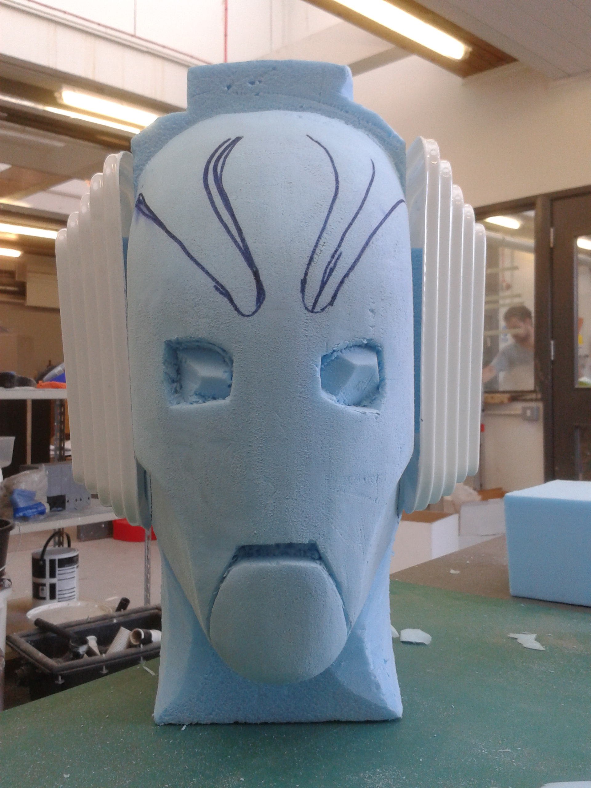

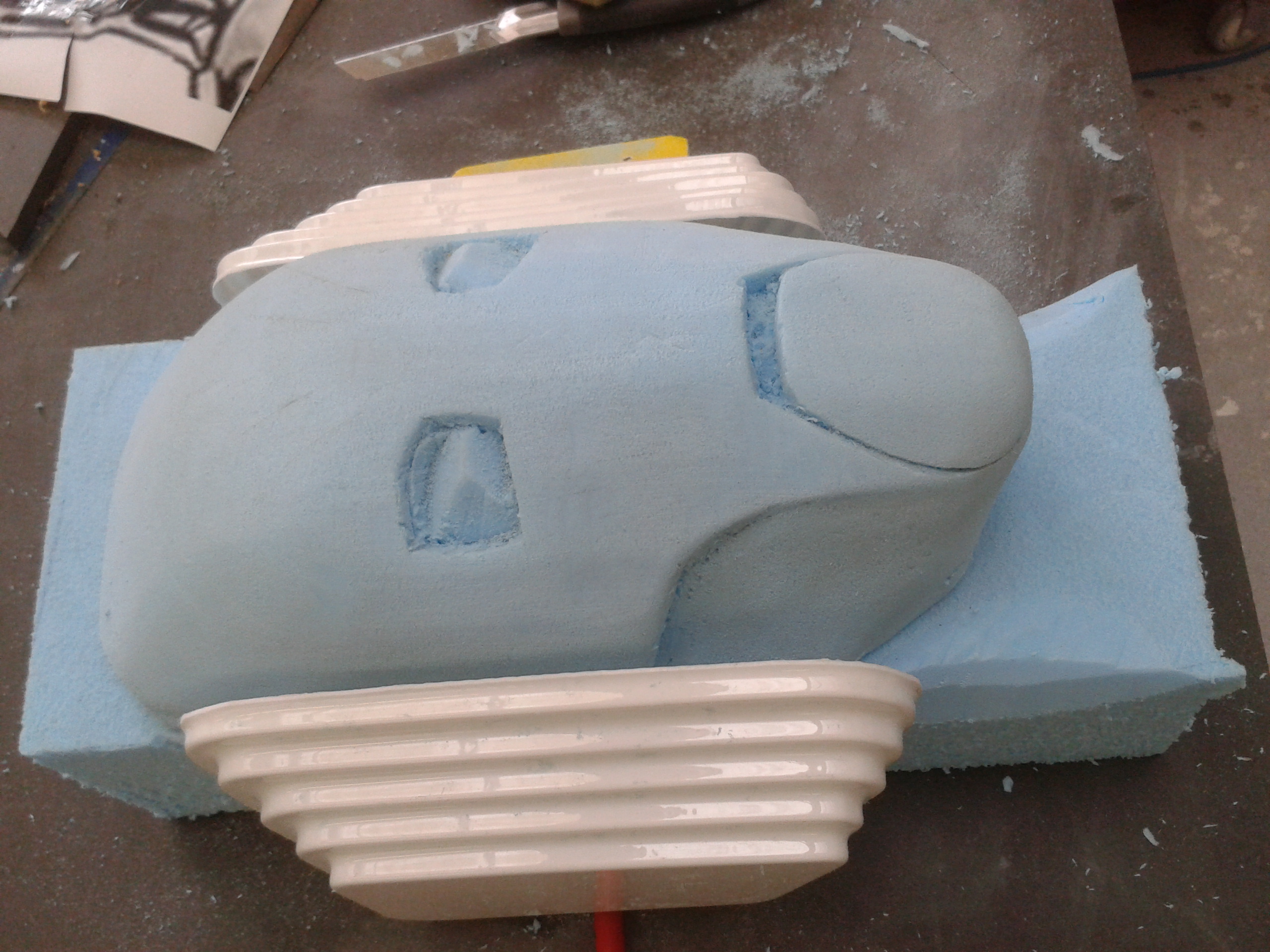

I'm using a blue styrene which I've never used before, but it is coming up with great results. 2013-08-02 12.19.10.jpg 2013-08-02 12.20.15.jpg I will see if it will take resin, a bit like surf board poly does? Anyone have any ideas?

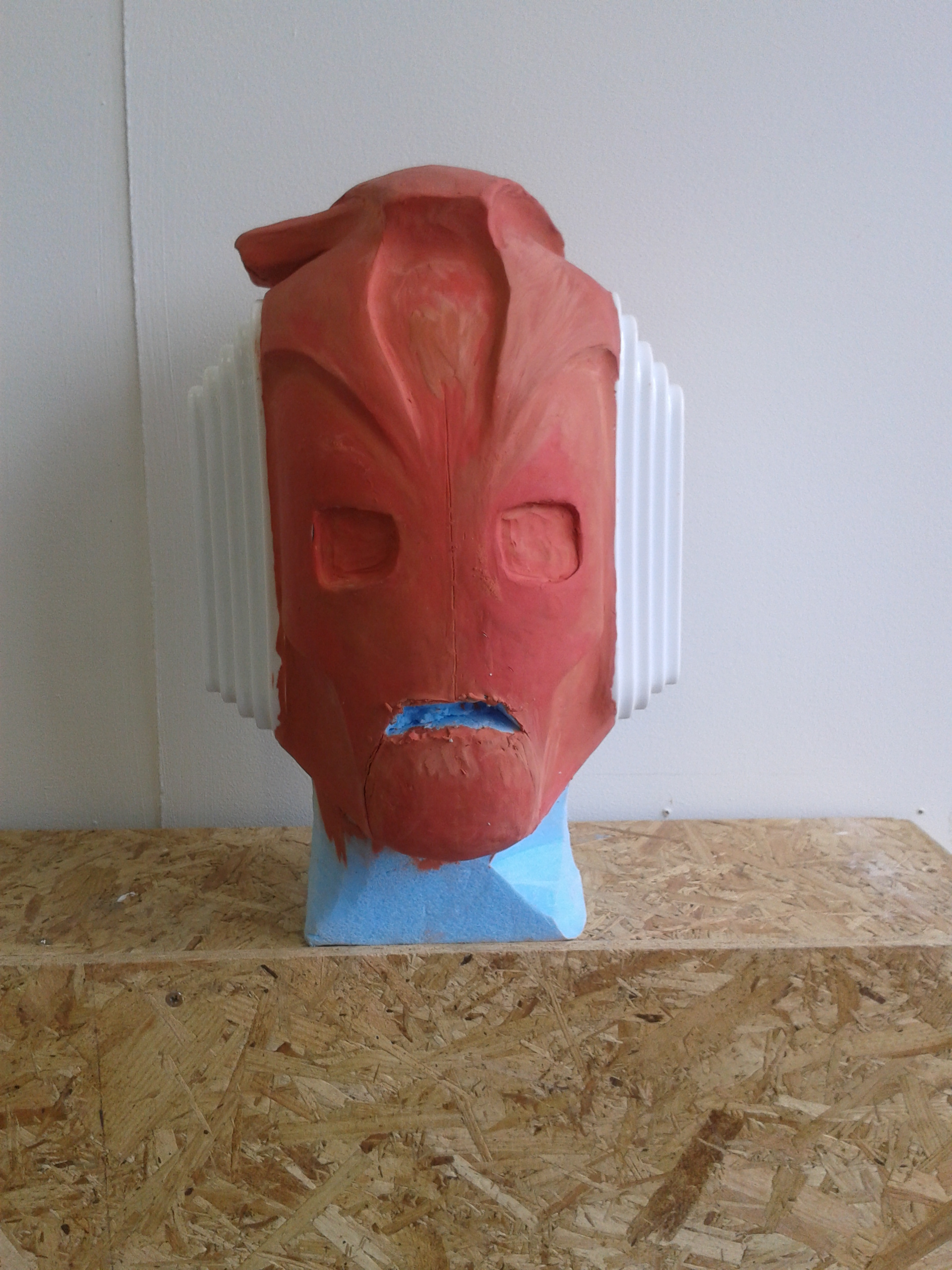

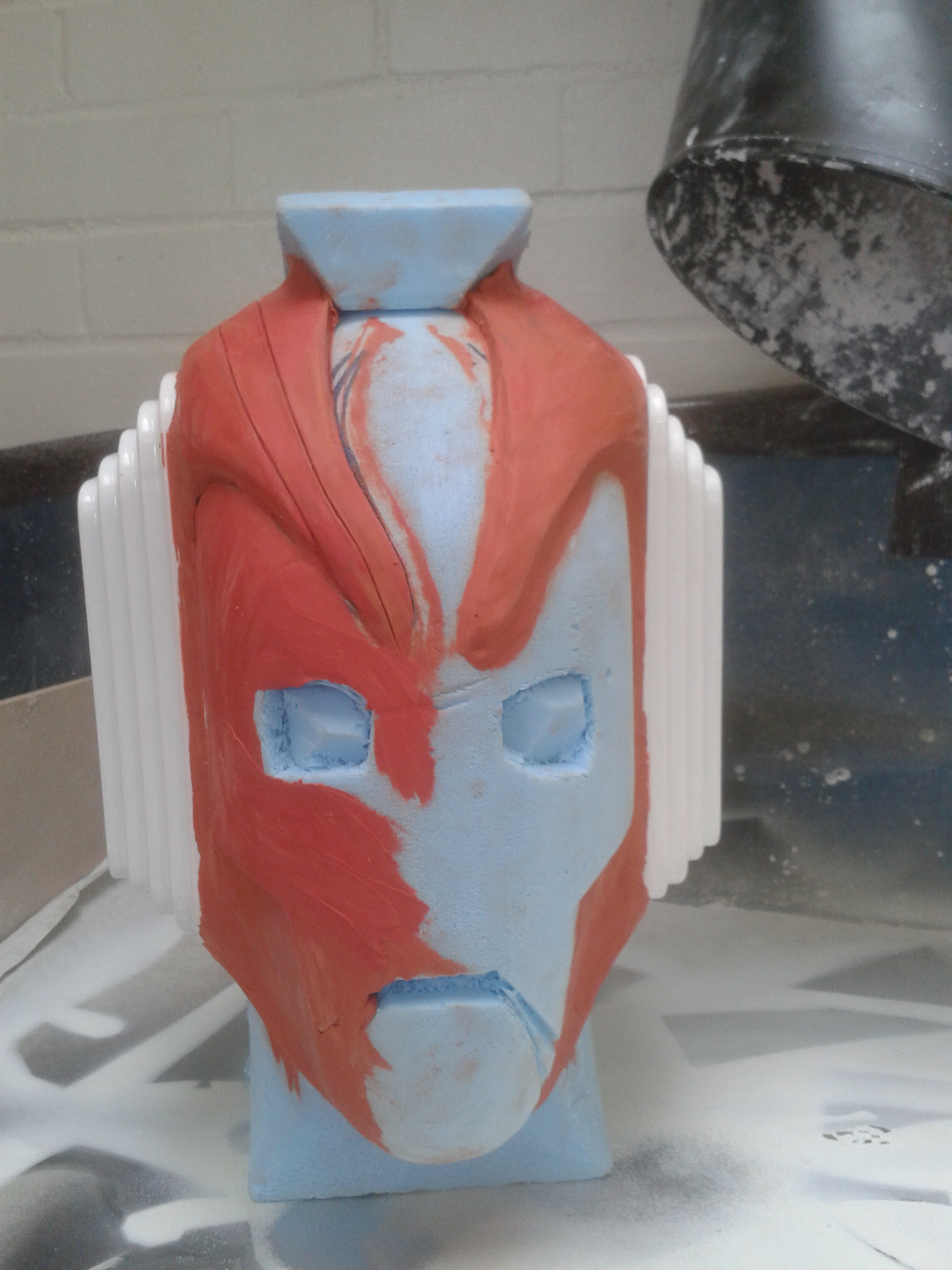

Although the blue poly is great to start with, adding detail is problematic, so I have reverted to the old tried and trusted clay. The good news is that the blue poly accepts the clay really well. Now I can build upon what I already have and start with the finer details.

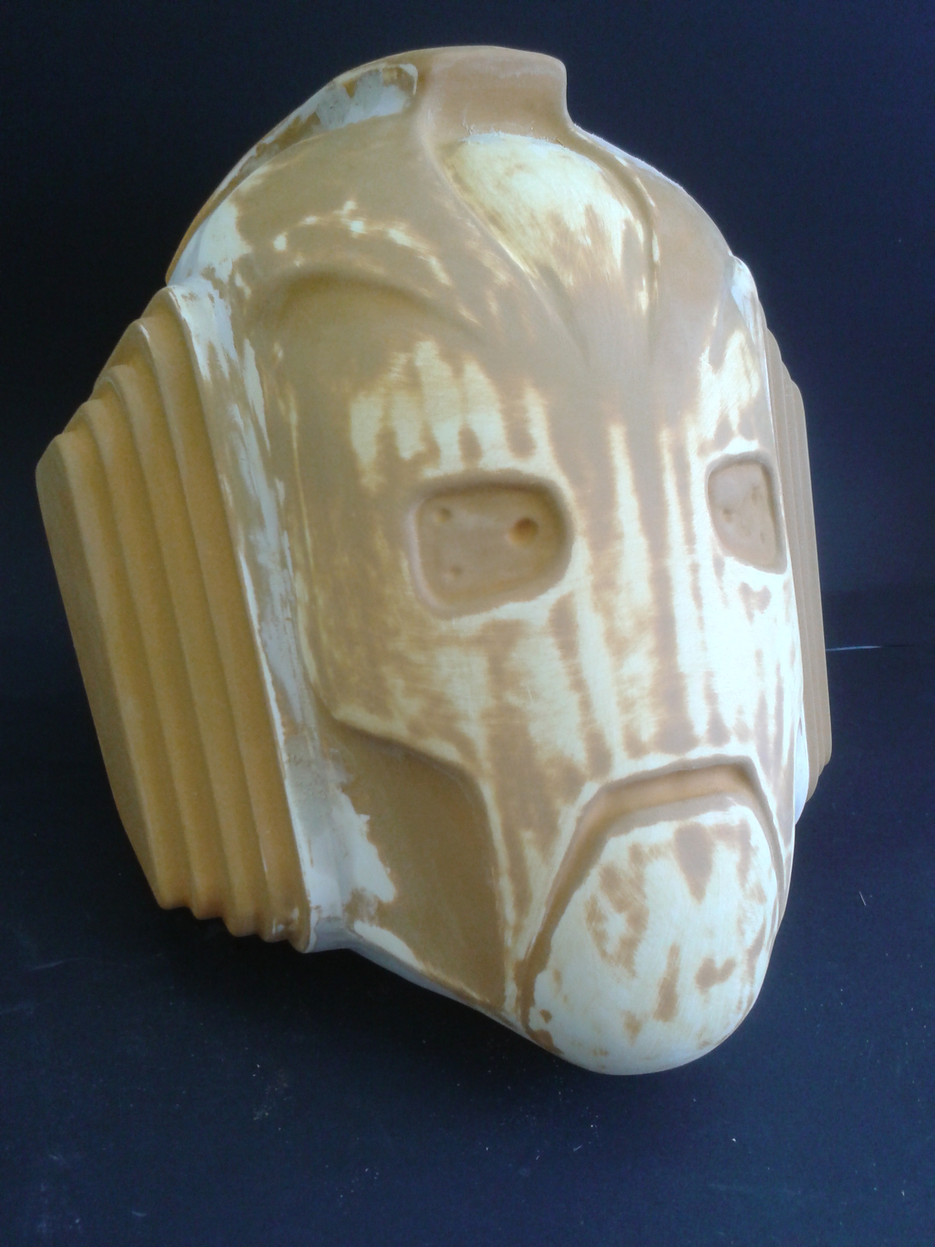

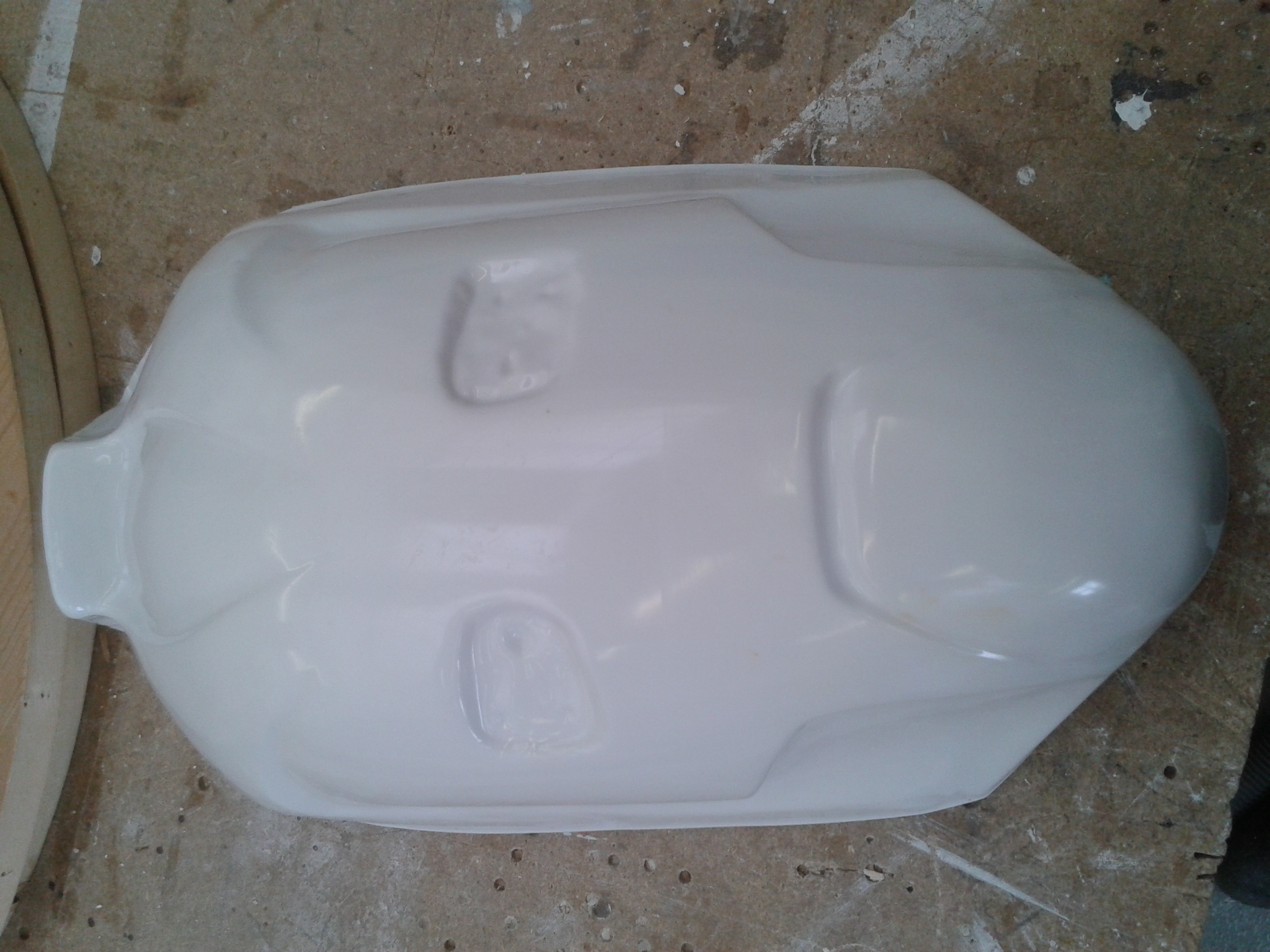

Here's me jumping the gun again. I moulded the front part of the face and made a plaster positive. 2013-09-13 12.03.19.jpg
I sanded the plaster down and am now trying to get out all the lumps and bumps. Working with the plaster is much easier than trying to get the newclay smooth. My plan is to mould all the parts seperately and vac form a helmet. And here's where I jumped the gun.
Ta daa... Yes I vac formed the head just to see what it would look like. It still needs some smoothing and filling etc but I'me really pleased with the result.

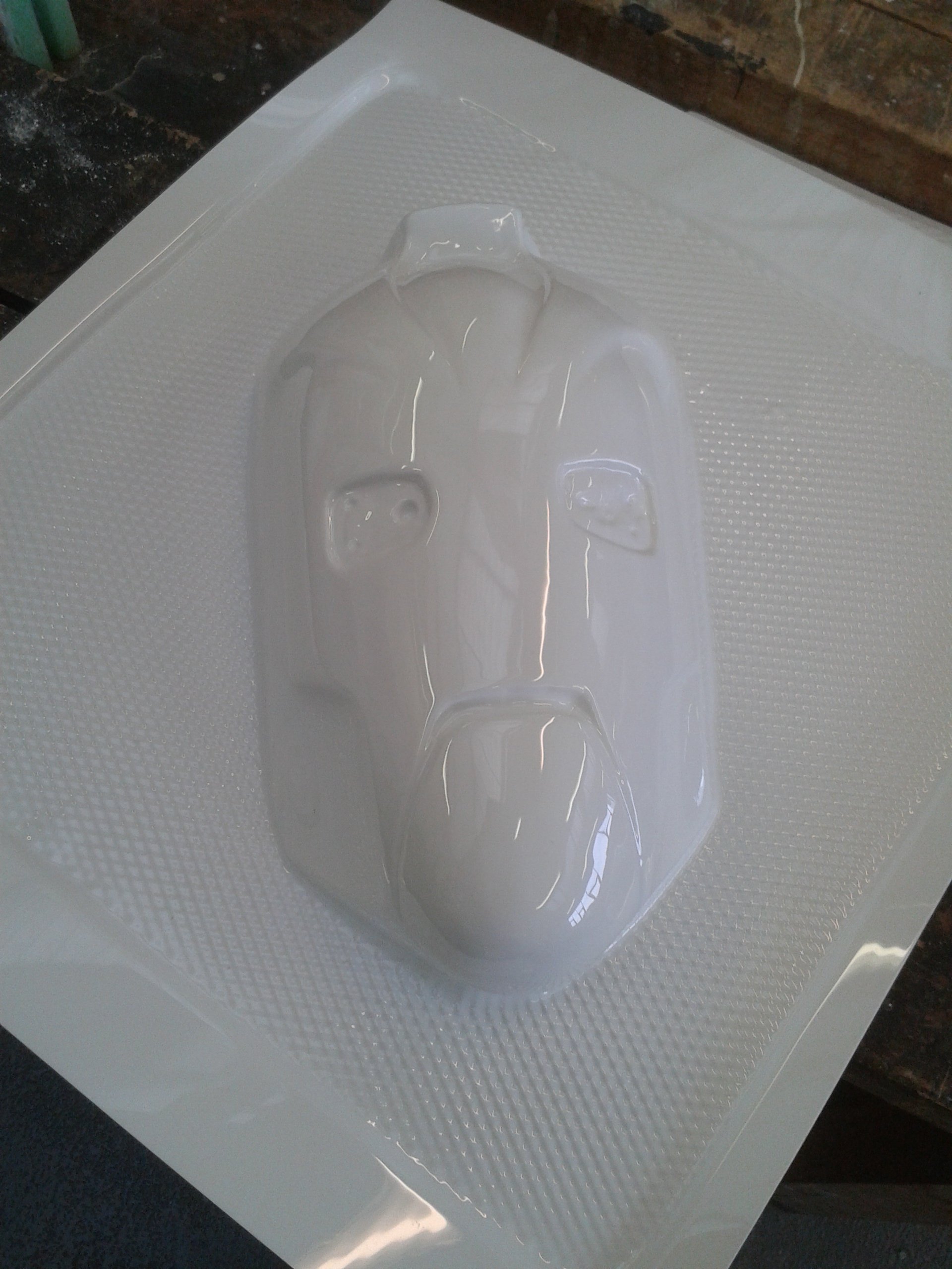

I've pulled some vac formed plastic shells of the mask.
It's so nice to see the plastic form around the plaster positive and give you a beautiful smooth and rounded finish. This one will be mirror smooth I hope when it is finished. I have to build my skills at plastering and vac forming so I can pull the plastic it two pieces (Or three) instead of what I have done.
The way I'm working there is still a bit of filling and sanding to be done where as I would love to be able to take a couples of pulls and just glue them together. It's quite quick though.
Tildane

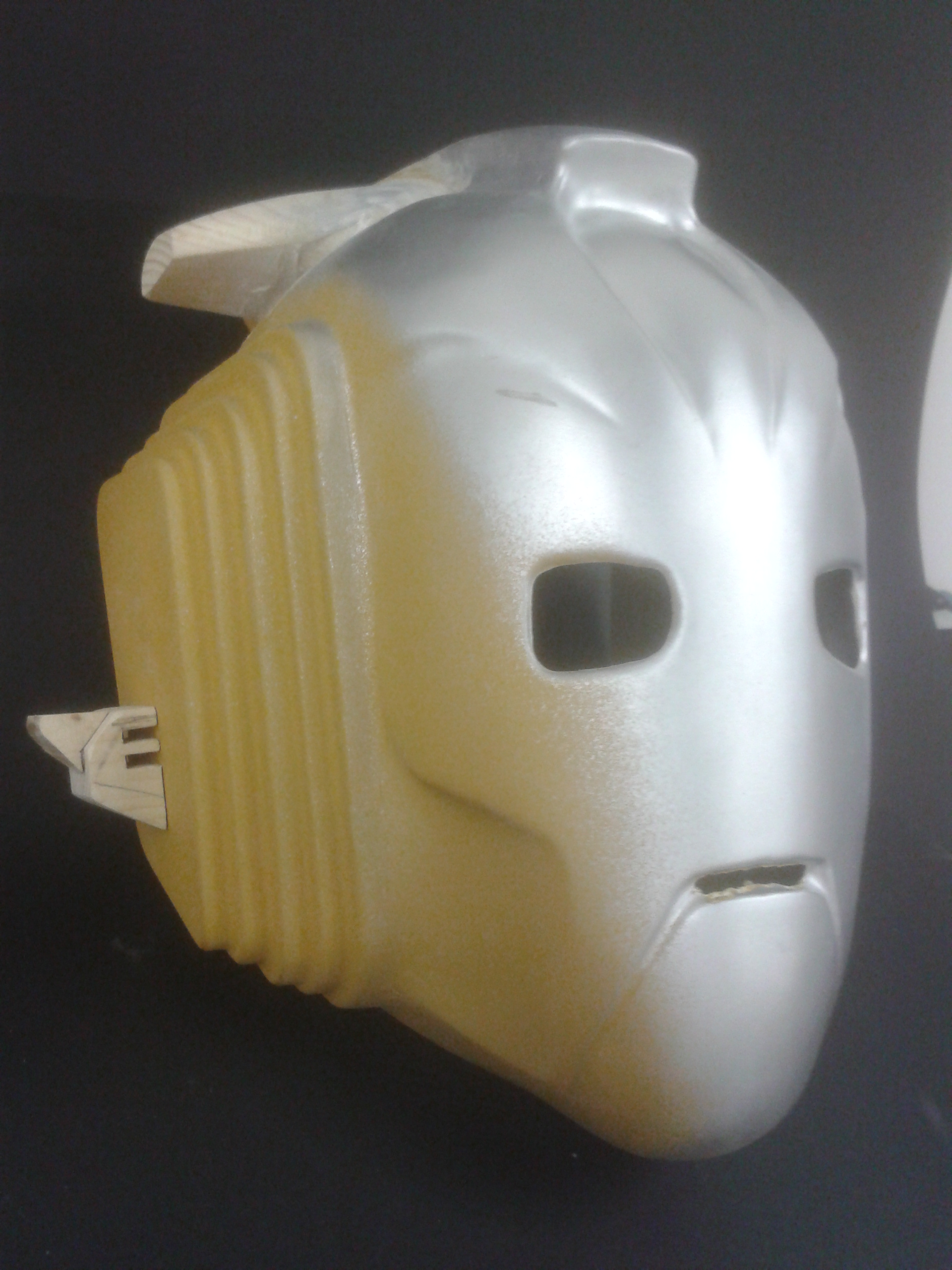

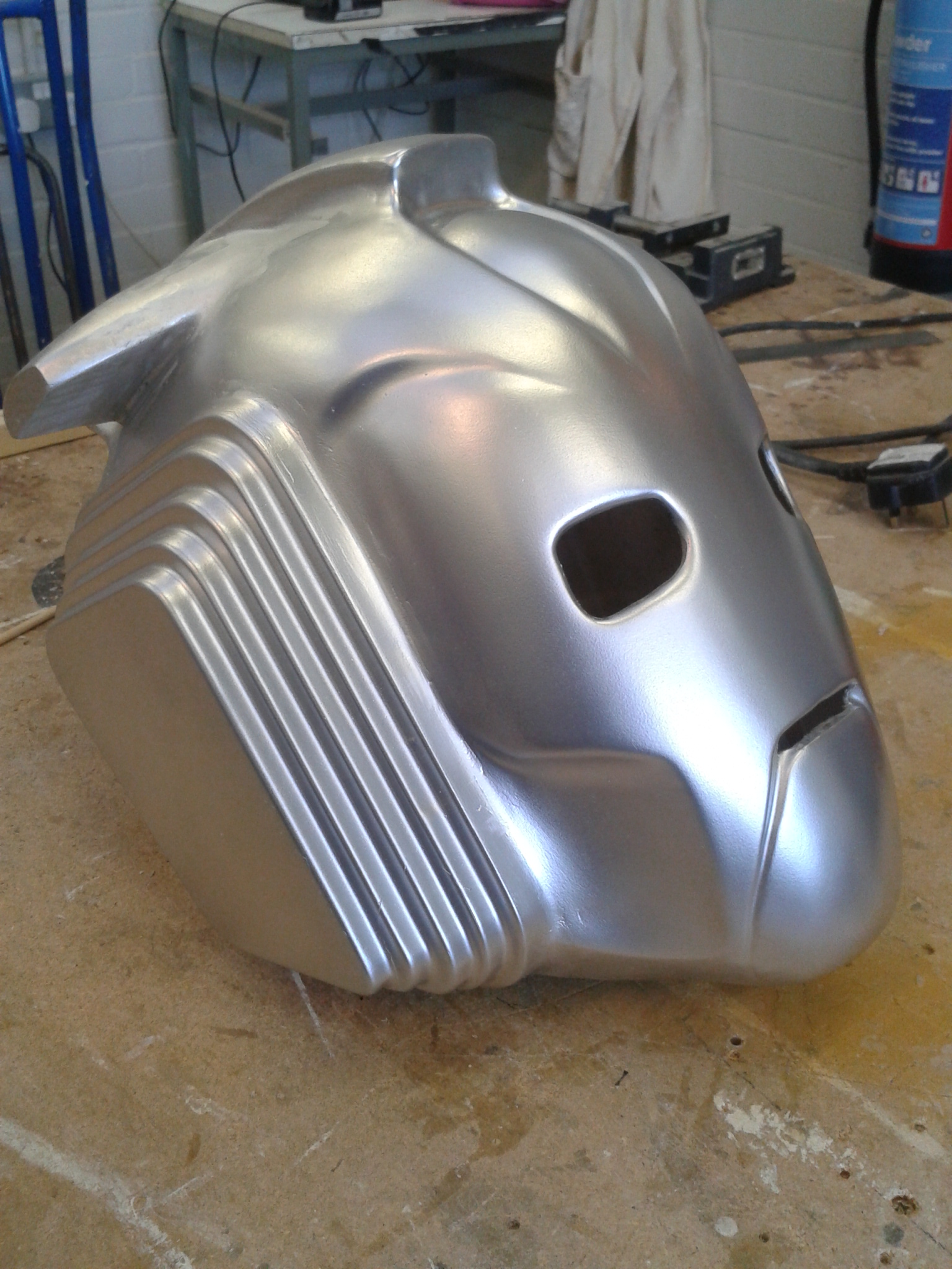

I've painted it in spray putty and filled the edges with car putty. I want this one to be as smooth as. I will also look into getting some of that "chrome" spray paint. Using the vac former has reduced the build time by about half so far. It could really only be used for certain designs.

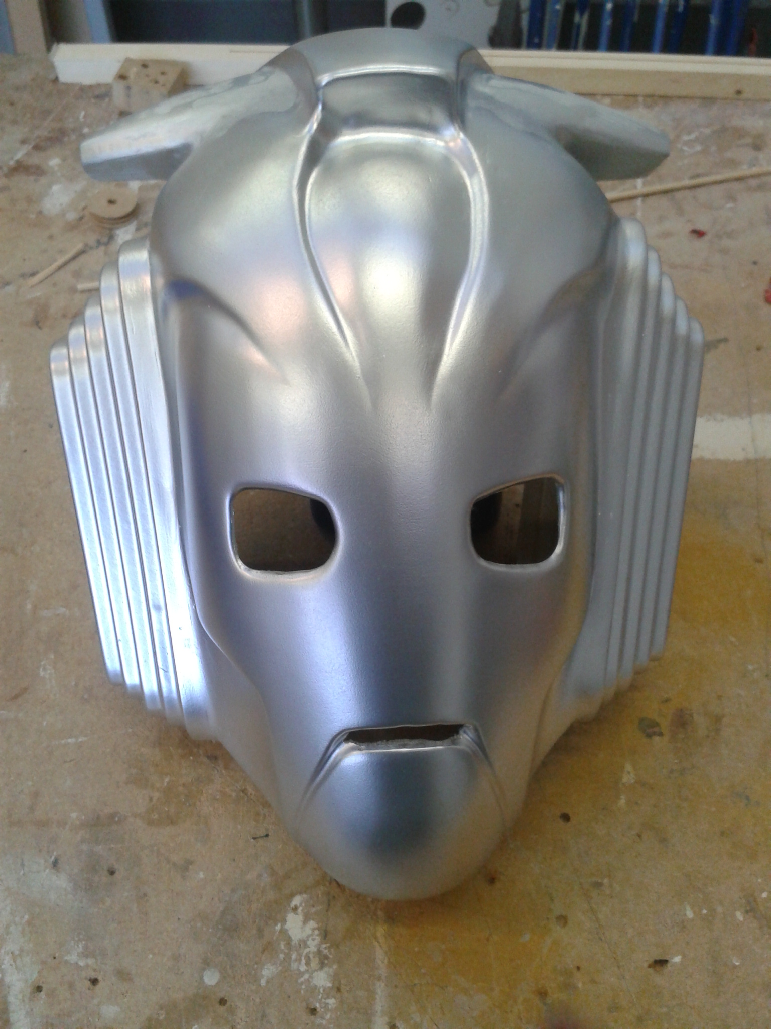

Coming along nicely. I've started adding some periferal features like the ear brackets. More sanding and painting. Currently looks to fat. Maybe to big, or I'm going to have to find a huge guy to wear it (That would be right for a Cyberman). I know a couple of giants... hmm
