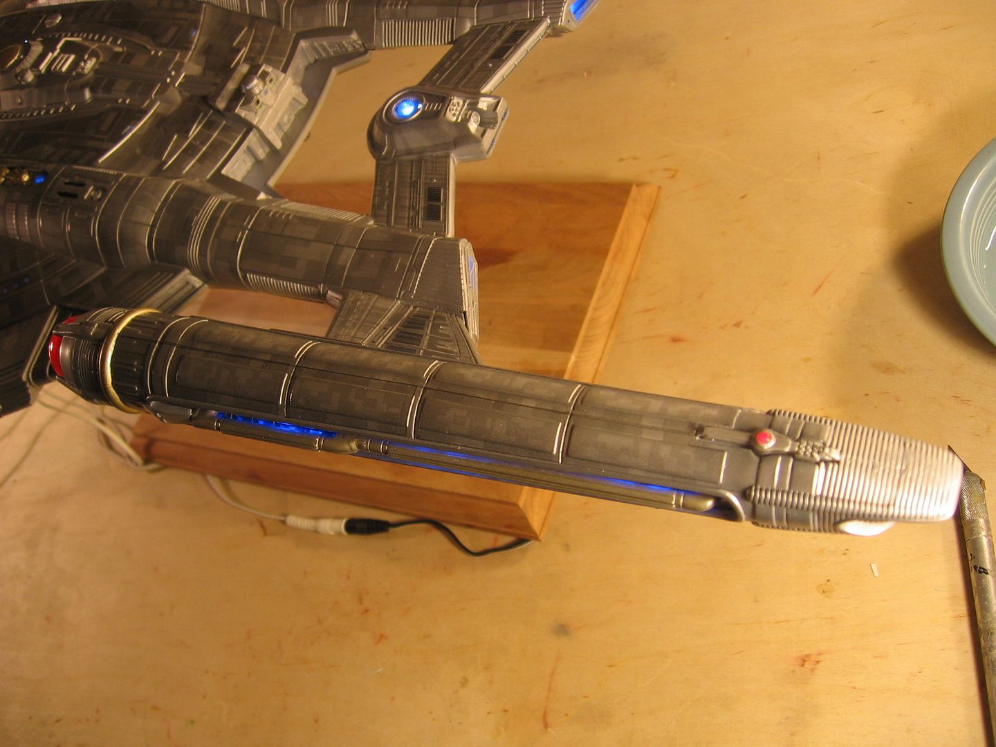

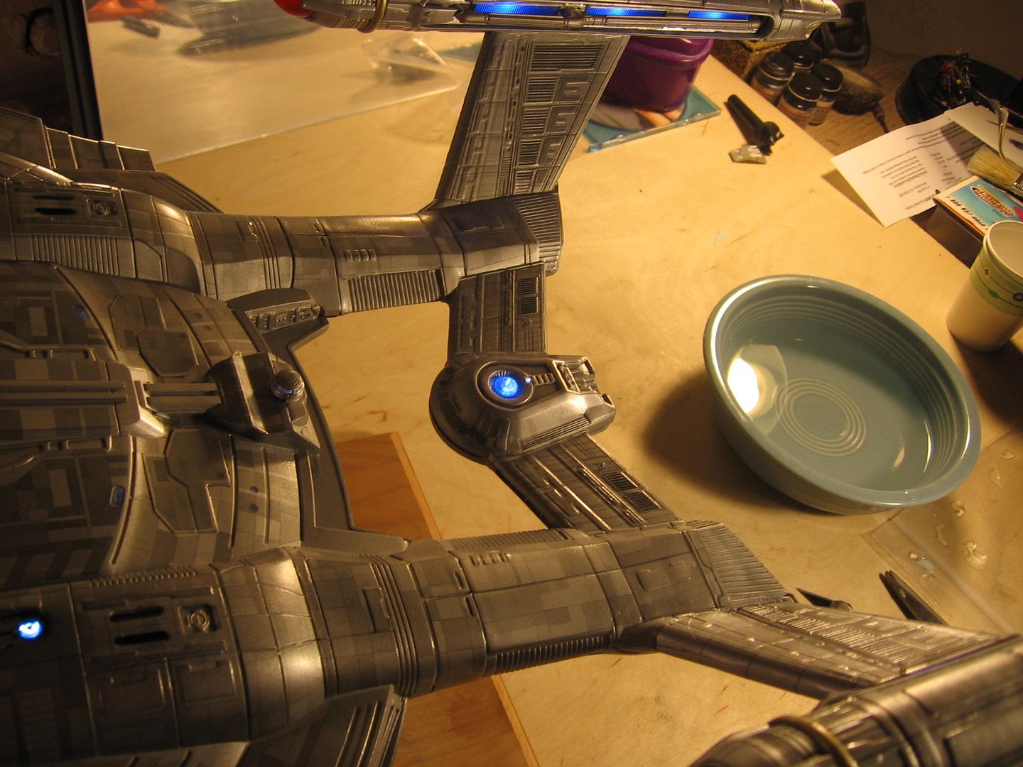

8 hours and this is what I have so far. Things sped up once I got past all that detail near the bridge and the 2 humps. I had to cut out and break up so many decals in to smaller ones or you will screw up. After awhile you start to see double and triple. So I had to stop when I got a few slightly off center and couldn't go back and correct them.
All and all I'm pleased and this bird gets a weathering job to boot once all these crazy decals are on.
This isn't a job for the faint hearted or short tempered. Several times decals broke on me and some rolled under. I had to remove them and put them back in the water and re capture to paper after getting the roll unders out again. And even then sometimes they do it again and I'd repeat the procedure.
The top of the saucer is nearly done and I should move on to the lower section next which doesn't look as hard. I thought this would take a couple of days. More like 5.

Lets see. 10 more hours today and I got everything on except the the lower half of the engineering hull on and the saucer bottom. With any luck I'll have that all done tomorrow around this time.
Clear on Saturday. Sunday the decals that came with the kit. More clear on Monday. A bit of touch up paint here and there and done. I think.
