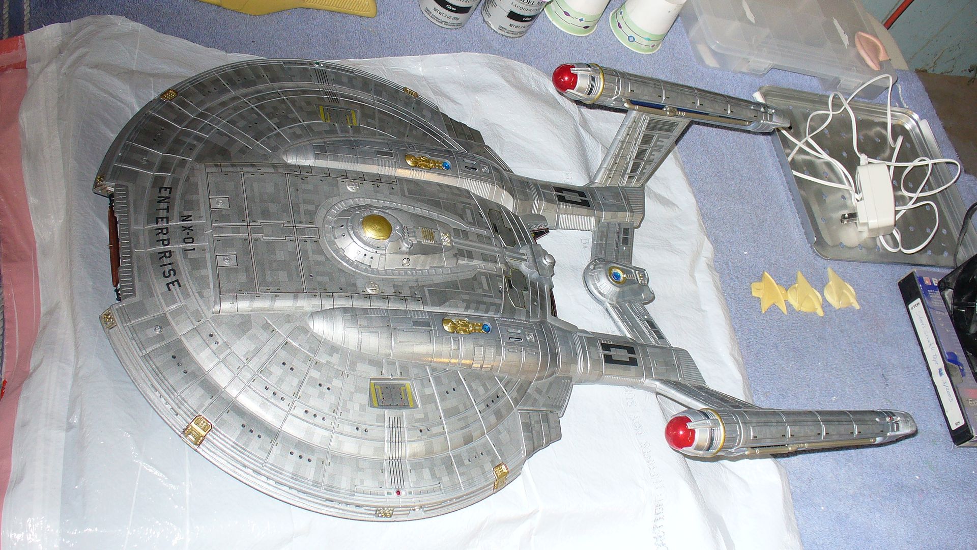

She's in the paint shop again and a clear coat applied to the top side. Later today I'll get the under side and we let her sit for 24 hours.
Steve
If you look close you can see some of the hundreds of small little decals.

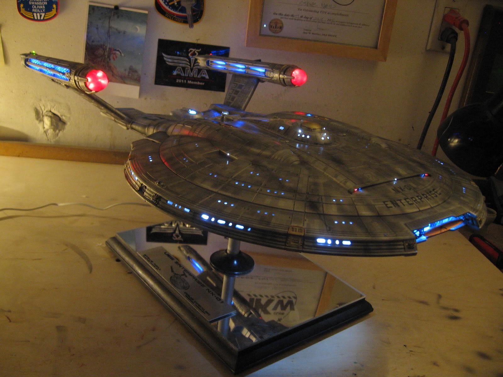

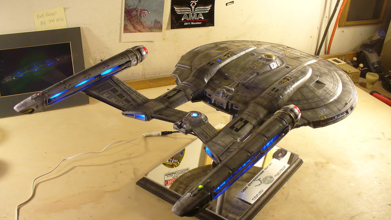

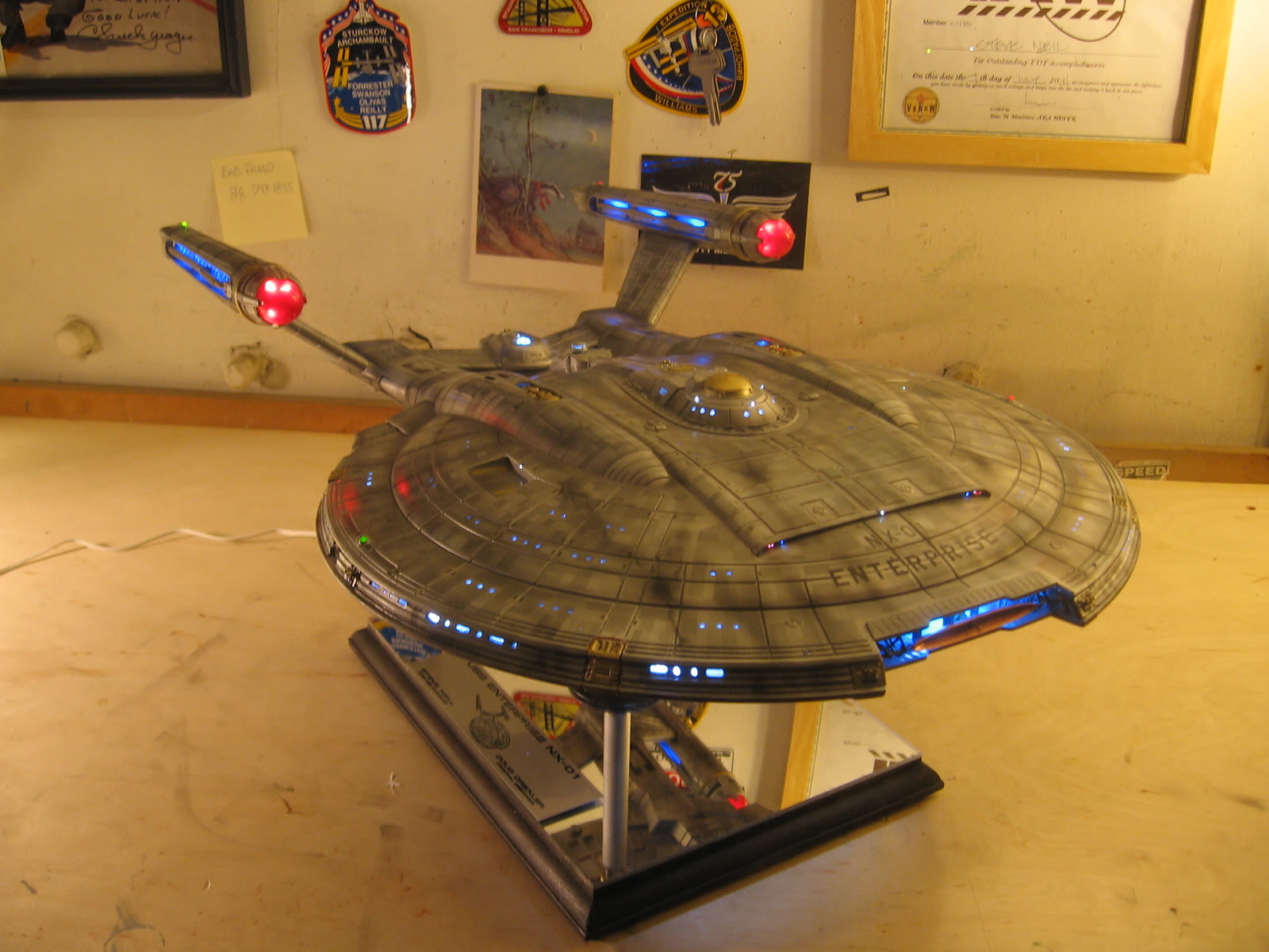

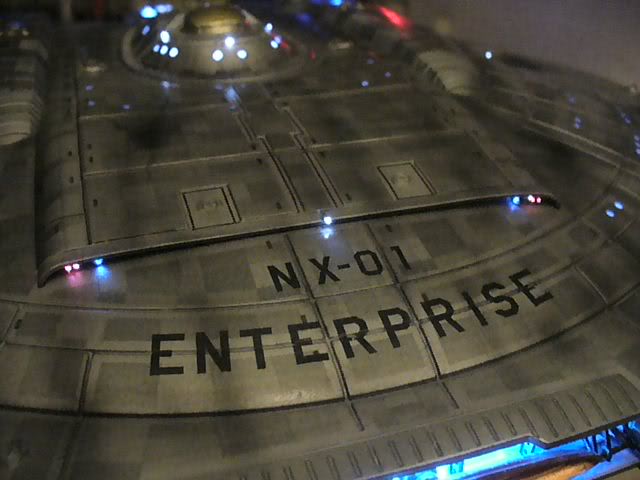

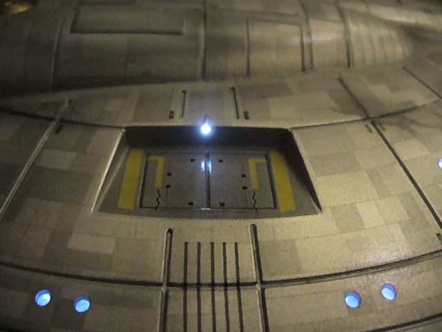

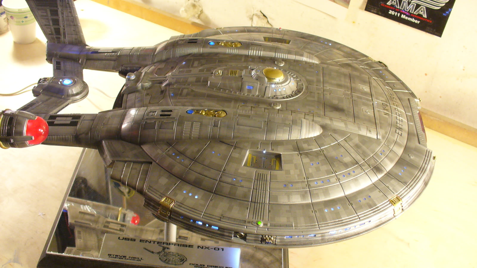

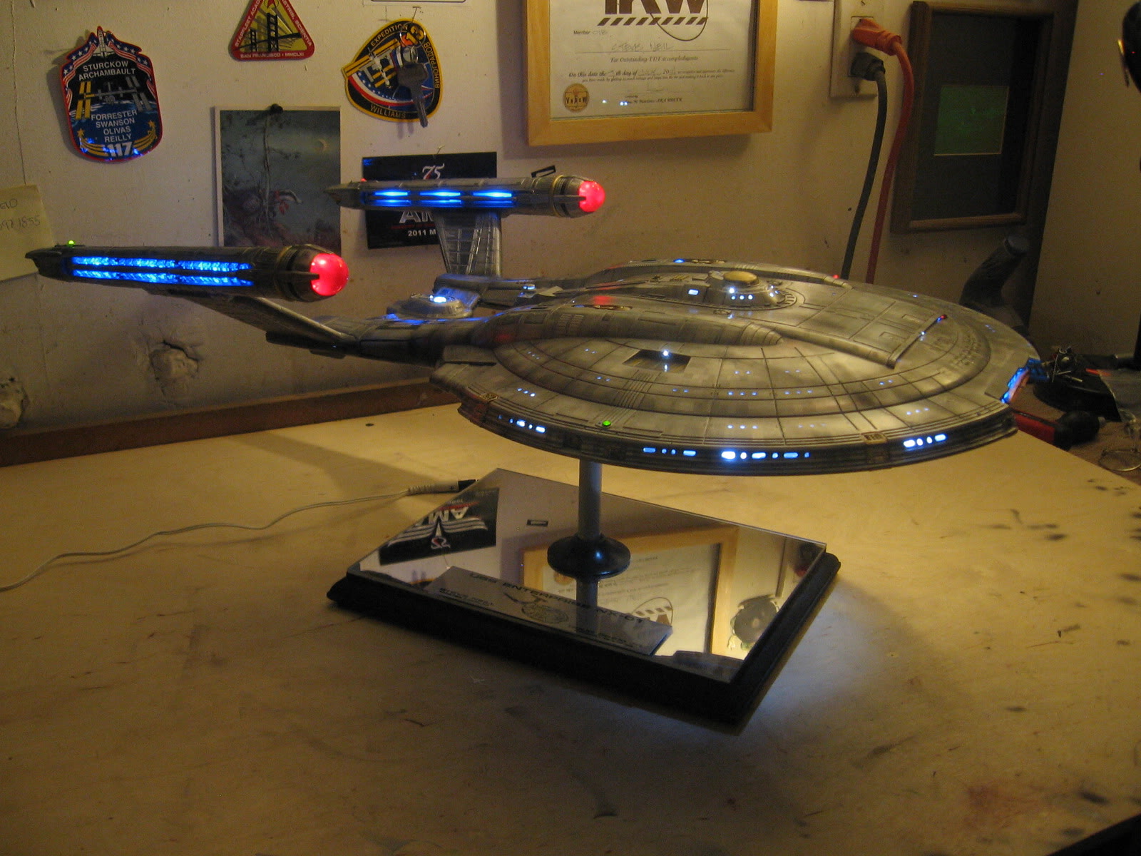

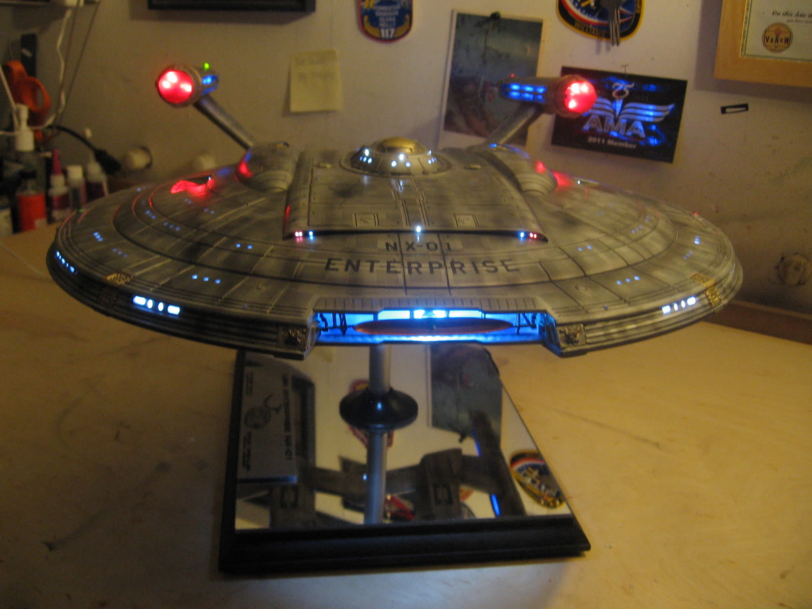

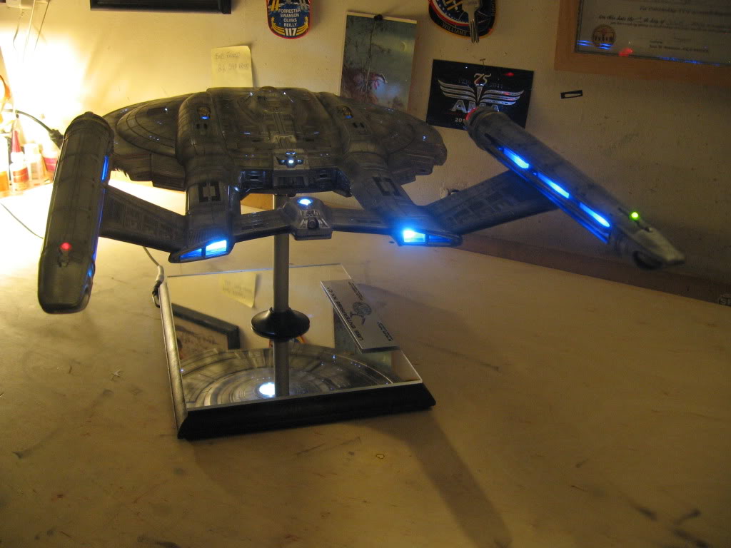

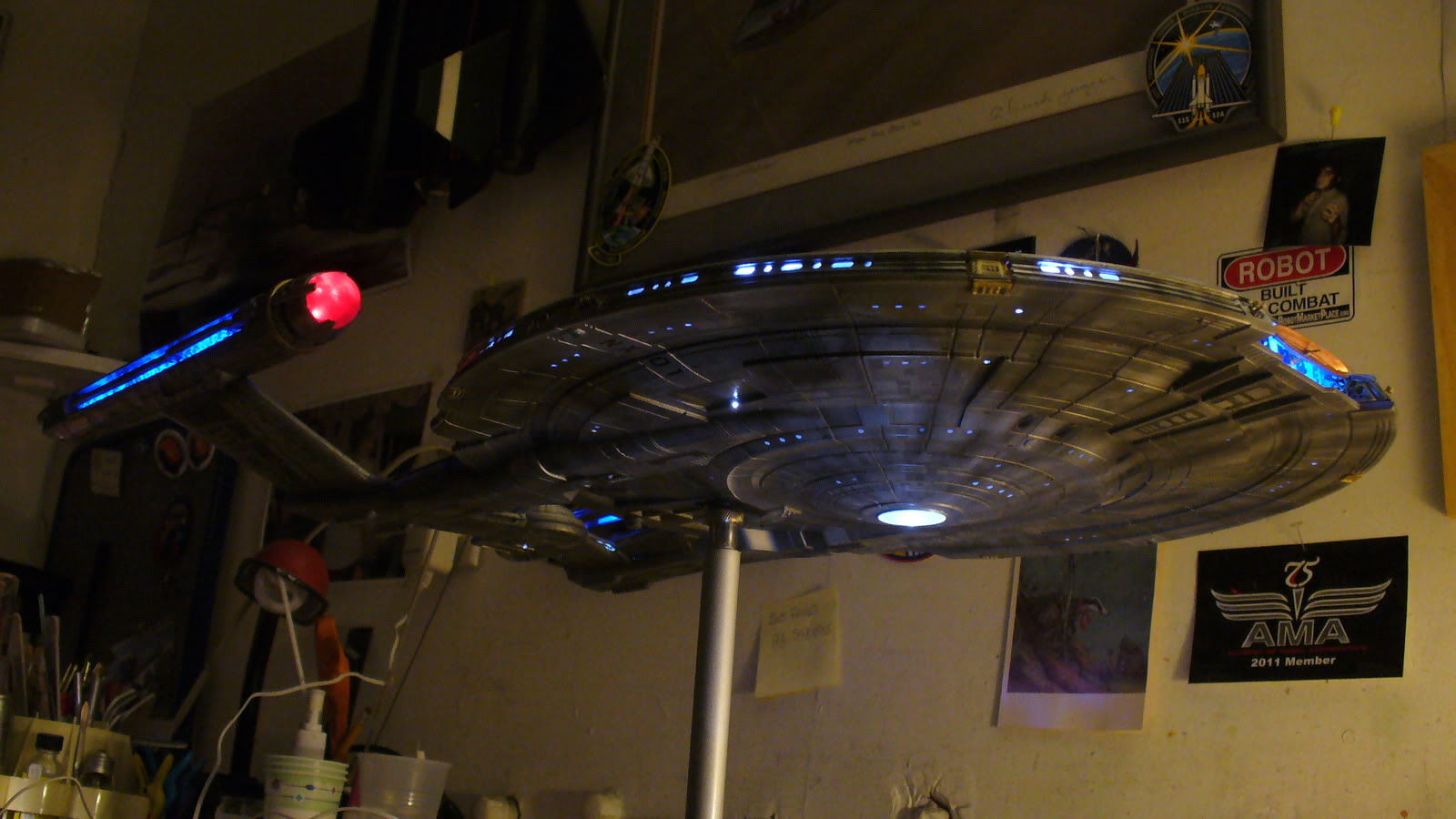

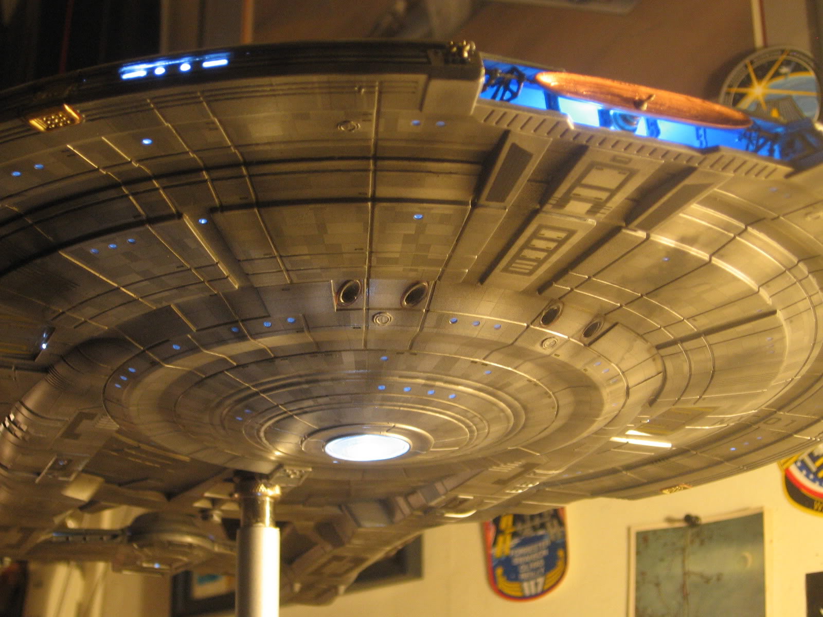

After nearly 4 weeks of work the NX-01 is finished. Dave or FuseNova had me add a bit of weathering and battle rash. I went back over her several times today and called her done. Most definitely camera ready.
So here’s a whole bunch of pictures and video for you to enjoy. As soon as I finish the molds for the big Enterprise I’ll be building mine. IK learned to really fall in love with this hip after getting to know her! Great design Doug!
Steve
