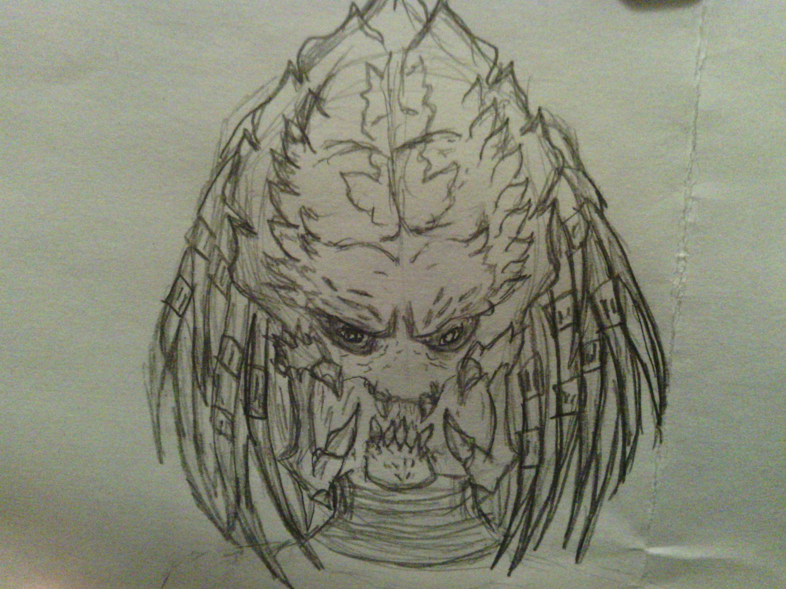

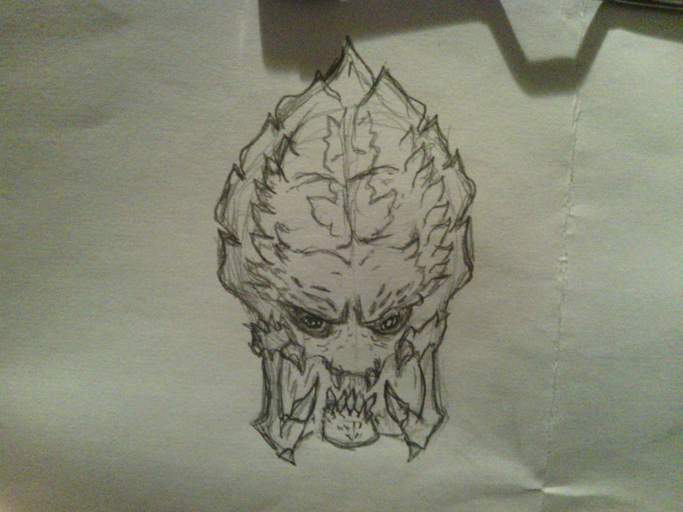

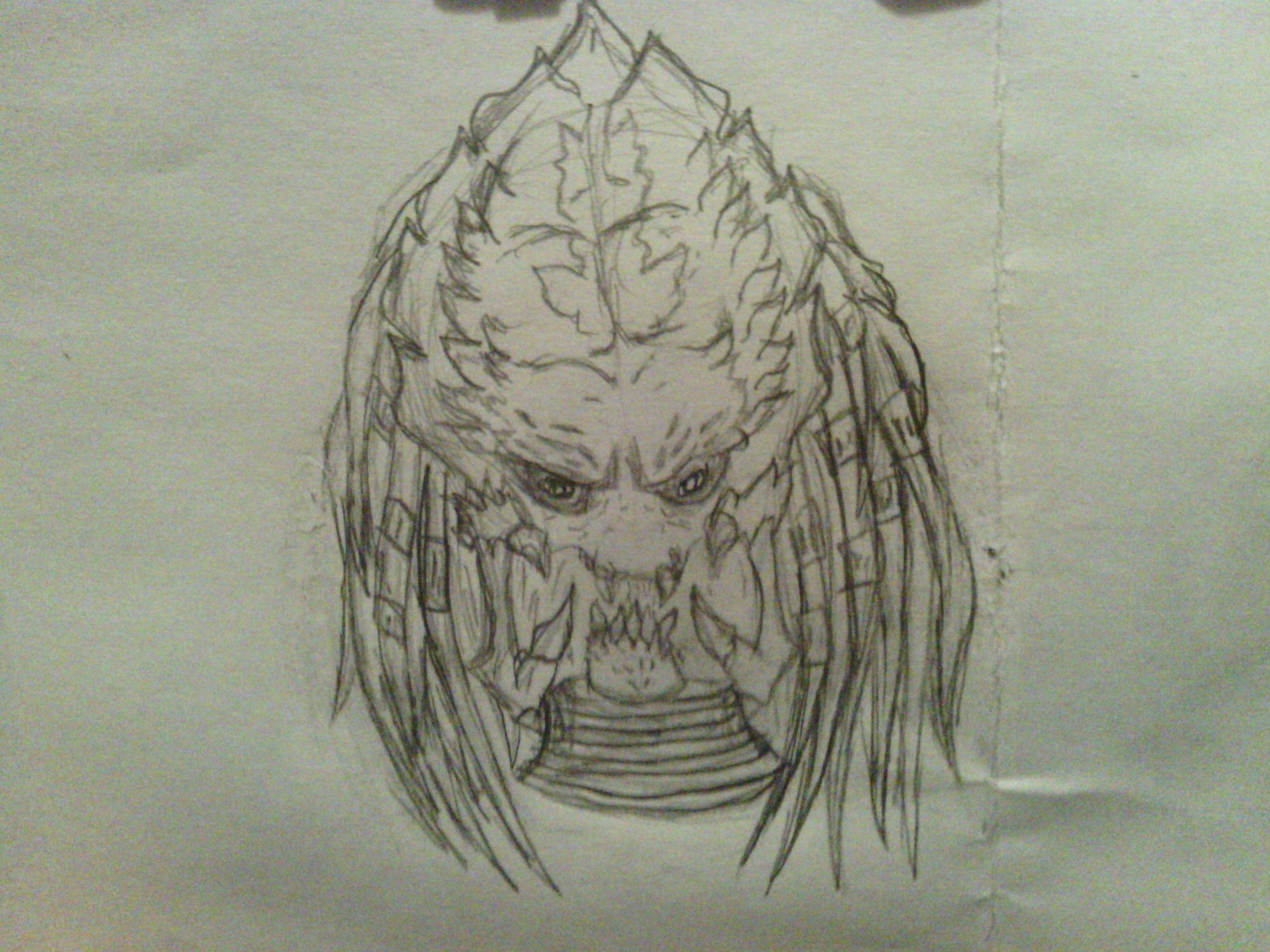

Somewhat of an update, got a concept sketch done, I'm not a very good artist its just to give you guys a jist of what the head sculpt should look like. And no scanner. Sorry.
I wanted to go with an angular crown and spikey brow just cause it looks meaner.

No dreads:
sezfG.jpe
Dreads:
jOWWh.jpe
Longer dreads:
XXkoI.jpe
