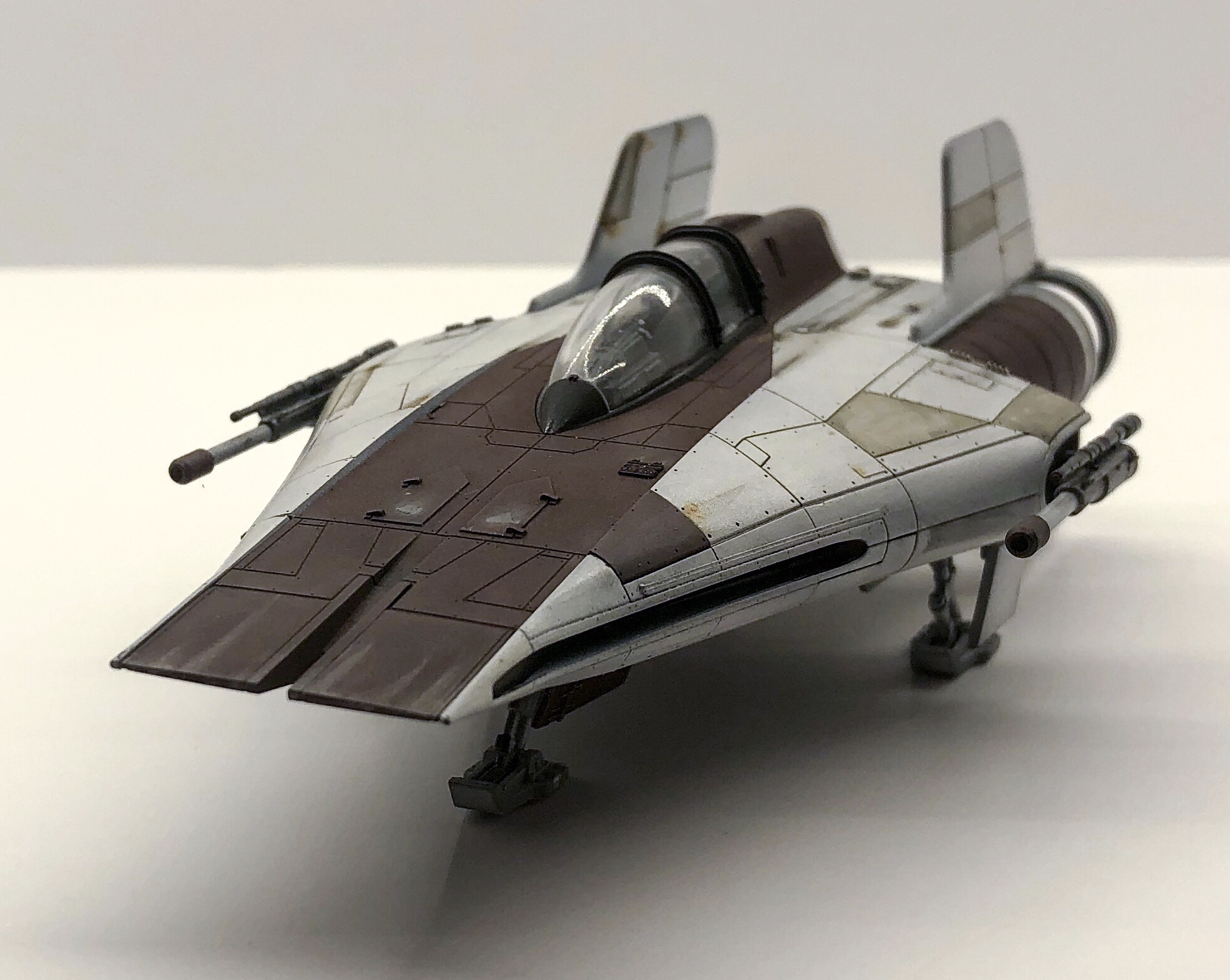

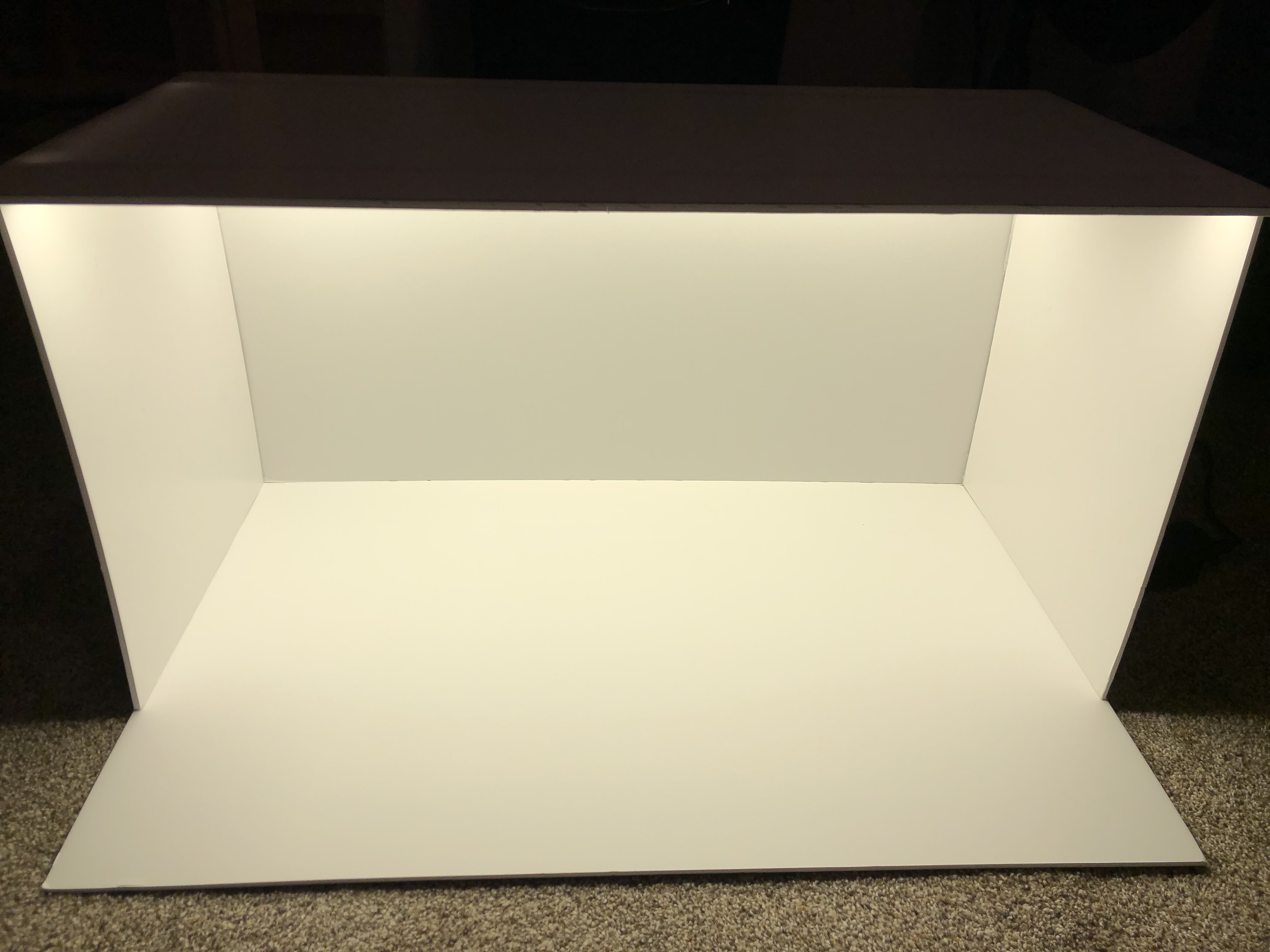

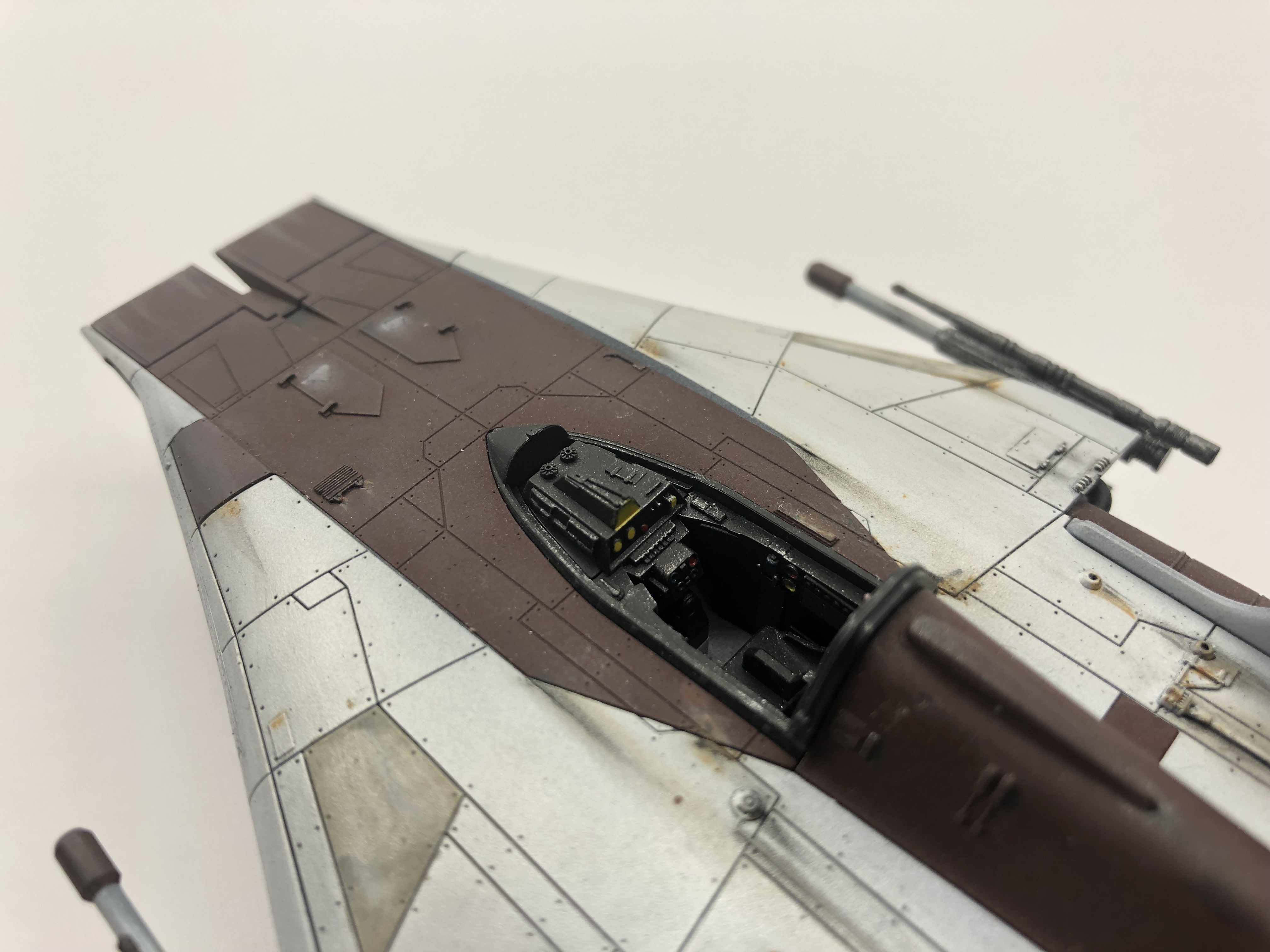

As the title suggests, I needed a light box to take better pictures of my models so I can showcase how they actually look. With input from quite a few members here, I was able to throw together a rather inexpensive box.
I used foam board to build the box and fitted it with a strand of super bright LEDs I bought off eBay. All in all, this box cost me under $20. Below are the results with a look at the box itself. Please note, I do still have to pick up some poster board to 'get rid' of the lines in the background.
The model I used is Bandai's 1/72 A-Wing built by myself, of course.

It was a 5630 strip of LEDs with a total of 300 for about $9 on eBay. I picked up two power supplies from the same seller for about $13. You only need one for the whole strip, but I cut it in almost half to use the other strip and PSU for another application. You see the ones I picked up in the links below.
LED Strip
Power Supply
So, a complete list of what I used would look like this:
  • foam board (largest I could get from Hobby Lobby) $5.99
  • hot glue and a hot glue gun
  • 5630 LED light strip $8.99 (used only half for the box, so the adjusted price would be $4.49)
  • Power supply $7.49
Total: $17.98

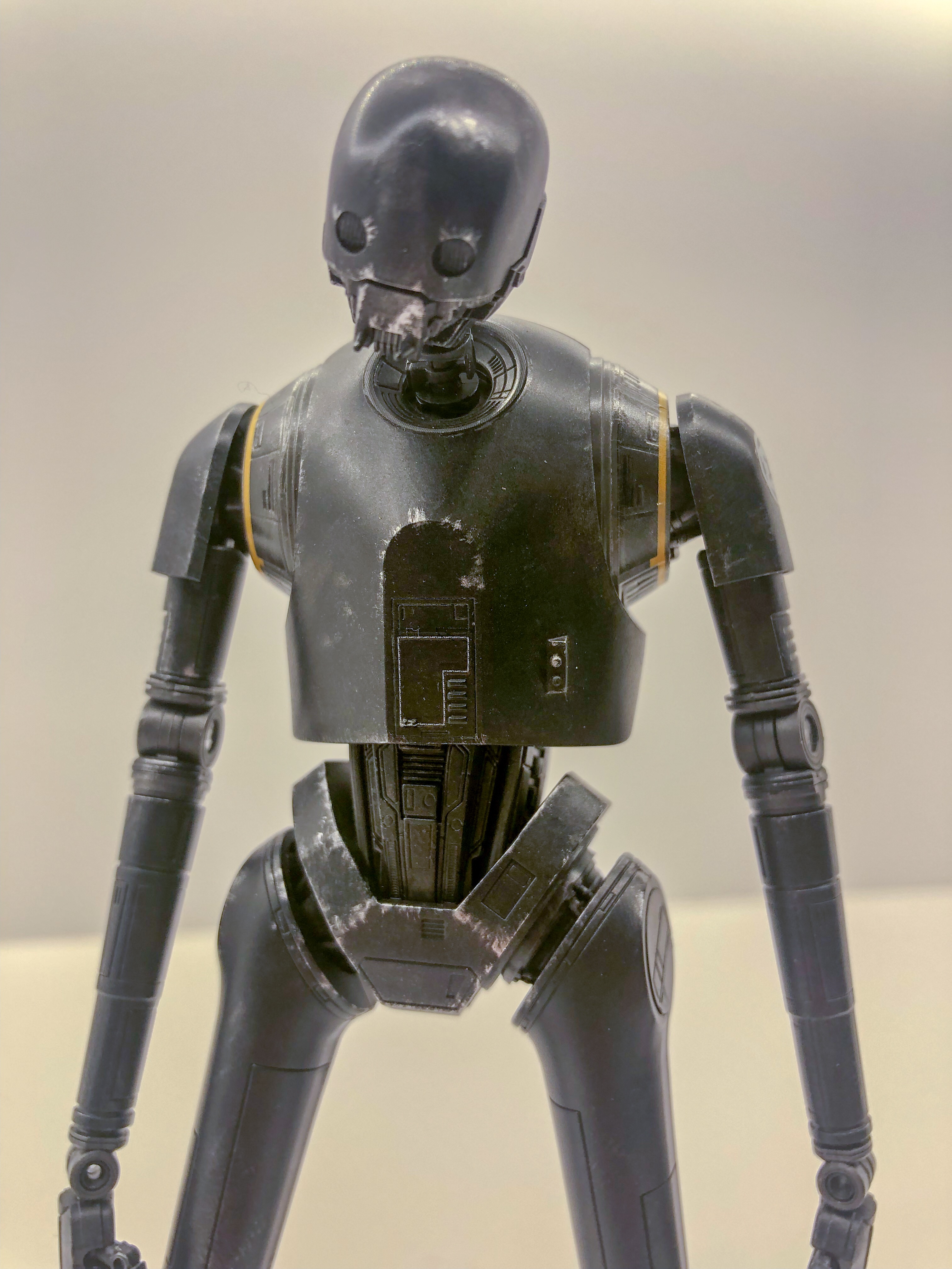

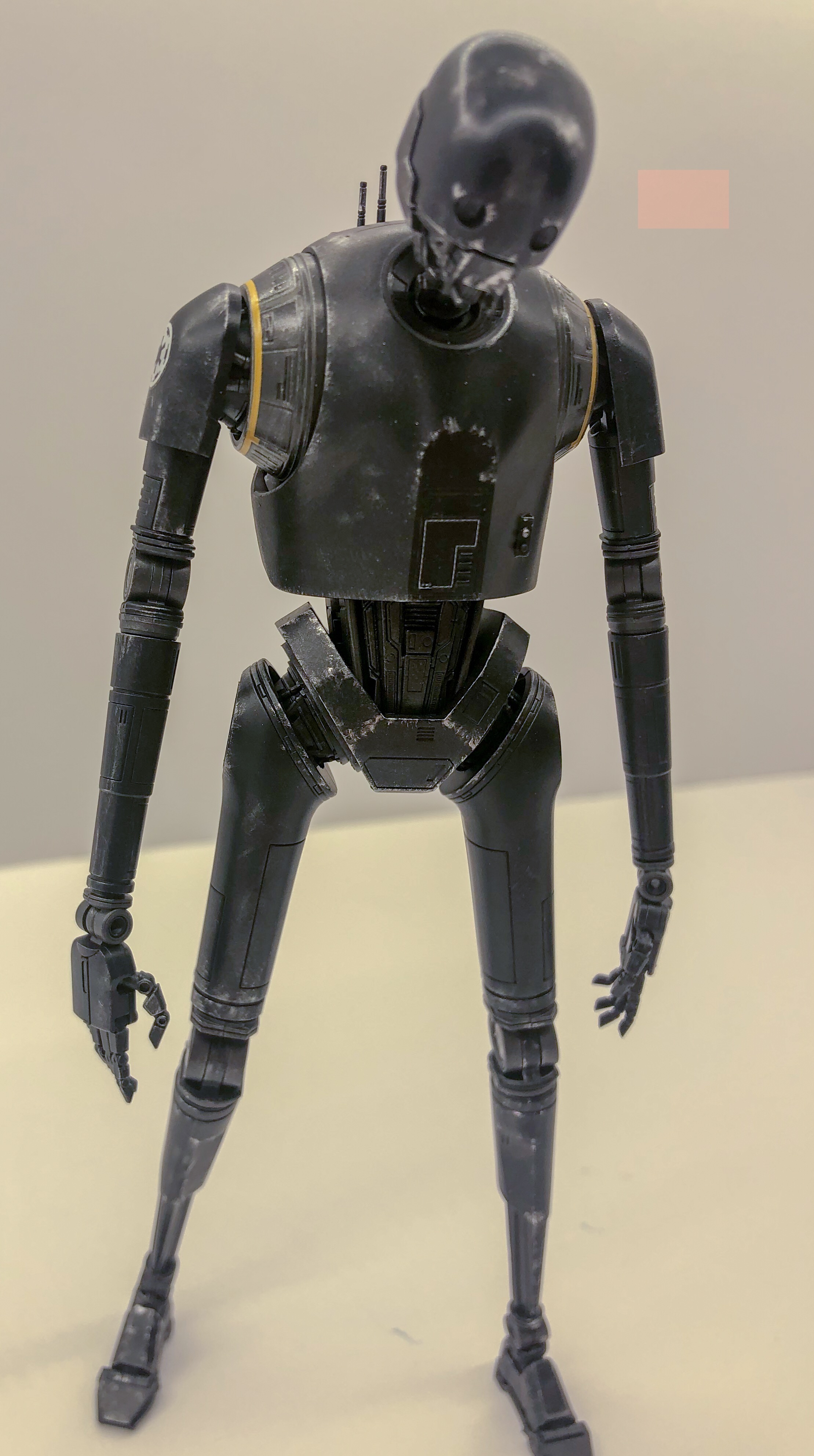

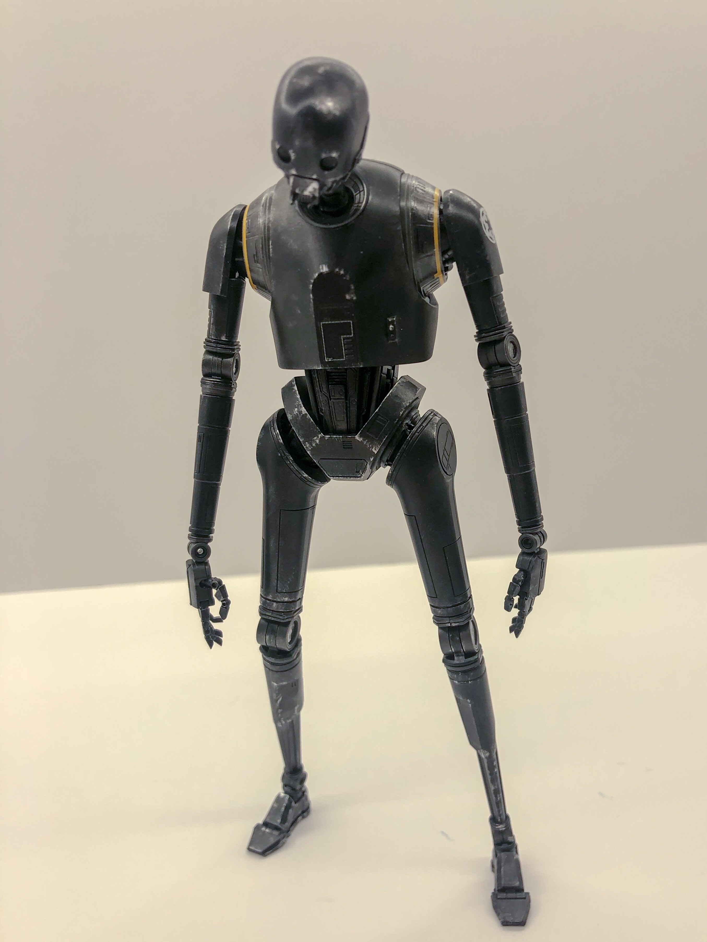

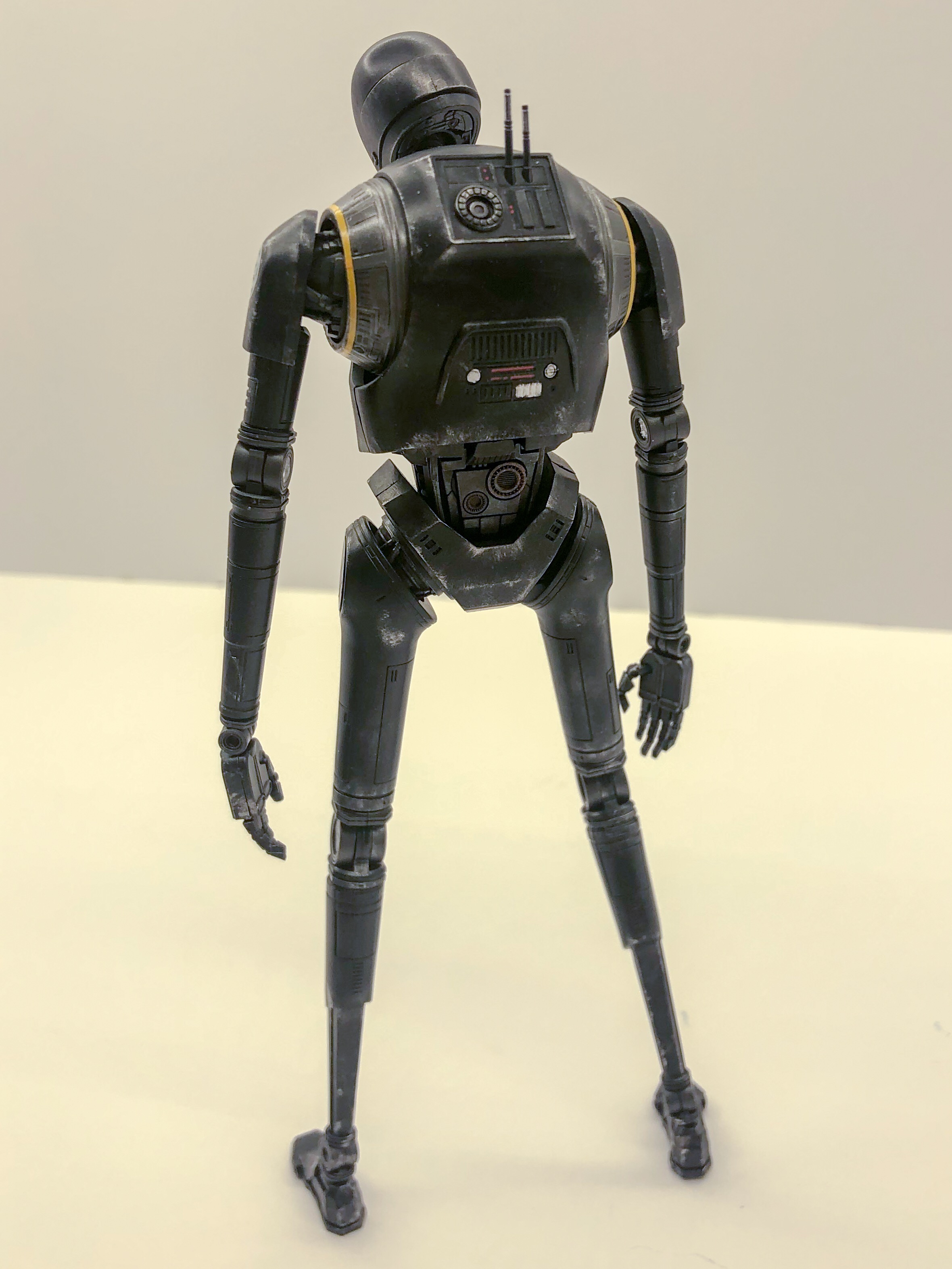

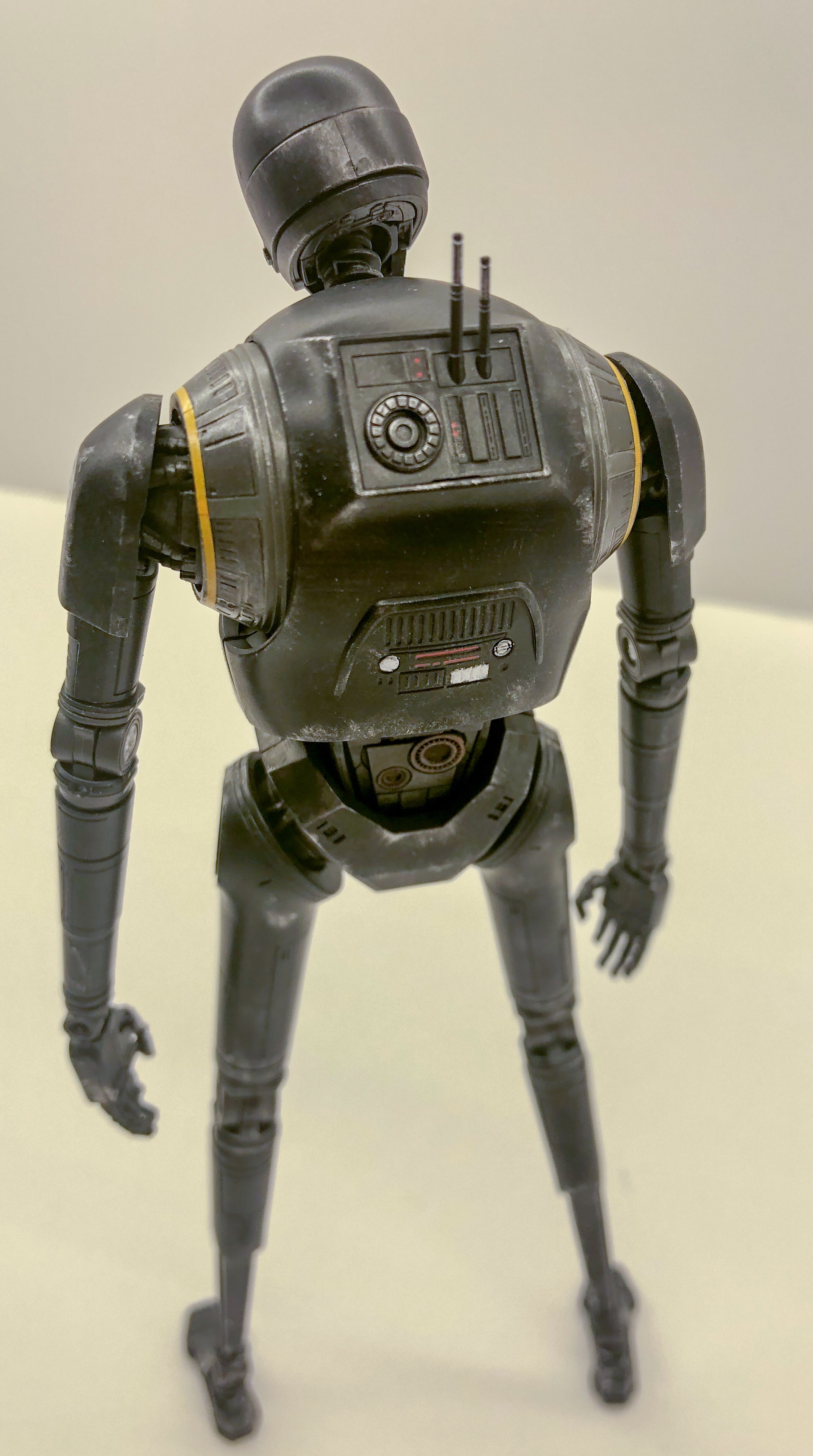

Here are some shots of my K2-SO in my light box:
20181214_025736736_iOS.jpg 20181214_025747966_iOS.jpg 20181214_025803230_iOS.jpg 20181214_025835642_iOS.jpg 20181214_025840995_iOS.jpg 20181214_025912208_iOS.jpg

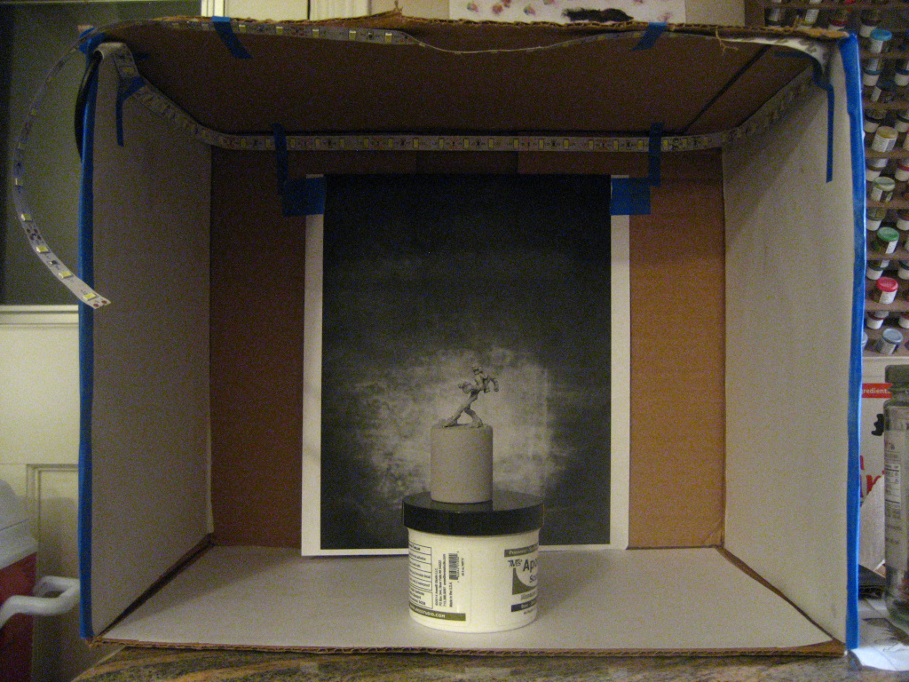

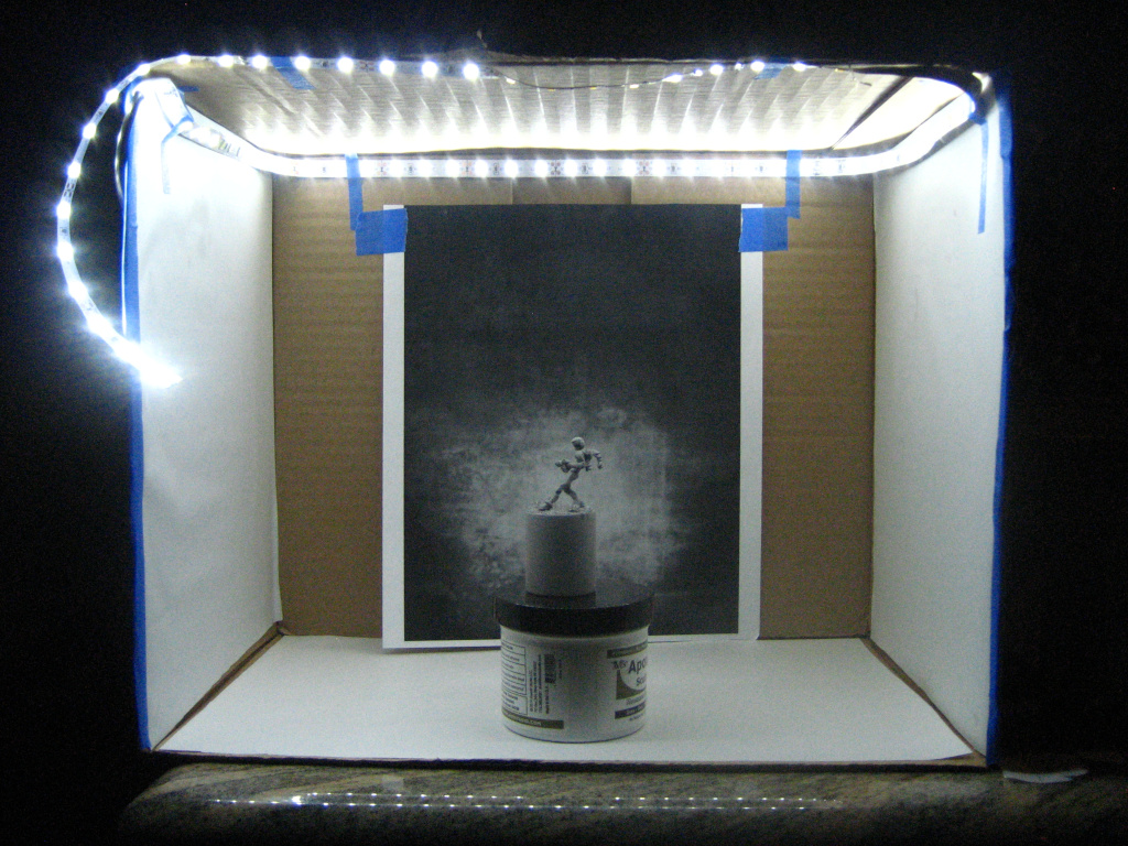

Hey korben, I got myself an LED strip and hacked together a cardboard box, some pages of white paper and a printout of a dark-ish background from Massive Voodoo. I took a shot of a 35mm figure I am sculpting, I reckon it turned out pretty good for a <$10 job.
Thanks for the inspiration!
