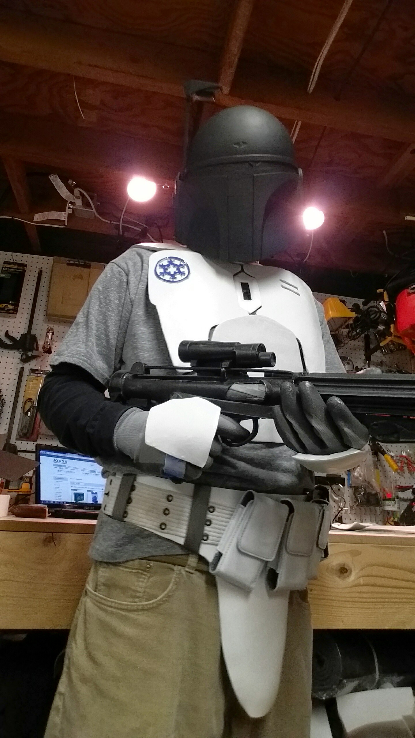

Once the lids were coming along I started to get the armor closer to being finished.

So, Kevin and I wanted similar color schemes, but also distinctly different. I went with a nice hammered bronze and copper for my accent colors. Kevin's colors ended up being silver and blue...
20150422_144250 by Robert Whalen, on Flickr
My helmet is on the right. First I sprayed both helmets inside and out, flat black. I wanted the inside to look finished as well when it was all done. Next I sprayed my helmet the Copper color that I wanted to be the color for the cheeks, ears, back, and range finder.
20150422_151816 by Robert Whalen, on Flickr
I let that dry for over 24 hours before taping over it.
20150423_142446 by Robert Whalen, on Flickr
20150423_142454 by Robert Whalen, on Flickr
20150423_142504 by Robert Whalen, on Flickr
Once the tape was in place, mine got hit with the copper, and Kevin's the silver...
20150424_112803 by Robert Whalen, on Flickr
I didn't get a photo of the next step, but I waited another 24 hours, and added more tape. Finally, the white coat went on last...
20150424_213623 by Robert Whalen, on Flickr
When the white paint was dry enough to handle I started CAREFULLY removing the tape. very slowly, and very deliberately...
20150424_213648 by Robert Whalen, on Flickr
20150424_235116 by Robert Whalen, on Flickr
We were quite pleased with the results. We felt that the two Mando's could belong to the same Clan, but weren't necessarily twins.

Still a few more details to sort out, but we did get a chance to take our Mandos "out for a spin". Our local Star Wars Fan Force - The North Ridge - produces and performs to a sold out crowd every year for the Buffalo Bisons. Kevin and I got to take some photos on the field at Coca-Cola Field during a dress rehearsal for our upcoming event on July 18th this summer...
If you are in driving distance to Buffalo, NY I suggest that you consider getting tickets for the game. Should be a blast!
I like to think that I'm Sam Jackson, and Kevin is John Travolta... "SAY WHAT AGAIN!"
