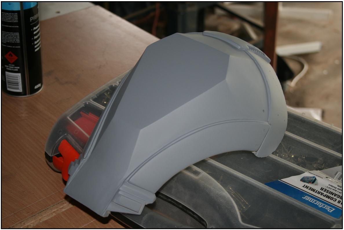

So recently Ive been working on the 3rd version of this helmet that I mentioned back at the start. This version is the helmet of choice for the 'tank'; a highly armored, badass foot-soldier that can take a whole lot of hell.
The helmets a work in progress currently, but heres some sneek peeks.....

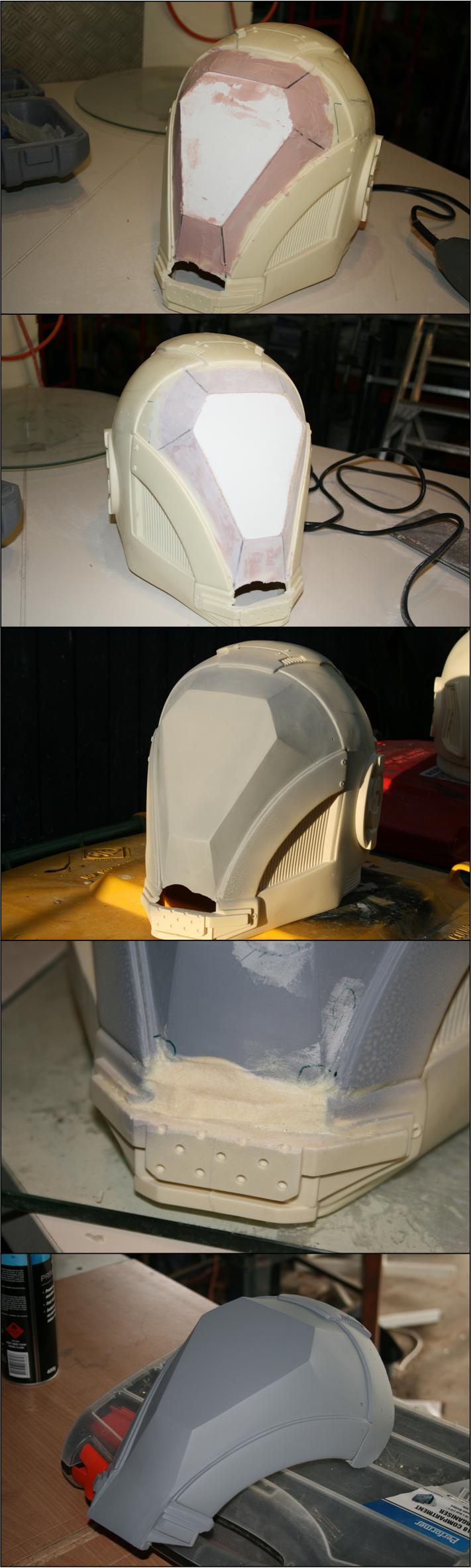

The first add-on was a variation of the visor. The idea was to create a toughened, segmented form that suited the reinforced look. This was achieved by cutting a base form from some scrap timber and gluing it into a blank casting of the helmet visor area. I then cut slots from the corners of the form out to the edge of the visor. I glued plastic strips into these slots.
After trimming some of the excess material away from the base of the helmet I discovered the casting was a little thin and had to fill the hole with some extra resin. A lot of filler, sanding, filler, sanding, filler, etc and I had a buck that was ready to be prepped for vacuum forming.

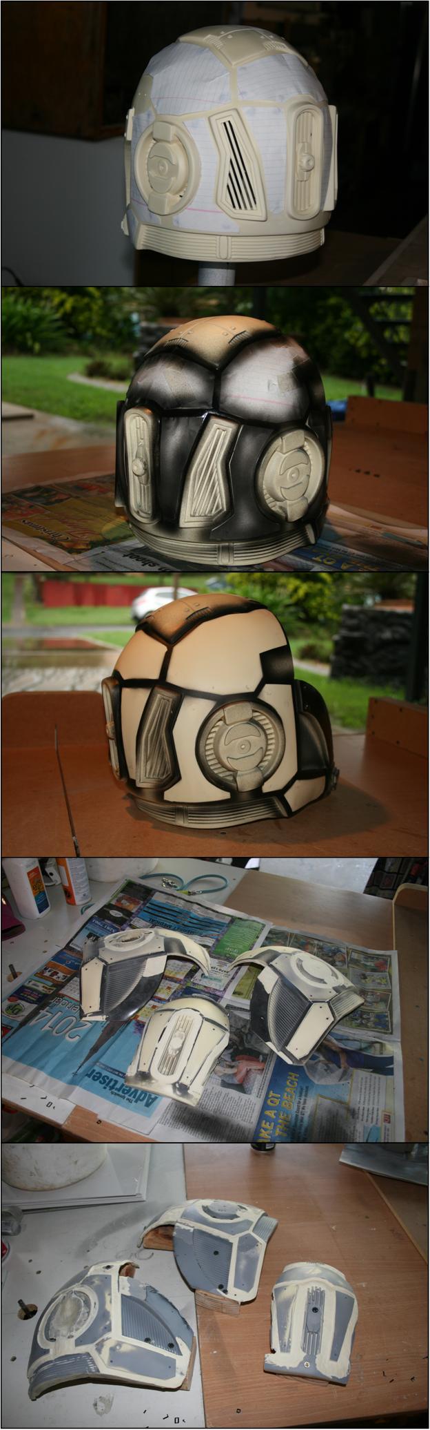

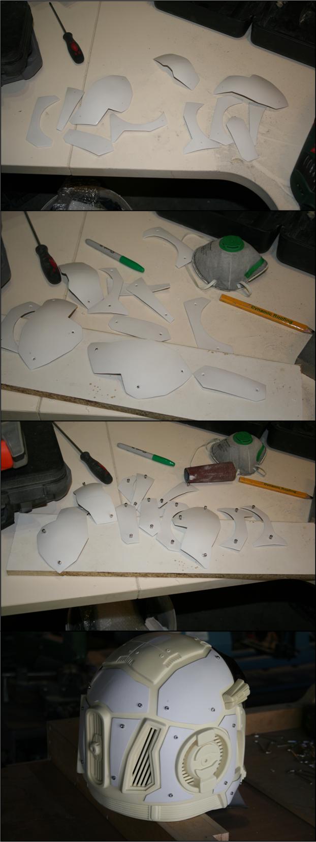

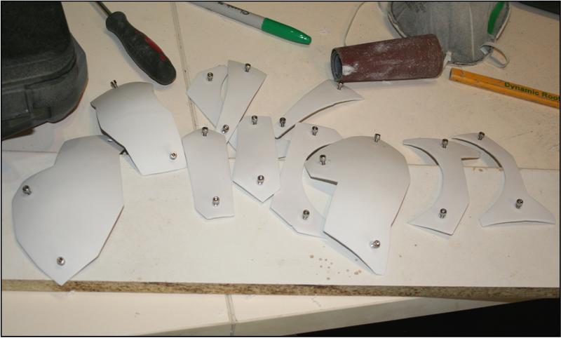

The next add-on was a series of plates to achieve a reinforced look as the helmet is for a 'tank' soldier.
These were made by using a copy of the helmet, creating some paper templates and then spraying over them to leave their impression on the helmet. The helmet was then cut up into sections and the painted areas dremelled out. The sections were then reinforced with fibreglass and wooden support structures.
I then vacuum formed some 2 mm ABS over these which left the impressions of each piece on the inside of the formed shell. Using a multi tool I trimmed out each plate, pre-drilled some holes and then attached the plates to the helmets with some hex head screws.
More to come.....

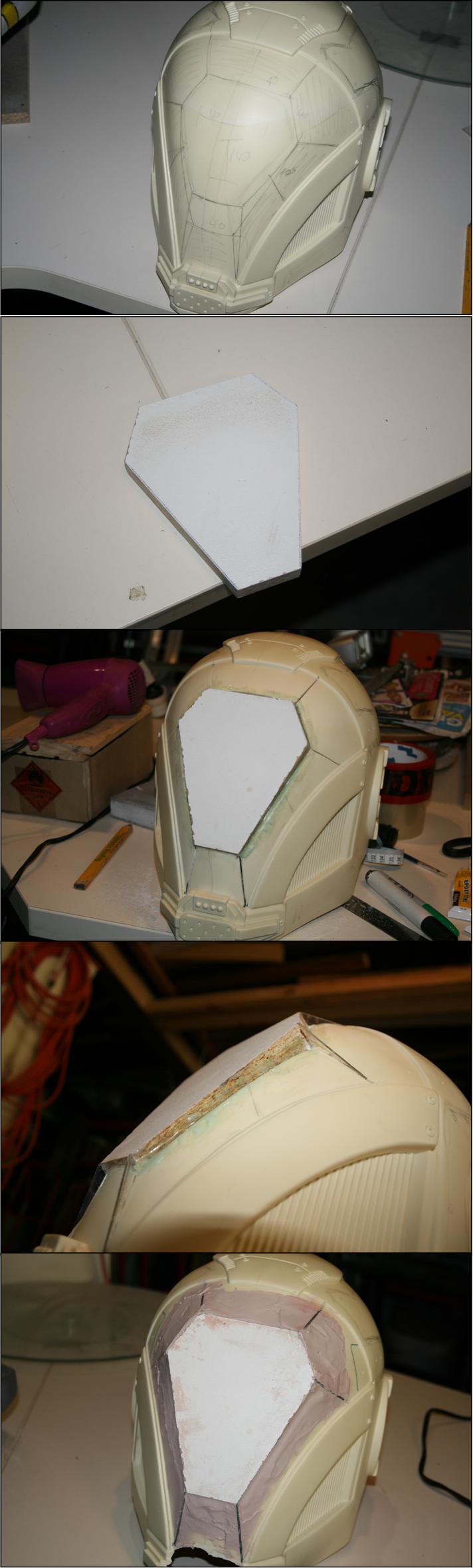

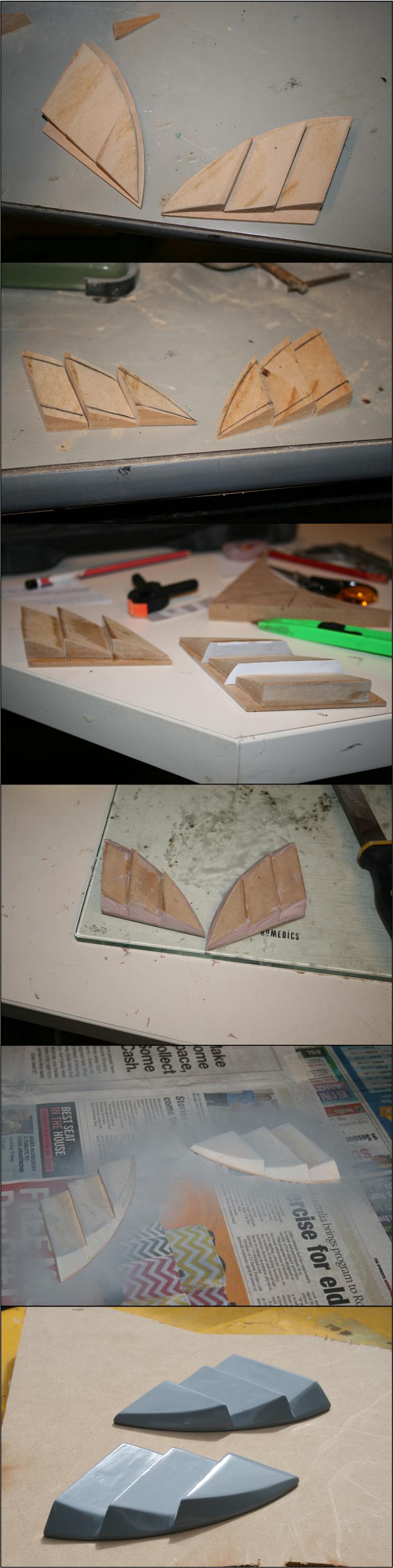

The last add on was a pair of cheek inserts designed to replace the inset, ribbed cheek details with a bulkier, more reinforced alternative.
These inserts were made by first creating a template of the recess and cutting a piece of MDF to suit the space on either side. These pieces were then trimmed into three sections and shortened to allow for a bevelled edge to be created with some filler. The pieces were glued to a 3mm MDF backing and some plastic strips were added to contain the filler. A few layers and some sanding and the masters were produced.
These would be moulded and cast, painted separately and then screwed to the helmet from the inside.

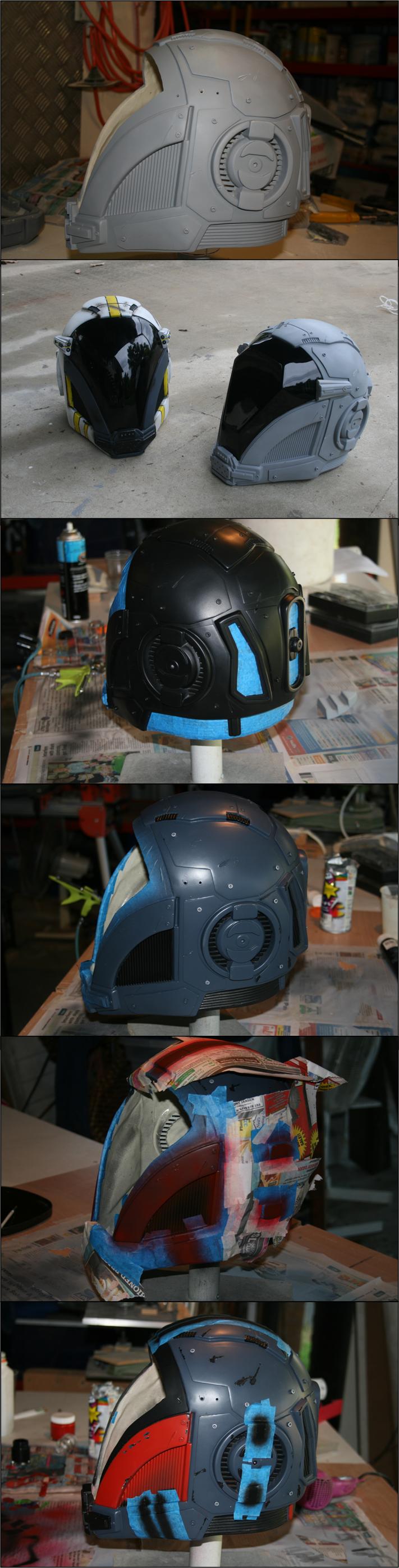

With all the add ons finished it was time for some paint.
This guy is meant to stand out from the crowd. He's the guy you call in when everything is going to hell in a hand basket and is meant to be easily distinguishable.
The colour scheme was therefore a little different......

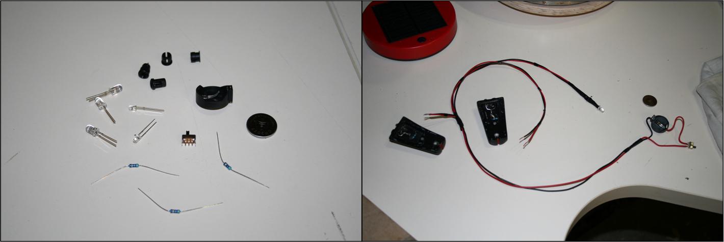

After painting it received some LEDs with a switch and easily changeable battery. A few components soldered into a harness and then added to the helmet.

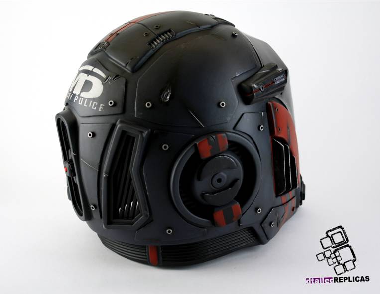

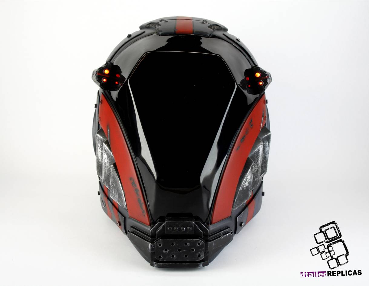

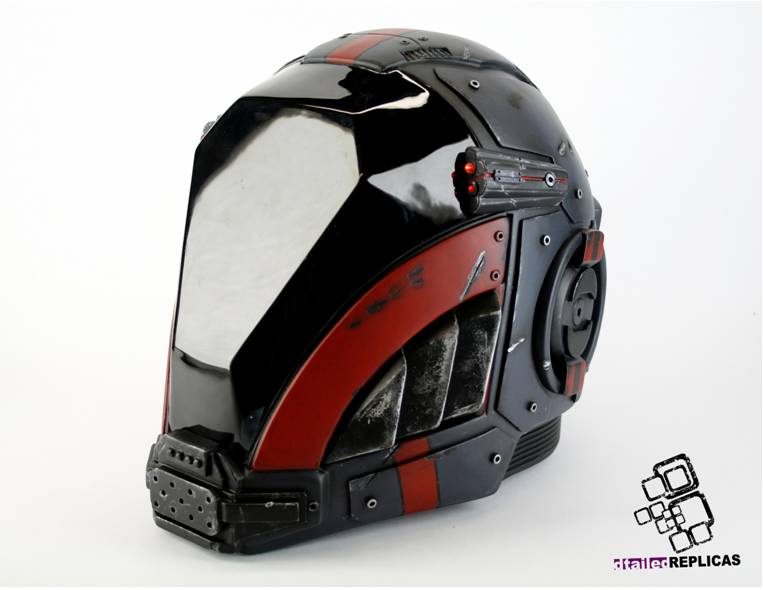

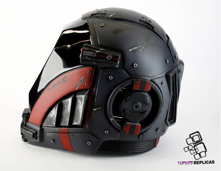

So, here we go. The final product........
If you've made it this far............thanks for following the build!

Re: Custom Commissioned Helmet: Build *FINISHED PICS PAGE 3*
That looks epic, the plates really make it so. I think I am a fan of the tank for sure.
