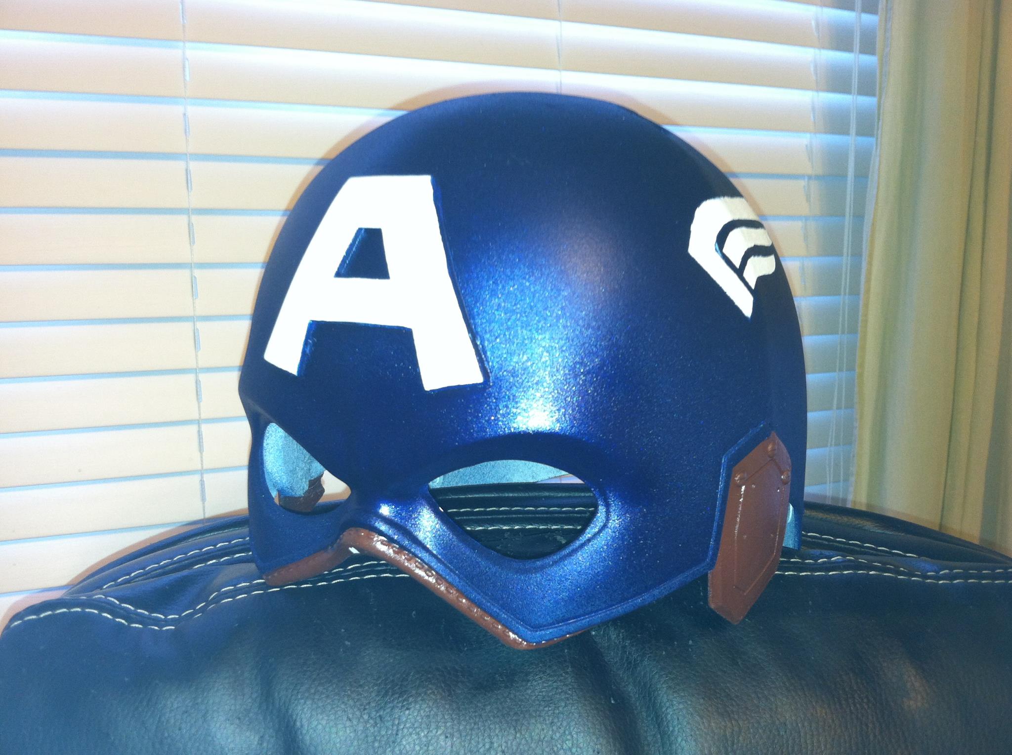

BLUE TOP COAT w/ WHITE GRAPHICS

NEAR FINAL TEST FIT (Not Final Paint)
![Cap Helmet [6].jpg Cap Helmet [6].jpg](https://therpf-f28a.kxcdn.com/forums/data/attachments/109/109568-b1d3b0b410590bbef14202684a5bb18c.jpg)

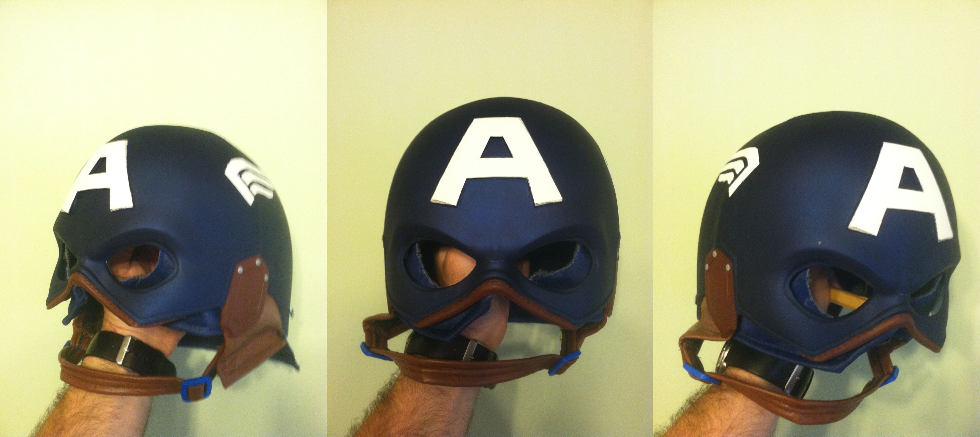

REVISED CHIN STRAP & HARDWARE TEST Fit w/
ADDEDE RIDGES & FINAL BLUE TOP COAT (Not Final Chin Cup)
![Cap Helmet [7].PNG Cap Helmet [7].PNG](https://therpf-f28a.kxcdn.com/forums/data/attachments/109/109569-9e5d9b11a8c21379d77ed0ef53cc8d40.jpg)

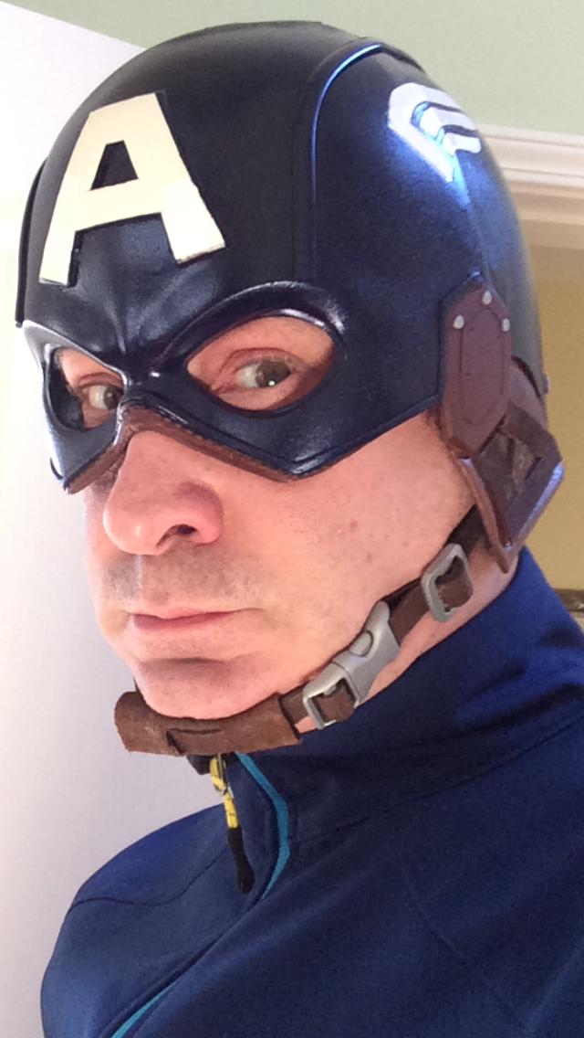

FINAL FINISHED HELMET w/ COSTUMES
![Cap Costume [0].jpg Cap Costume [0].jpg](https://therpf-f28a.kxcdn.com/forums/data/attachments/109/109570-354fee3a554249fc5d25e0d9c8912b1e.jpg)
