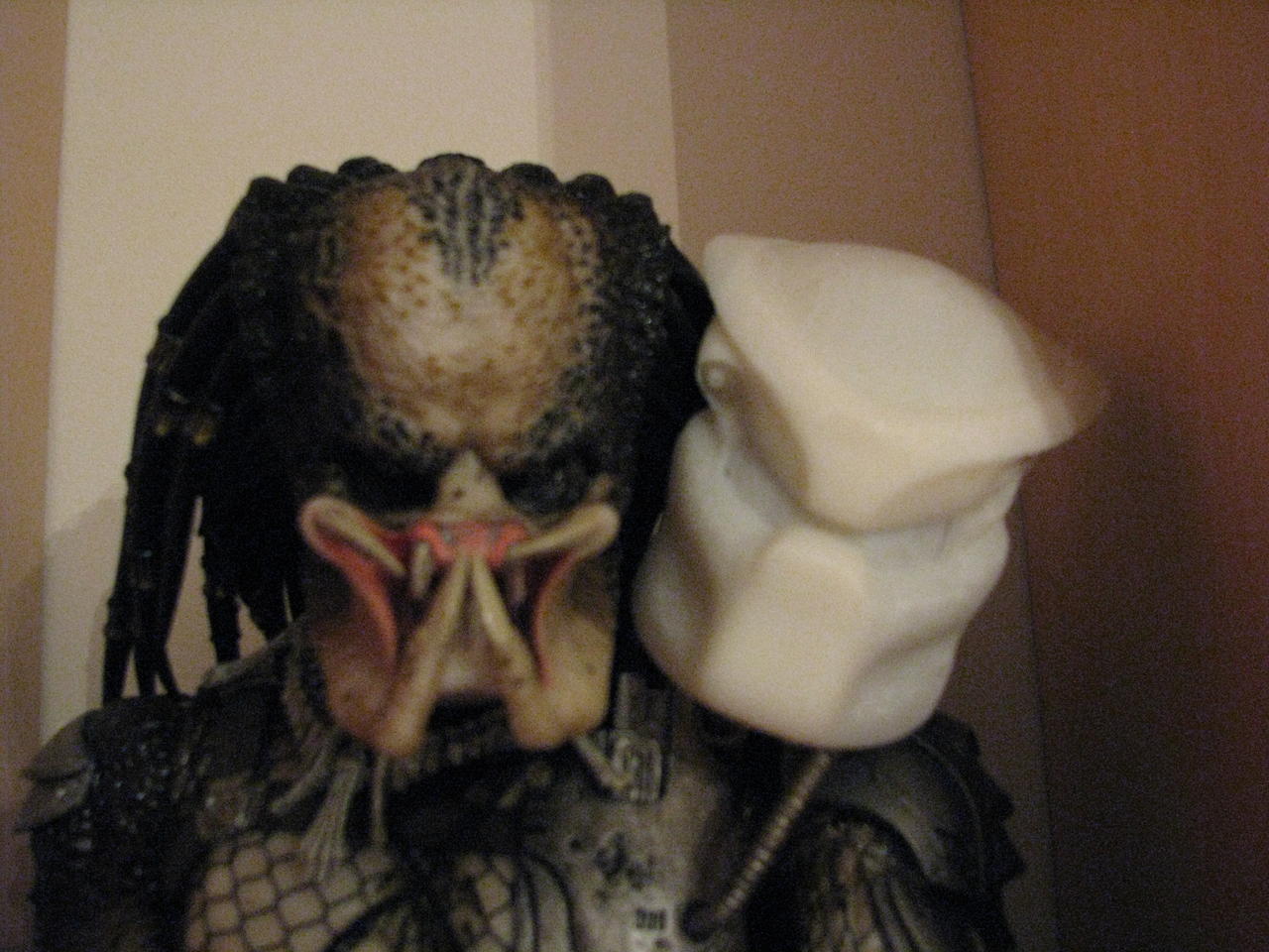

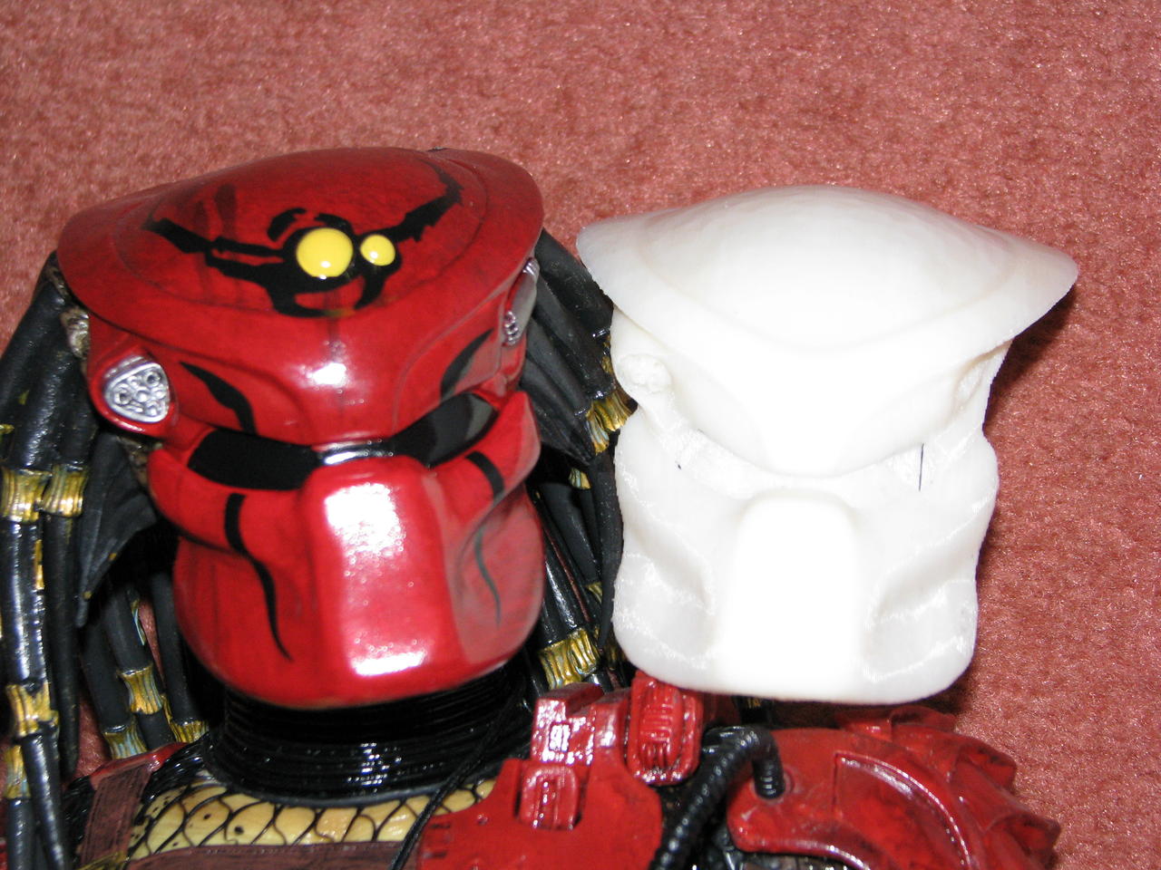

Here are some photos I took last night with my camera.

Unfortunately the NECA 1/4 P1 closed mouth head isn't closed enough for the bio to fit, at least not without a large gap round the sides, so I may well hunt down a 1/4 scale masked jungle hunter figure to add to my collection - the only 1/4 scale figures I don't have at the moment are the open mouthed and masked jungle hunters, I've got all 8 of the others and Dutch. It's a blurry pic, and some of them are still boxed in this shot, but they're all out on the shelves in my living room either side of the TV now:
