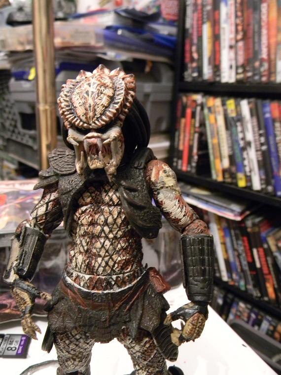

Berserker Pred minus armor, plasma cannon, and loin cloth.

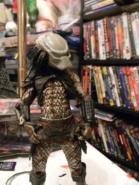

City Hunter minus touch-ups, plasma cannon, quills, accessories, and wrist blades.

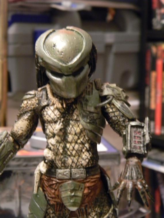

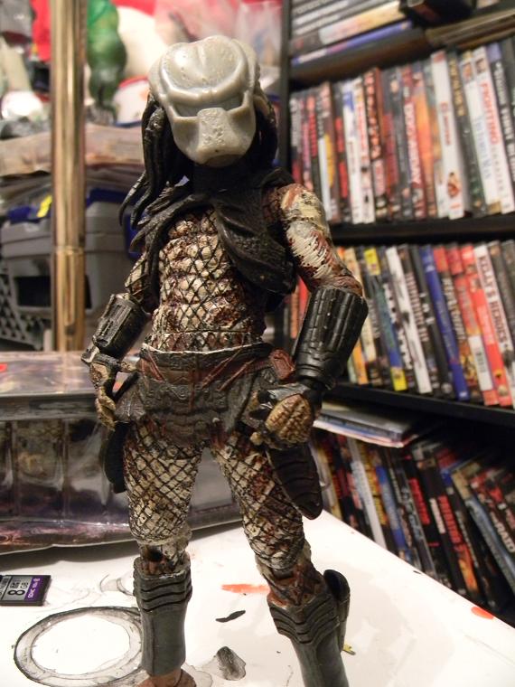

Anytime minus touch-ups and plasma cannon and quills. I've included the "lazy eye" he appeared to have when he first took his mask off.

Nice work all round, especially the paintwork on Berserker and Anytime. I lol'd when I saw his lazy eye.
I know it's a comic book homage, but I'm not a fan of the blue armour (same goes with Big Red) as it seems too bright to me, and stands out far too much compared to the preds with metallic armour. Perhaps several washes to tone the colour down to suggest rust/dirt and weathering to show the bare metal underneath? Especially on the edges of his armour plates.
Personally I prefer my preds weather beaten, rustic and earthy, and your other three have that in spades/ Keep it up!
