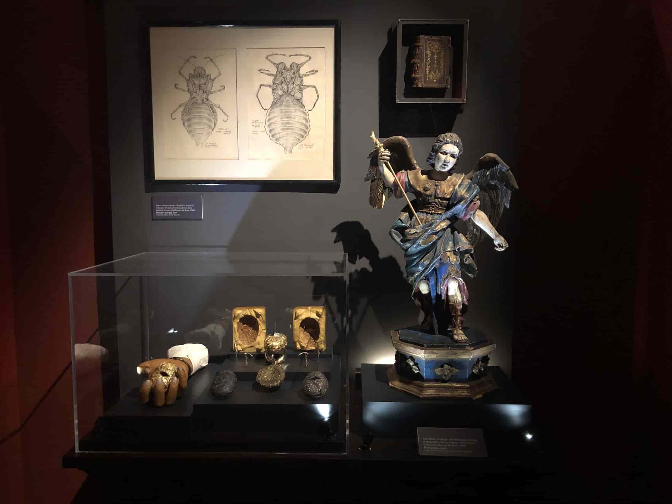

Also, check this out... I just ran across this pic last night - I'm guessing it's from that traveling del Toro exhibit. Looks like he has the original mold too! :eek:
Great find! Would love to see some closeups, if there are any...
