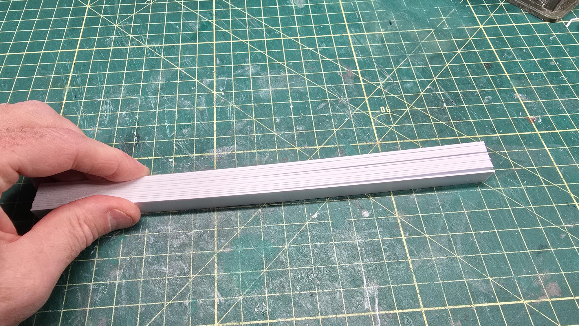

Hey Carl... I got the chance to do some cutting on .o4 styrene tonight. I just set it up to do 1/2 inch strips. I started by doing two runs at the lowest setting, then two runs at 3 steps deeper for the cut. It worked pretty decent. I probably could've gone a bit deeper on the cut. But here are the pictures of the finished product. If I were to do more intricate shapes, I'd probably do a couple more runs with a bit deeper setting to make it easier to pop the pieces out.

Thanks for the test Russ.
When you say "runs", I assume you mean the blade is going over the same cut lines multiple times?
Also, how long did the Cameo take to do all the work to complete the sheet?

Yes indeed. I did two runs over the same lines with the lowest blade depth setting, then did two runs at a deeper setting. The first two runs were at the slowest speed, and can take a bit of time, The last two sets of lines were done at a faster speed. I figure these kinds of runs can just be set up when I'm doing something else, so they can go in the background. I would say the overall time to do the lines took about 10 minutes. It is definitely a bit faster with the .02 and .03 styrene, with the .04 being thicker, it definitely took more time as I wanted to go slower with it. I did put a piece of .06 in there and started to scribe some lines with that, but I had it in the machine incorrectly and had to stop the cuts. I feel it would also do that but would take longer due to having to creep up on the cutting depth over time. I feel the real draw for this machine to do this stuff is the accurate repeatability of the cuts.
