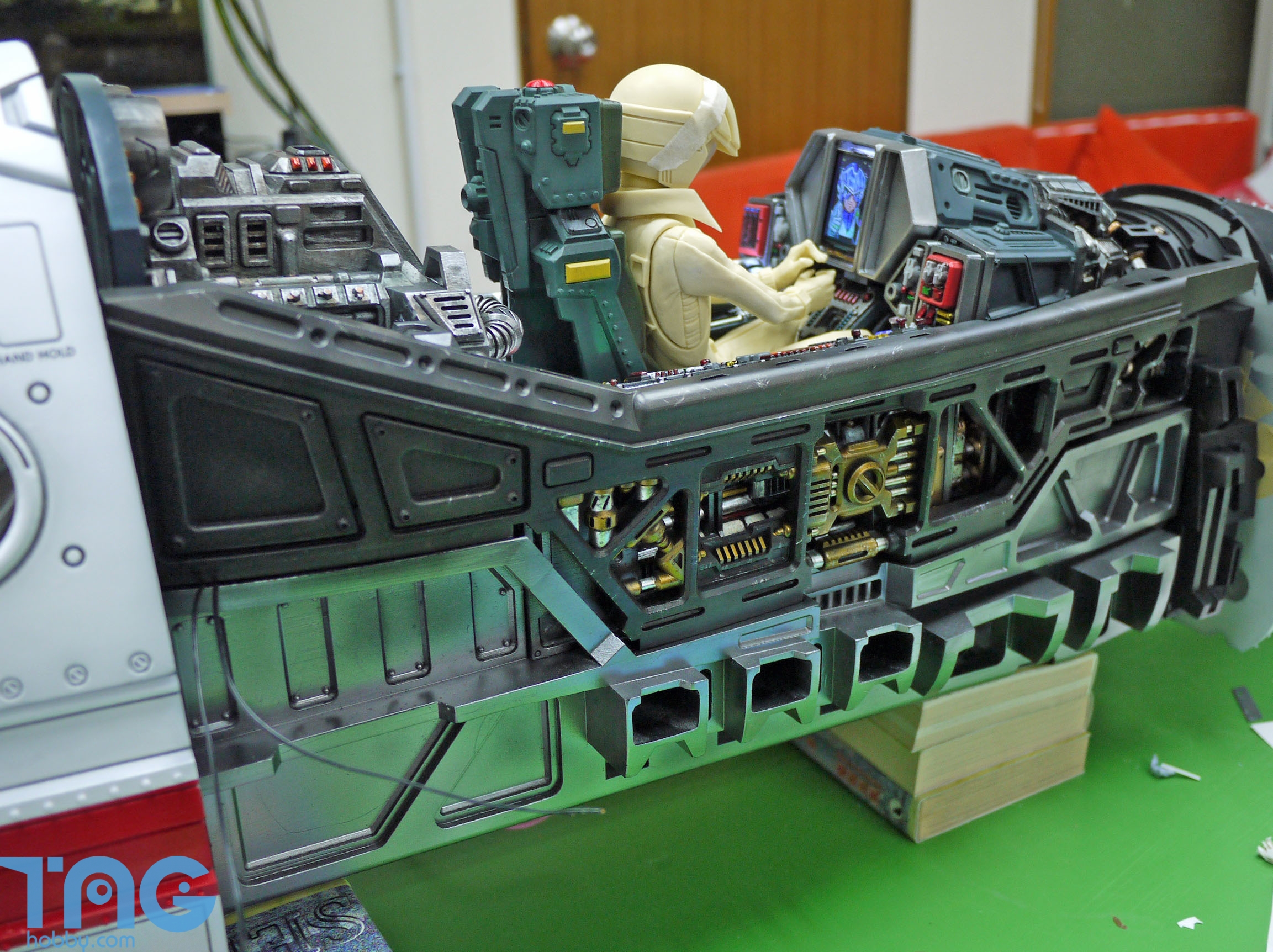

The idea of recreating a VF-1 cockpit is an excellent idea, Kid's Logic made a 1:6 scale diorama that is very good for referencing too:
VF-1 - cockpit 3Q behind Kid's Logic.jpg VF-1 - cockpit 3Q behind light-up Kid's Logic.jpg VF-1 - cockpit 3Q front above Kid's Logic.jpg VF-1 - cockpit 3Q front Kid's Logic.jpg VF-1 - cockpit front Kid's Logic.jpg VF-1 - cockpit side behind Kid's Logic.jpg VF-1 - cockpit side close-up Kid's Logic.jpg VF-1 - cockpit side Kid's Logic.jpg
If you think about it, it's quite narrow, and you could do some stuff with wood panels, get some switches. I like the idea.
