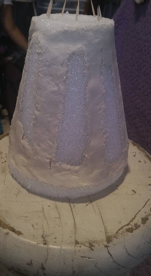

I got to get the bondo on and tried sanding it, it looks too bulgy, but it wasn't thought to be easy either
With bondo, you should have a super low grit sandpaper available. Like 36 grit. First, make sure you don't add too much hardener. Then apply it to the piece, and wait next to it. At some point it will get harder and gummy, so it is no longer liquid but it is still pretty soft. At this point you'd be able to easily leave marks in it with your fingernails, Take your 36 grit sandpaper and start shaping it. It will take down high points like a dream. Get the nice general shape you want, and then let it harden more before you move on to higher grits.
And all of the supplies I've mentioned should be available in a WalMart if you go to the right departments. Auto body repair area should have most of it.
If you are working with Bondo you should invest in a surform, you can really save yourself a lot of time and work. If you work the bondo when it's still in the rubbery stage. Also as mentioned earlier, you should decide what resin you will be casting parts with, and find out if you will need a tin based silicone or platinum based.
Yeah I got to make the form, need a lot more molding then what I had. I'm gonna order some soon but my mold it dry half way and it wasn't that bad. I know its not perfecr but since its look is more organic, fluid-like really, i figured it wouldnt be so bad. if it comes out too bad im going to re-sand it to a smoother form. it was taken monday
Yeah the mold was a bust, I went for a cheap route and got a 25 dollar silicone and wasted it. Bit the bullet and got smooth-on silicone platinum based gallon kit, Gives me a chance to resurface the mold and hopefully learn from the last mold. Also since ive been on night shift i havent had much time on working on it, but i have been working on a few designs for my daft punk/destiny crossover cosplay. Any pointers?
