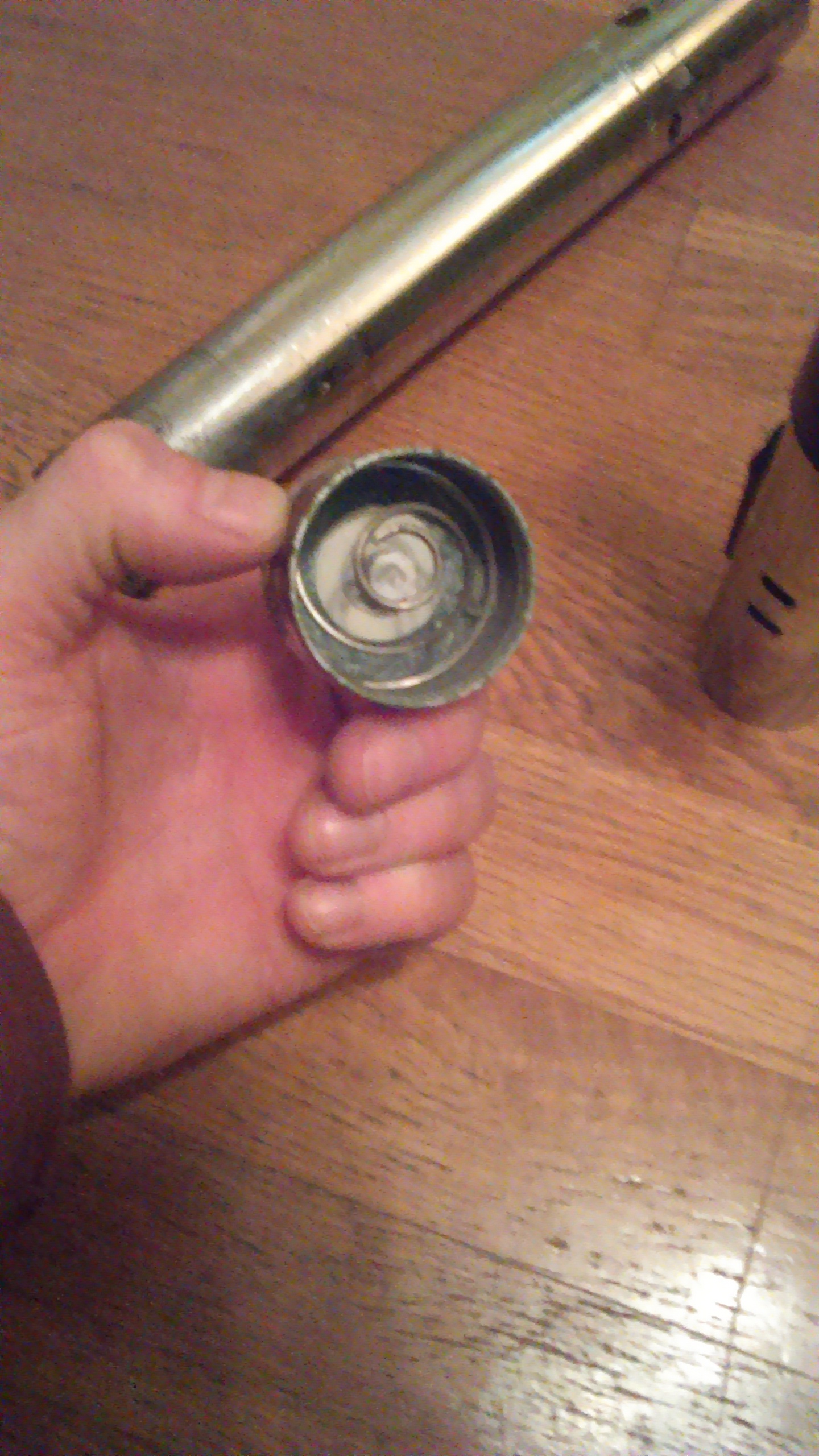

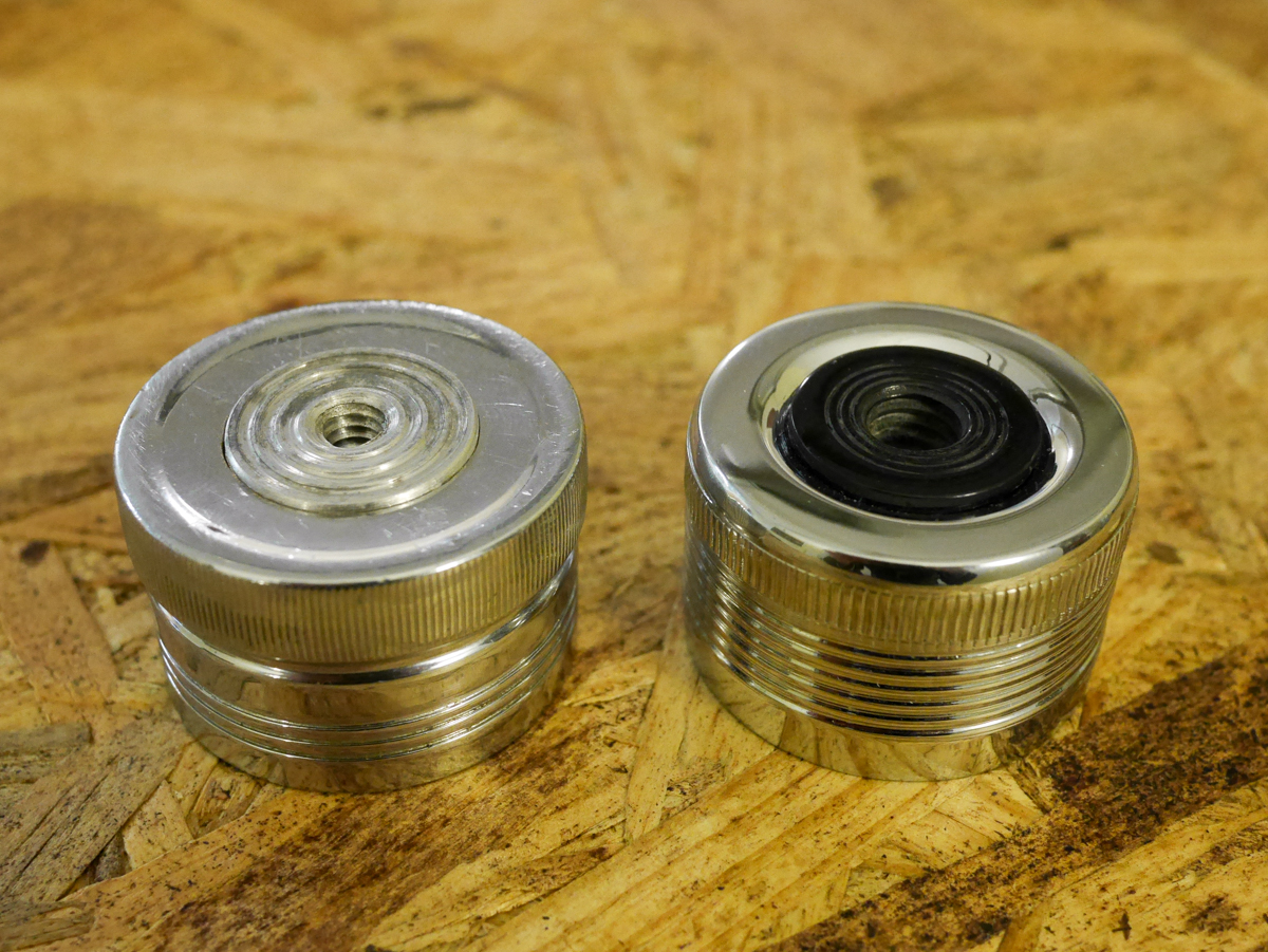

I have here 2 Heiland endcaps: one knurled edge type and one seriously chewed up number. The crusty one has the same tripod mount (I'm assuming that's what it is. I'm still learning about large format cameras and this thing threads perfectly onto my tripod) that you find on the hexagonal Synchronar endcaps. The plan is to transplant the circular threaded part from the sad endcap into the knurled guy.
I seem to remember reading about people performing similar operations but can't seem to find posts now that I need to :unsure. Anyone have any pointers? I plan on using a dremel to remove the threaded part from the sad endcap, drilling and filing out the center of the knurled one, and finally epoxying the 2 pieces together.

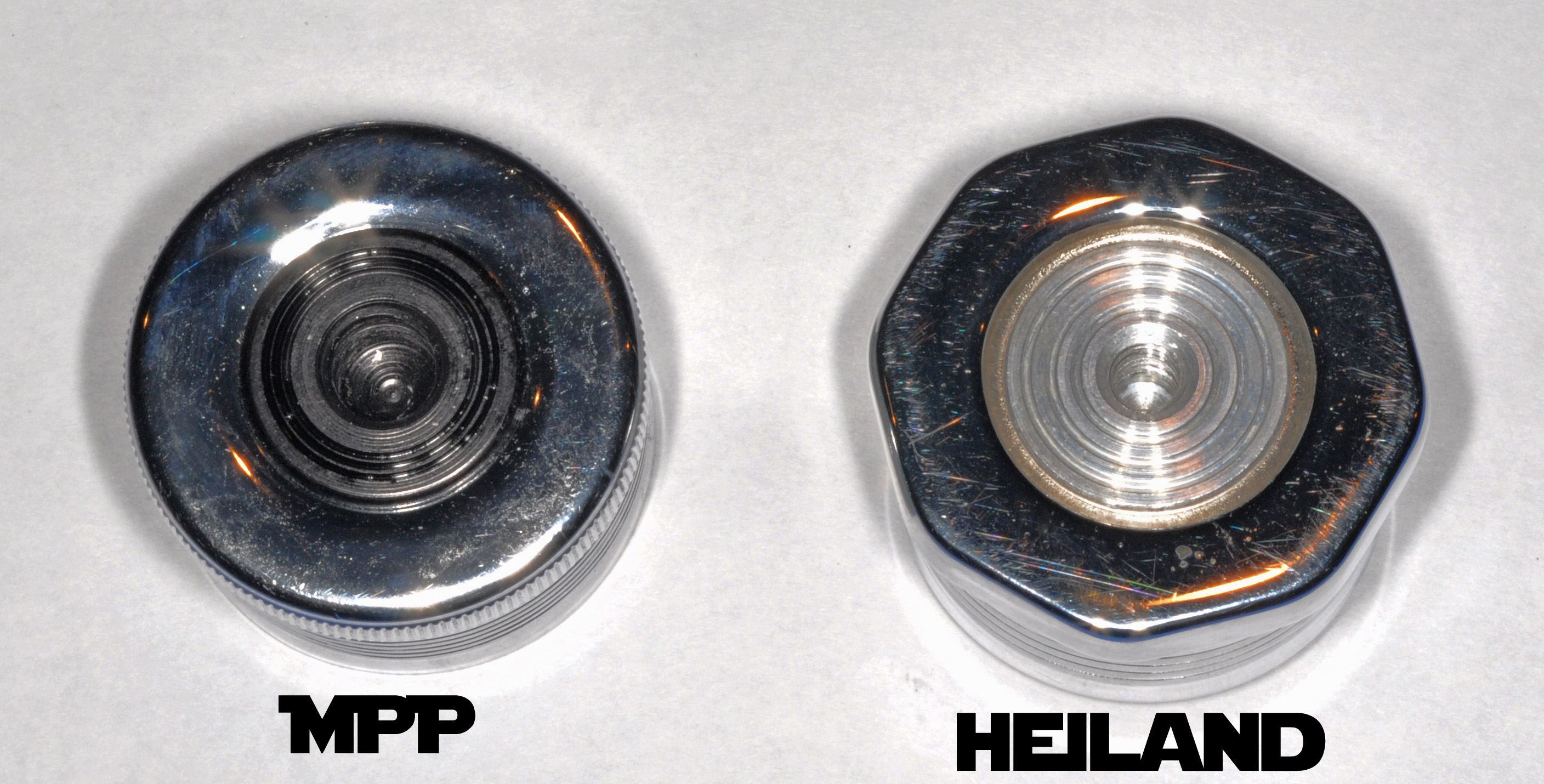

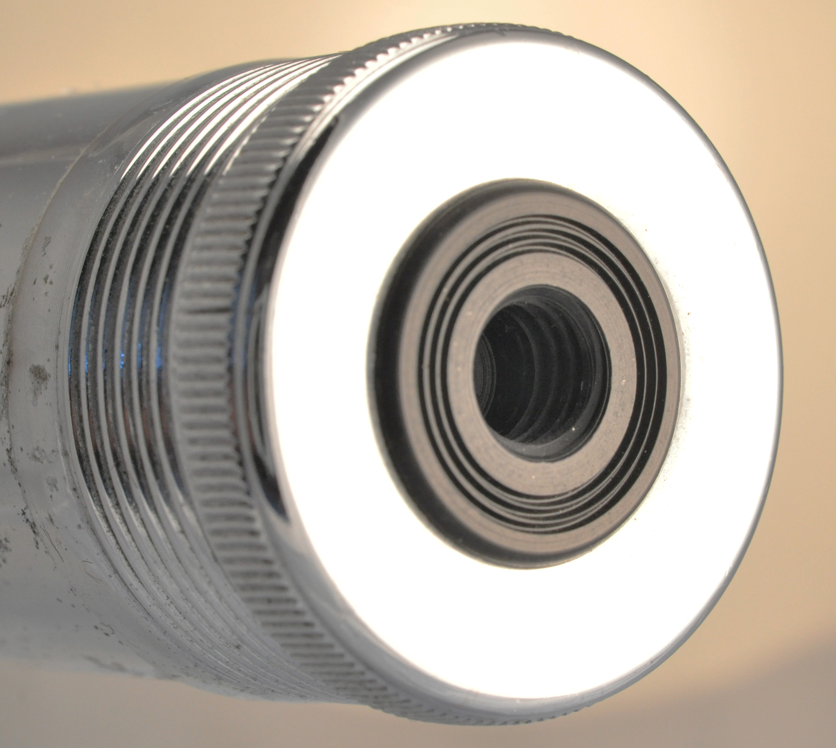

It is indeed a tripod socket. Some ref pix if you could use them. Also, not all tripod sockets aren't the same size between the US and other countries, so there are converters which screw into the larger socket to make it smaller. You probably could just drill the knurled cap and glue/solder a converter socket in place. Might work, not sure. Worth investigating though.
Good luck with your build.

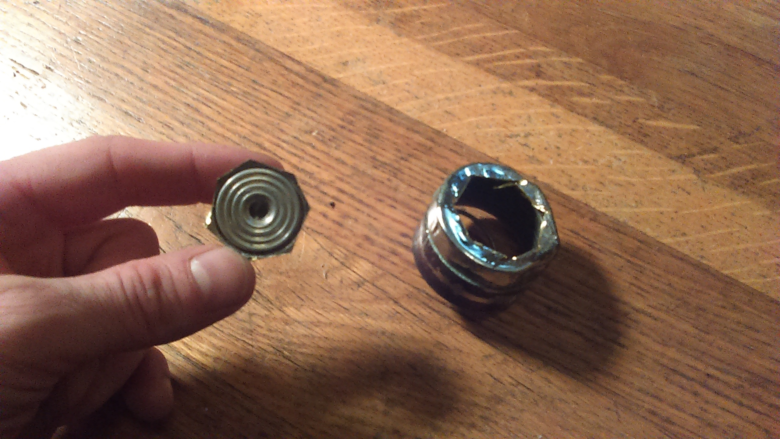

I got the tripod mount removed from the sad endcap and trimmed up. Sad endcap, your suffering is over.

I have the same two endcaps, I might try that too. What'd you do, just carve it out with a dremel grinding wheel?
Re: Creating a hybrid Heiland endcap MPP style. Pointers?
I used the cutoff wheel to rough out around the tripod socket, the sanding barrel to get rid of the leftover flanges, and finally I used a needle file by hand to get as round of a shape as I could; it's too easy to get flat spots with a dremel.

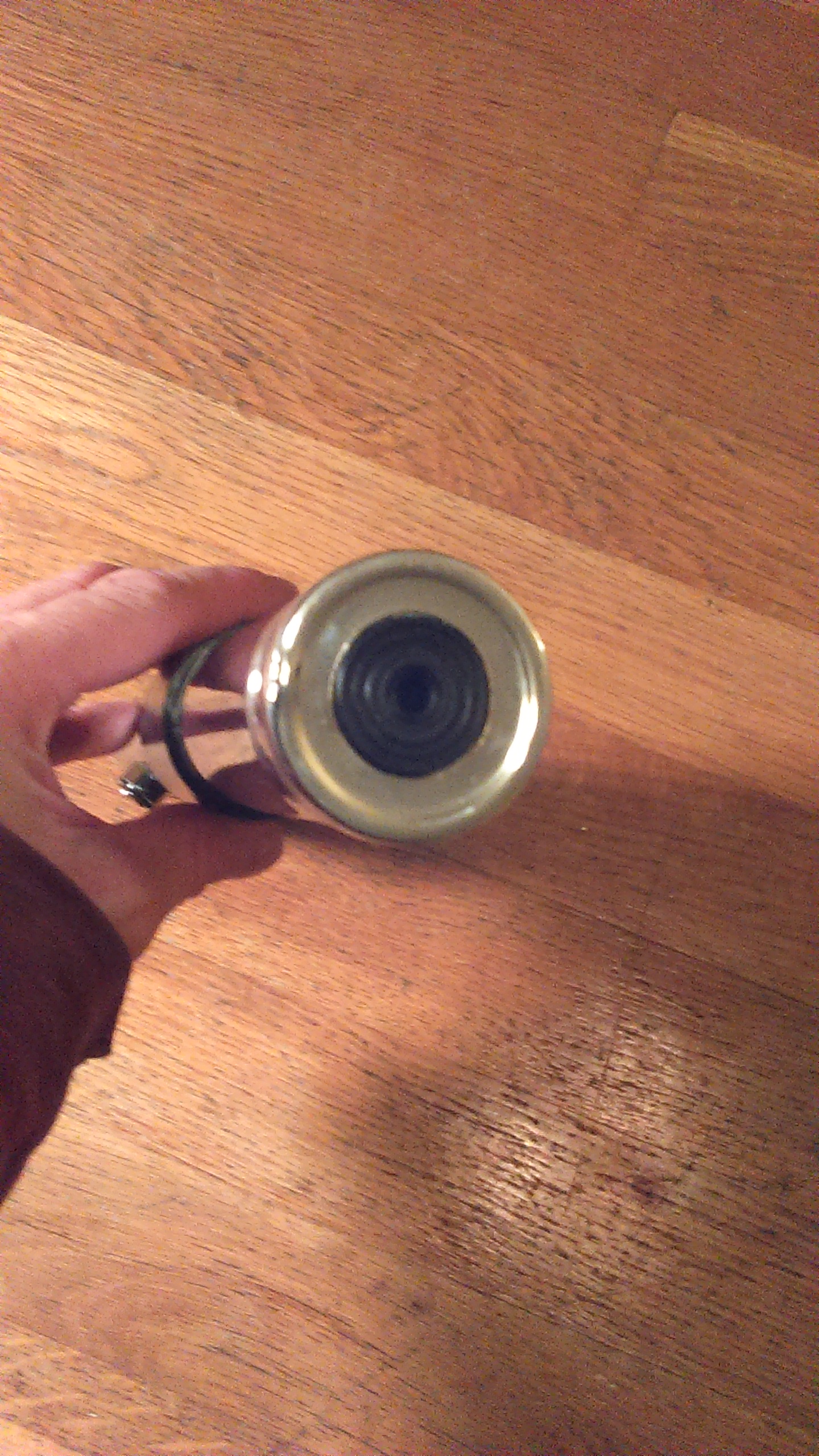

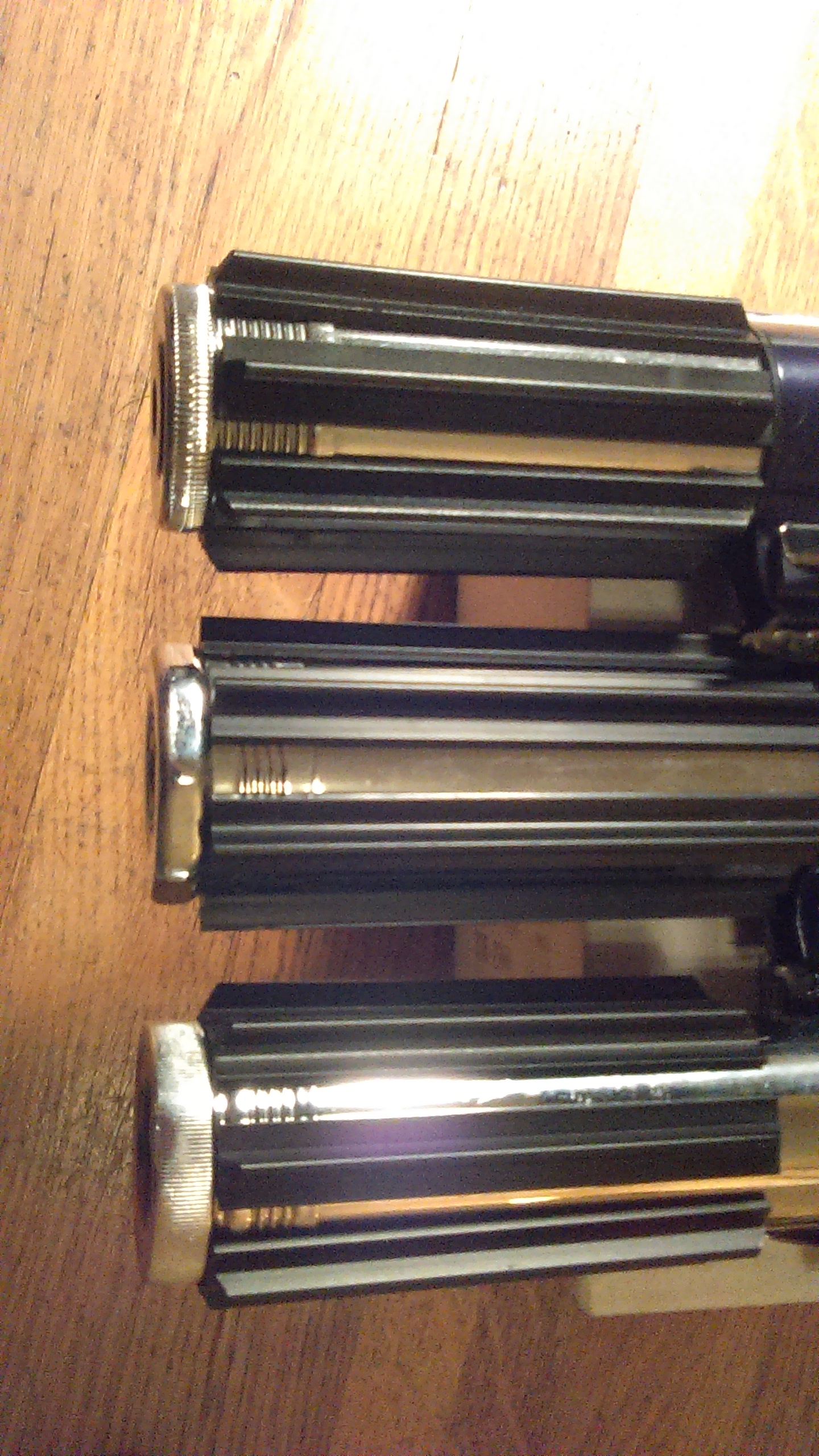

Mission accomplished! I drilled a hole in the center of the knurled and cap and filed it to size, painted the tripod socket black, and then used epoxy putty on the interior to hold everything together. I'm quite pleased with how it turned out :cool

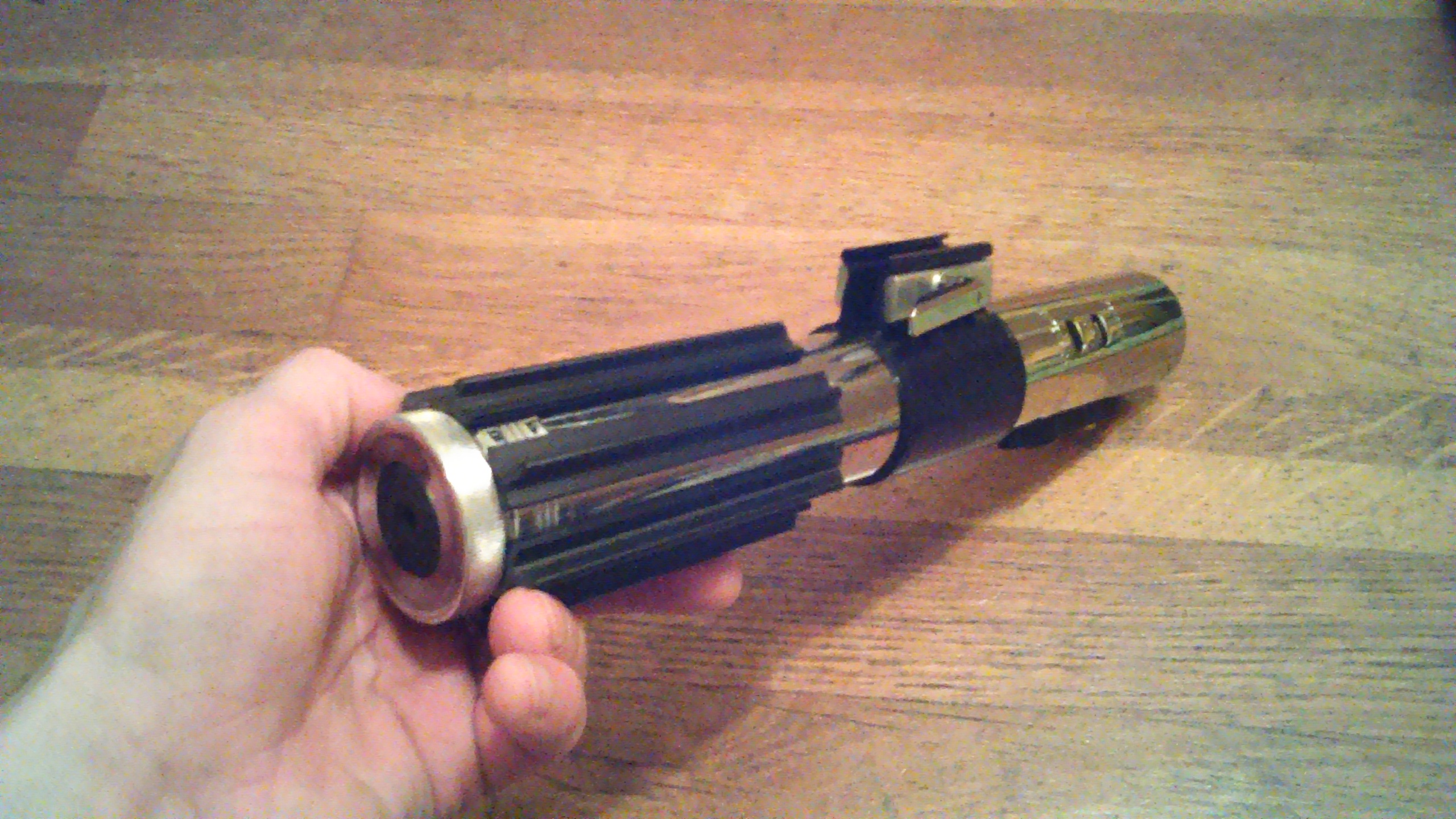

I couldn't resist posting some more pics. Got some t-track on this baby, and I must say that it accents the endcap wonderfully.
Obviously, I'm going for a Vader ANH V1 here.
Here we are next to my other Vader sabers. The ANH V2 on the left is a Parks MPP replica, the ESB in the middle is a Synchronar with the hex endcap, and the last one is the new one with the hybrid endcap.

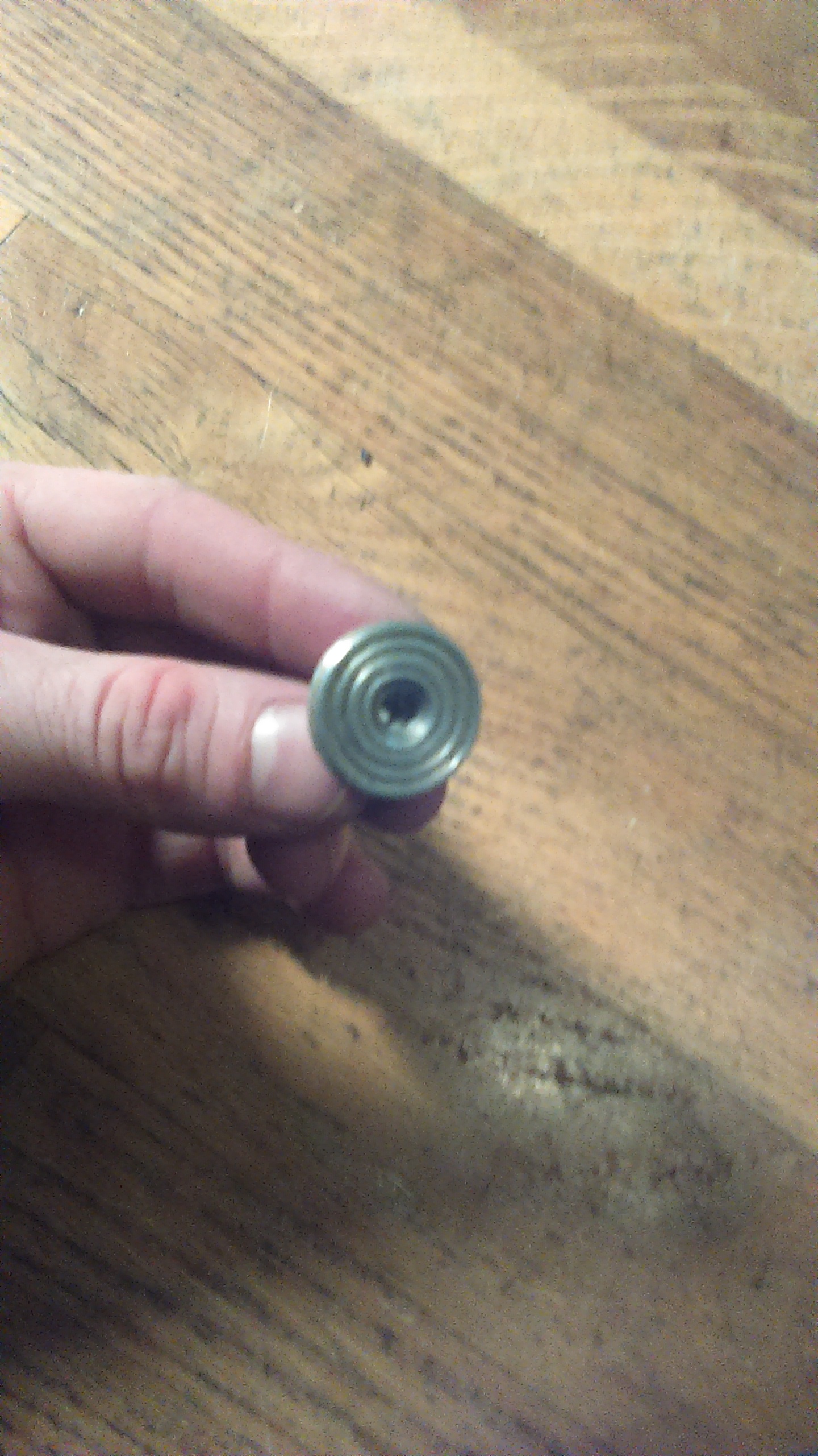

I just removed the tripod mount from the center of my Heiland end cap too. My end cap was in great shape though, so I wanted to remove the center without damaging the rest of the end cap. That way I can fill the hole with something else and still use it on a custom saber if I want. The way I did it was I took the dremel's grinding tool to the inside of the end cap, and kept working it around the edge of the tripod mount until I'd removed enough material to pop it out with a hammer. The edges were a little rough, but easily cleaned up with the dremel.

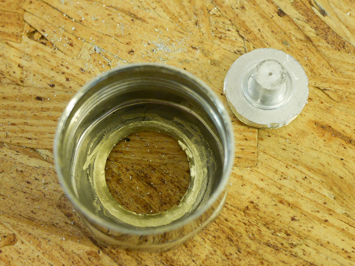

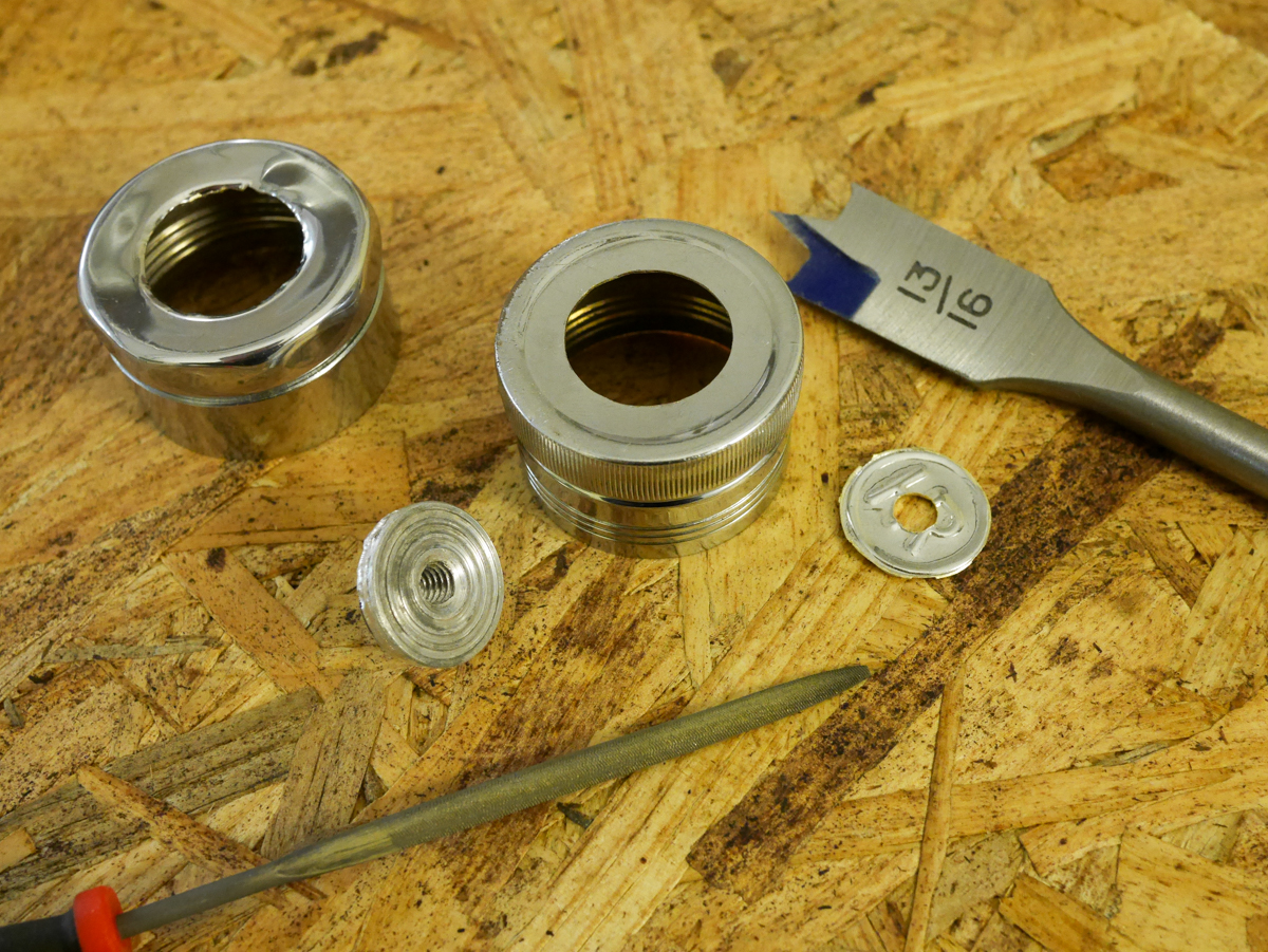

I drilled my other Heiland end cap and fit the tripod mount into it. It's not glued in yet because I need to paint it still, but I got a nice snug fit. Drilled a large hole that was a bit too small and used a file to widen it till the piece fit in. Took a picture of it next to my Larbel end cap too.
View attachment 611809View attachment 611810
Looking good! I can't wait to see this on a saber. It's been a while since I've seen a Larbel MPP, too. Very cool!
