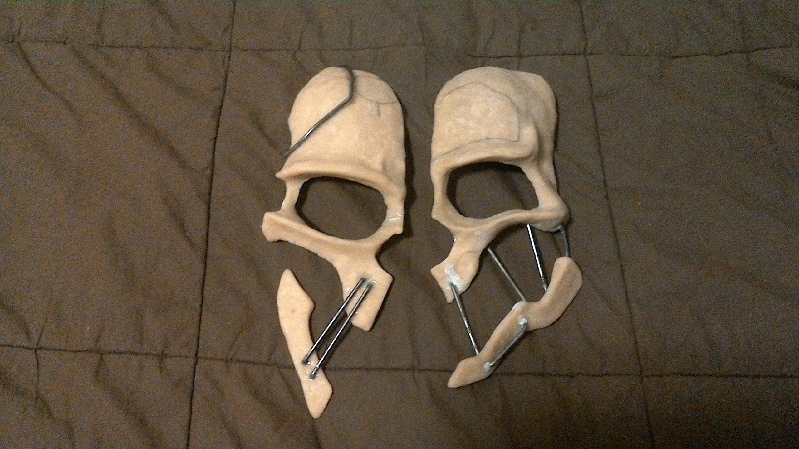

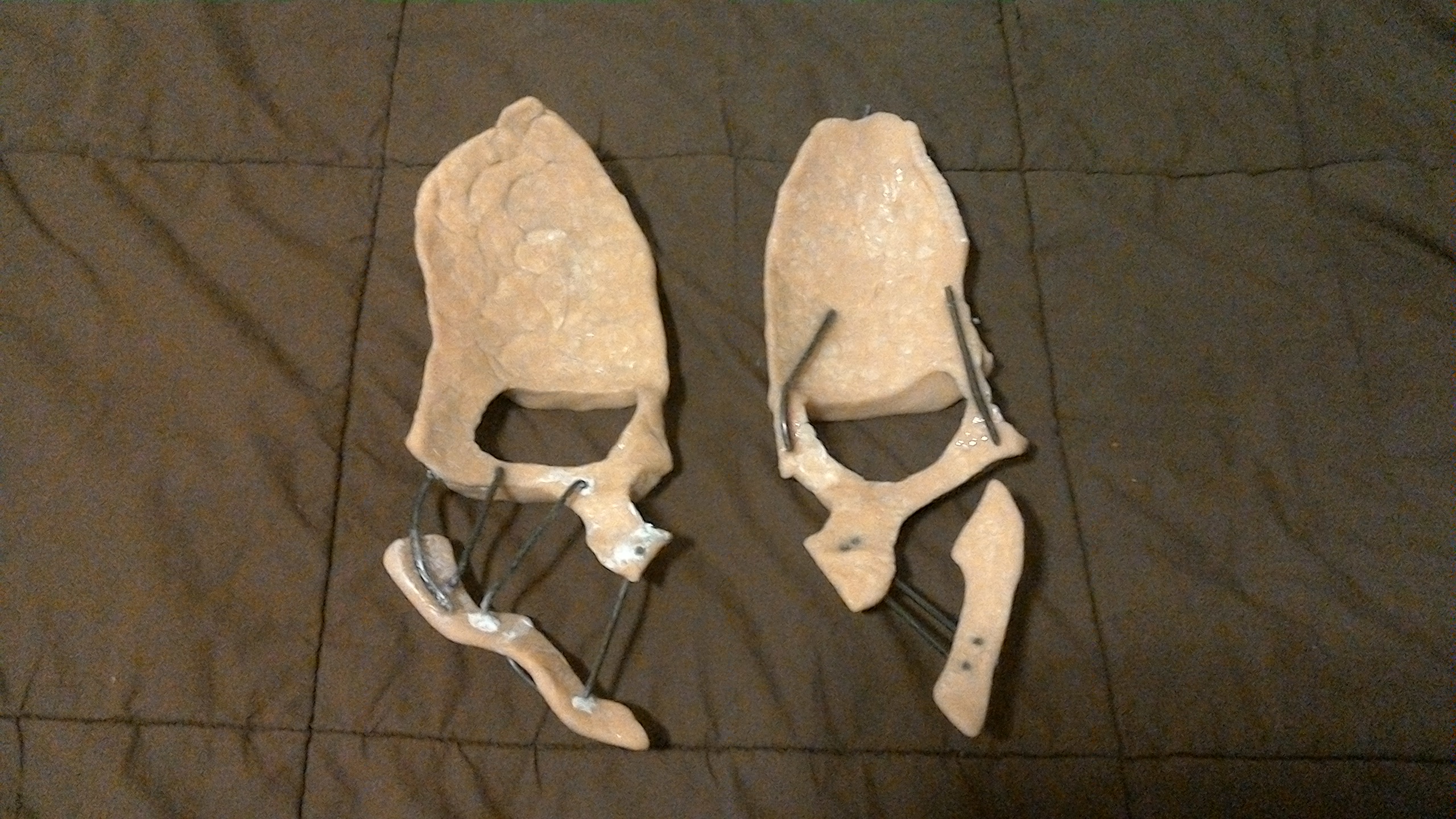

Instead of making a Super Sculpie mask into a mold, and making a cast from that, I plan on just wiring together and painting all the Super Sculpie pieces. There have been a few problems with this, primarily that the thinner areas (jaws and areas around the eye socket) have broken a time or two and in hindsight I should have painted the pieces before wiring them together, and if you are looking to make your own mask, I'd recommend doing the mold and cast.
Anyway, this is the picture I've been primarily using and my progress so far.
I still have a few more wires to glue, which I've been doing by bending the wire the way I want it, then turning the ends at 90 degree angles and gluing them into holes drilled into the two pieces. The wires I found are some type of landscaping staple that I found in a mystery box in the garage. They're pretty stiff so it would probably have been easier to use something else but the slightly rusted condition I found them in adds a nice aesthetic.

P.S. The two wire's glued to the back are there to hopefully prevent the eye sockets from breaking again. (the other sides' eyes are sculpted a bit thicker so they don't have this issue)

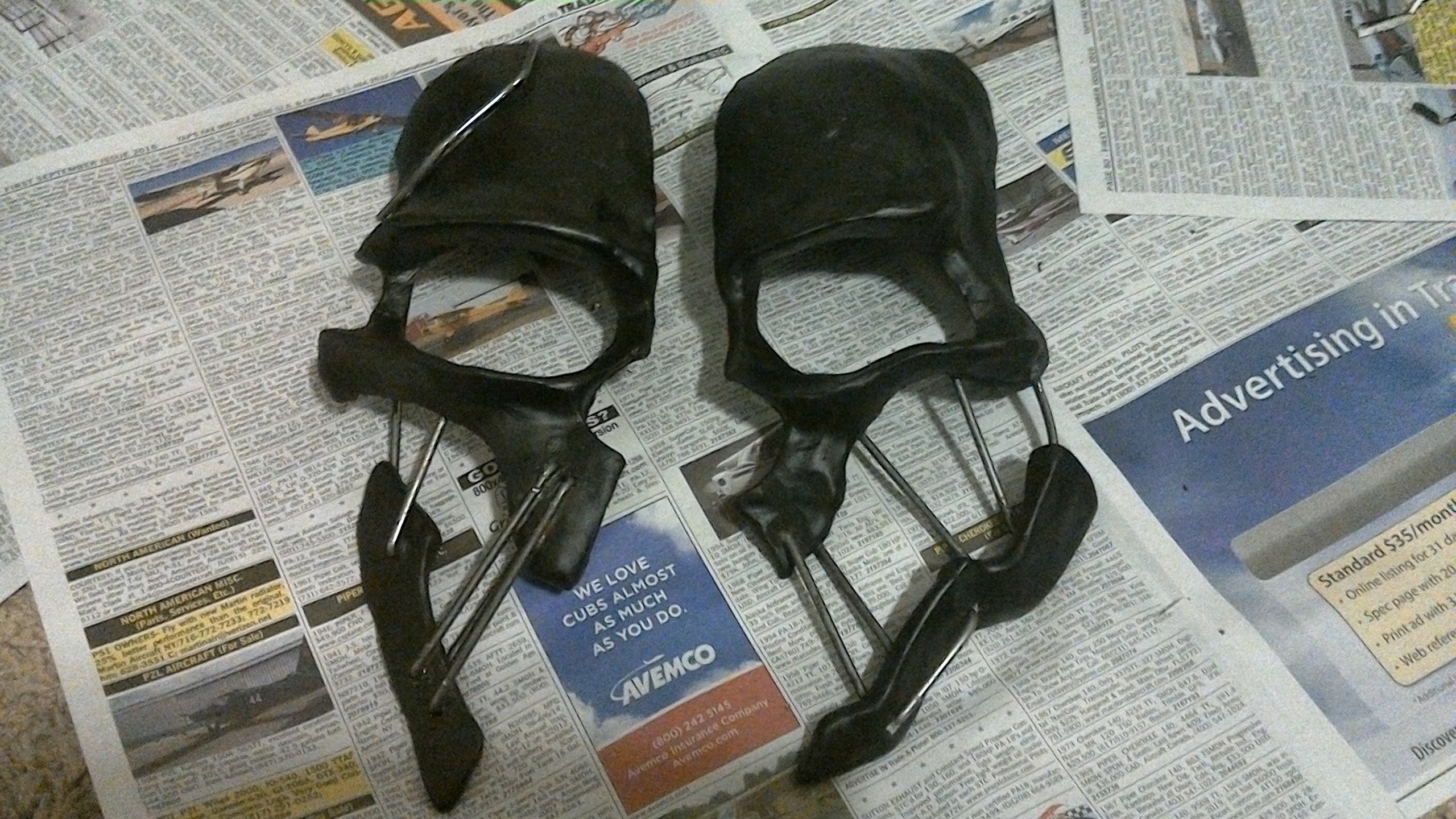

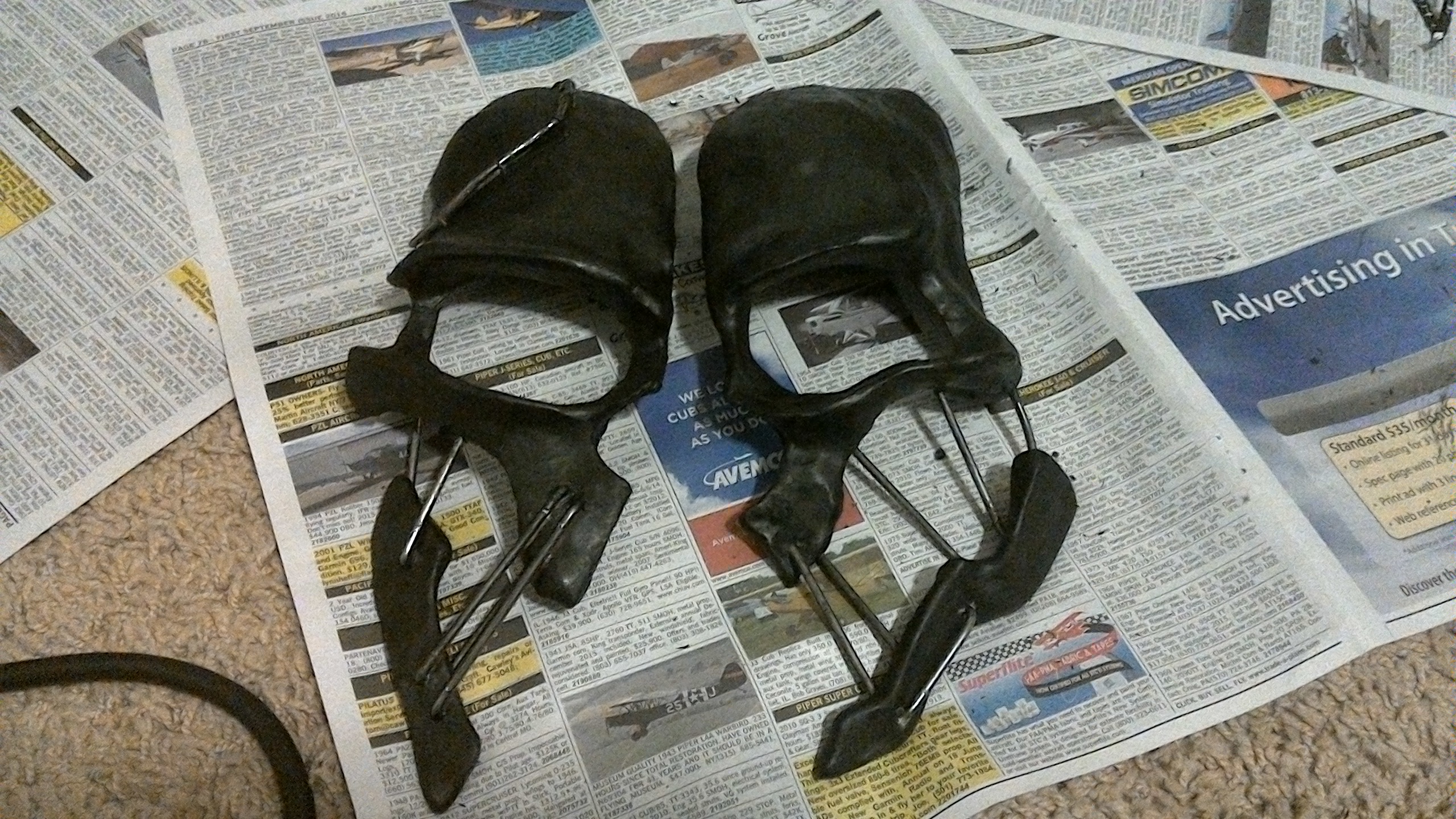

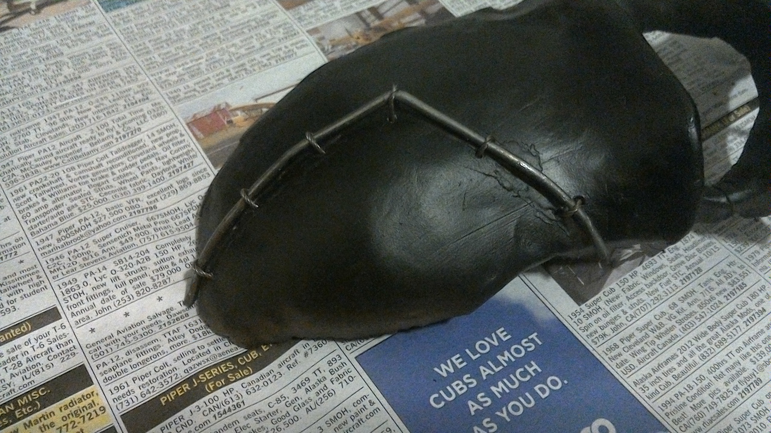

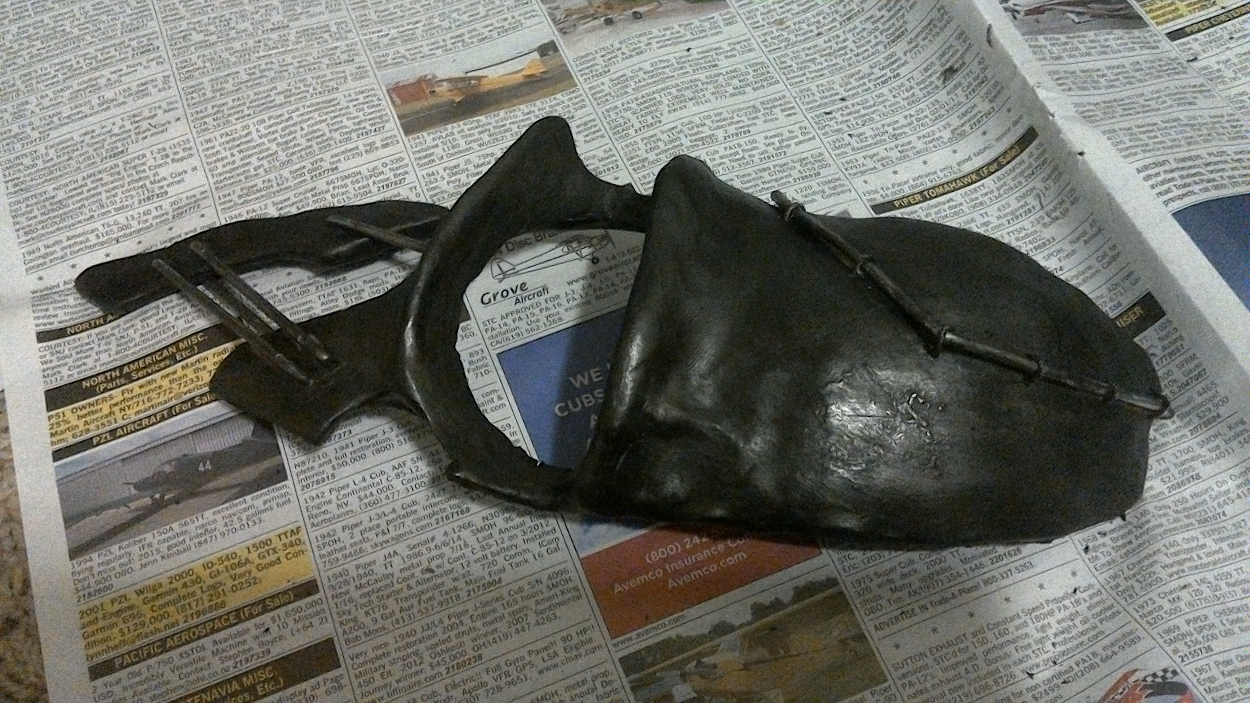

I've spent about an hour and a half with the spray paint and Rub n' Buff tonight and painted the mask. I've also put in the small wires that appear to hold a larger wire in place on one side of the forehead. I used a matte black spray paint and ebony Rub n' Buff to try to hinder any glossy appearance.
WIN_20161014_00_05_32_Pro.jpgThis is the mask after spray painting but before Rub n' Buffing.
WIN_20161014_00_30_59_Pro.jpgThe small wires are bundles of 4 thin wires wound together and inserted into small holes either side of the large wire and twisted together behind the mask.
WIN_20161014_00_58_48_Pro.jpgThis is the same half of the mask as the previous picture, only after applying Rub n' Buff. The Rub n' Buff, when applied on the heavier side of things, dampers the inherent gloss of the spray paint, covers up any fingerprints leftover from sculpting, and gives a nice uneven aesthetic.
WIN_20161014_00_58_38_Pro.jpg This is the assassin's mask as it is now. Next I need to find and fit the eye pieces, and begin working on a hood which the mask can be attached to. I also need to make the decorative circular piece near the top of the head. There is one more jaw wire that I'm leaving out until the two halves are connected and fixed to the fabric hood, as its the wire that connects the area below the nose on one half to the end of the jaw on the other. Since these are two thin areas of the Super Sculpie, I'm going to use a more malleable wire to reduce the risk of another break.

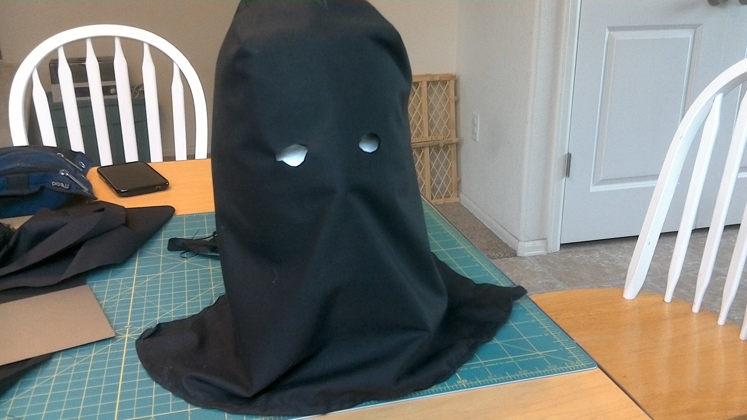

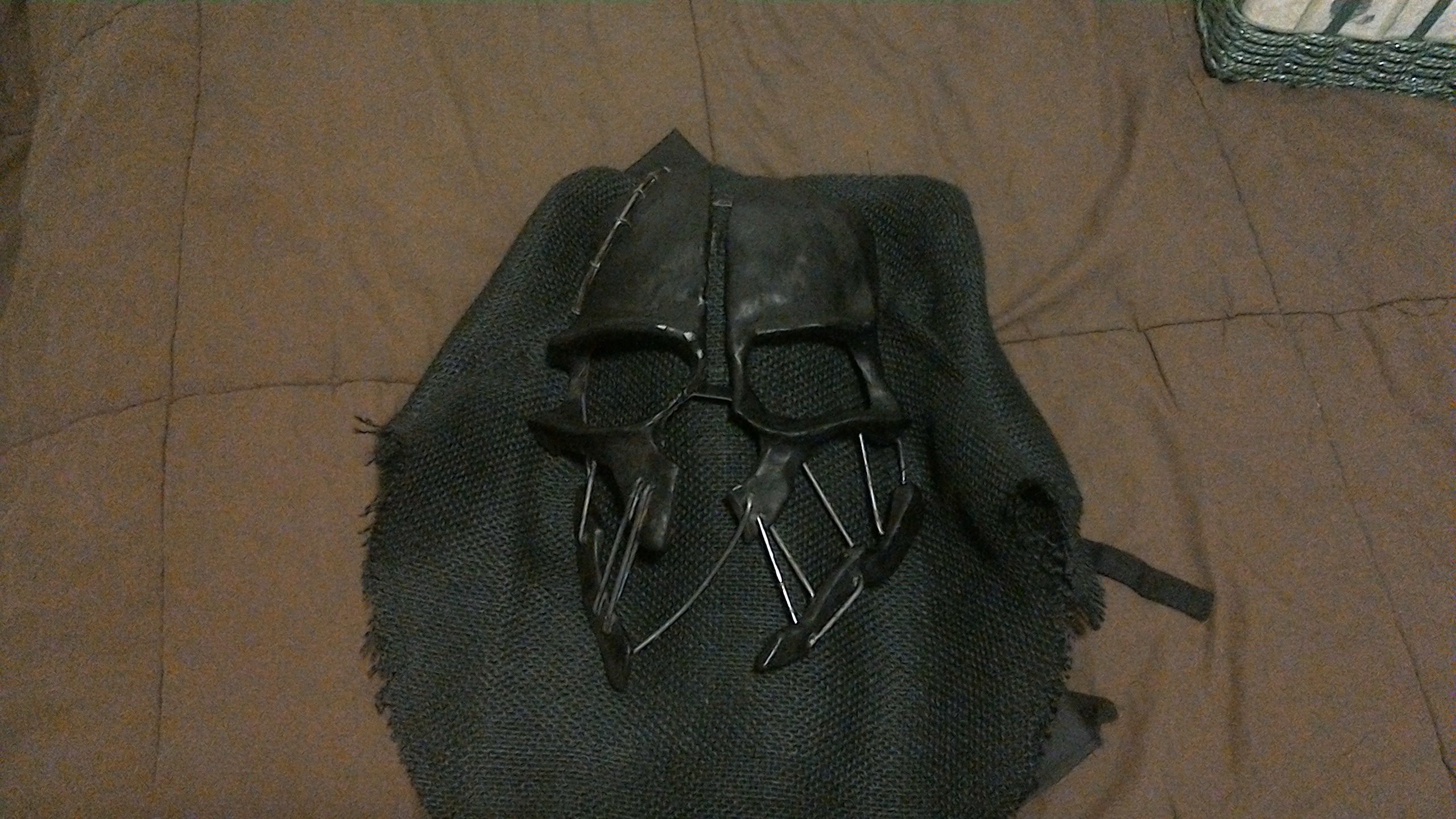

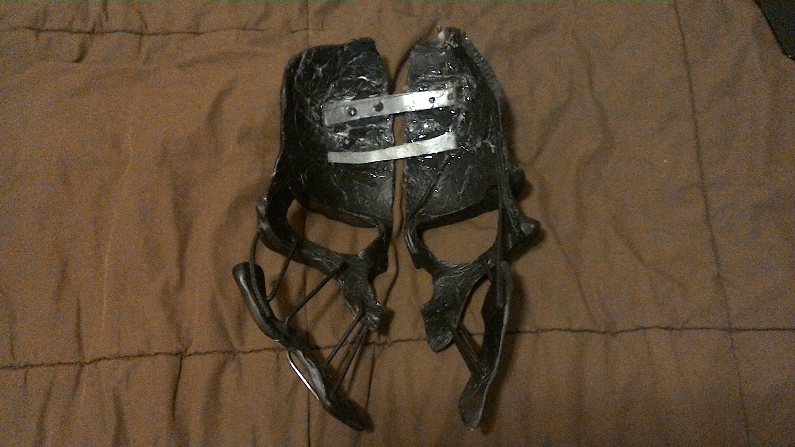

Just before Halloween, I went ahead and connected the two halves of the mask and created a hood to attach it to. I used three strips of steel cut from an old computer case to connect the face together (second most frustrating thing I've done in my life). Then, with some help, I made a simple hood witch an adjustable button from an old hat and covered the front side of the hood with a layer of black burlap material and cut holes in the first fabric so I can see through the burlap. Using some superglue to hold the mask temporarily in place on the burlap, I then tied some of the jaw wires and the steel connecting strips to the fabric hood to hold the mask on more securely.
WIN_20161024_00_50_11_Pro.jpgThe steel strips glued to each side of the back of each side.

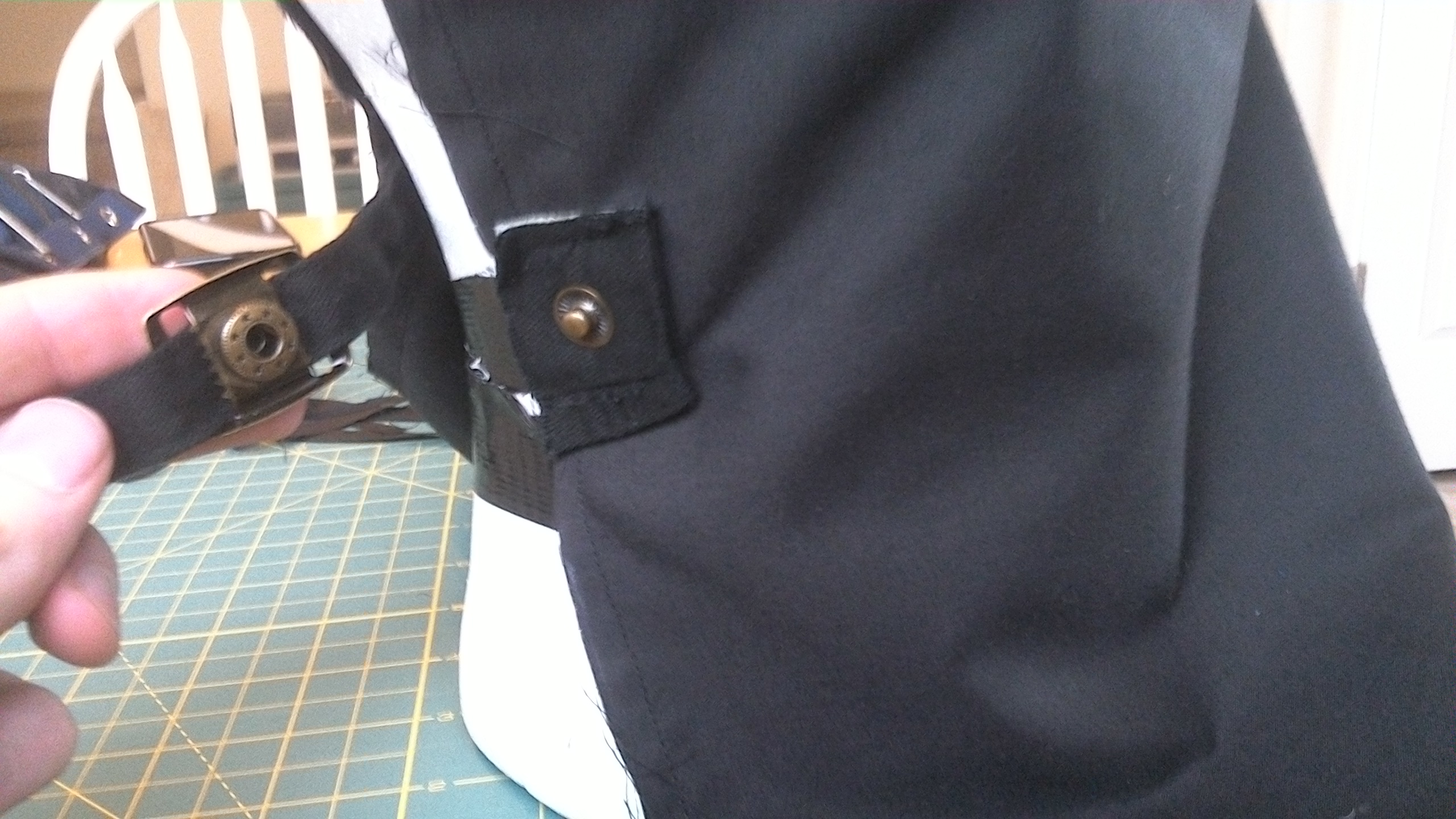

WIN_20161028_16_35_10_Pro.jpgAdjustable button sewn to the back of the hood. The top of the hood is sewn together in a similar way.
WIN_20161028_16_35_21_Pro.jpg Eyes cut into the first layer of the hood. I later made them into a slot for better peripheral vision.
WIN_20161028_20_50_24_Pro.jpgBurlap layer with folds sewn into it in the same way as the hood to fit it to shape and sewn to the hood with the mask glued and tied on.
I've also made the final wire connection from the lower jaw on one side to the upper jaw on the other. This was done after the two sides were connected by the steel strips to prevent any breaking of the two thin areas the wire joins to.
