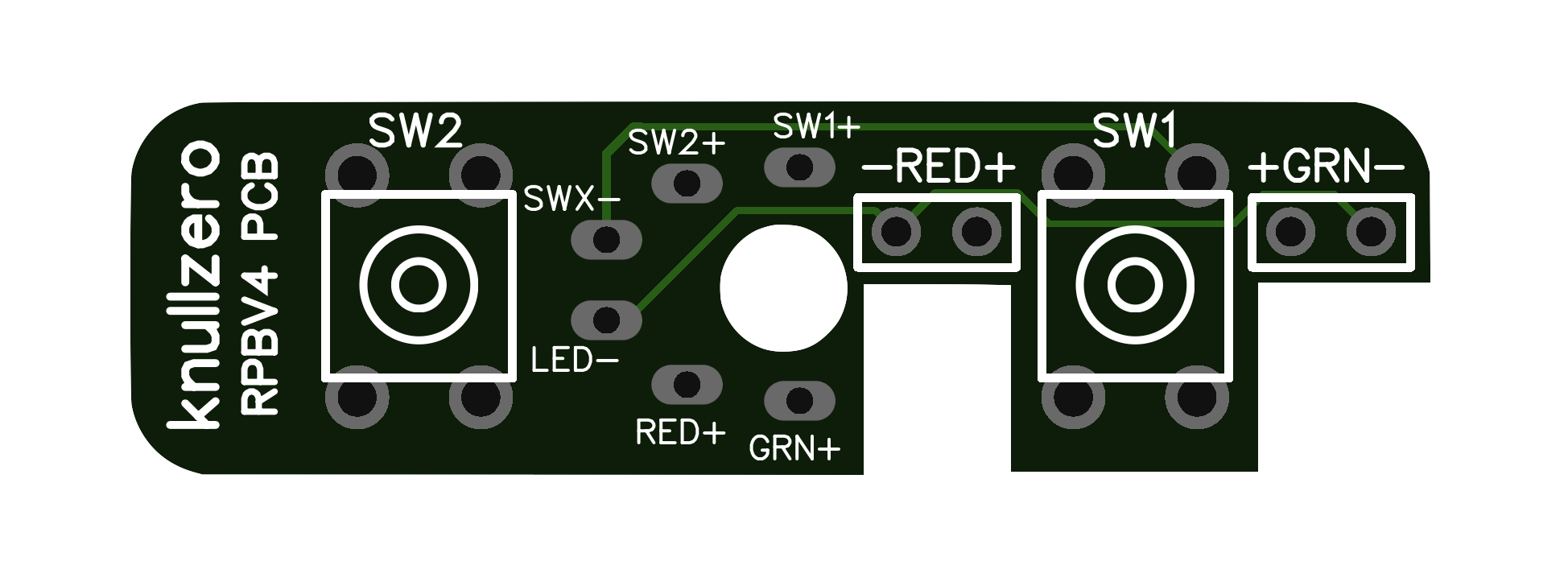

Major update for everyone... I finally got some time to do some drilling, break out the soldering iron and put everything to test. I drilled the required holes in the copper lid and the pass-though switch activation using the circuit card works great, I just had to sand down the bottom of the card a bit. I also drilled the holes for the triangle inserts. I soldered the LEDs and switches to the PCB and connected everything to a PCv4 I had to test with. The LED illumination looks great so far.
But there is some really crappy news... There is a connection on the PCB that is bridging the switches together. There is no easy work around so I have to modify the design and reorder the boards. I'll get the design updated and reordered tonight or tomorrow, which will mean another 7-10 days wait time before I can ship. I am really sorry everyone, I know everyone is ready to get their sabers installed.

Here is the revised PCB:
The cutouts will allow for the LEDs to be mounted and centered against the triangle inserts. The video I posted was using four LEDs (coming off two accent pads still) in a PCB sandwich configuration. The problem with this is that it raised the PCB a little bit too high plus added a more challenging mounting job for the LEDs. The PCB will sit on top of the control box screws and lid will press against the tactile switch tops keeping everything secure.
The LEDs I am using are simple 2x3x4mm white LEDs. In the video I didn't use anything to separate the light inside the box. Based on the way the inserts are flush with the inside of the box nothing was needed.
