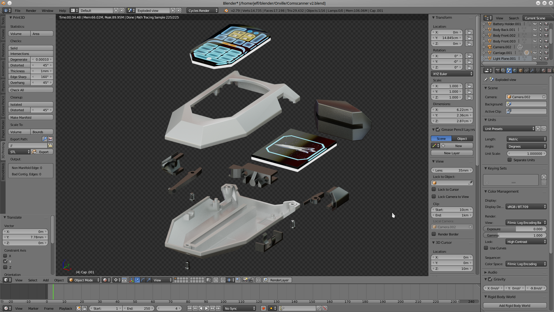

Here's my version of the Comscanner from The Orville. Modeled in Blender, printed on an Ultimaker 2+, sanded, painted, and assembled.
IMG_20180401_205521.jpgIMG_20180401_205451.jpg00000IMG_00000_BURST20180401210027_COVER.jpgIMG_20180401_203214.jpgScreenshot.pngIMG_20180322_225107.jpgIMG_20180326_185941.jpgIMG_20180401_150629.jpg
Apart from the 3D-printed parts, I used Lexan for the screens, graphics drawn in Inkscape and printed on laser transparency sheets, and the electronic components to light them up. And a couple of springs.

Thanks! Once I tweak out a couple of issues with the model (found another angle that showed I'd got the dark rectangle on the back slightly wrong, and need to make a little more room for the switch), I'll be putting it up on Thingiverse with instructions, so anyone with access to a 3D printer (or who's willing to pay a printing service like Shapeways) can make their own.
