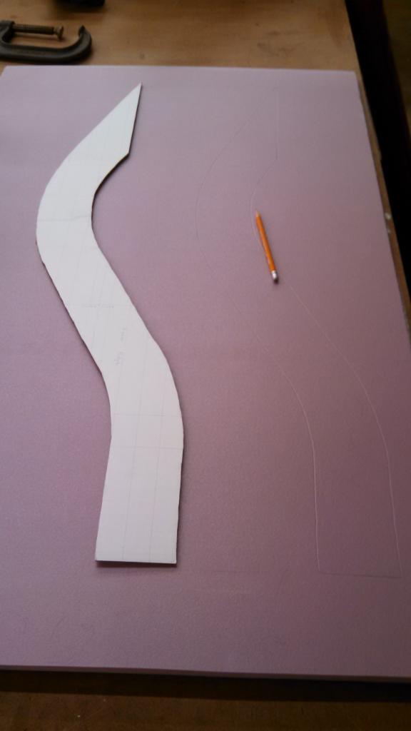

I started out with a sheet of cardboard 3ft. long, to create a traceable pattern for the sword blades.
I cut that out, then traced it twice onto 3/4" insulation board.

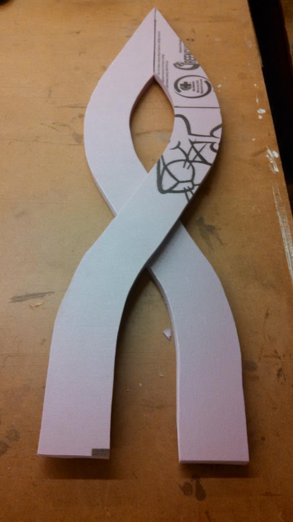

I cut them out with a utility knife, using very short sawing strokes to keep the curved edges intact.
I started to bevel the edges into the bladed shape using a belt sander. Not only was that a little hard to control, but it caught the tip of the first blade and tore it off, so I had to cut a replacement. (Luckily a 8'x4' sheet gives you plenty of foam to work with.) I decided to use the utility knife to bevel all the edges.
Time for sanding! I used 150 grit sand paper to mostly even everything out. If you run your fingers over the flat of the blade, you can still feel a slightly uneven surface, but that was necessary to maintain some semblance of integrity in the blade while also maintaining the right shape.

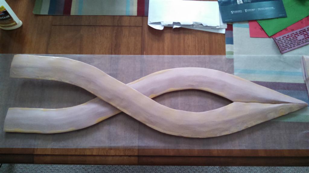

I cut two 1' x 6" sheets, glued them together, then set about carving and shaping the cross-guard.
I tested a wood glue coating on a test piece. It looks like it tends to crack with any flexing, and with a weapon of this size the foam is definitely going to flex, so I will probably do 2-3 coats of wood glue on the entire sword before painting.

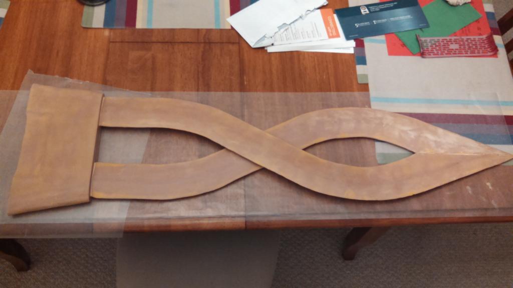

The Modge Podge was a no go. It looks like a great product, but with two applications both requiring FOUR WEEKS to cure, I couldn't use it. After all, the recipient's birthday was January 5th, and I wanted it done by then. So I opted for the wood glue route, with 3 coats on each side of the blade/guard. Then I hot glued the top of the blades together prior to painting.
I used a rotary tool to carve out a slot in each blade bottom and two in the top of the guard, coated popsicle sticks in wood glue and inserted them into both parts, then kept them compressed for a few minutes until the tack held them together enough to dry completely.
With a combination of a belt sander, band saw, and hand sanding, I filed down one end of dowel rod handle. After drilling a hole into the guard, I wood glued the handle into the guard. Then I cut out thin craft foam for the three dimensional details at the base of the blades and guard. Finally I taped off the areas supposed to be green and it was time to paint!
Two coats of paint in close succession produced an unfortunate cracking effect. A third coat of paint fixed it, but I feel it is important to document this in hopes someone else won't make the same mistake.
