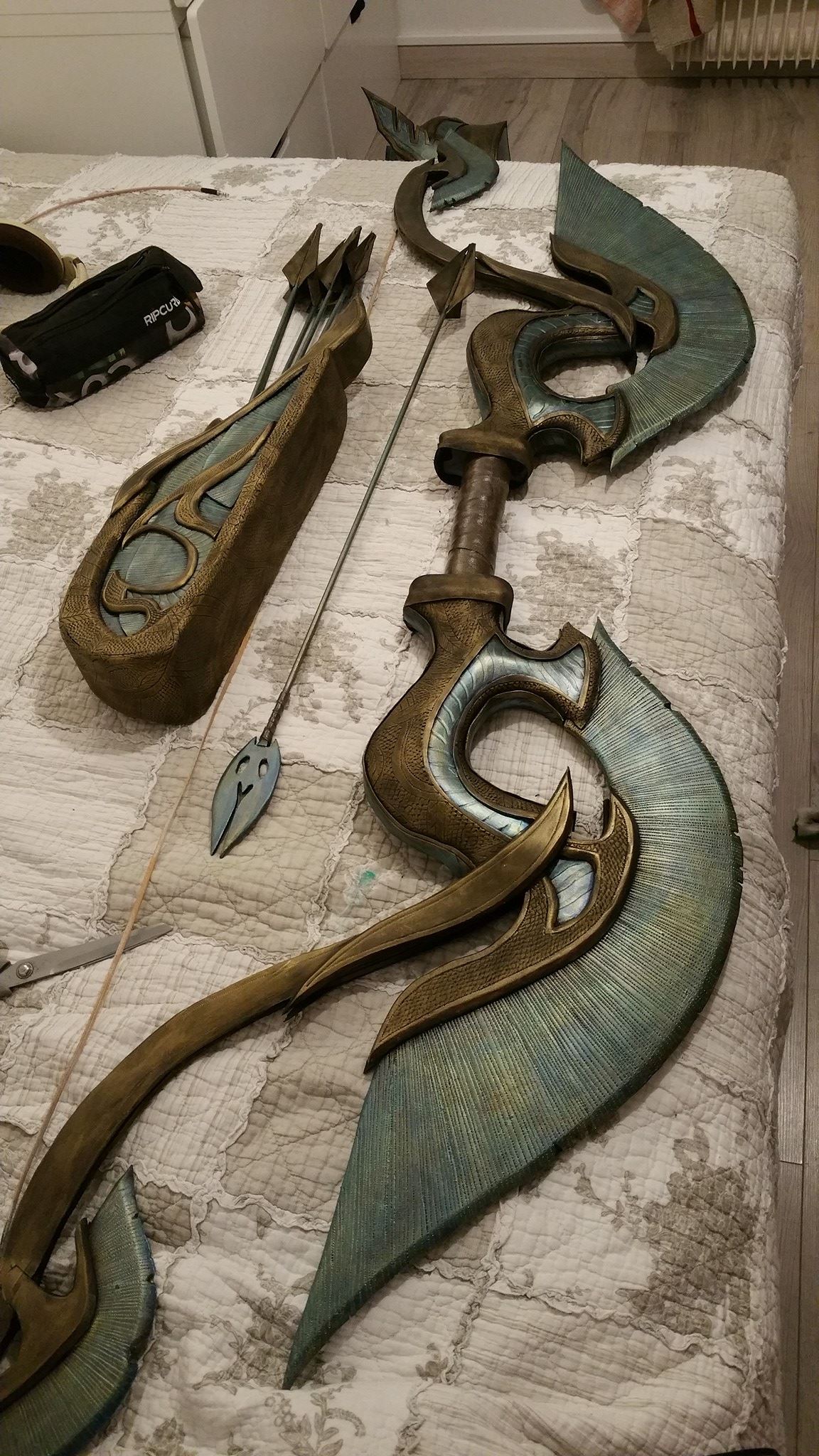

I'm building this out of EVA foam (density 100kg/m3, thicknesses 10,5 and 3mm), with a multilayer pipe as a core for support.
After making my pattern (by using a screenshot as a layer in GIMP and redrawing the main lines), I started making the glass blades, which looked like this at first:
I started detailling them a bit:
And I also made a sort of "size test" on the floor...the white tube is the multilayer pipe I was talking about.
I only started this yesterday so there isn't much to see for the moment, right now I'm working on the limbs.

I'm still building the "base". Since the in-game model seems to have multiple "layers", I'll probably use craft foam to make this kind of details. Besides the multilayer pipe which holds the big glass blades and the handle together, I put a strong steel wire inside the "limb" I just added (I think I'll attach the string to it as well).
It's attached to the pipe like this (I know, it looks disgusting but it works...)
(I still have to bend it a bit more to be sure it won't move)
The bow looks pretty huge ingame compared to my character, so I made a pretty huge one in real life too (also, I'm not wearing the armor, which makes me slightly bulkier). The limbs are not symetrical at all since I just taped my pieces together to take a picture (I blame the largest "blades" in fact, one of them is in the right place while the other isn't).

Not much progress since last time (but I added some volume). I also have a video (with a really bad shooting posture, I'm terribly sorry), showing how the limbs move thanks to the steel wire (I'm still using an elastic string though, so the bow isn't actually functionnal).

My acrylic paint bends pretty well, I haven't had any problem with it yet...
Ok, the photoshoot was finally earlier than I planned, and I entered the rush mode, and totally forgot to update the thread since ! The finished thing looked like this:
We took really cool pictures (in the wiiiiild) with the full armor, the quiver, and the bow. I might do a glass battleaxe later.
