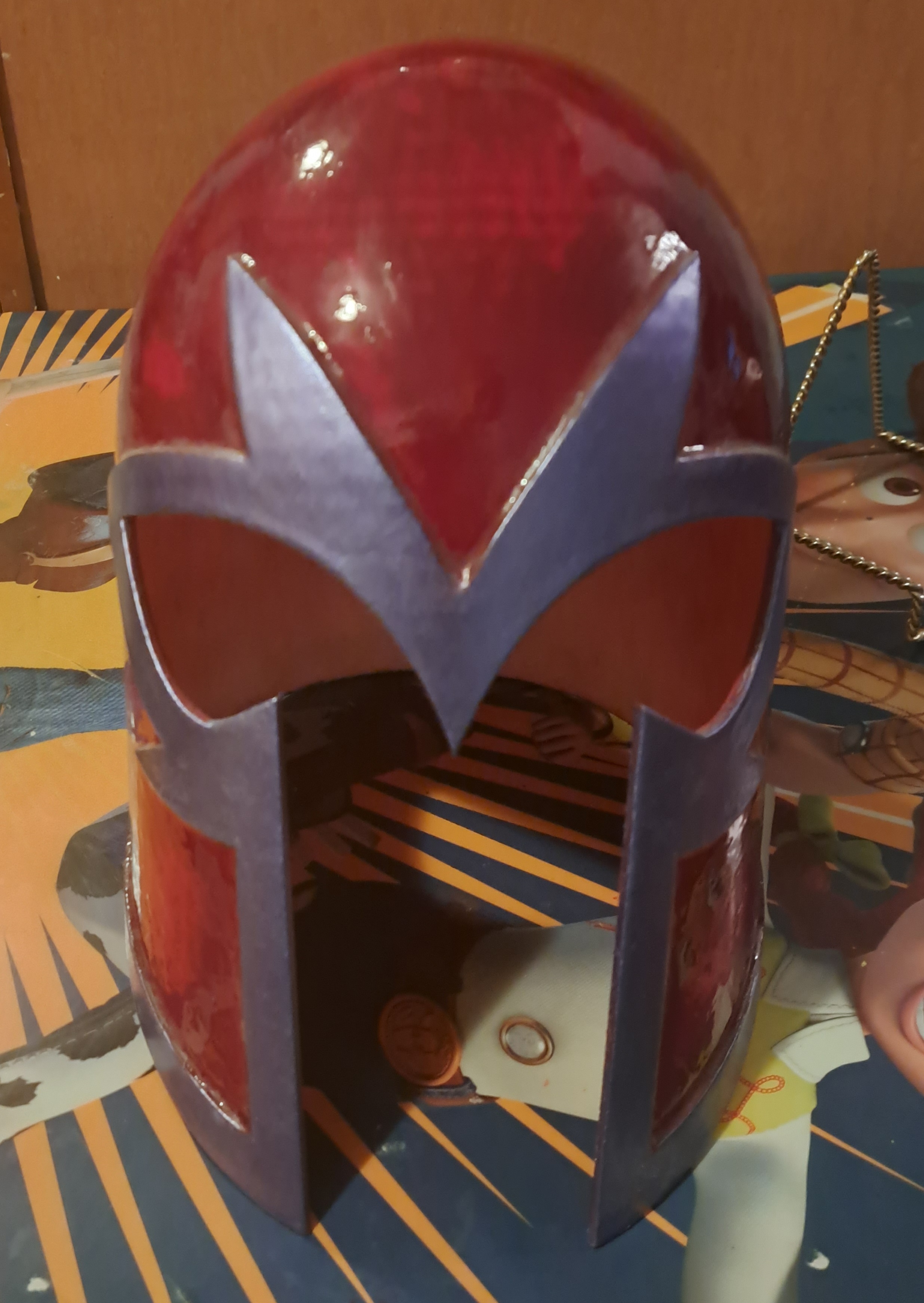

It is great work! I like the look of your helmet over my old one

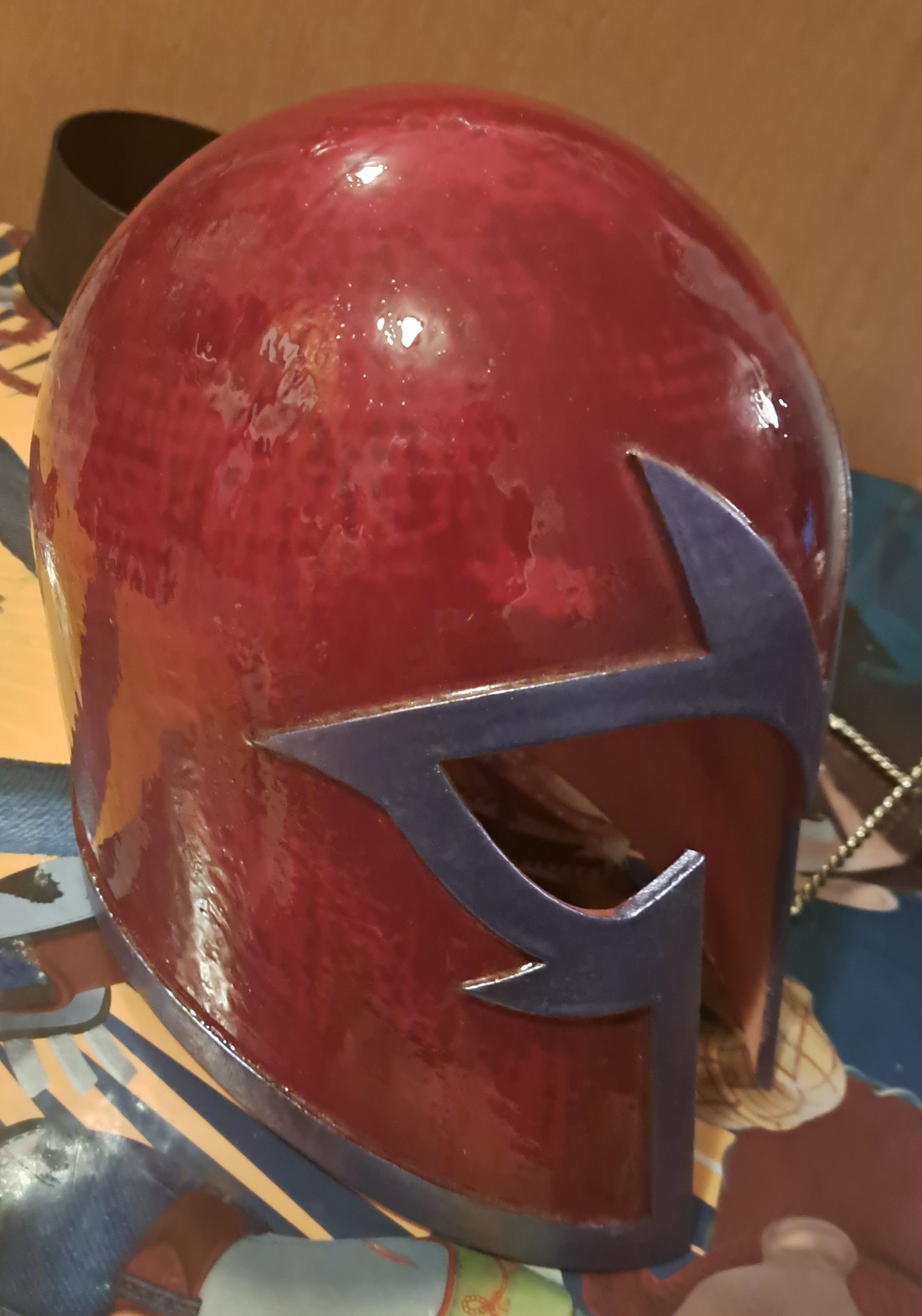

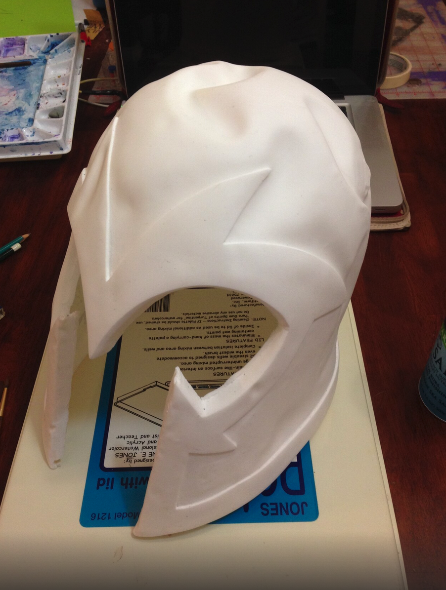

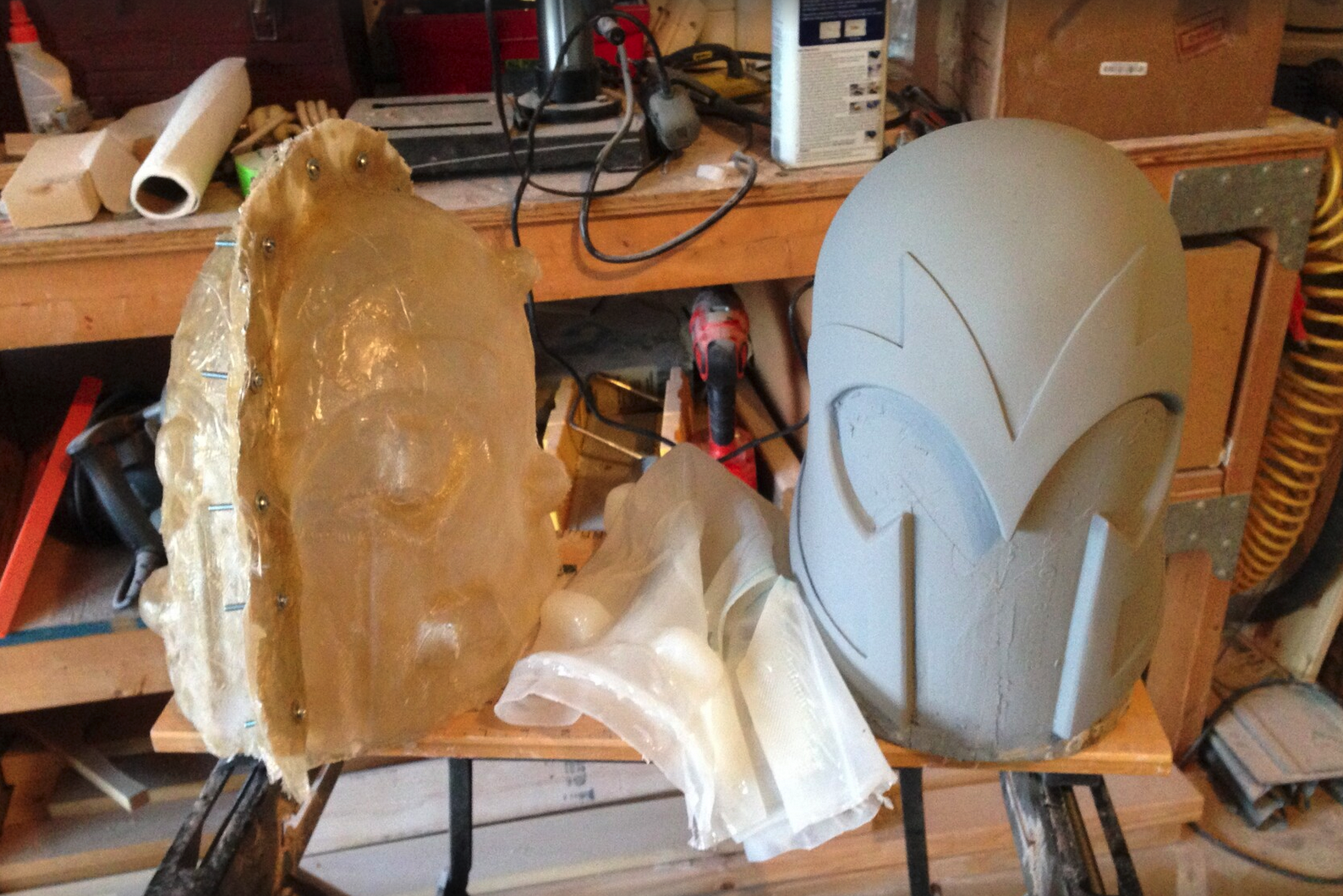

Yours is like the First Class X-Men movies, that's actually the one I tried to make 8 (!!) years ago.
It was the first thing I ever tried to make a mold of, and I did a hilariously thin amount of silicone. In the first photos that's actually it sitting between the sculpt and the mold jacket. I tried to cast it anyways and it was hella lumpy.
I used to really like the look of that one, but working on this one I wanted mine to be more like the early runs of the comics and/or the 90s tv show. Plus doing the bits around the eyes it finally dawned on me, after a lifetime of seeing this helmet, that the eye bits resemble an electromagnetic field.

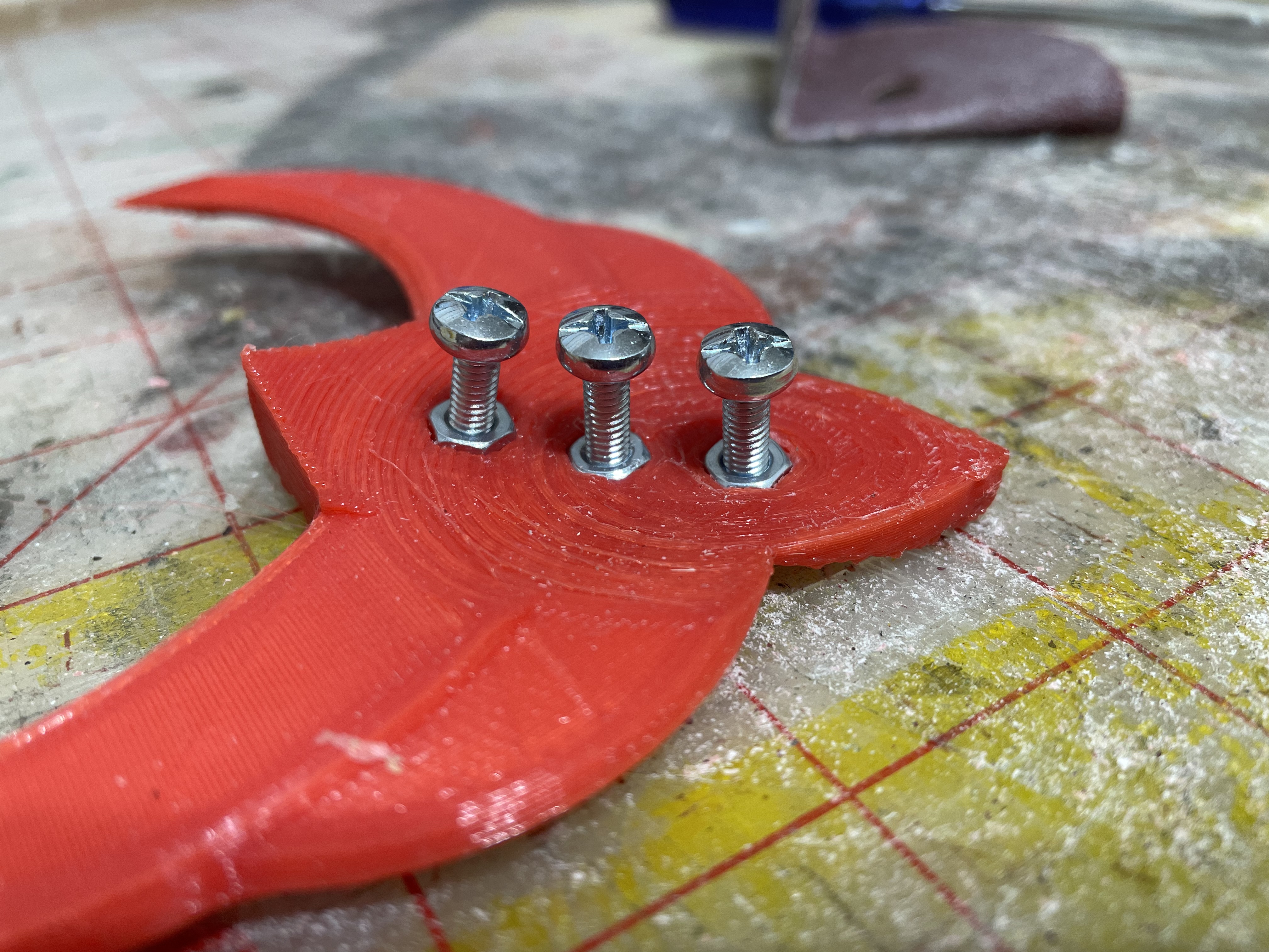

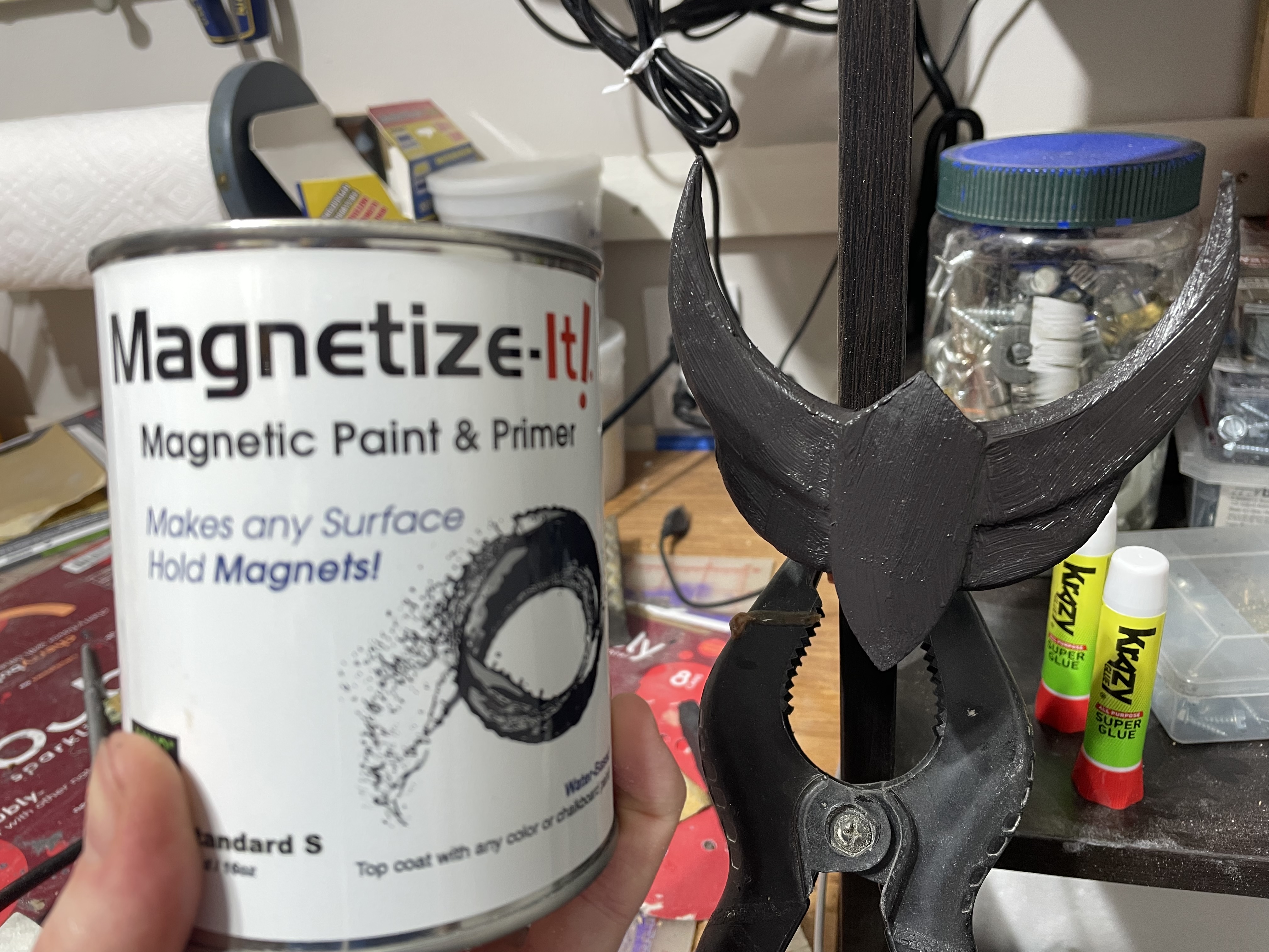

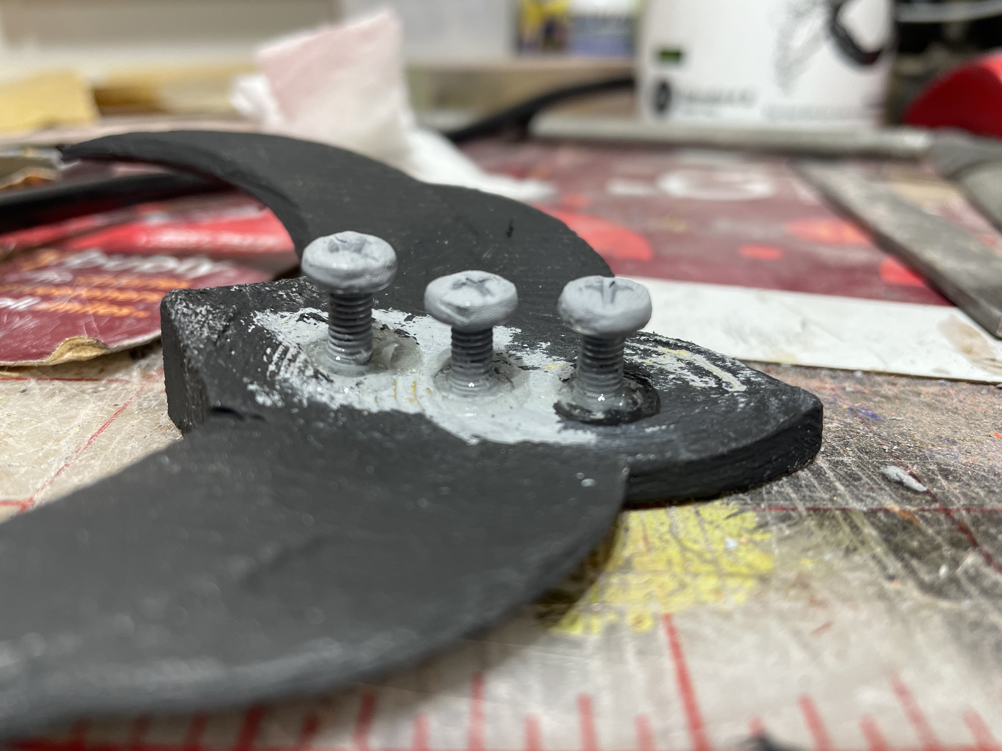

The crest is coming together. I thought it would be cool to make parts of this actually magnetic, but I misunderstood how this paint works. This is just paint with metal in it, so magnets will stick to it (kind of…), but it isn’t actually magnetized itself. So much for being able to stick paper clips to the crest, lol.
I’m going to attach it to the helmet with some screws. I left hexagonal voids in the back of the print, covered the bolts in Vaseline before treading nuts onto them, then flooded the entire thing with super glue. The Vaseline kept the hardware from getting glued together and then I was able to sand everything smooth after unscrewing them. It all worked pretty great actually.

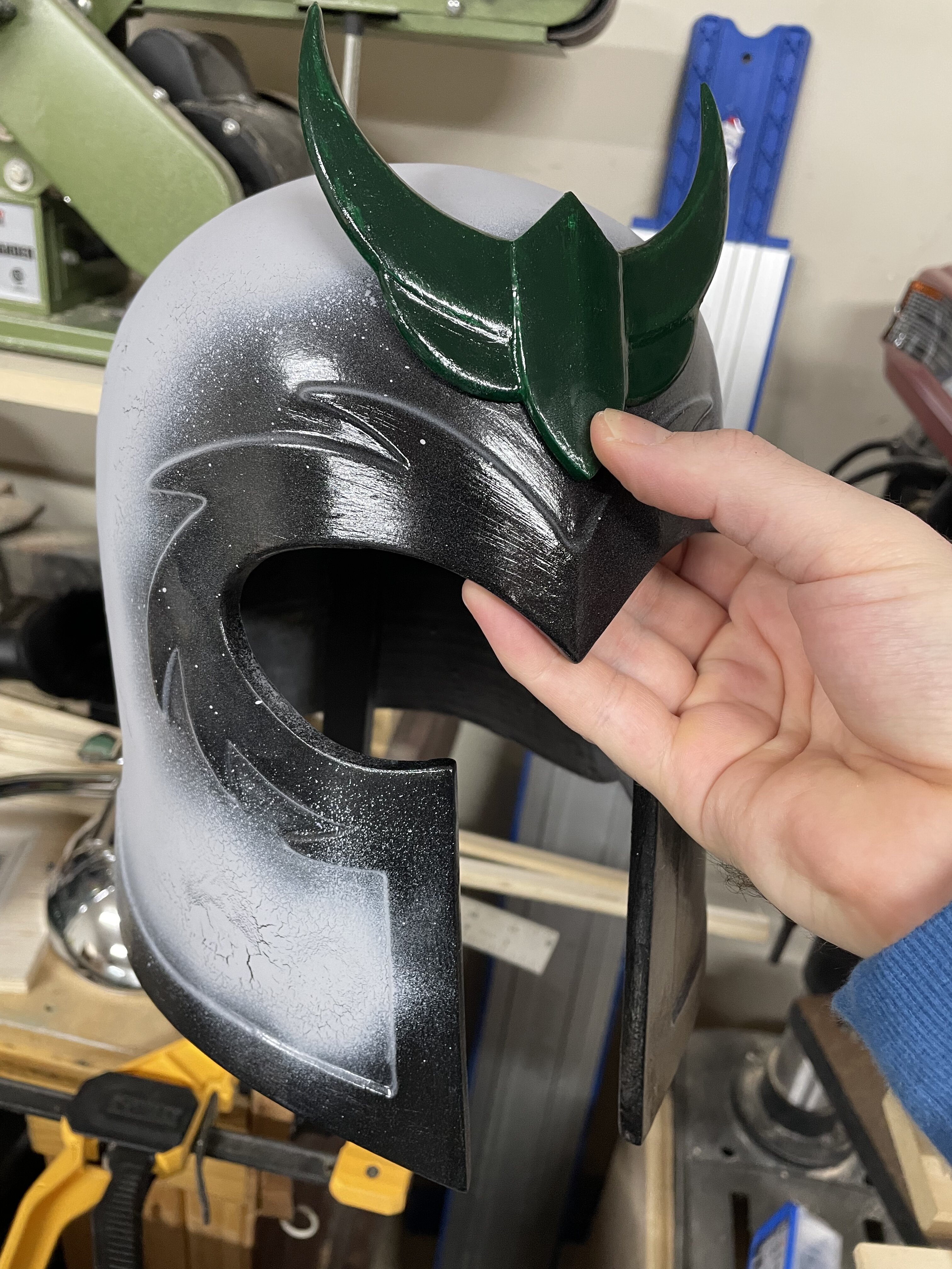

I’m getting really close to final smoothness on the dome, and the crest is nearly finished with sanding as well.
I plan to weather this fairly heavily, lots of textures and gouges. Is anyone interesting in a mold/cast of a clean version of this before I mess it up? Fair warning, it’ll be a while (summer, potentially) before I can ship anything.

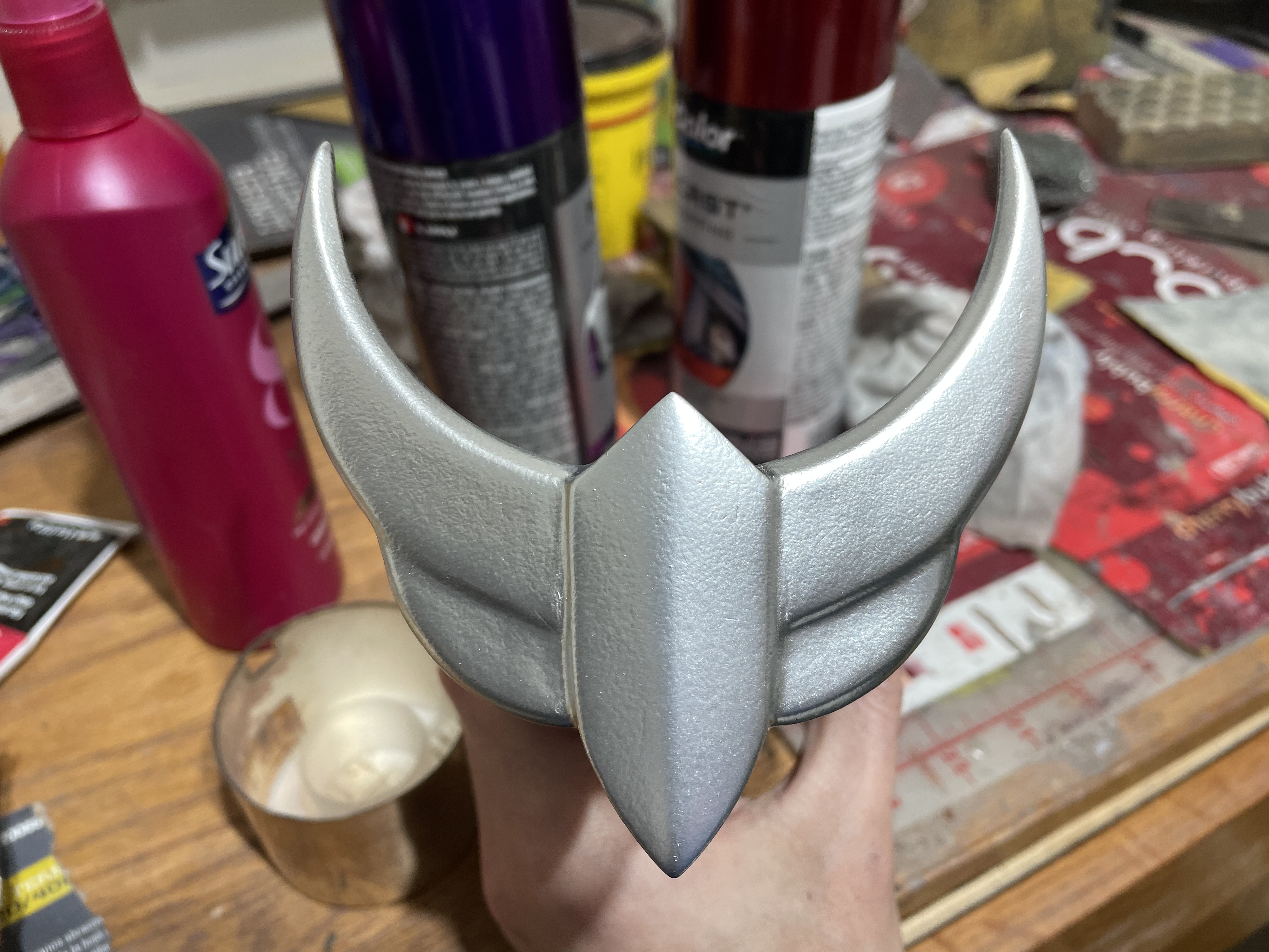

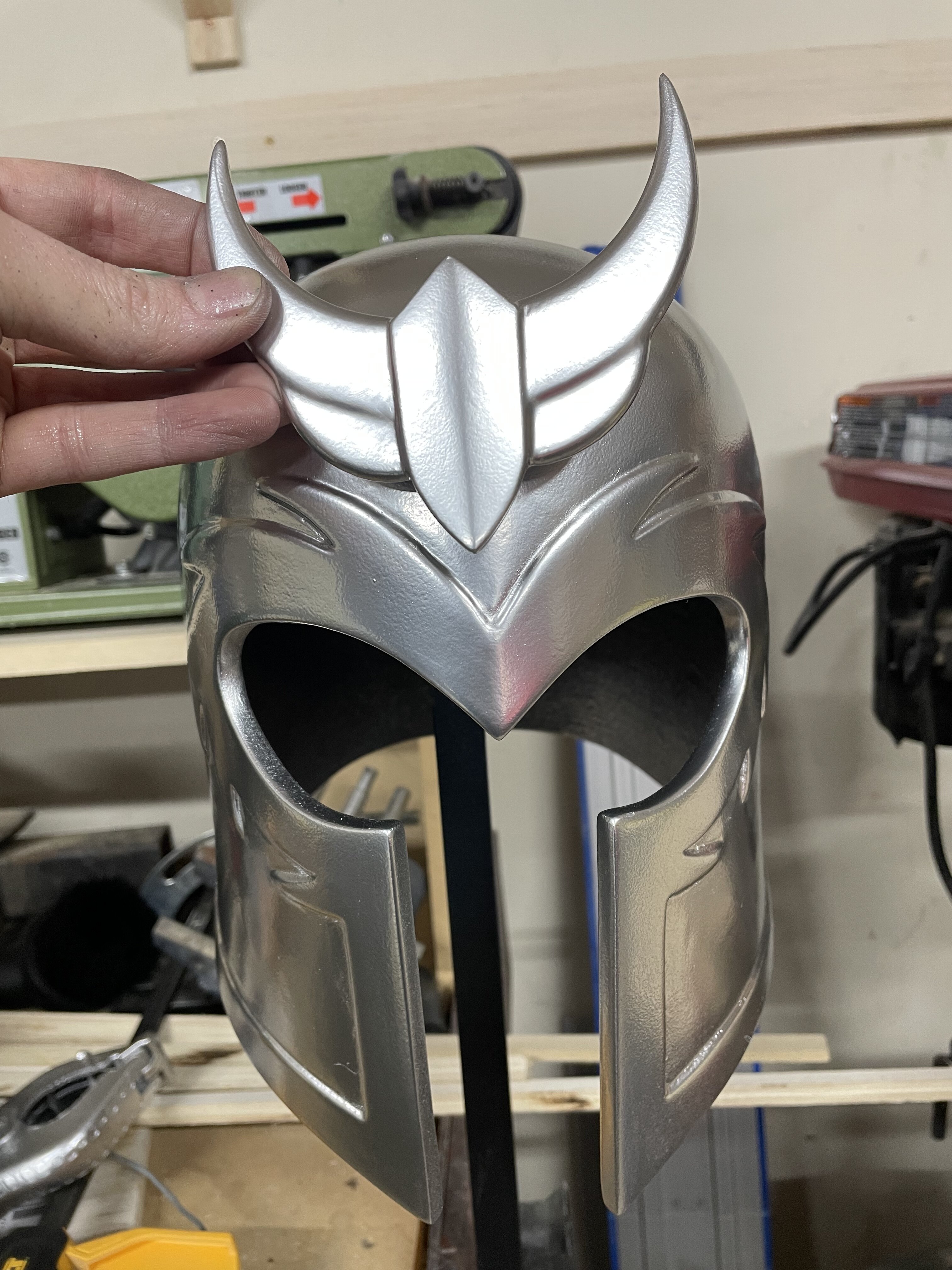

ryanoh

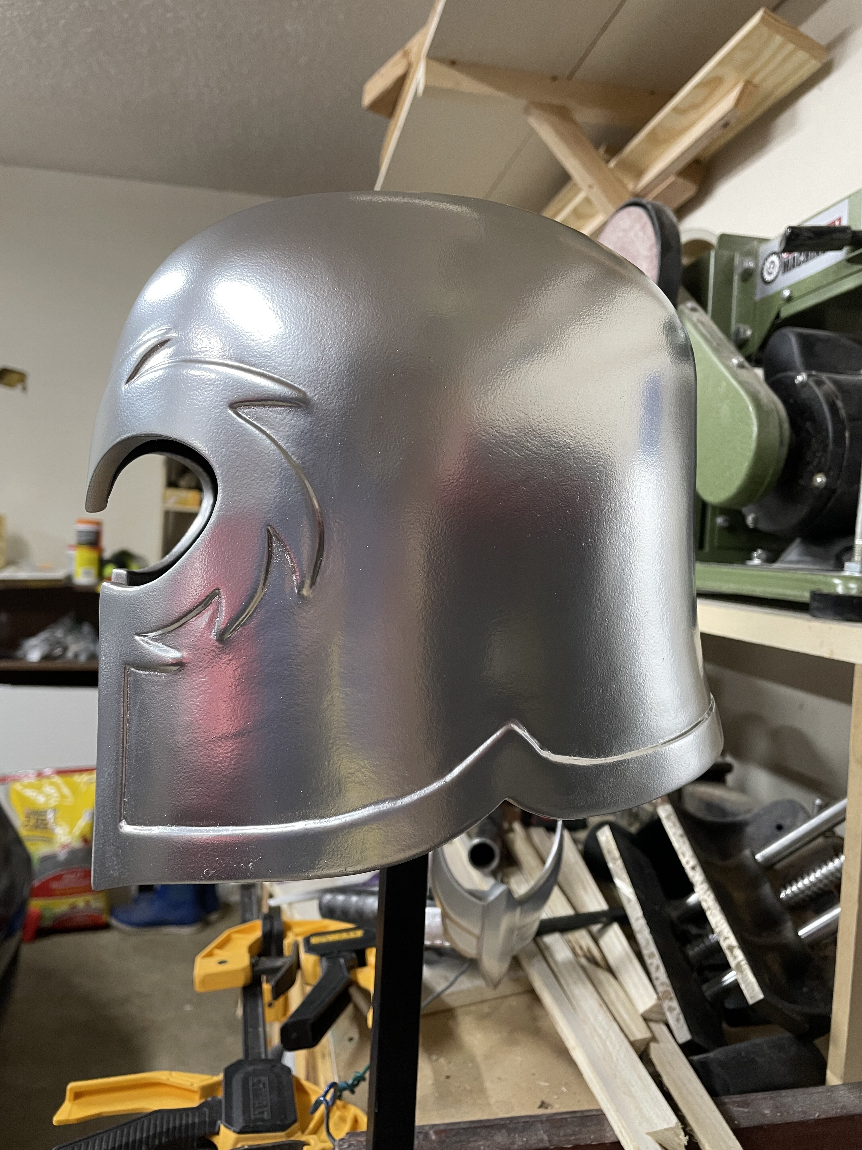

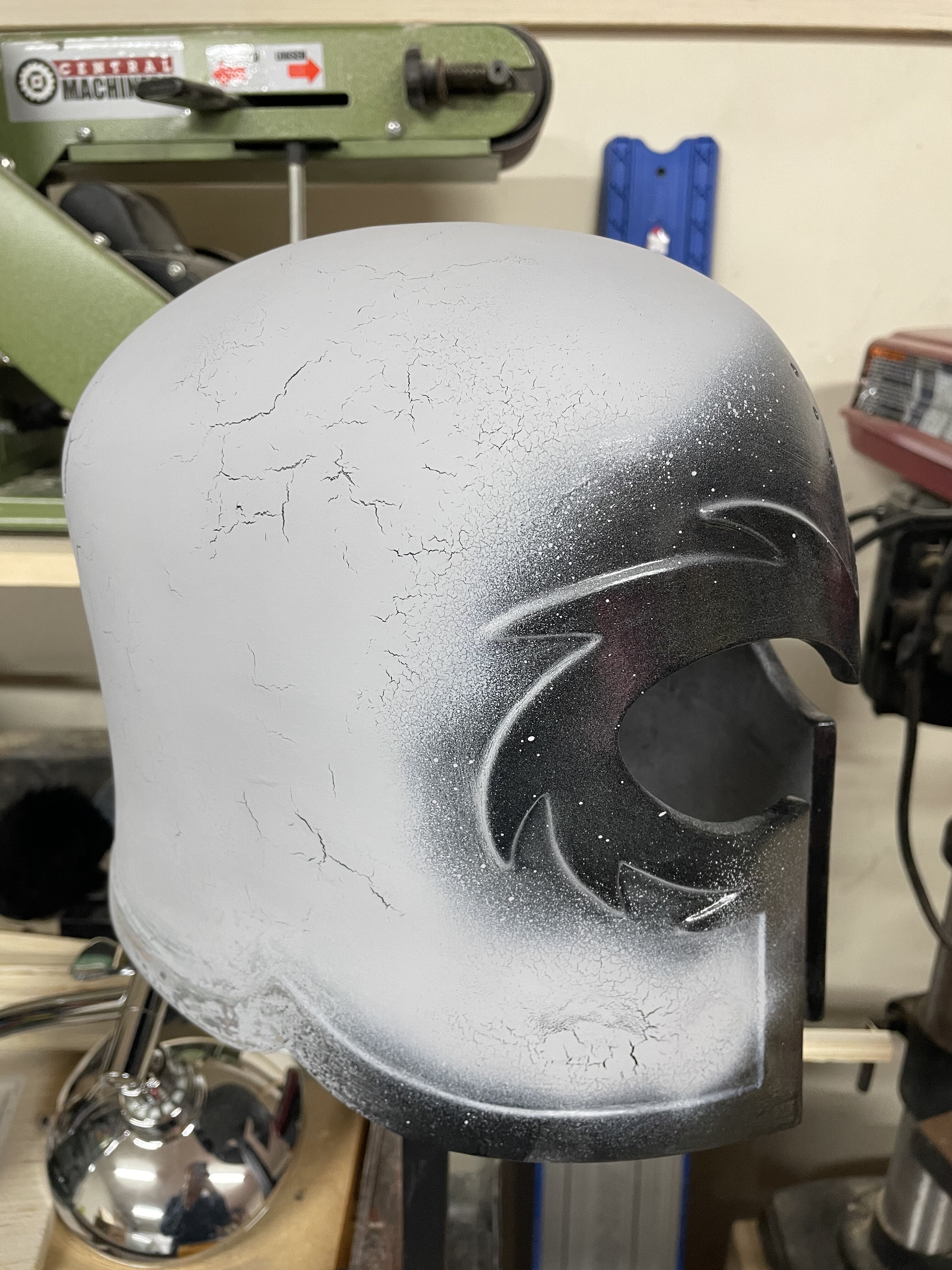

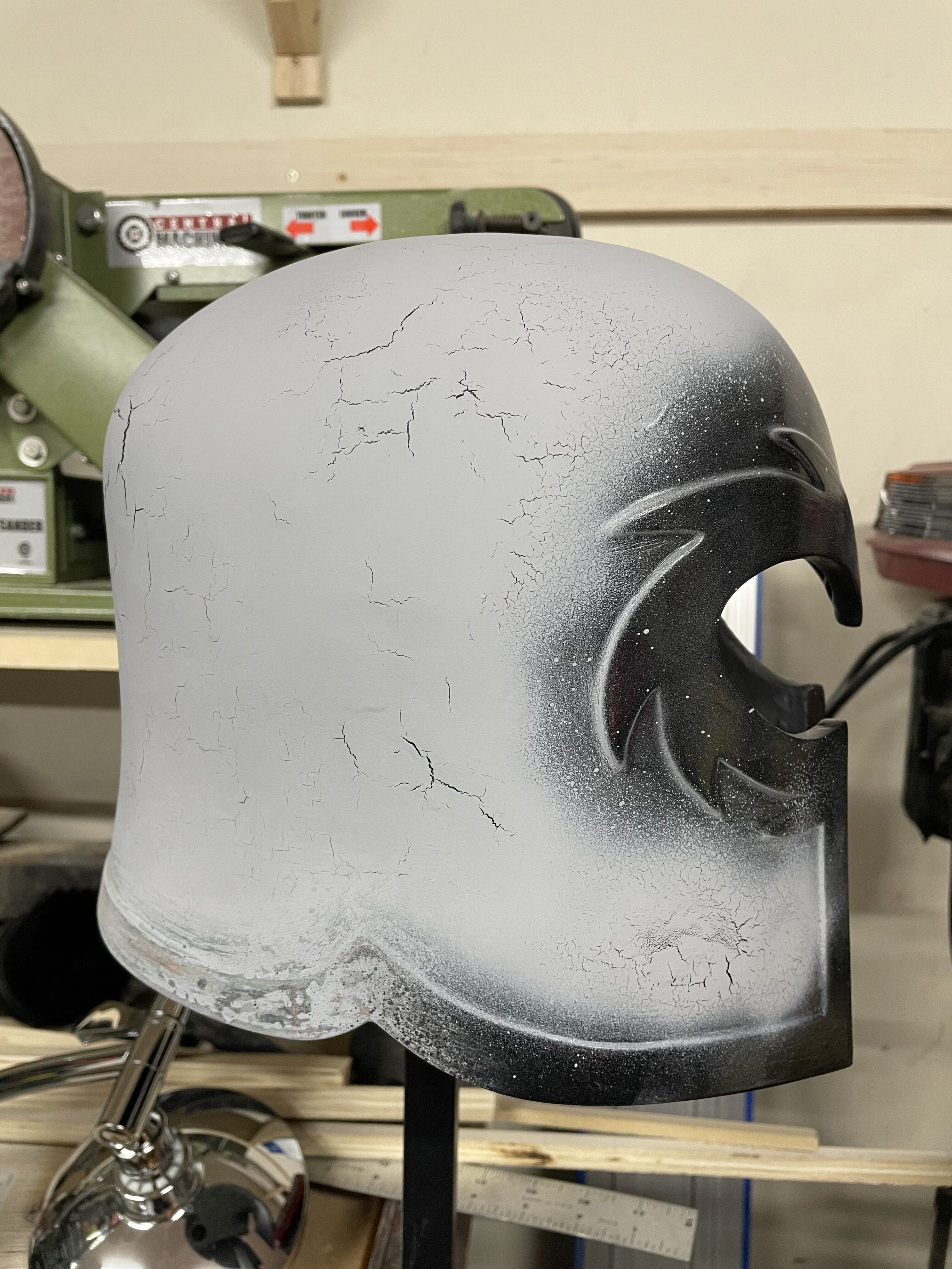

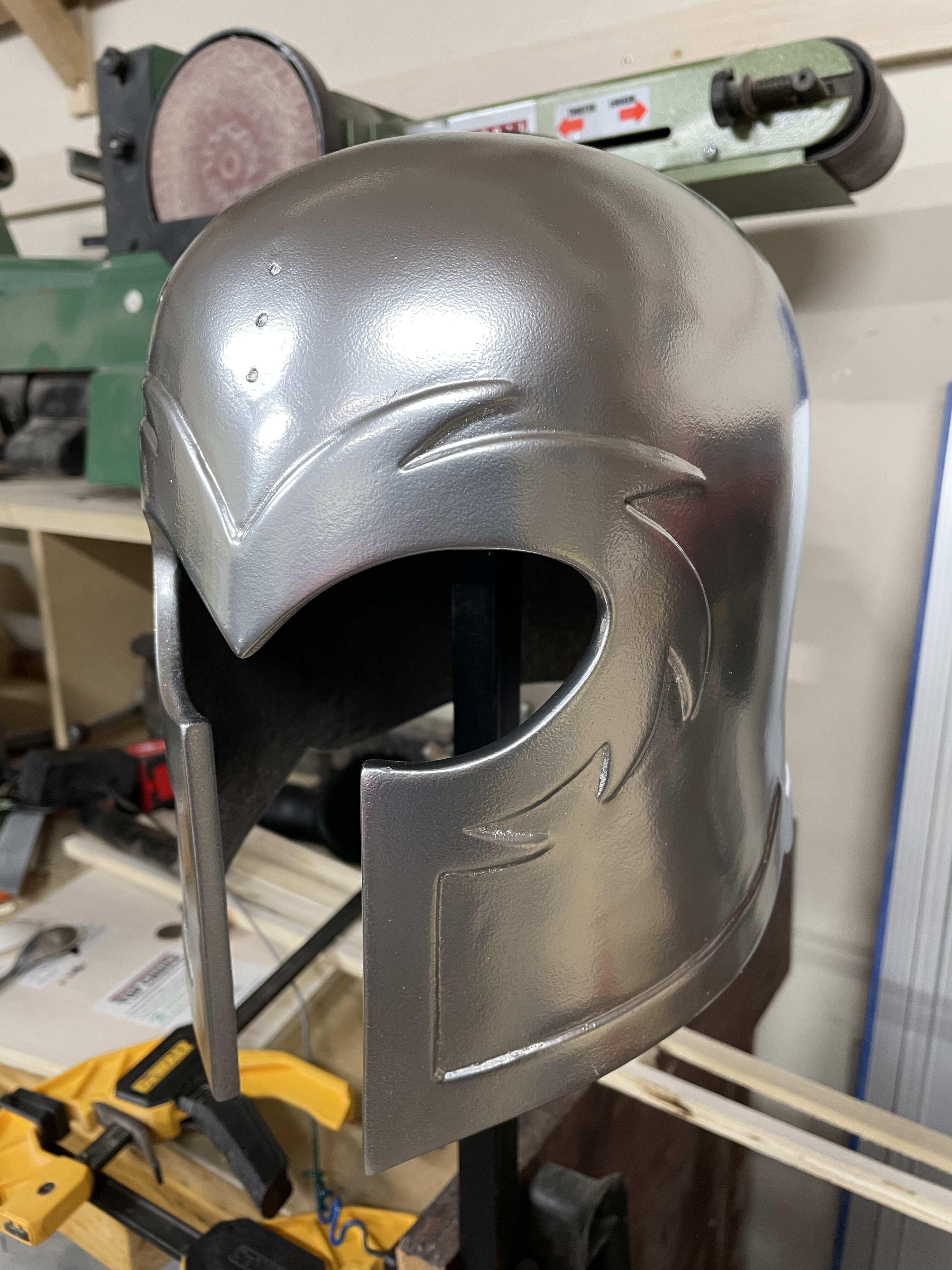

A couple shots of the final Duolicolor chrome base coat. The crest smoothed out a LOT after another layer, I’m hoping tomorrow the rest of the helmet will do the same so I don’t have to polish anything. In the first photo you can see the red and purple colors I have picked out in the background, currently in the spoon painting phase to make sure I like how everything looks.

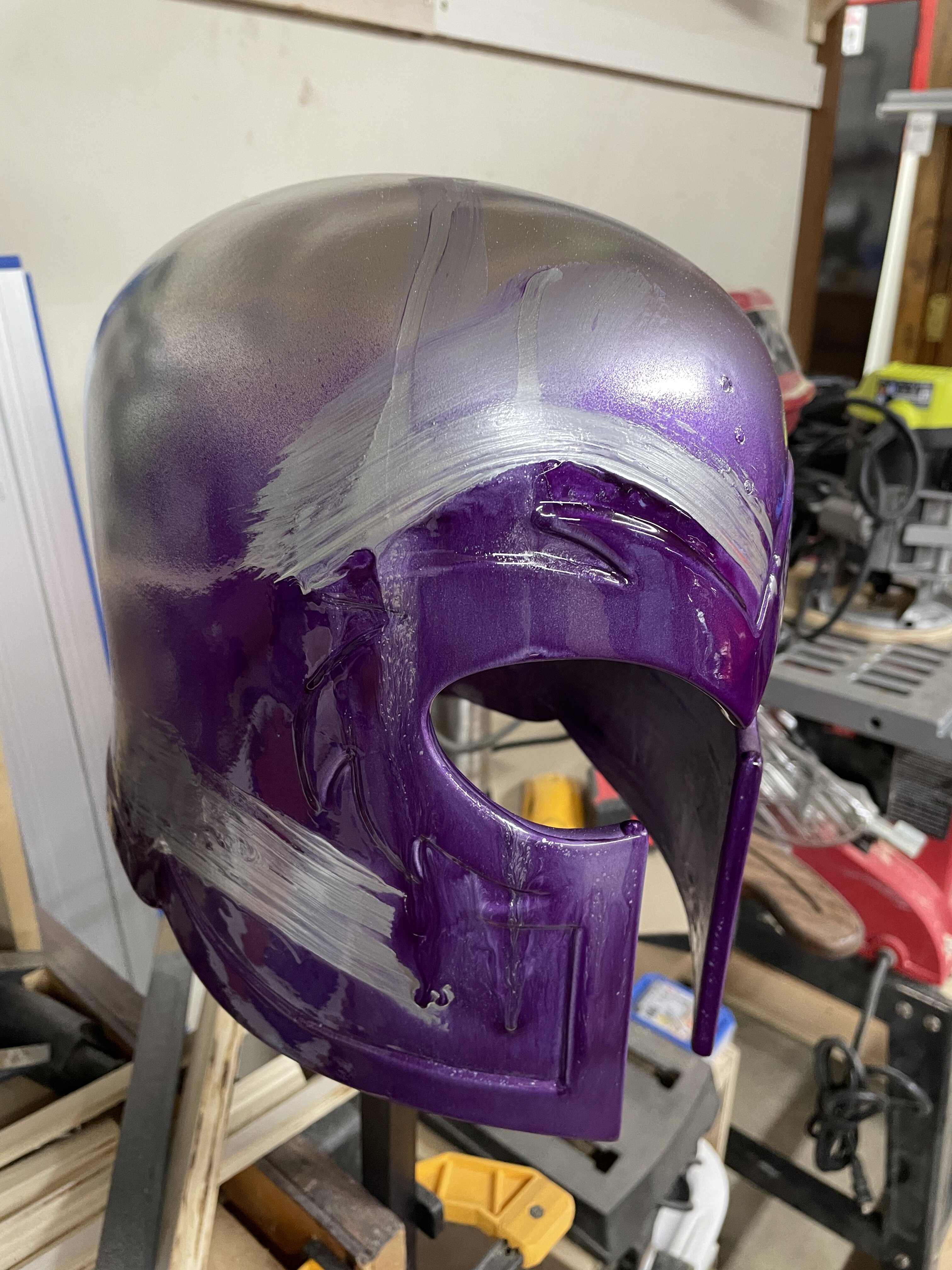

ryanoh
Painting some spoons trying to figure out the final color scheme here. I’m between one (slightly easier with the paints I have) and three (the hardest as far as painting/masking).
I know I said I was going to do a lot of weathering but I think I’m actually going to keep this one fairly pristine for now.
