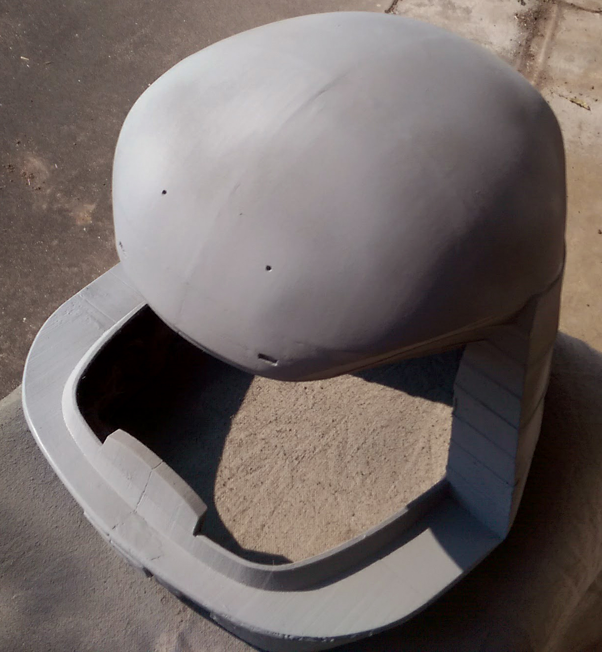

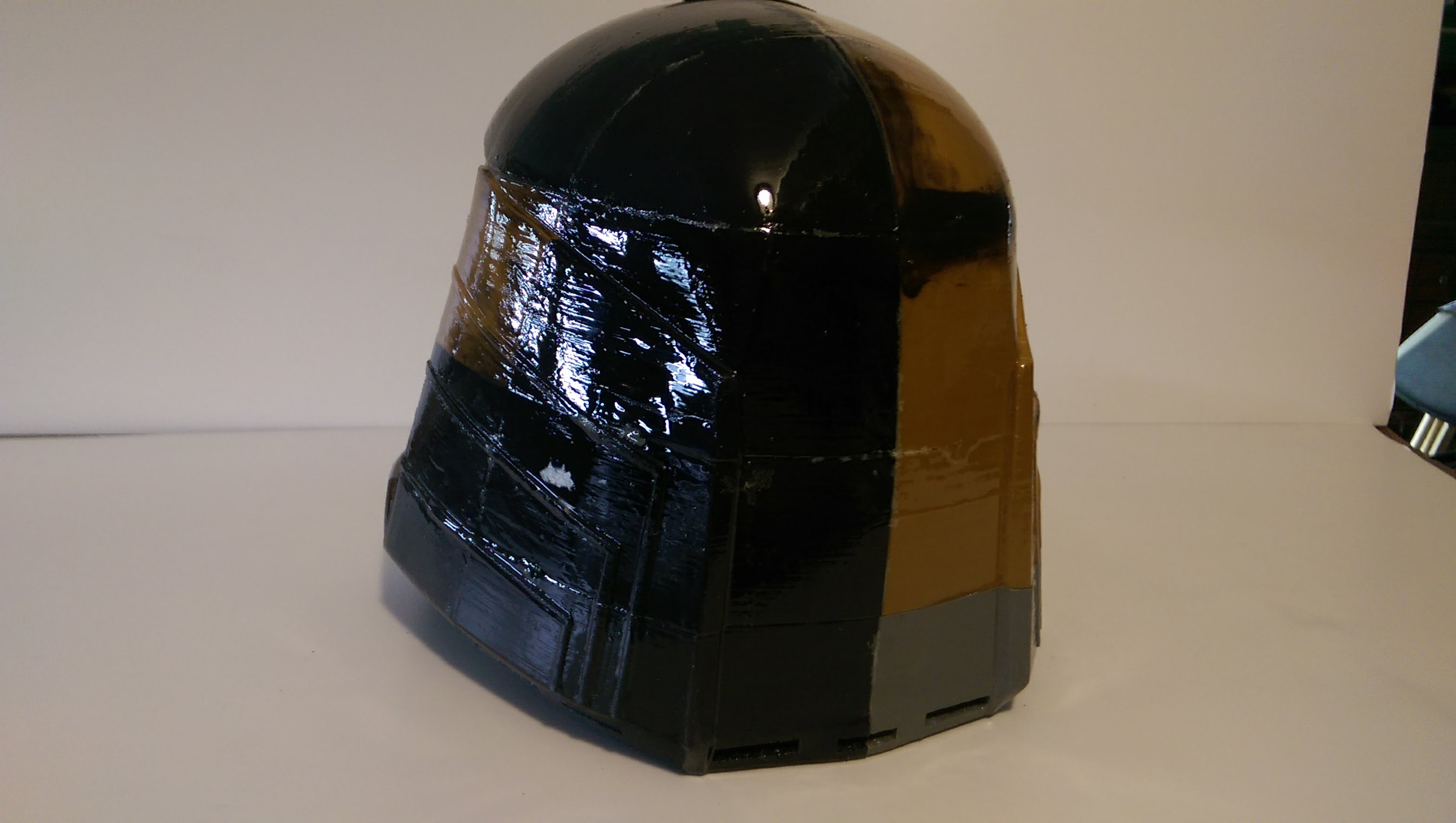

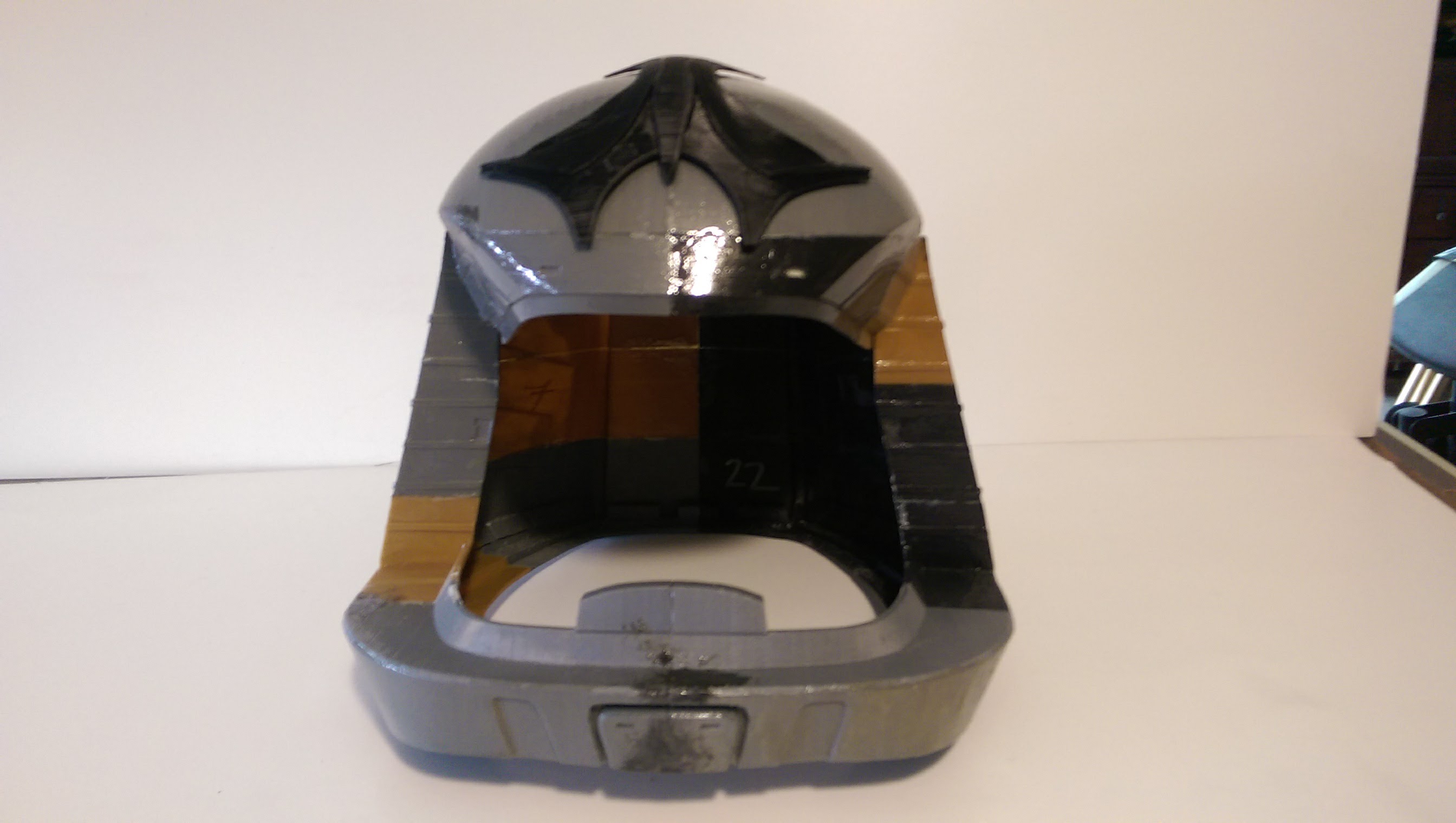

The first step was 3d printing the parts on an FDM printer and gluing them together the Eagle emblem was printed with an FDM printer for this photo and taped on but the final printed emblem was fabricated on my SLA printer. I had done some seam filling and coated the helmet with a two part epoxy.

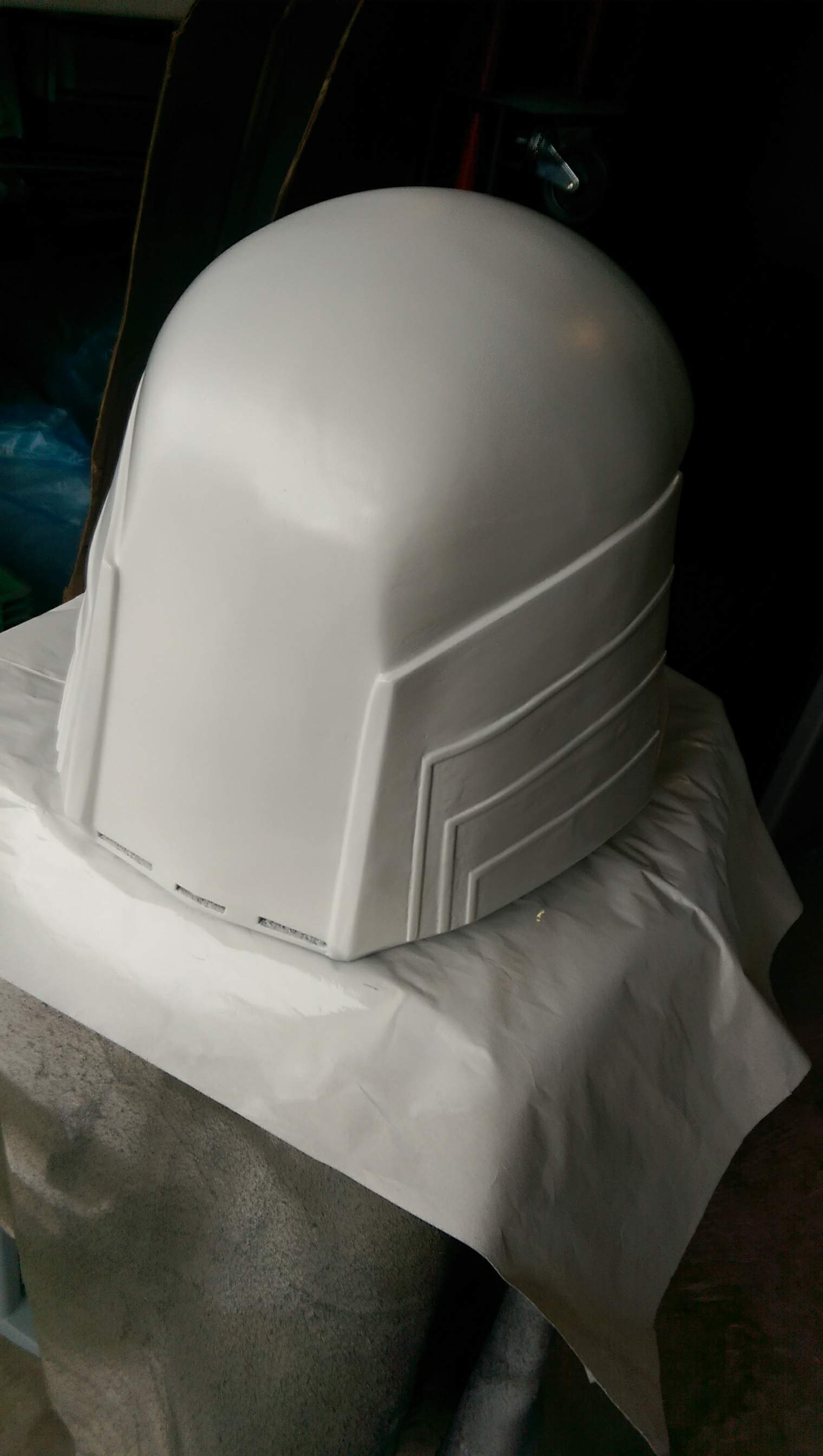

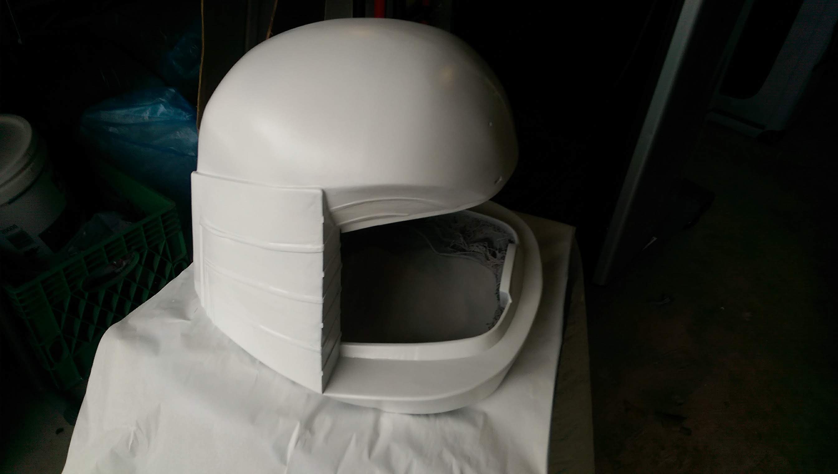

Next I primed the helmet with an automotive spray primer and coated the interior with fiberglass.
After that I started sanding, a lot! I used a lower grit sandpaper, like 80, then did more bondo filling and sanding again, until I was using a 2500 grit sandpaper.
I painted all the pieces separately and then assembled them, added the electronics and padding.
