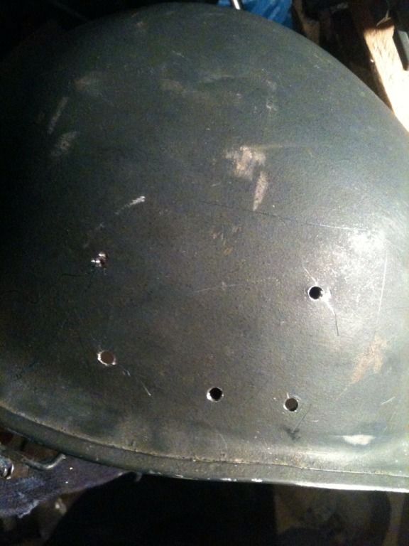

Being as it's a metel helmet, I decided rivets were the way to go. I drilled the holes in the cam, marked them on the helmet, and set about making the holes. It's at that point I ran into problems:

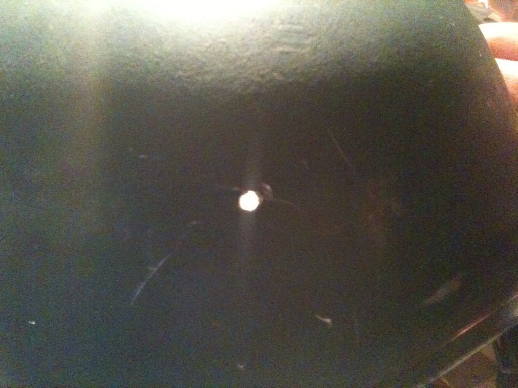

Yep, hartfield steel is not fun to play with, and none of my bits would cut further than the base of the cutting head. The other problem is bit wandering, you can see from the score mark in the pic :/
So it was time for a bit of research, and an engineering forum provided me with the solution. It turns out that quite a few members of said forum use tungsten carbide masonry bits and cutting oil for reinforced steel/armour plating with much success.
They were right, in less time than it took to mark it with my other drill bits, I had a hole:
I used a bit sharpener after every two holes till the cutting head wore out on hole five:
It was then that it became apparent that bit wandering had kicked in at some point, and the cam was now pointing upward :facepalm

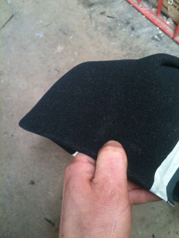

Started by deciding what I was going to make it out of, there were a few good suggestions, but settled for using foam as I like the thicker looking plates (using 1mm and 10mm foam), and going with Xrobots technique for coating foam with resin.
First I gathered some small pieces of foam that I got from work (they looked about the right size), and cut out shapes till I was happy:
I then took a thinner piece of foam and skinned the helmet:
This was just a test piece of foam as its too soft, but the effect is right. I have a piece of 1mm craft foam I'm going to heat shape/glue over it instead.

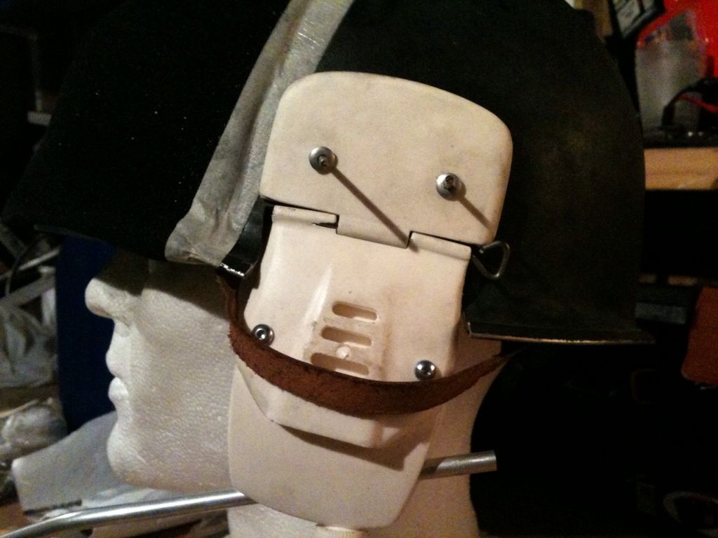

I finally got my drill press in the mail so set it up, drilled the rest of the holes in the earpiece so I could assemble it:
Unfortunatey, the lower hinge piece wasn't quite aligned properly on one side, and the drill bit came through the outer wall, another job for the filler :rolleyes
The last of todays antics was drilling the two holes to attach the earpiece to the helmet (ignore the strap):
I'll be cleaning up and filling/sanding the parts next, then sorting the new lobe plate skin after.

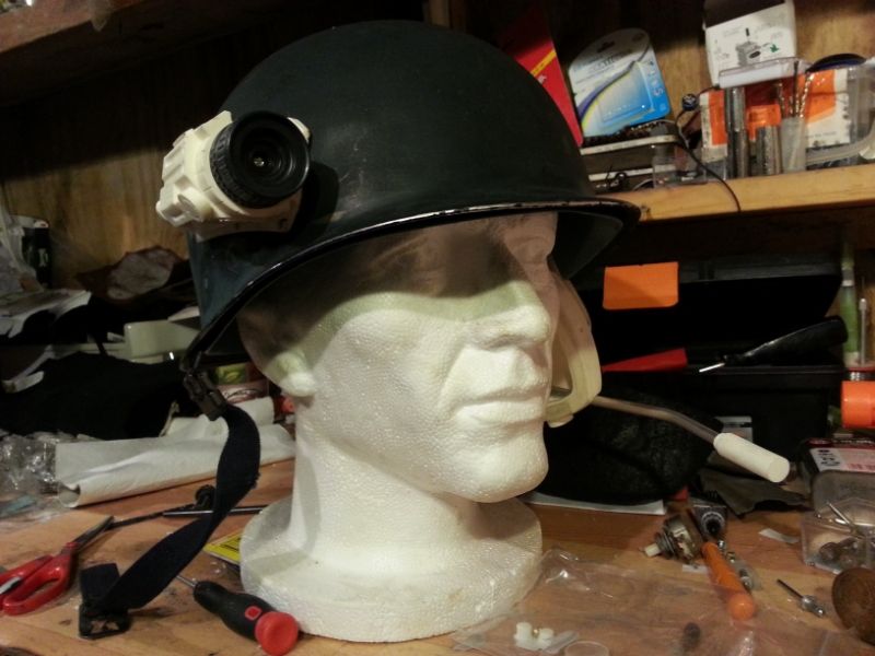

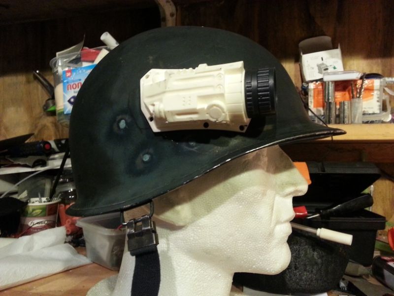

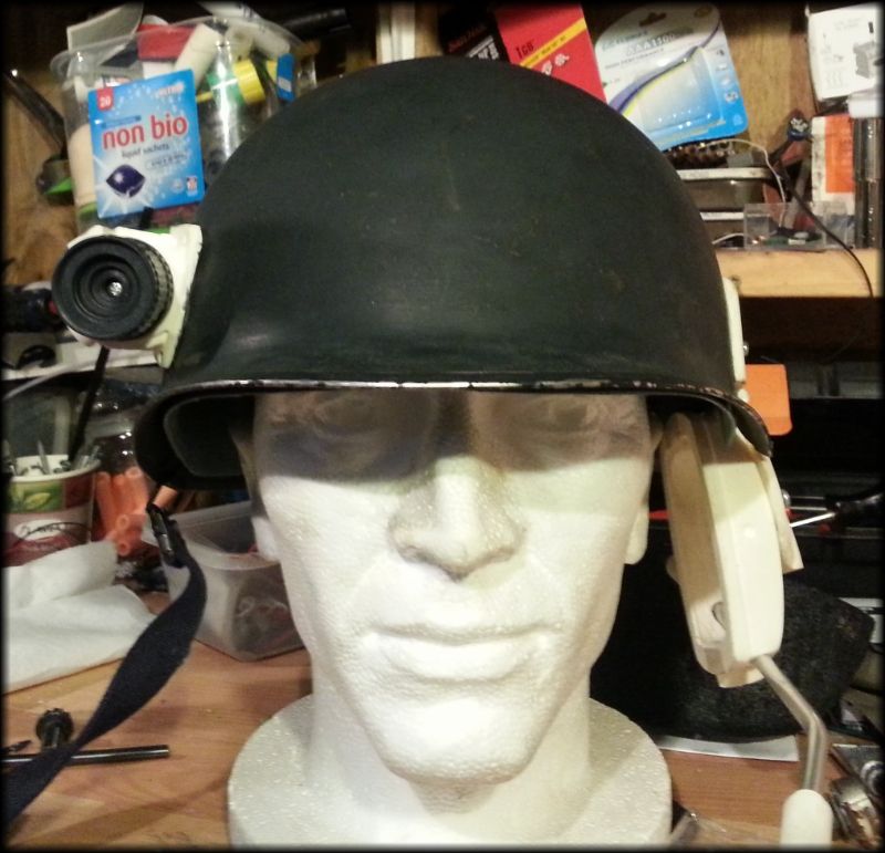

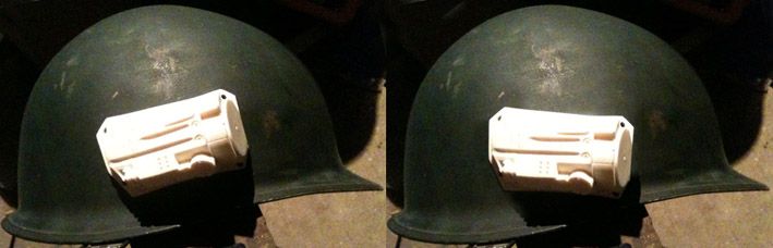

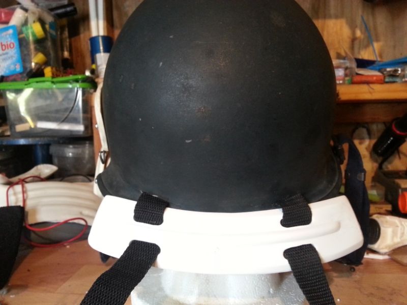

Got a little more done. I filled holes in the casts and helmet, then sanded smooth and assembled it all for a test fit.I used this compasit pic as my guide for the helmet camera (made by punkmarine over at the aliens legacy forum). The pic on the left is how I mounted it, the pic on the right is how it should be mounted :p
Here it is temporarily re-mounted (you can see the holes I filled in on the helmet), though on the mannequin head, it's pointing upwards a little which makes it look off a bit.
I also splashed out on new lobster plates from mooncrest, they have a lot more detail as theirs are cast resin, as opposed to GA's vacformed ones.
