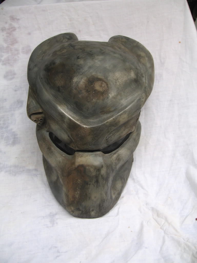

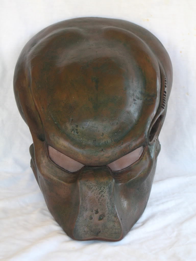

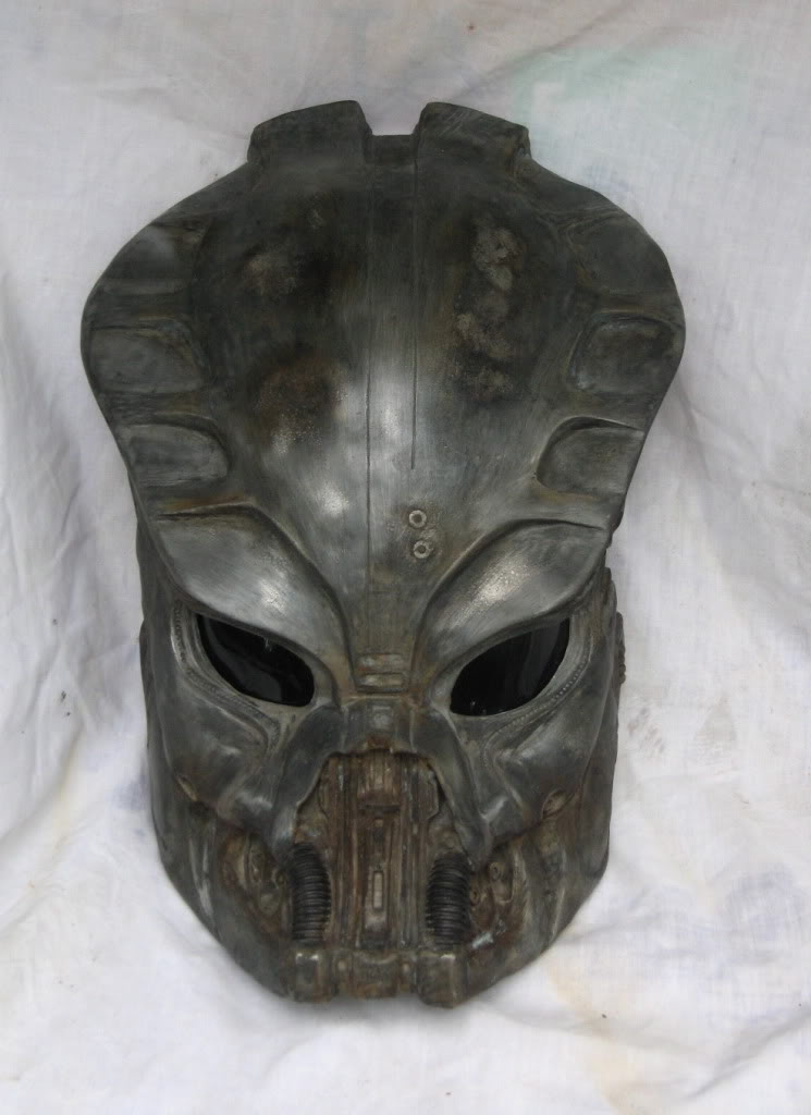

Here's a few pics of cold cast bios:
Aluminum
Aluminum
Bronze
Copper
VaderDave
Ok, just so I get this right...Coat the mold with a thin layer of the resin/metal mix, allow to set up, and then do layers of regular resin until the bio is built up to the desired thickness allowing each layer to set before the next layer it added.
Am I tracking that right? :(
hez1
Bingo. It's slightly time consuming and may take some practice till you get used to how the resin sets. I find smoothcast 320 to work best because it has a pretty gradual set up.
VaderDave
One more question:
When you take the casting out of the mold, does it look like metal or do you have to do something to the surface (ie...polish...steel wool..etc..) to bring out the coloration of the metal?
hez1
You have to scrub it. The smooth-on video recommended rubbing it with mineral spirits first I think? I don't remember. Then steel wool, then some of the metals benefit from polish like brasso. I had great results with the copper and brasso polish, after going from coarse to fine grades of steel wool. I recommend the smooth on video if you haven't already watched it. Search the Arsenal forum for my cold cast P2 thread, that shows you how that looked at various stages. Right out of the mold it just looked like brown resin.
