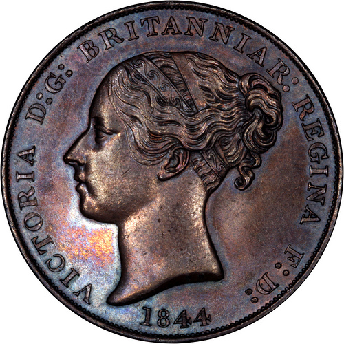

I want to create a replica necklace that belongs to the character Jacob in the upcoming Assassin's Creed Syndicate game. References I can find lead me to believe is is an 1844 Victoria shilling coin.
The character appears to have punched a hole in the top, and mounted it on a leather string. I've found 1844 shillings on eBay for reasonable prices, but I don't want to destroy the original by drilling into it if I don't have to.
