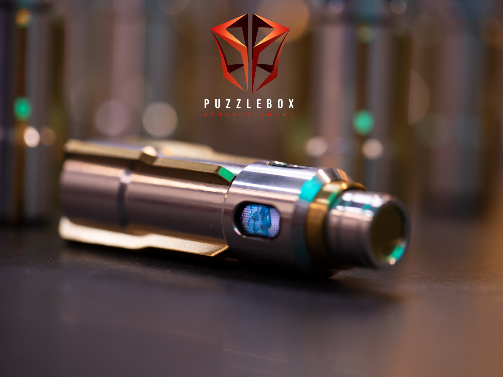

The Hyperfuel canister was my favorite prop from Solo. I've been working on it for a bit and those who follow my Instagram have seen it in the works but I haven't posted on here yet for some reason. I've actually recorded some footage also but haven't really had time to put together youtube videos yet either so i'll start a thread here and begin posting it.
This is the current look at the time of creating this thread. Its pretty close i have a few tweaks to make for accuracy but pretty darn close i think.

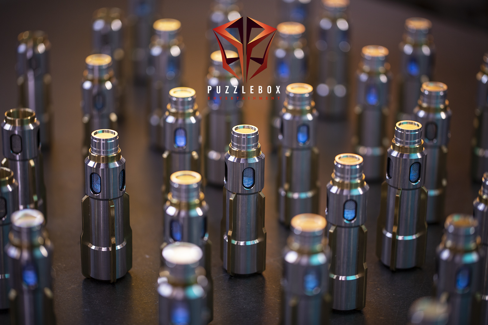

I'm also in the process of doing a run since I had a lot of interest through Instagram.
If you are interested make sure to get on the list. Its basically a first come first serve signup list. Its about 1/3 full without even announcing anything yet.

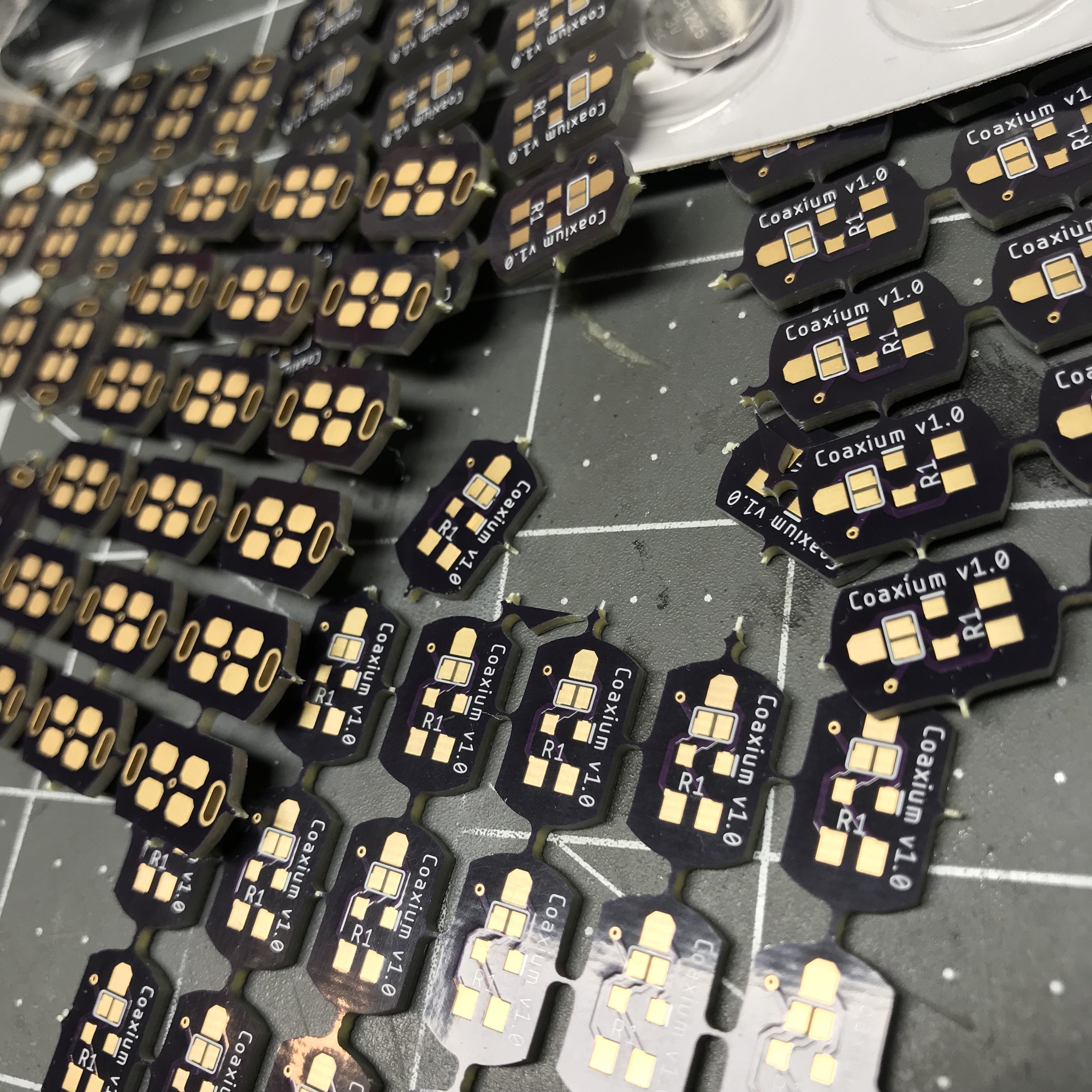

And one more here for tonight.. This is the prototype for how the lighting will work. I first made my own custom tiny boards to make sure it would work. Since they do I then designed and sent off a couple circuit boards to be made professionally. Those should be here in about a week. It will function the same but be a little cleaner. This is a TINY space to fit it all in :) I was pretty happy with how its working out.
