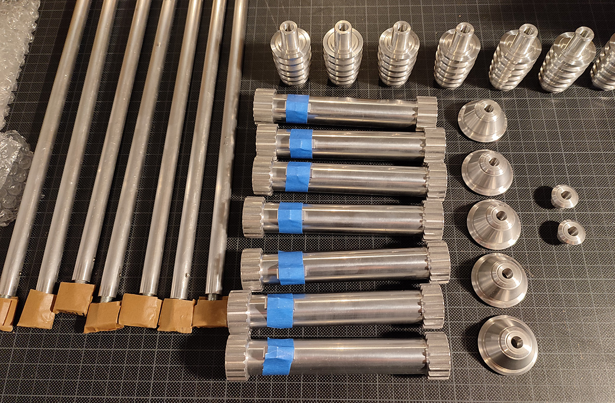

small update after the rush of this week end!
I managed to finish the last gears I needed to finish, I actually put the kits for sale before all the gears were done because I had enough to cover the first orders I was anticipating and didn't want to be to delayed :)
here is the traditional end of run photo, it has almost all the parts even though a few have been already sent out:

lastly, here is how the items are packed together so you get an idea when opening the things and don't loose the small parts.
The gears and barrel are dry fit together in the proper position, if you keep it that way, you just have to slide them over the cut barrel. I taped the sights to them to avoid loosing them as they are super tiny.
The washers are packed together with the V8 cone when you ordered this variation. If you haven't ordered the V8 cone, the washer is packed by itself, be carefull not to misplace it.

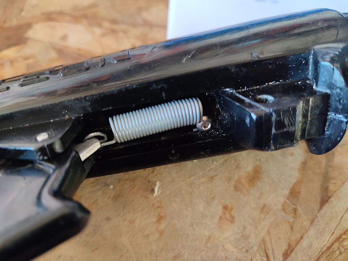

Hello guys,
I saw that there was some discution about the trigger mechanism, so I tried my own as well to share and give you guys some options. There are countless options for this, there is room inside, there is a hook on the trigger that is very practical to use, the trigger will stop on both direction against the plastic of the pistol when re-assembled, so any good spring will give a nice feeling, what I did is pretty simple and I'm very happy with the result, it really "clicks" when you press the trigger :)
I just used a rather stiff spring that I attached to the trigger hook on one side, and I put a screw into the plastic and aluminium tube that goes inside and wrapped the other end of the spring to it :
and a short video of it working:
