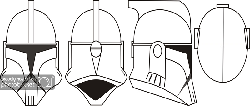

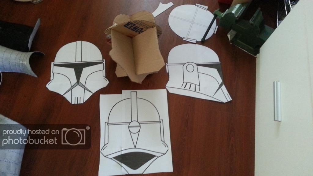

Blue prints: This is my study of the Fordo helmet. Looking at the screen caps, the helmet design was very inconsistent and always changing. This is more of an average of the different configurations.

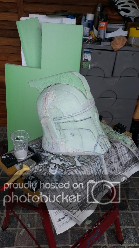

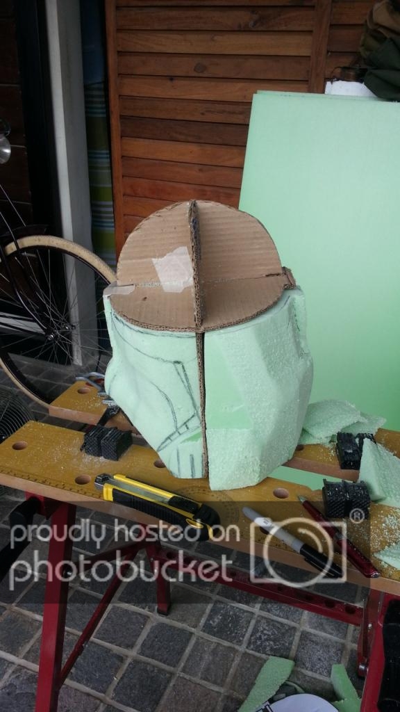

Here are the progress pics:

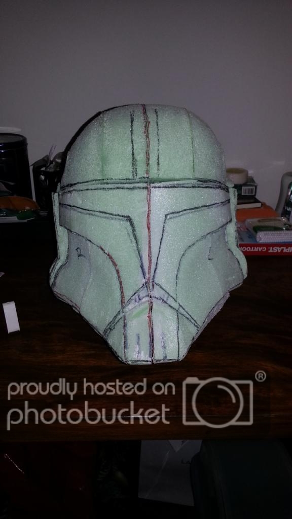

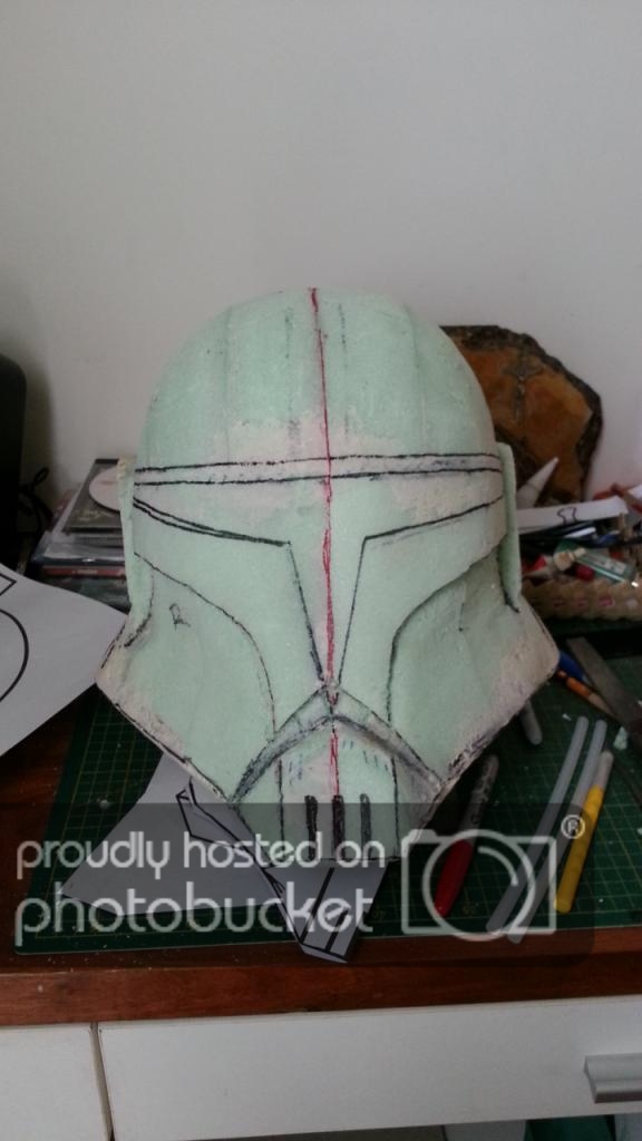

At this point, i realized that the cardboard skeleton shifted out of position and i could no longer use them as reference for my center lines. As a result, i had major symmetry issues. So i had to remove the foam from the skeleton and stuck the quadrants together and draw new center lines.

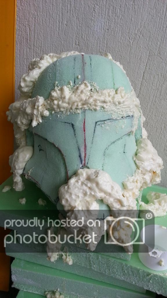

Fixing with spray PU foam

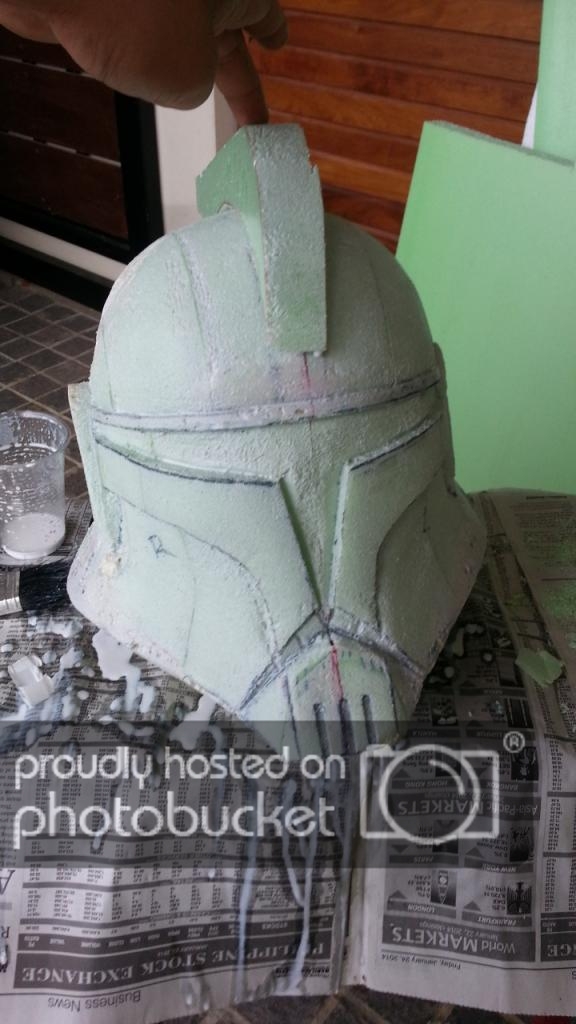

Sealed the xps foam in acrylic emulsion in preparation for bondo. Also started work on the mohawk.
[/URL]

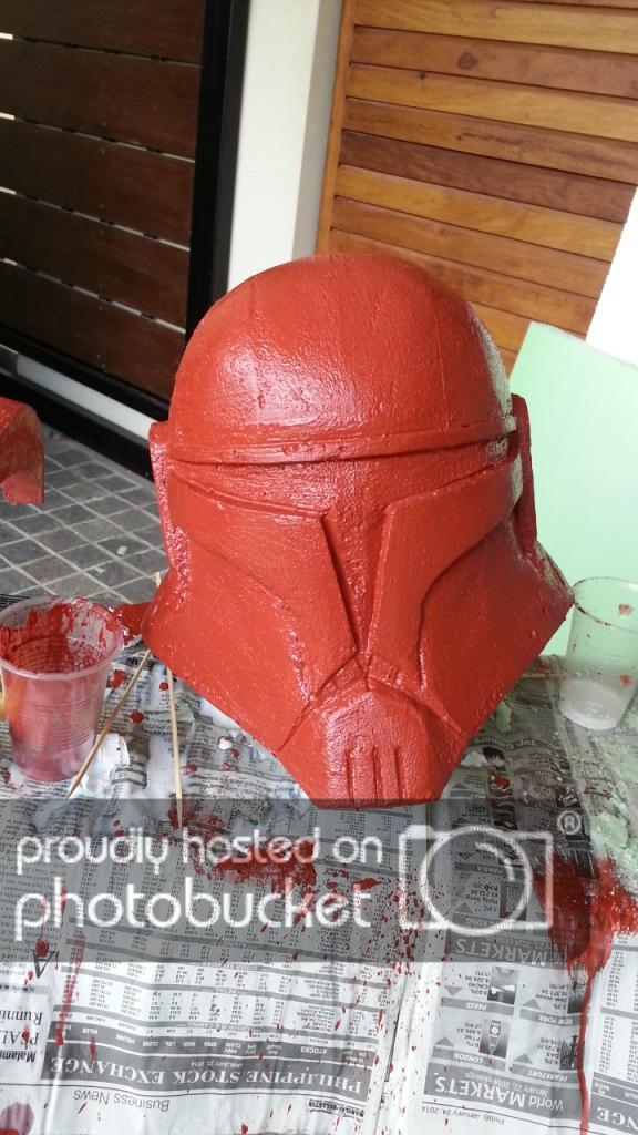

Just a coat of two of latex paint to see details better...on to bondo ( and sanding....and more bondo and sanding...)

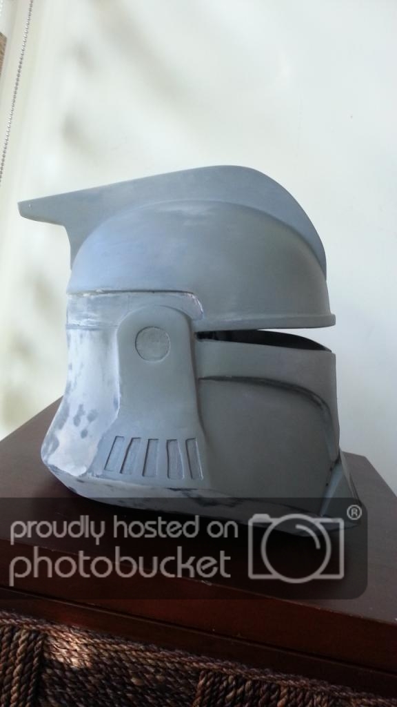

The very tedious Bondo stages:
As seen here, i've lost a lot of sharpness from the details...i think an unavoidable step to get the base helmet all smooth.
Next up: Re-sculpting and refining the details...

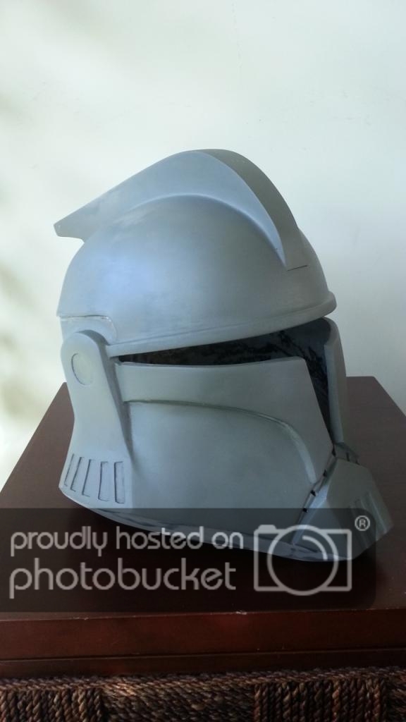

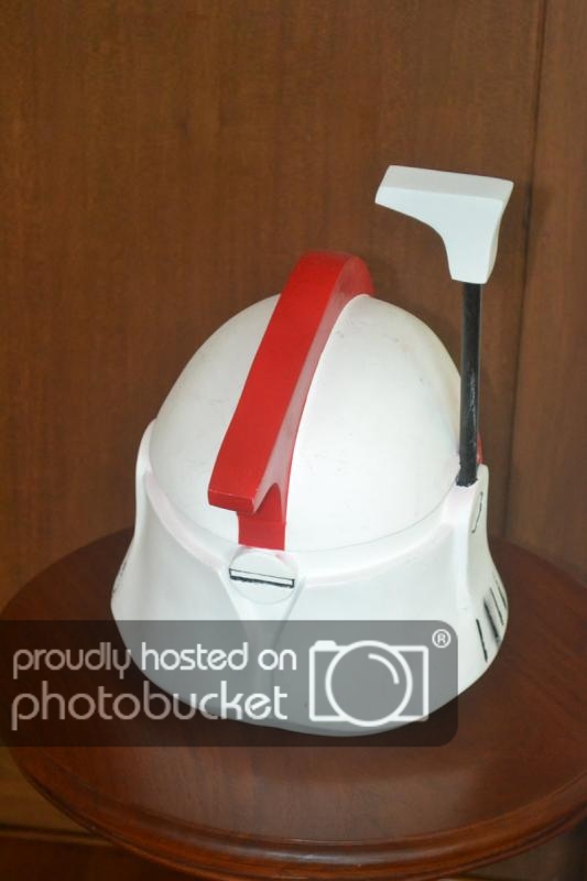

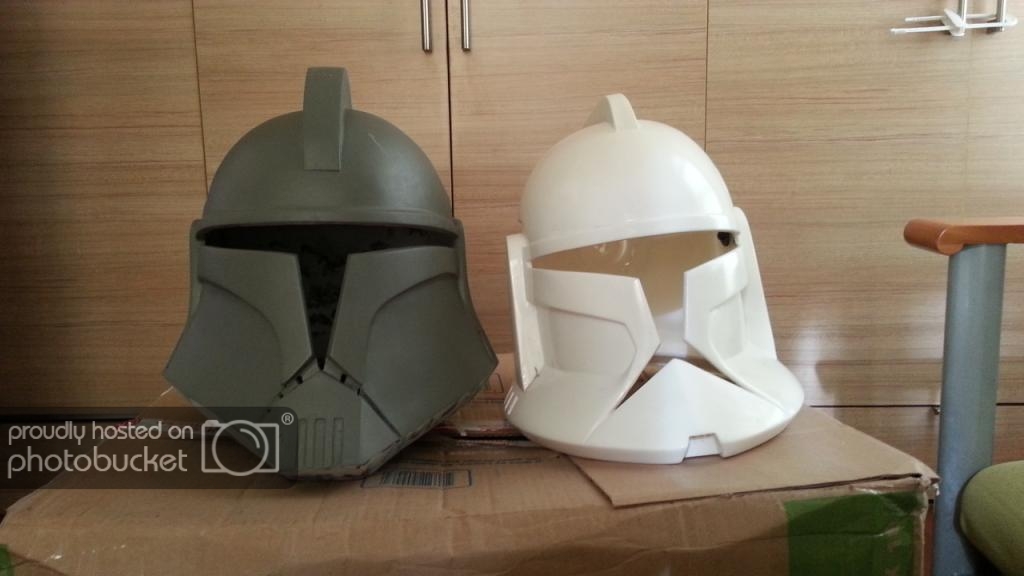

First casting! This prototype was done in fiberglass. Here it is after the lens and frown were cut out and after a first layer of primer and sanding. I was in the process of laying down a second layer of primer when i ran out. Unfortunately, the primer brought out some errors that need to be fixed. The master will have to be altered a bit and another mold made. Lession learned: primer the master sculpt first!
Here it is next to a KWD season 1-3 animated bucket for size comparison:

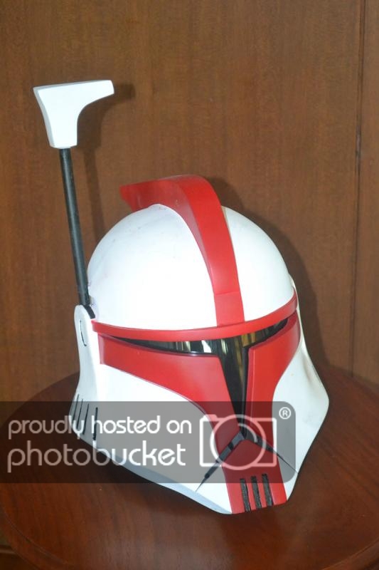

Here's the finished helmet...
And here's the finished armor as well! Presenting ARC Capt. Fordo from the 2003 Cartoon Network Microseries!
