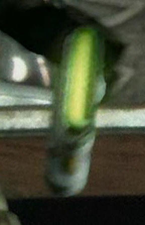

It really is a fantastic model. Very little is needed to bring it up. And you did a lovely job of adding features. Excellent call on the iridescent front lens. Note the color shift:

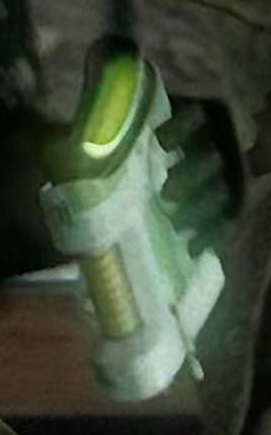

You definitely strike me like someone with the same mental affliction I have. One of my main credos is, "It it's worth doing, it's worth over-doing." With mine, I redid the side lever -- thinner -- in steel and narrowed the slot, redid the front lens "frame" with thinner walls, the eyeshield piece was one of my first practice models in Blender -- I made it one piece and made the curve match the Phase I and II helmet-front shape, as it definitely seems to me intended to be conformal:
Printed that in TPU so it's rubbery and has give. I drilled out where the light is supposed to be and, y'know, put a light there. My only two criticisms on your build are heckin' minor. One is the top "dial" piece. The 3D model is open, but the film asset has a flat surface closing in that center opening, below the return edge:
And that last one shows the other, as well: the screen is 1) green and 2) looks to fill the whole space inside the eyeshield...
That said, you did an amazing job. I especially like how you got depth to the screen. And I agree with your desire for strap anchors -- they're definitely there. I'm hunting for good found-part candidates. I'm very happy to see you do this build. Not nearly enough of these out there in the costuming world. :)

Thanks for the feedback! I loved building it. So: regarding your notes:
- Color changing iridescent film: https://www.amazon.com/dp/B07X531DZ6
- The visor fit: I agree, it does look like it should fit closer to the helmet.
- The top dial: It was hard to tell, but based on the left pic here, it does seem to be recessed to the level of the other housing, and the paint appears to connect to the side markings, implying that the ring may swivel and focus, but be a ring shape. Not certain, but I assume that is what the modeler thought as well.
- The lit space: I agree, it could be full width, but for what I was attempting (depth) there is not a full wide depth past the handle shapes. The model had a rectangular space already, and I realized that was the only space that was deep enough for what I had in mind. Most Electrobinoculars view screens appear rectangular in canon, and the user's eyes are much smaller inside the helmet, so this felt like a concession I could make.
- The color: Most Electrobinoculars appear light blue, except this Gree image, and one other from Clone Wars. I thought they may have done this to look good for Gree's clearly custom style (with his green mirrored visor), but I just wanted a more classic look anyway when people saw it, so that it would feel familiar. Totally went off of preference on that one.
