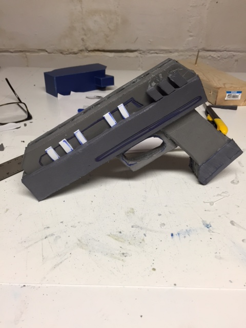

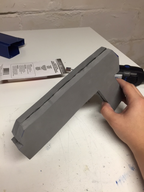

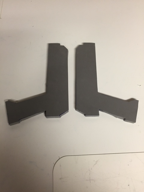

1) cut main pieces out of foam that was 10mm thick
2) glue the mirrored pieces together
3) start building up layers using 6mm thick foam and adding details with 2mm thick foam, also score the foam by using a sharp blade and only cutting through the top layer of foam not all the way through, then heat it up with a heat gun and watch the magic happen
4) repeat the whole process to get two blasters!

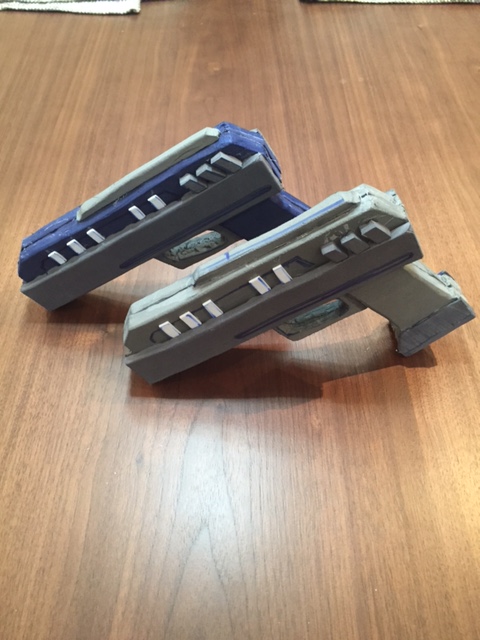

So I feel pretty happy with the way these turned out! I think they have just enough detail and look great considering this was my first ever foam weapon build!

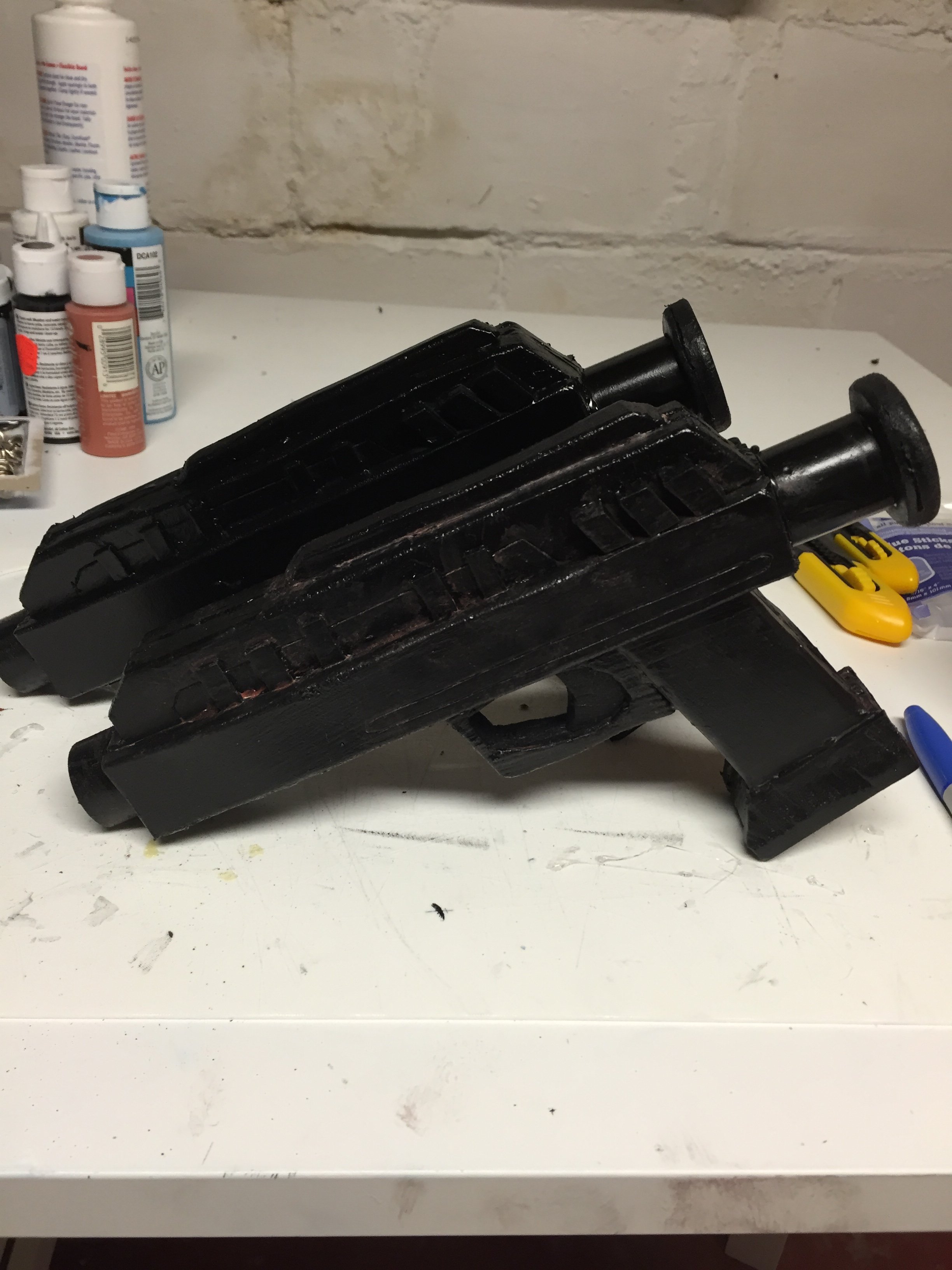

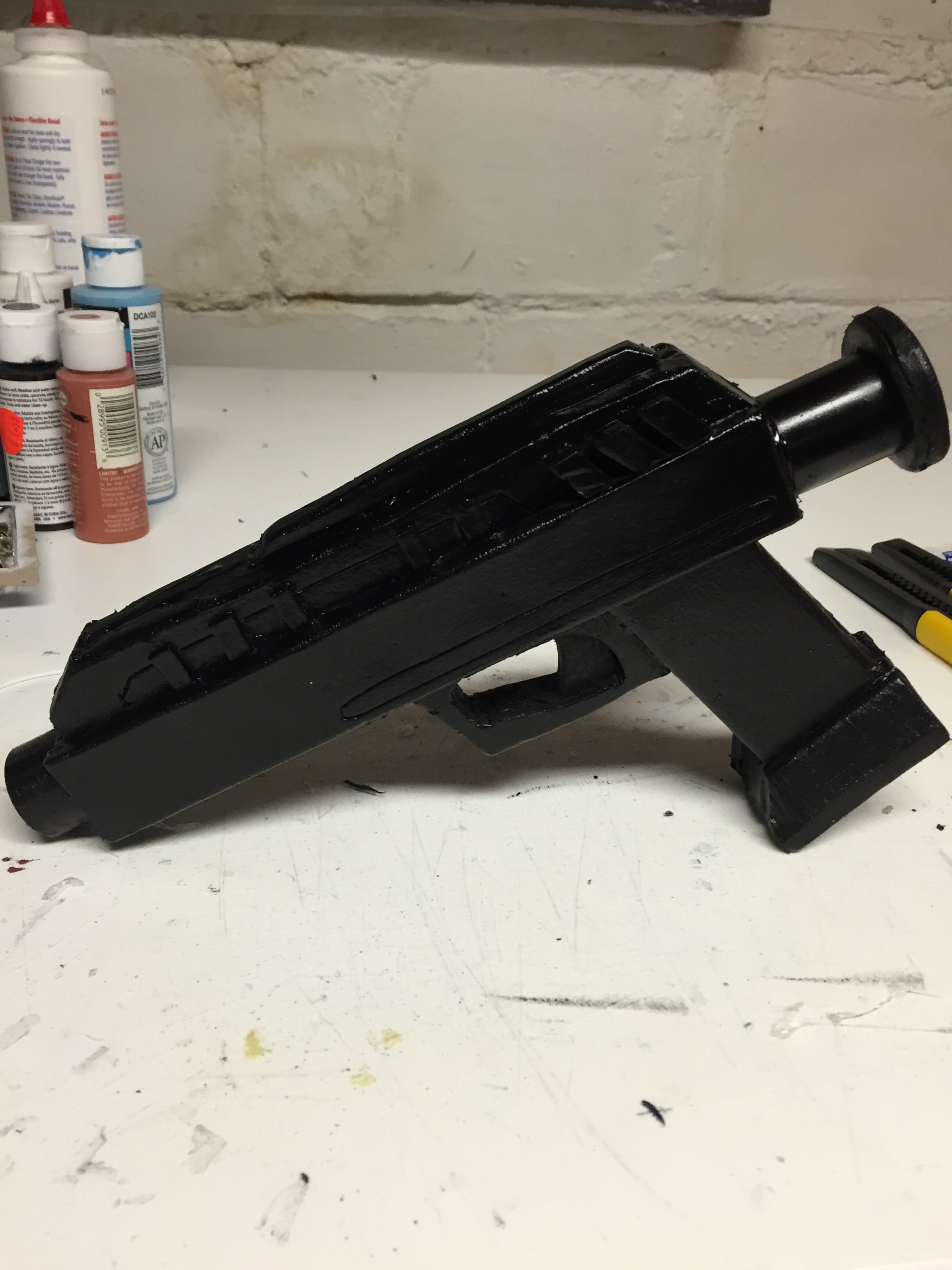

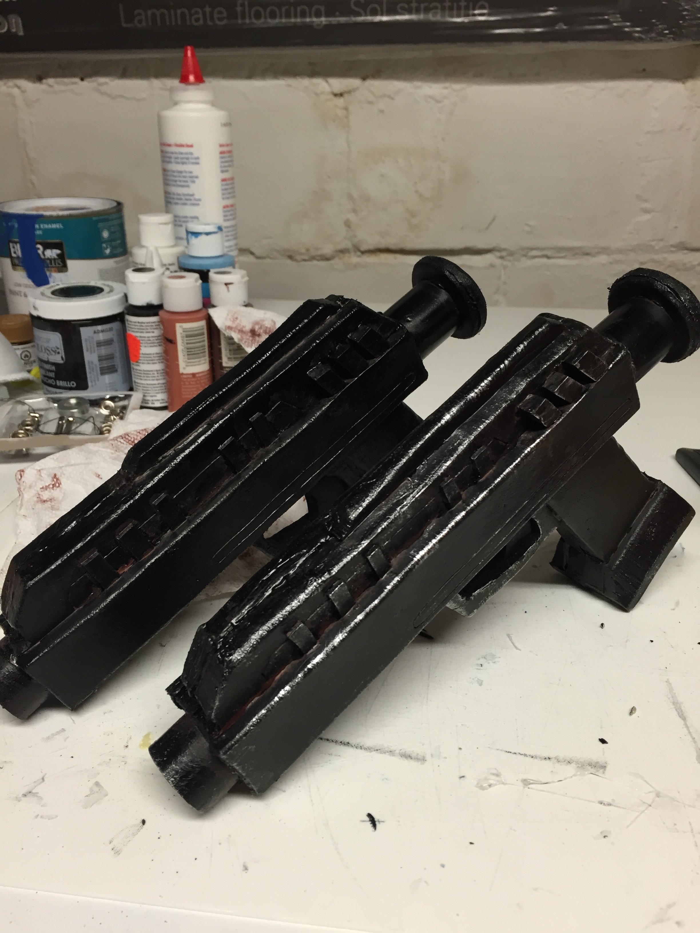

From here I am going to add some pvc pipe on both ends for the barrel and the bit that goes at the back. After those are added on I will begin the painting process and post those pictures soon!
Thank you so much for checking this out, please leave any comments, questions or tips
