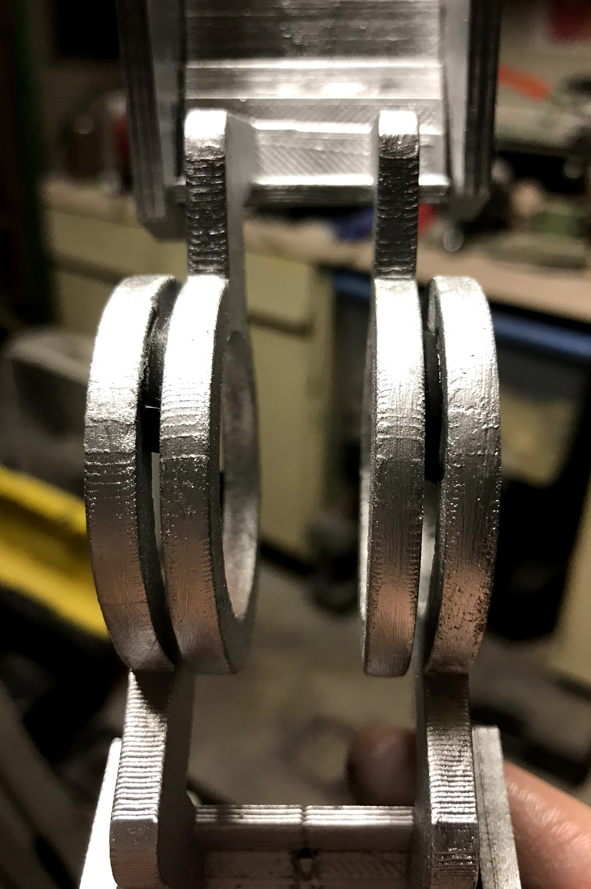

This should fit very neatly in the handle parts. You will need to bondo the joins on it and possibly add some glue filler to get it to fit just right. The reason for slicing it this way is because it prints really nice with no supports. It's worked really well for me on three of these now.
1" very thin black washers (4 of them)
These should just be as thin as you can find (like 1/16" inch) and they go in between the claw hinges. They greatly aid in the friction that keeps the claws open, but you don't want them taking up much space. This is a bit experimental, but is probably the way to go.
UPDATE: I was unable to find the exact washers in a quick hurry as I wrap up two builds of these, but simply cutting a little piece off of them and gluing the to one of the hinges has added a whole lot of friction so this will work for now.

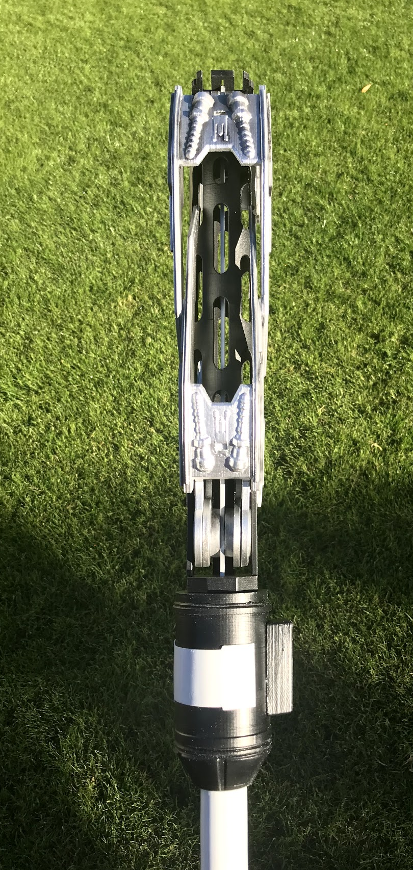

ASSEMBLY
I hope to post some simple instructions soon, but for now I can say that all you need hardware-wise are the items listed below.

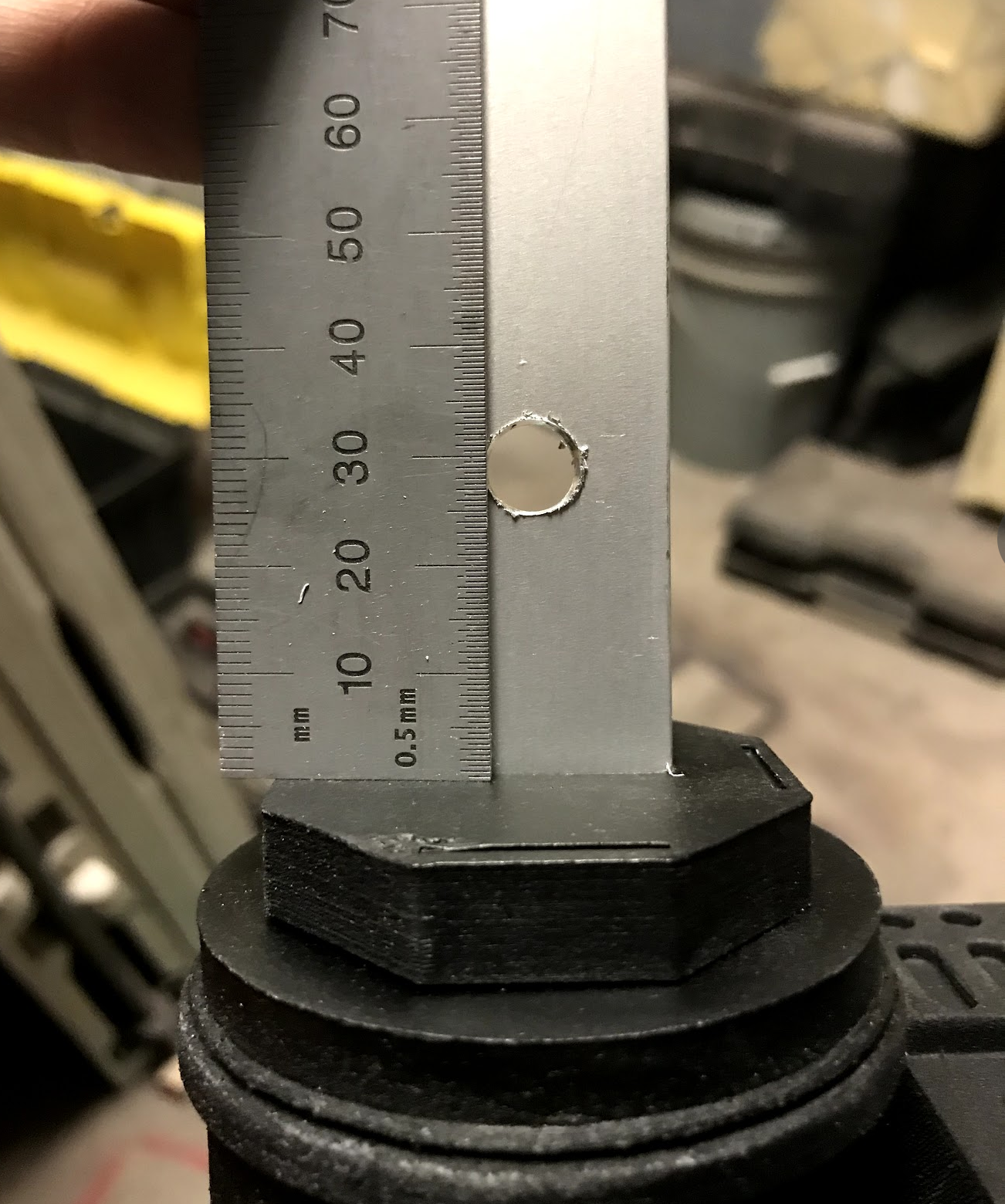

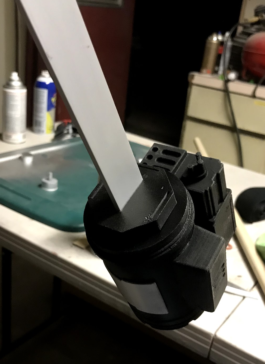

1" x 1/8" aluminum bar (2 feet, cut to fit)
This should fit neatly in the slots of all the end parts and give the whole top end strength. You can see a bit of it here.
Here is where I drilled the lower hole.

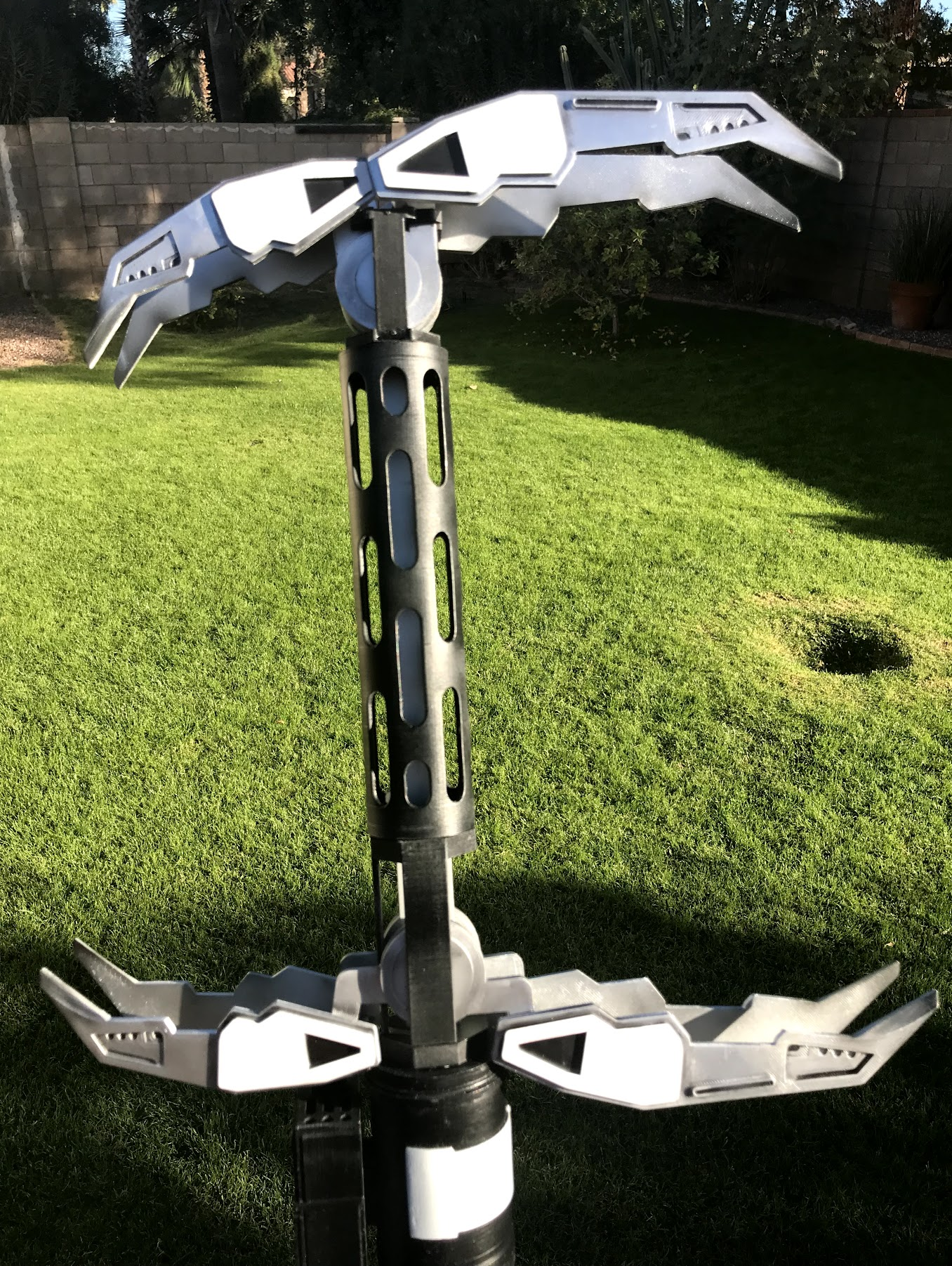

Paint Prep
I highly recommend Rustoleum spray filler primer. Bondo makes one too - and in black - but it's harder to find and it takes twice as much paint to fill. Does a great job with 3D print lines. I also highly recommend using Bondo Glaze on the blades because that silvery sheen really shows the print lines.
Paint
I used the following paints for this. I highly recommend them both for the colors and the results.
  • Black - Montana Gold Shock Black. You can tape it less than 2 hours later!
  • Silver - Montana Gold Chrome. Same cure time as above.
  • White - Rustoleum x2 Ultra Paint + Primer. This is the same as most FOTK armor and I wanted mine to match. I also love the glossy sheen, though the cure time sucks.
  • Clear - I used Montana Gold flat/satin clear coat on all but the glossy white parts, after weathering with an airbrush.
