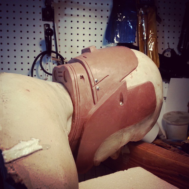

Early photo of the sculpt (ugly stages!), which was done on the client's lifecast for a proper fit, We were especially concerned with getting the jaw to wear correctly which is an issue with quite a few other helmets we looked at.

Awesome job man.One of the best helmets i've seen.I have many questions about it.Finished,it looks like its made out of resin but on the photos i can see you sculpting the clay.If its made out of clay wouldn't it be compact??:confused?How did you make it wearable.Could you provide more info about the procedure you followed??? Keep the great job and thanks for sharing.:thumbsup

Here's a photo of the sculpt for the under helmet/rubber bits when I was getting prepped to mold it and touching up some of the detail on the bottom. (Hard to work on when the lifecast was upright)
