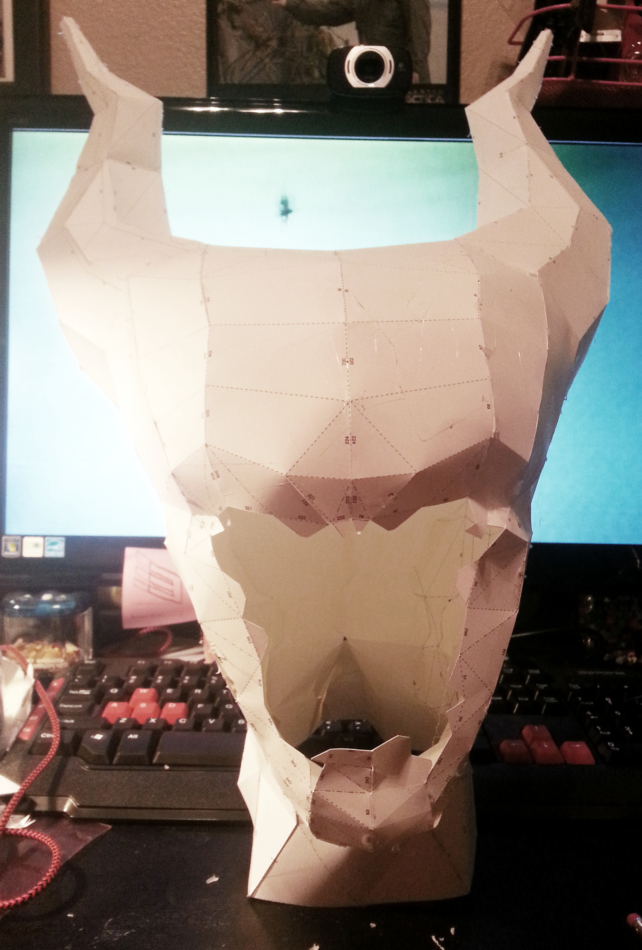

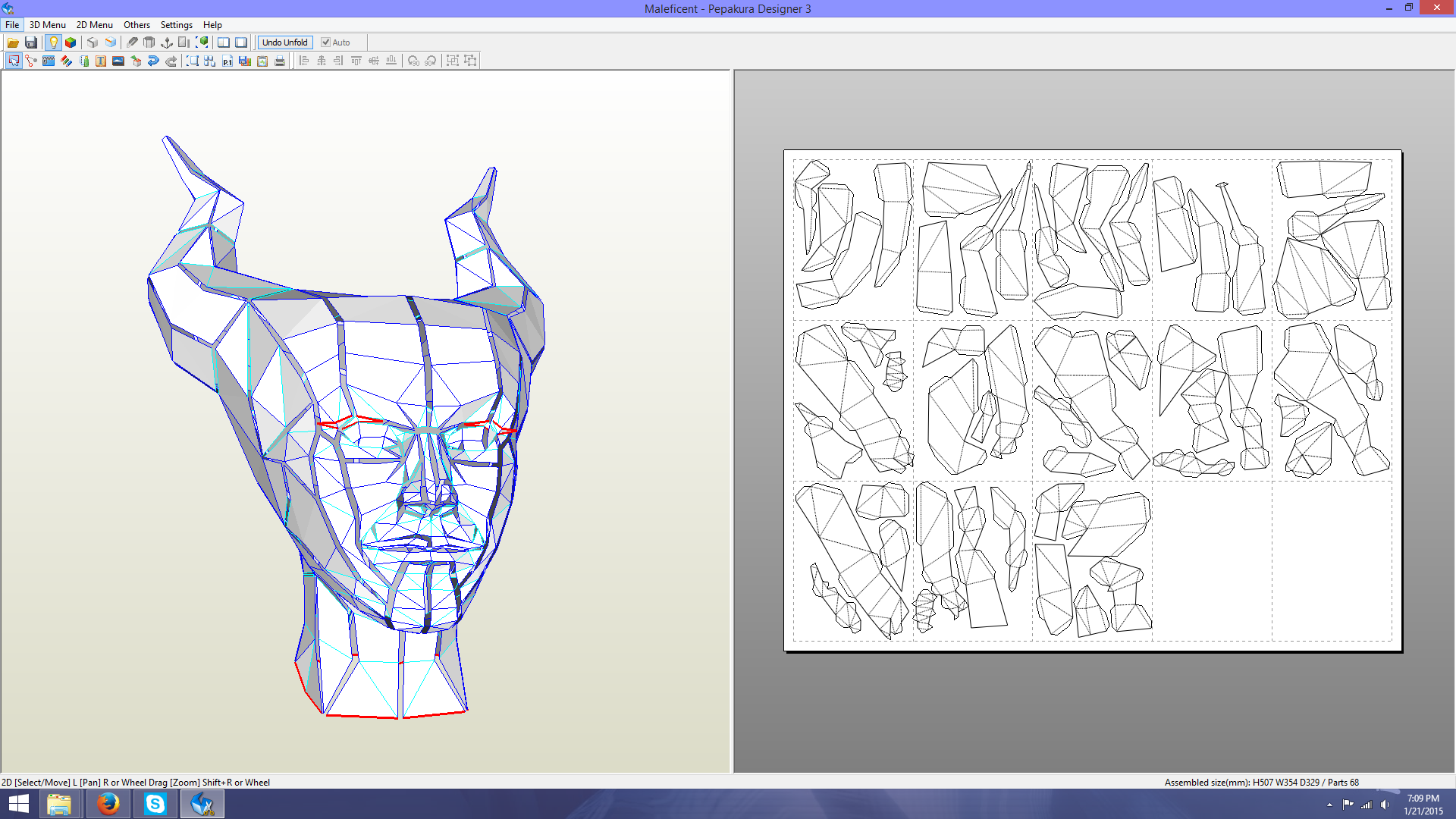

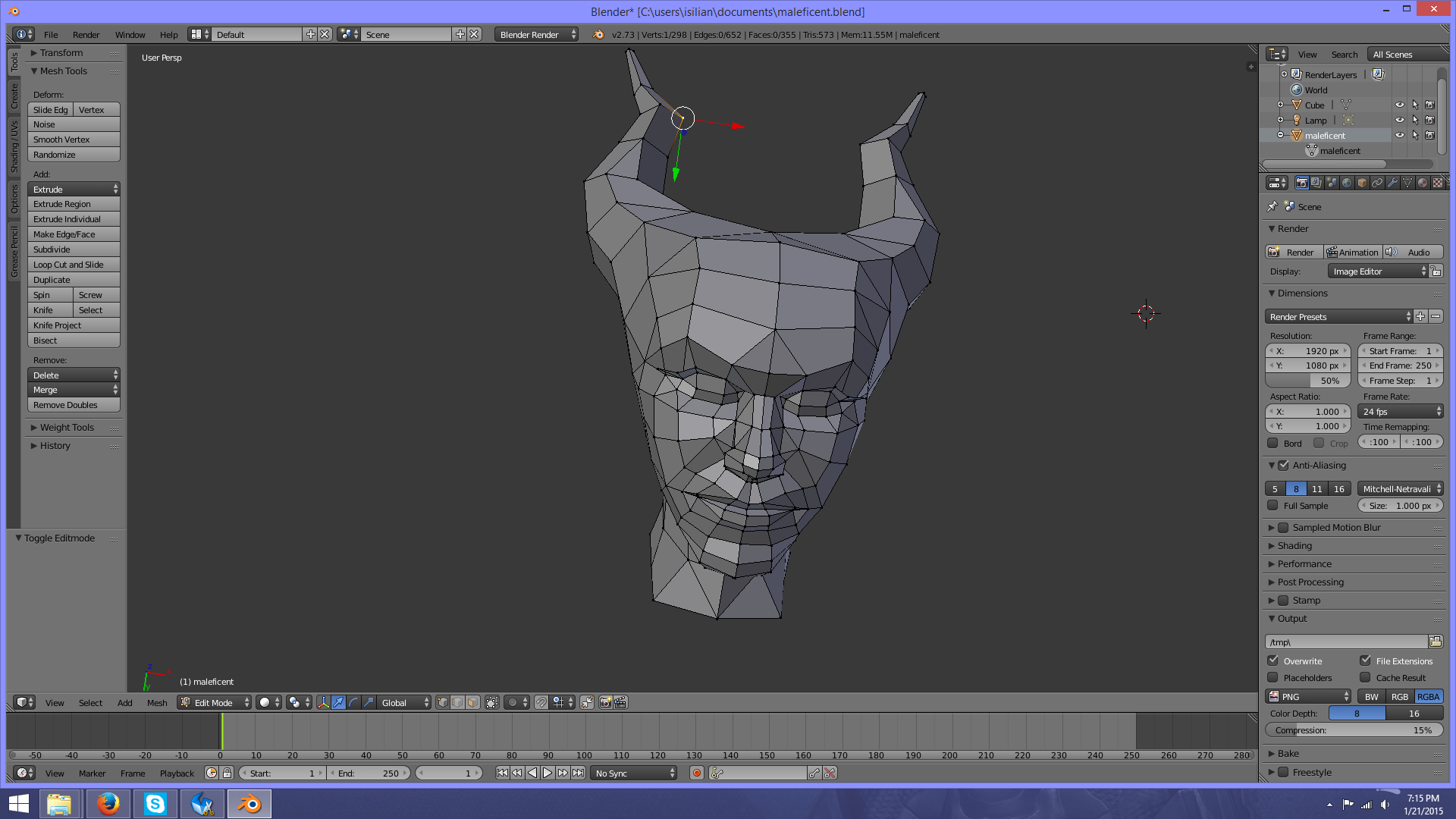

I had to start one step farther back, and look for a 3D model of her that I could then unfold and build. I found one that I liked https://www.yobi3d.com/#!/search?q=3d obj maleficent, and began the editing process in Blender. I did away with the staff and Diablo, and set about deleting everything below the base of her neck, effectively turning the full body model in to wig head with horns. I did a little bit of shaping to make the head a little wider since my face is not nearly as thin as the model's. In the end, it looked like this
I went over to Pepakura Designer, and started the unfolding process. It took forever to get the pieces in to a manageable arrangement. I haven't unfolded an object in a long time, and I've never unfolded something as wibbly-wobbly as this, but after lots of connecting and dividing faces to make it printable and at least somewhat manageable to build, it looked something like this
I ended up leaving the little fiddly bits of the eyes, noes and lips off the piece layout, since I don't really need those for the helmet, and they would just take more time to assemble. After I was somewhat happy (or at least I didn't hate the pieces) I took it over to Pepakura reader for Silhouette to print it out. Next session, I'll be cutting and assembling the head.

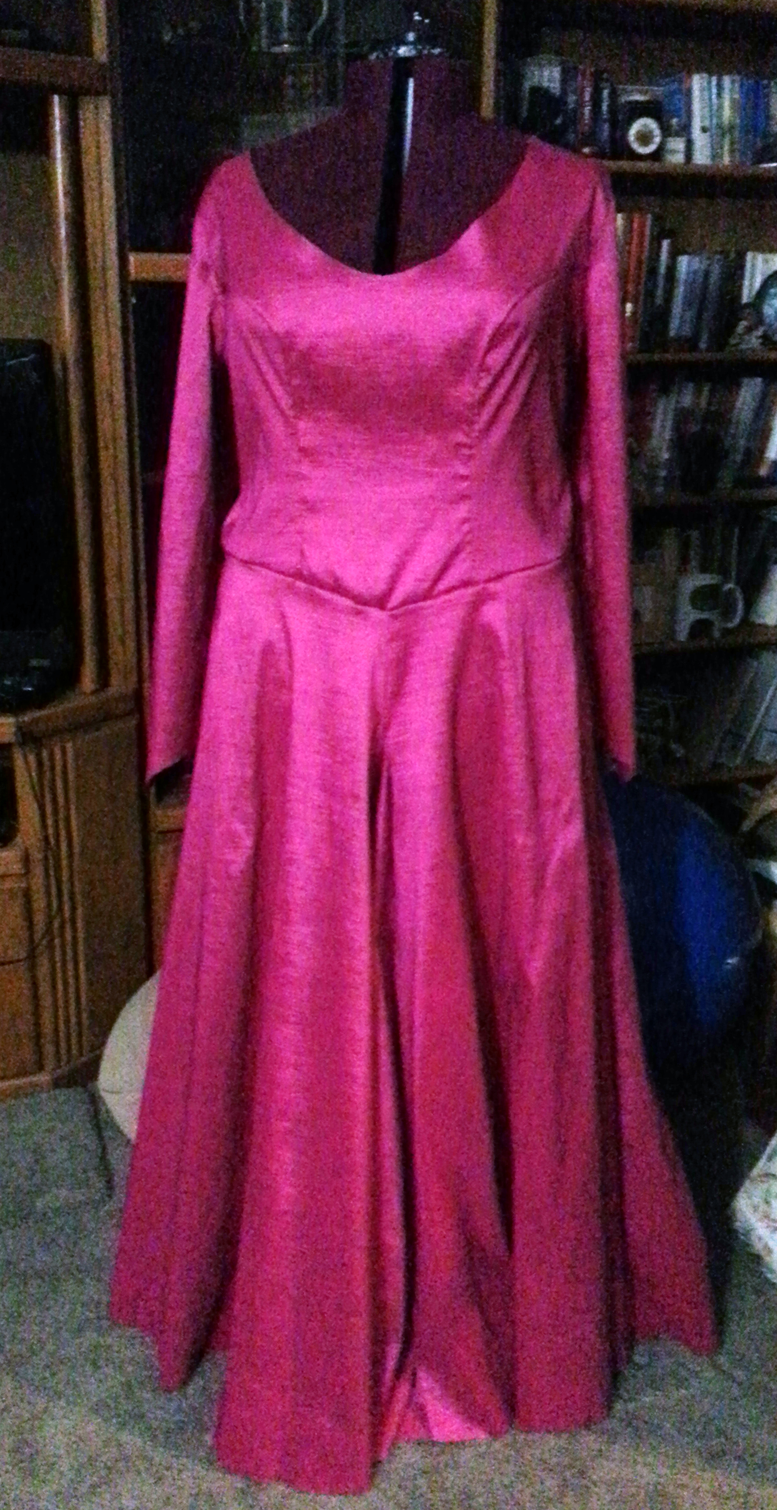

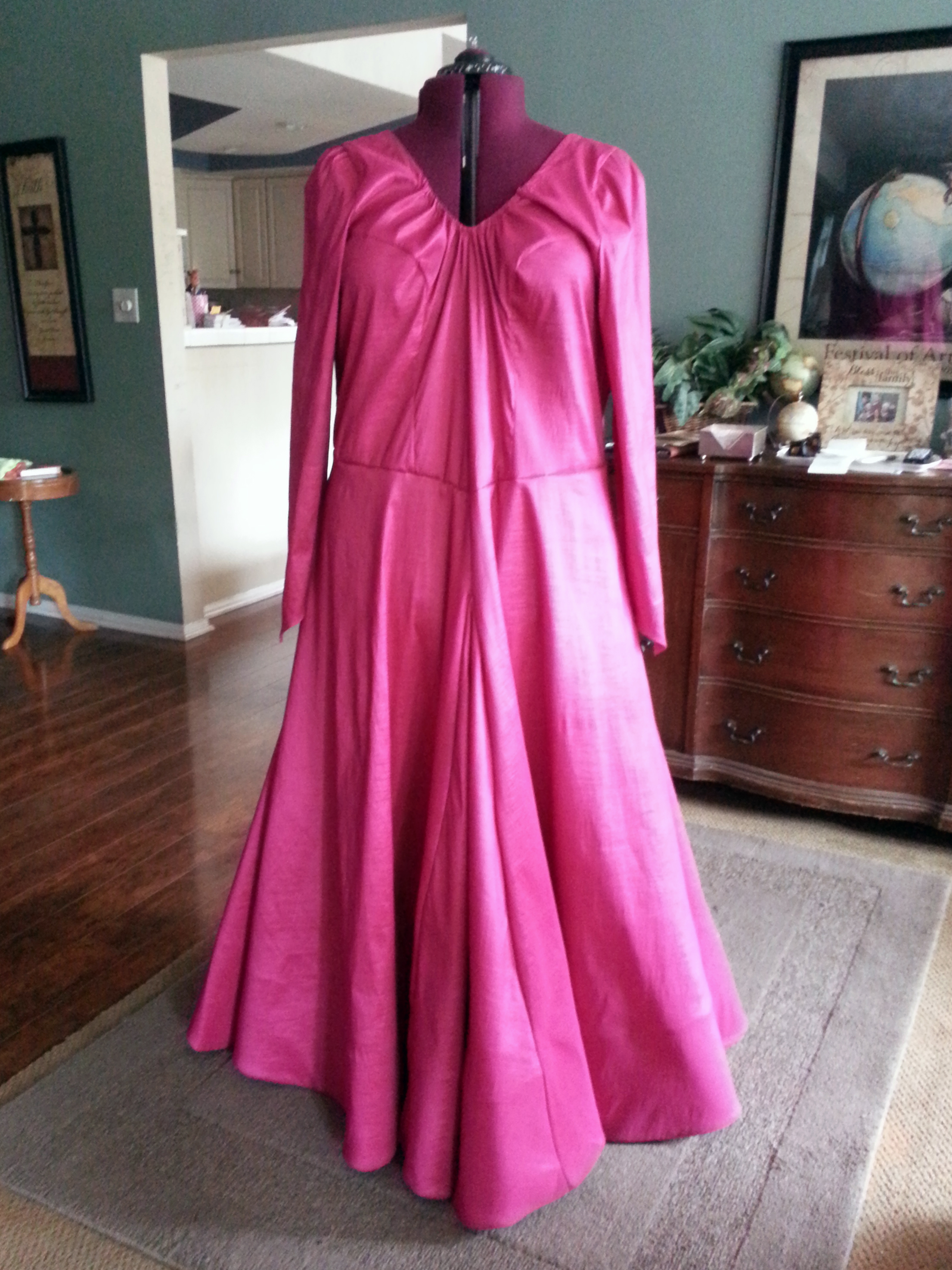

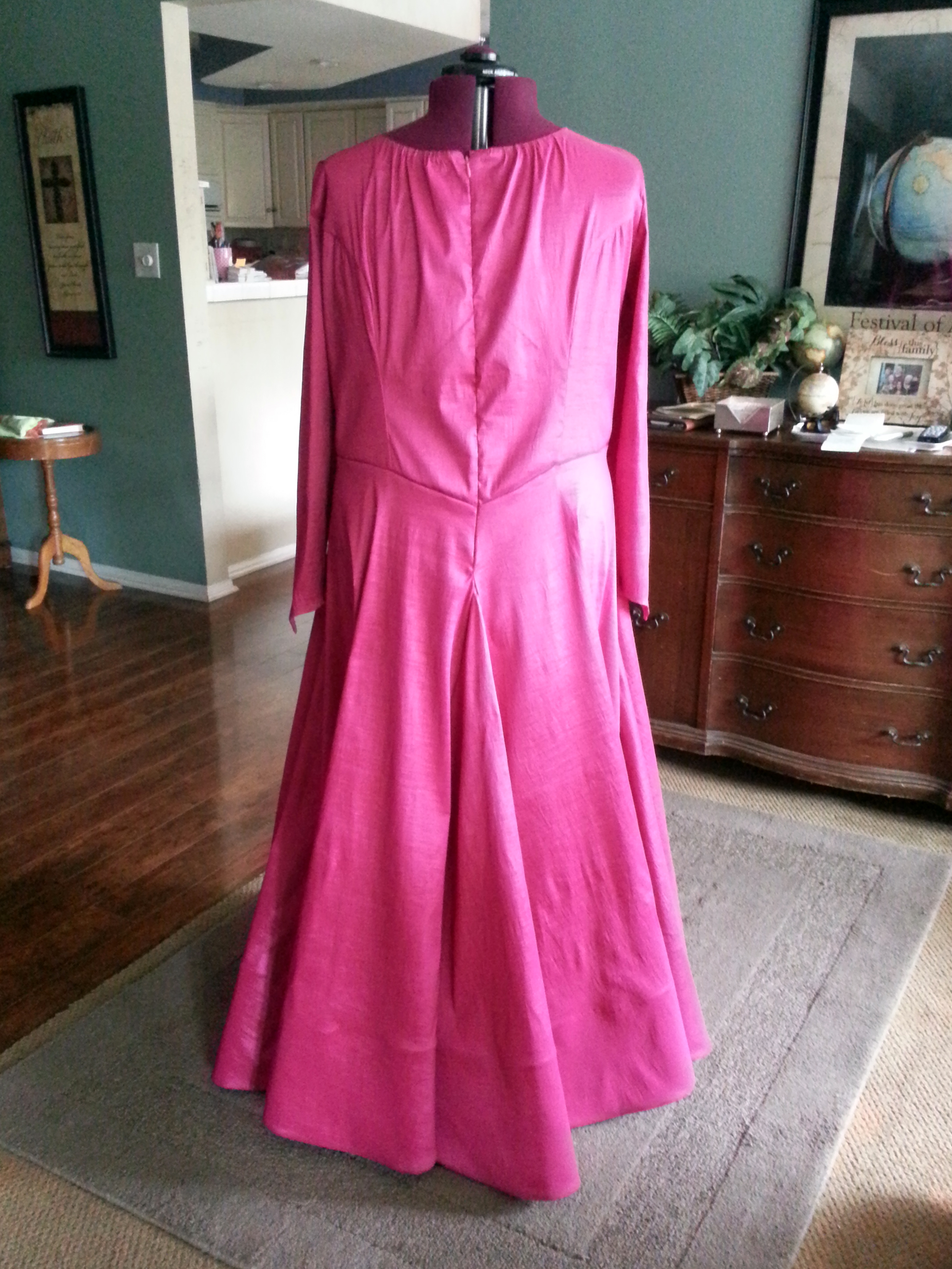

On the fabric front, I was able to cut the under dress on Saturday, and did most of the sewing on Sunday. I need to finish the sleeve and neck openings, and do the hem, but right now she looks something like this
You will have to excuse the horrible picture. It was late, and the lighting in my mannequin area is horrid. After seeing her on the form, I decided I am going to put horsehair in the hem, partially because there isn't enough length in the skirt to have it be floor length with a standard hem, but mostly because she's a little too drapey for my tastes. I was able to find 2" horsehair in a ton of colors super cheap here, but of course it's coming from China, so I'll have to wait for it to get here before I can do the hem.

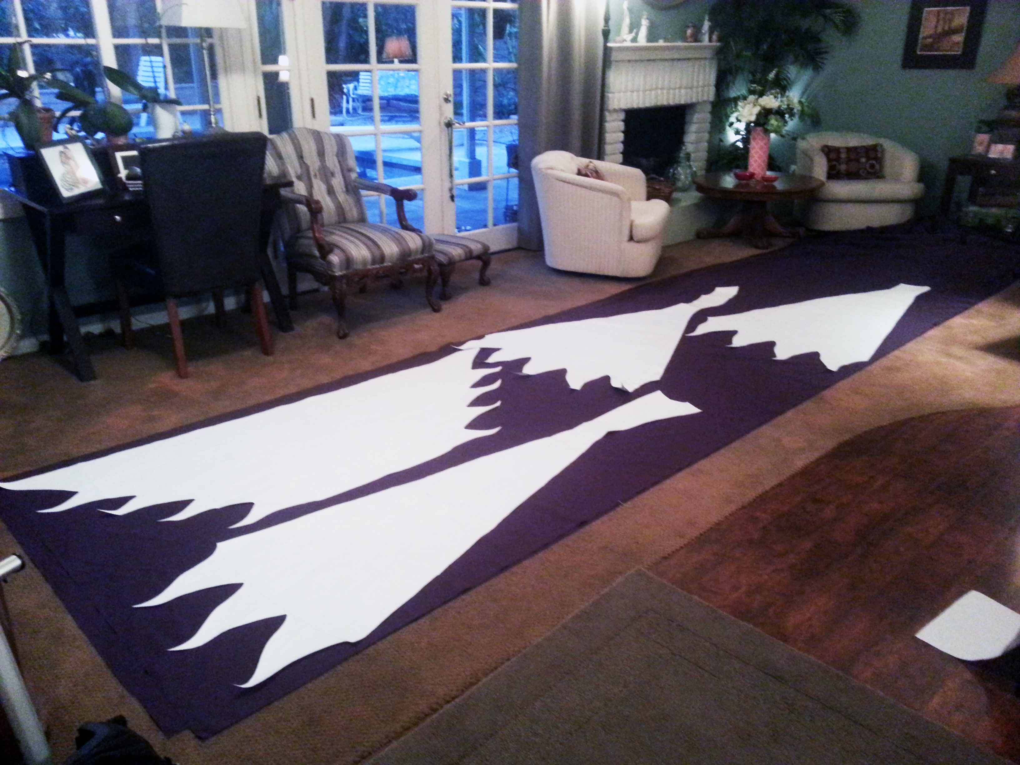

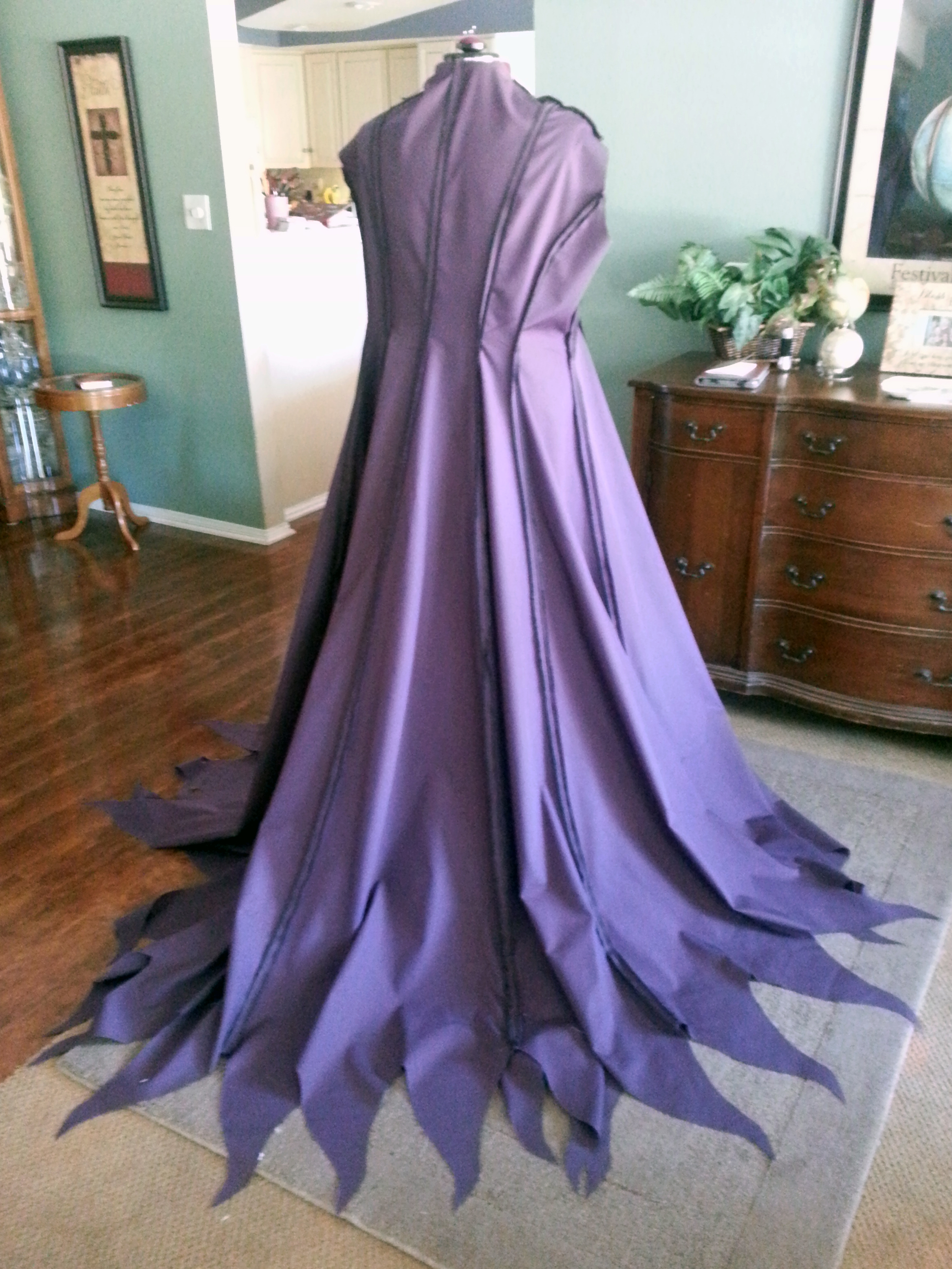

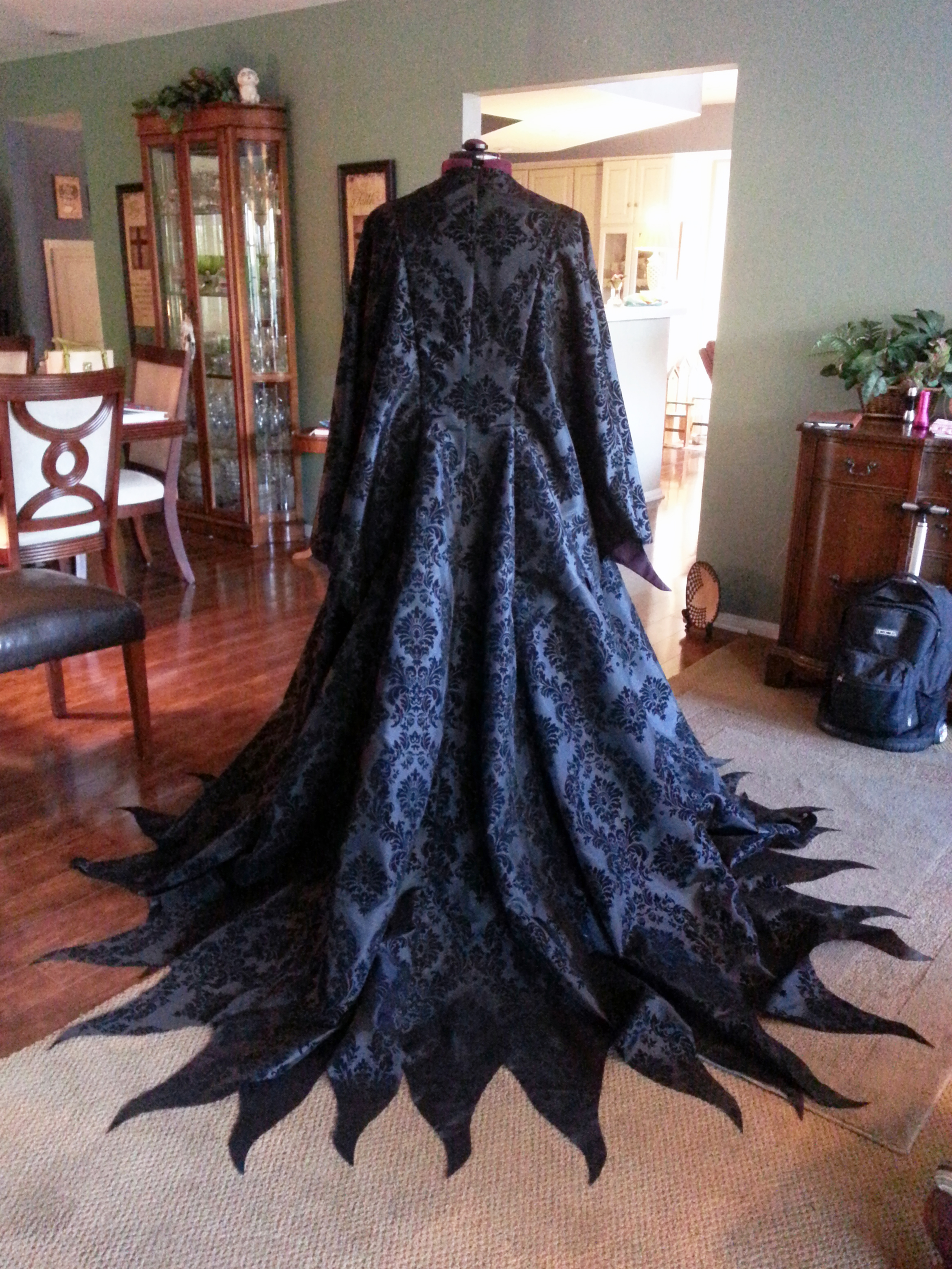

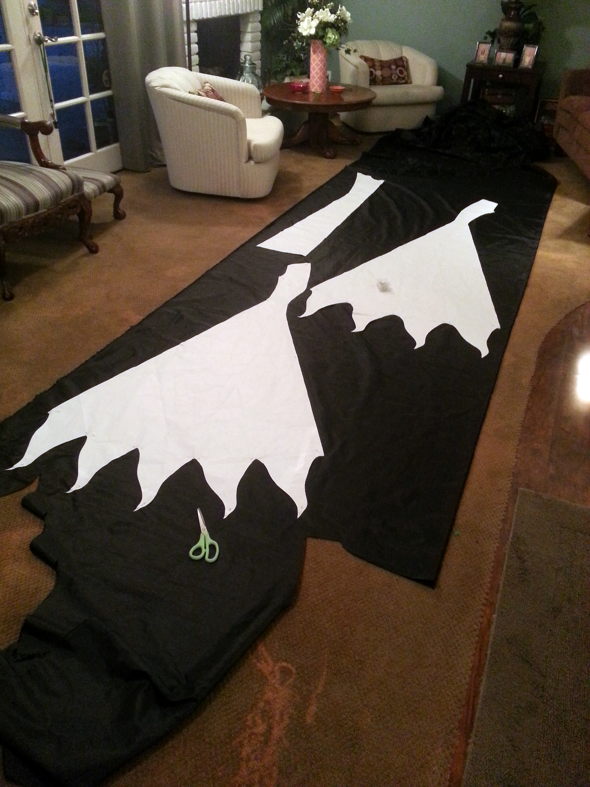

I got in some serious work time this weekend, despite the Super Bowl distracting me for half a day. It all started with the cutting
I did the initial cutting on Thursday, which is what you see above. That on the floor is most of the 14 yard piece of 58" wide fabric I got for the lining. After I started the layout, I knew there was no way I was getting all of the pattern pieces on the yardage I had, which meant I had to go back to the fabric store for more lining fabric on Friday, as well as order and additional 6 yards of the taffeta for the exterior. Once that gets to me, I'll be able to cut the exterior and start on that.
The sewing of the lining was relatively simple. The seams were really long, but compared to some of the projects I've done lately, were very simple. Since the robe is going to be a fully lined garment, I didn't bother with my usual French seaming, instead opting to serge the seam allowance after I sewed the seams. I sewed the lining in about 5 hours on Saturday.
This is what she looks like right now. The flame points don't like to lay out flat because there are so many of them, but I am extremely pleased with the look so far. I'm hoping that when I have the whole thing together, the flame points will still go a little crazy so you can see the lining under the black.
I took some time to work on the under dress as well, finishing off the neck edge and sleeve openings. I was originally going to bind the edges, but decided that I didn't want a binding to show on the edges. Instead, I got some single fold bias tape and used that to finish off the openings. I opened up one of the edges of the tape, stitched it right side to right side of the openings, understitched that seam (because I'm crazy and love to understitch everything), then hand hemmed the tape down. All in all, it have me the nice, neat finish I had wanted. Now I just have to wait for my horse hair braid to arrive from China, so I can install that in the hem.

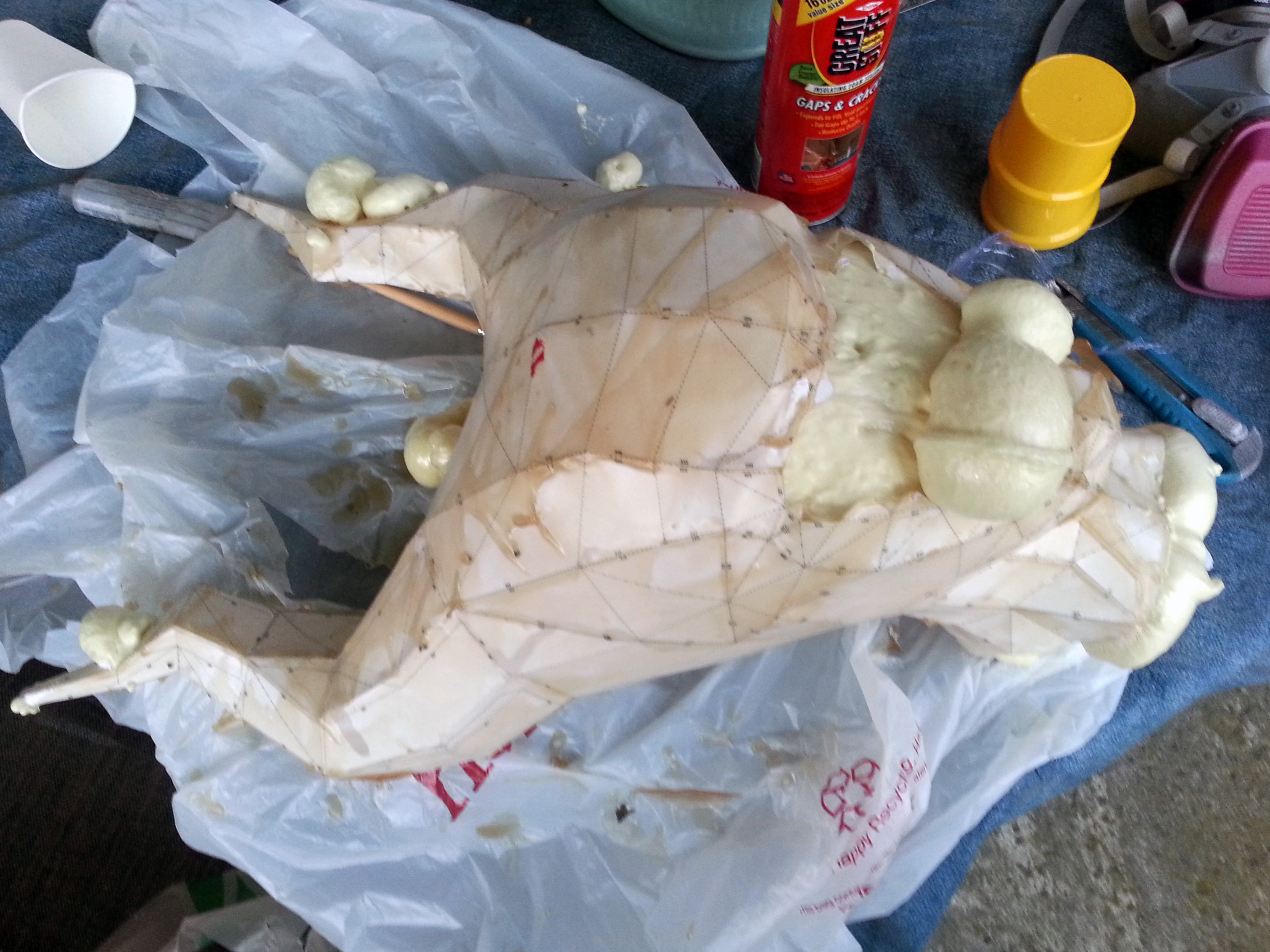

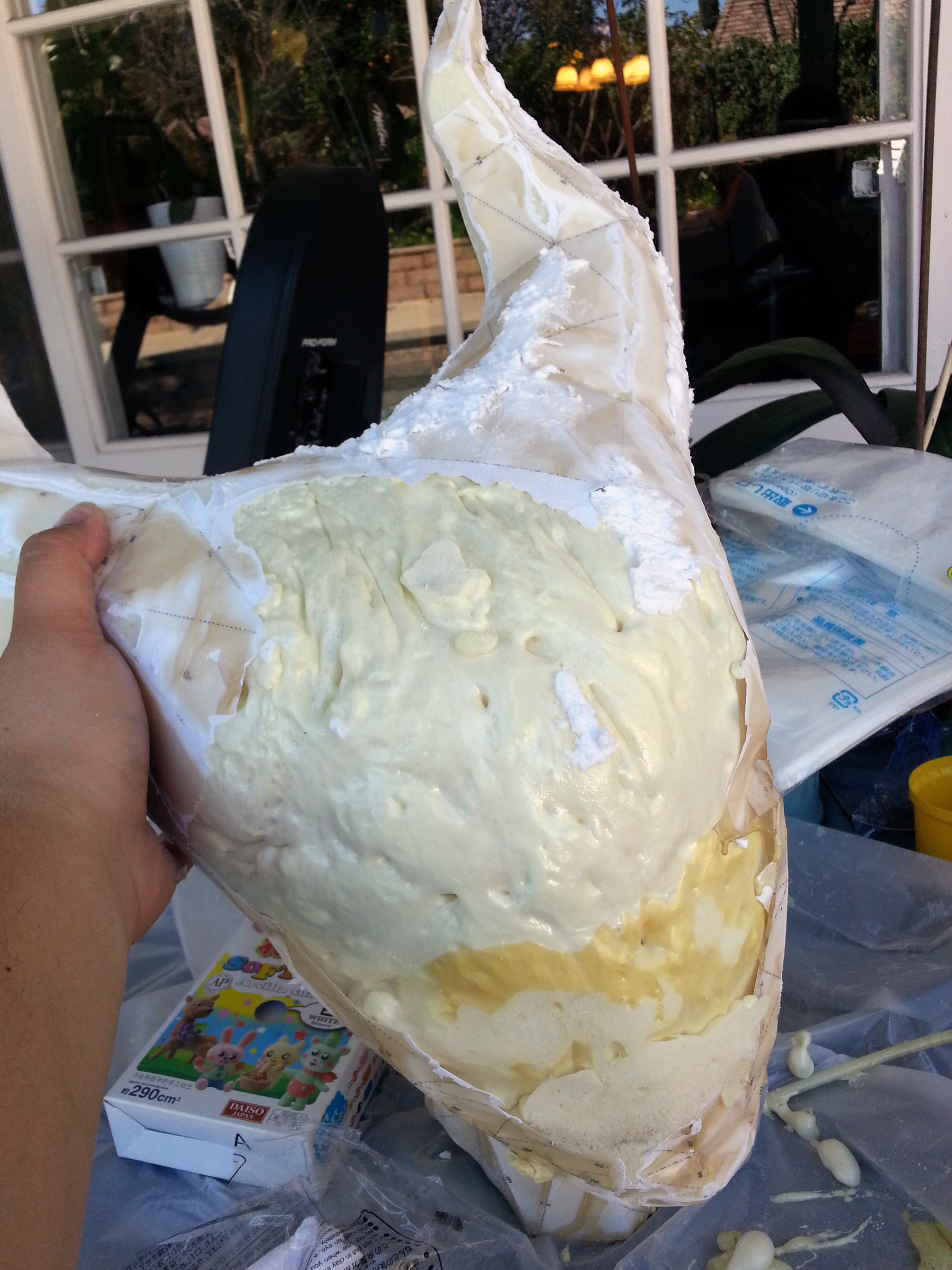

On the horn front, I resined the paper form yesterday. I had to take 2 passes to cover the whole thing since the head didn't want to cooperate and stand up. I'll be going to the hardware store today to get some expanding foam to fill it so I can start with the smoothing and shaping.
InkPigg

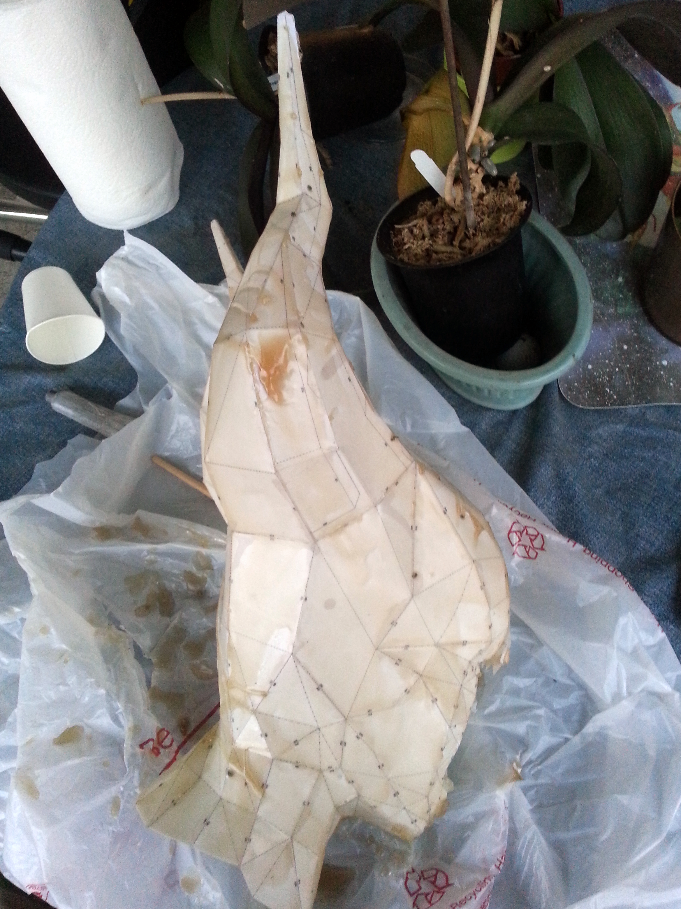

Just a quick update on the horn front.

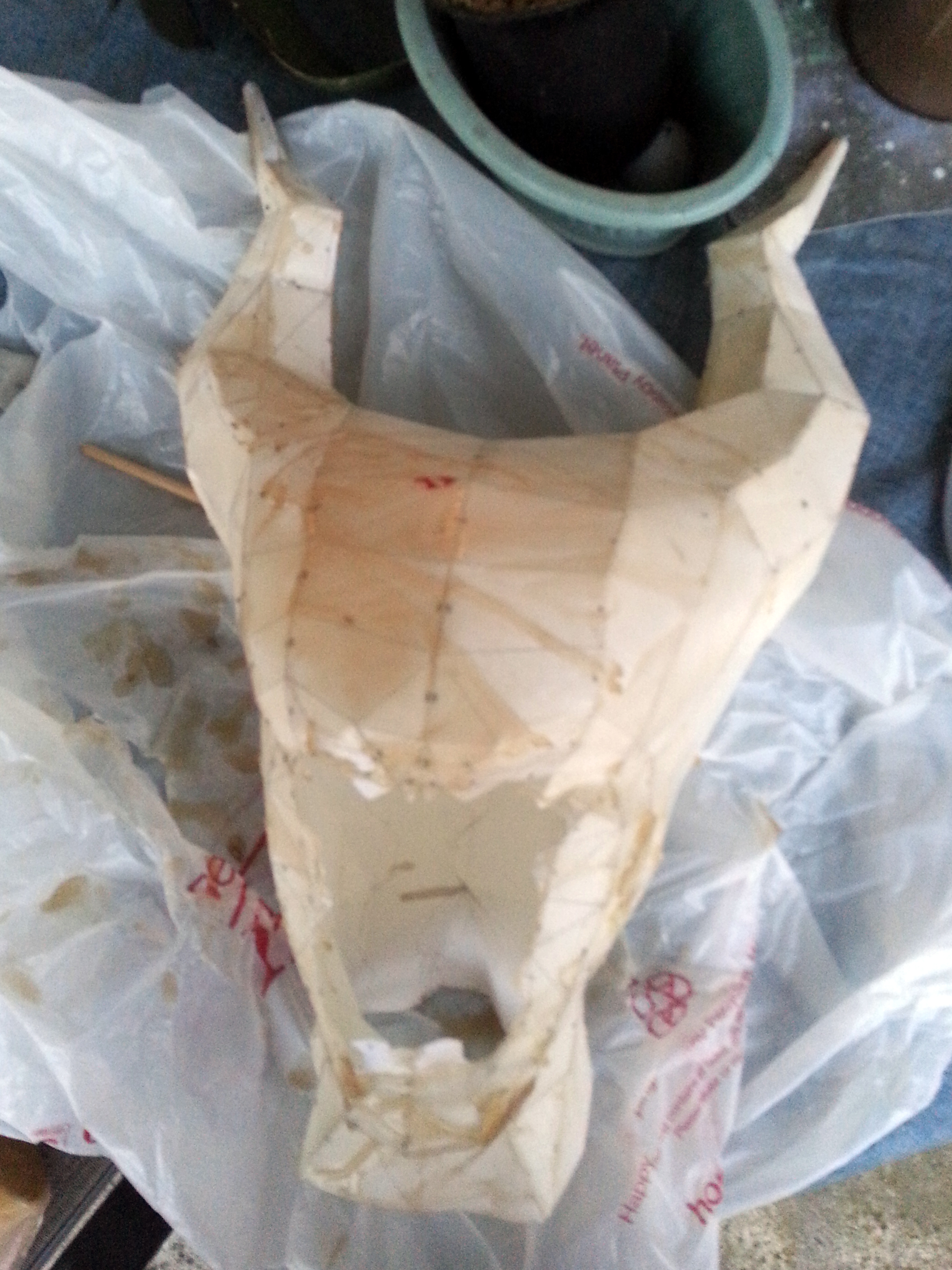

Last time I mentioned that I had resined the pepakura head, but I wanted to share a picture of the progress with you
I was working pretty fast when I coated the paper, so the resin got a little messy in spots, but that's ok since I'm going to take the head to the sander. I used a lot more resin than I normally do, since I'm not reinforcing this from the inside with fiberglass. Looking at it with the whole thing stiffened, I'm starting to wonder if it's too big. I suppose I'll find out pretty soon. I did fill the head with Great Stuff so I have something to carve in to later.
Poor thing, she looks diseased. I ended up having to drill access holes near the tops of the horns since I couldn't get the foam all the way to the tips from inside her face. I used one full can to fill her up, with a little extra from a second can I had lying about to fill in the gap near her chin. I'll probably spend some time this weekend carving and sanding her down to get ready for the thermoplastics.

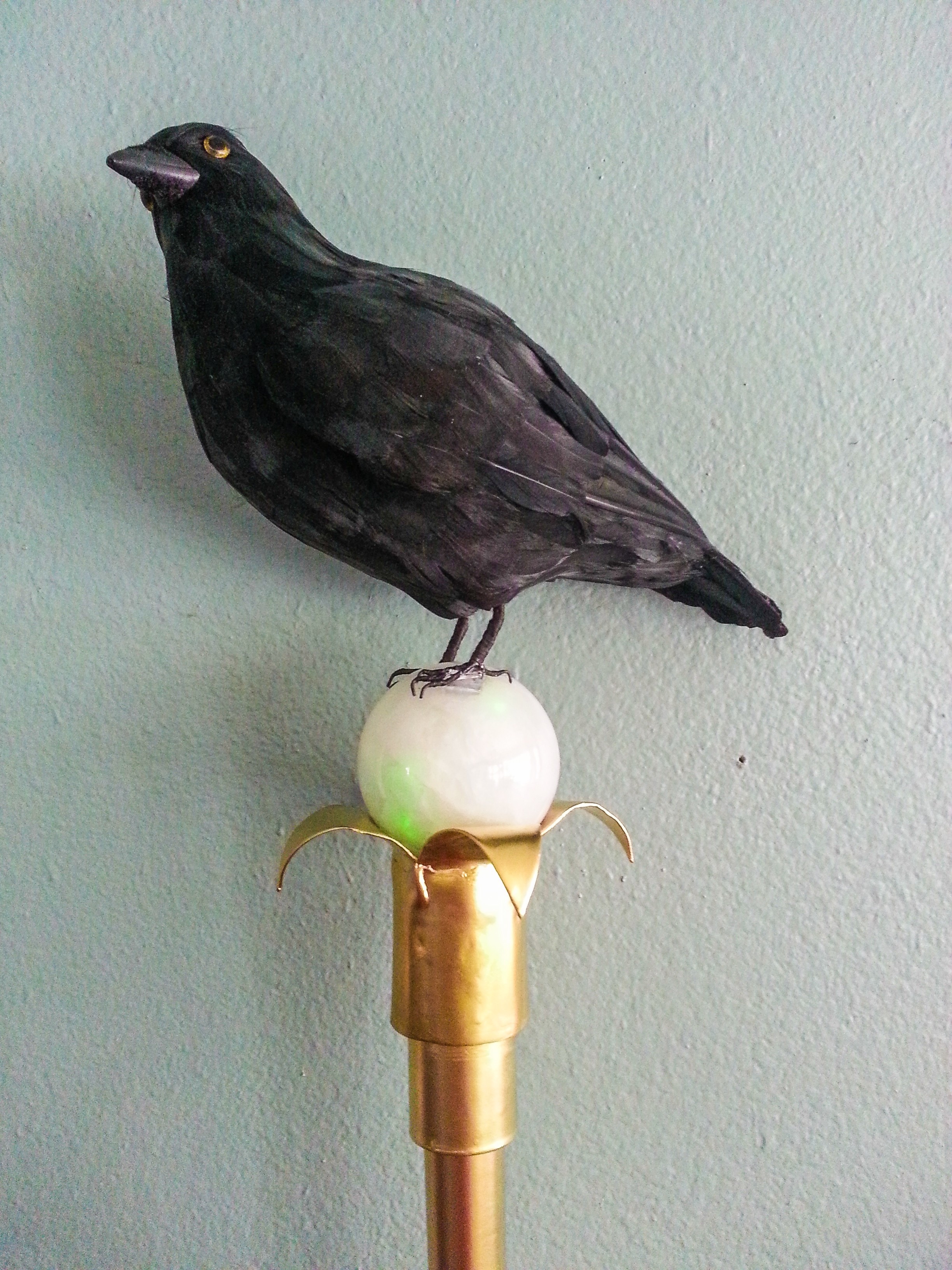

I got a raven! I wasn't sure I was even going to have a Diablo for this costume, since I was having a hard time finding a bird that was the right size and looked good. But I found this one while poking around on eBay, and I knew he was the right bird for the job. Now I have to figure out how I'm going to mount him to my staff and/or shoulder.

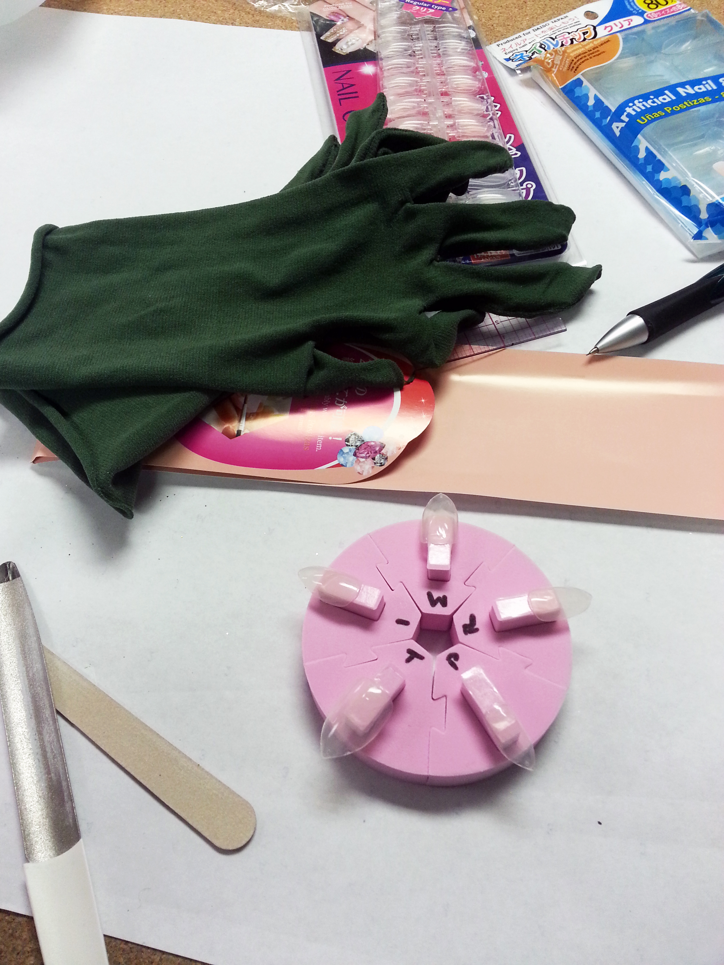

In the actual crafting portion of the costume, I started on a somewhat strange item. I knew going in to this that I was going to have to paint my face green, but I wanted to avoid painting my hands if possible. Luckily, I had this pinned for a circumstance just like this. So I set about sewing a pair of acceptably green tights in to gloves.
The gloves look a little weird just lying there, but they look good on my hands. I need to put some elastic in the wrist to keep them in place, and I'm probably going to put a magnet in the top of the wrist to grab on to the robe sleeves when I get all dramatic. Painting the fake nails was a bit of a struggle for me. I don't normally paint my own nails, so I kept messing the fake ones up. 9 of the nails made it on to the gloves, but I somehow managed to melt the right thumbnail when I was trying to put hot glue on it, so I need to redo that one.

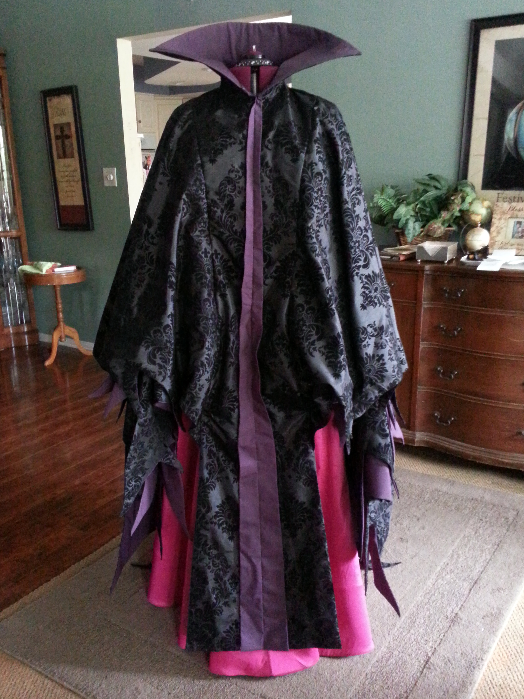

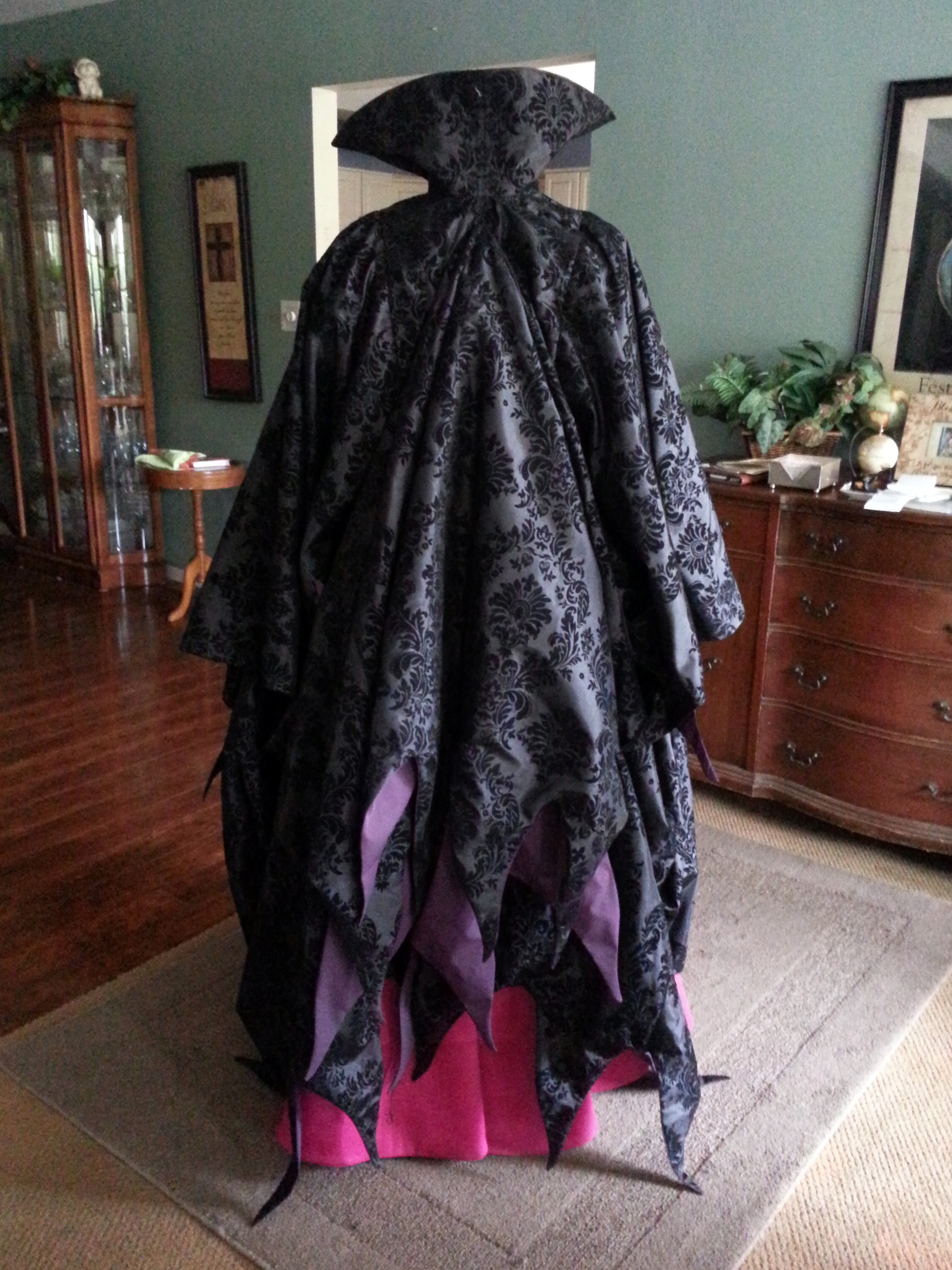

In serious sewing land, I did some serious work on the robe. Of course, it started with the cutting.
For the record, I hate cutting. Cutting is the worst. I would rather hand hem 20 yards of skirt than cut 20 yards of fabric. That being said, I did all the remaining cutting in one sitting. I'm just happy I won't have to cut those flame points any more. They look nice, but they really, really suck.
I started the sewing with the wing sleeves, just so I could get a feel for the sewing of the flame points. I got both of the sleeves sewn in one night, despite my stupid idea that I needed to understitch the lining as far in to the points as I could. Lesson learned here: there will be no undersitching on the hem flames.

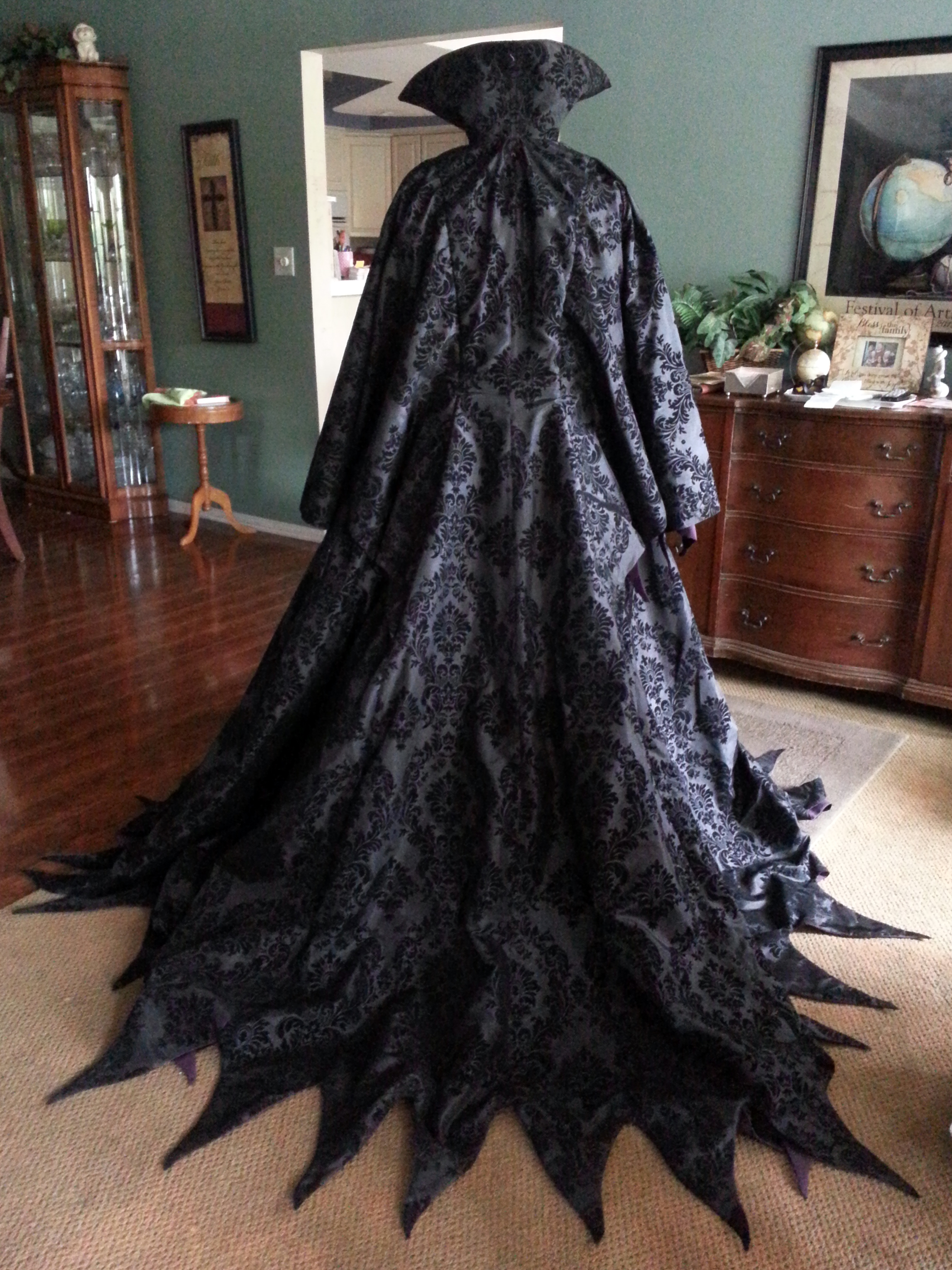

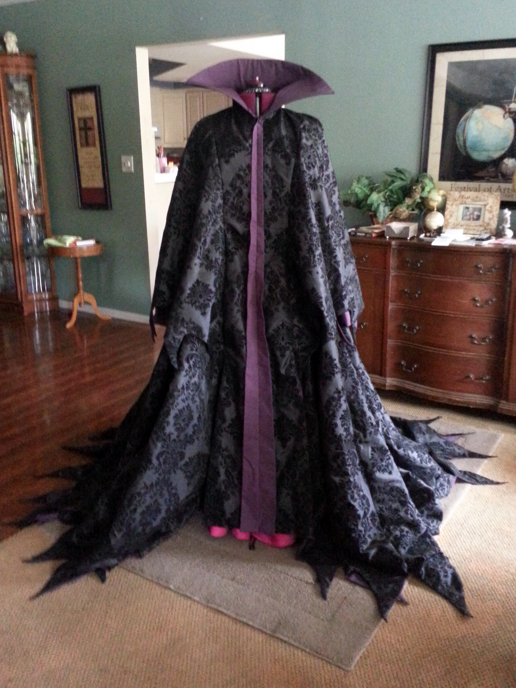

The robe exterior had to be assembled in a very specific order, so it took me a little longer than the lining. Normally, I start my sewing at center back and work out from there, but because I was putting the wing sleeves in to the shoulder princess seam, I had to modify my order of sewing. I started with center back, then attached the center front pieces at the shoulder seams. Then I assembled the middle and side fronts and backs in to the side sections, also attached a the shoulder seams. Since I was putting pockets in the exterior, under the wing sleeves, I had to puzzle through the order in which things were going to get sewn in the shoulder princess seam. First, I basted the wing sleeves to the center sections, starting at the shoulder and going down the front then down the back. Then I sewed the pocket piece on top of the sleeve, with it still folded over the center panel. Attaching the remaining pocket pieces to the side panels followed that. After that, the whole seam got sewn together from shoulders down, going around the pockets and everything. And since I decided I didn't hate myself enough yet, I serged off the edges of all of my seam allowances.
It was totally worth it though. I'm super happy with the way it looks, even without the collar and the lining attached. The wing sleeves might be a little too long, but since I'm going to be flinging my arms around a bit, I think it will be ok.
After I finished patting myself on the back, I started attaching the shell to the lining. I started with the armsceyes, since they're always a pain to sew together. I had to put the lining and the shell on my dress form so I could pin the armholes together correctly, then I took the whole monstrosity to the sewing machine and stitched and understitched them. Then it was on to the front and hems.
I started about 12 inches down from the neck edge, since I don't have my collar ready to be sewn in just yet. Down, across the bottom, and up the inside of the center front panel was easy. Down the inside of the middle front panel was easy. The hem was not. I decided the best thing to do with all the flame points was to pin them at the tips, and the valleys, and at the midpoint between the two. It sounds so easy when I say it, but it ended up taking me over an hour to get all the pins in. The sewing isn't too difficult, but since every flame tip is a corner, I have to sew slowly in to it with a tiny stitch length, reinforce the turning point, and sew back out with the tiny stitch length.
I still have to finish the last third of the hem stitching, and I need to finish the collar and put that in as well, but the robe is well on its way to completion. I didn't get to work on my horns at all this weekend, but with the robe almost done, I should have more time to devote to the horns soon.

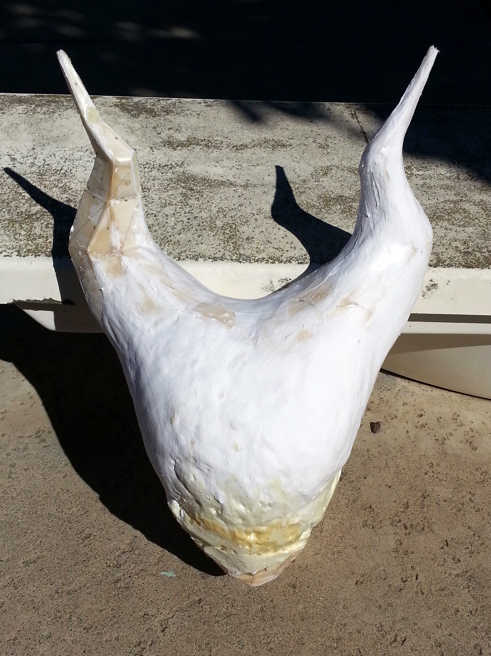

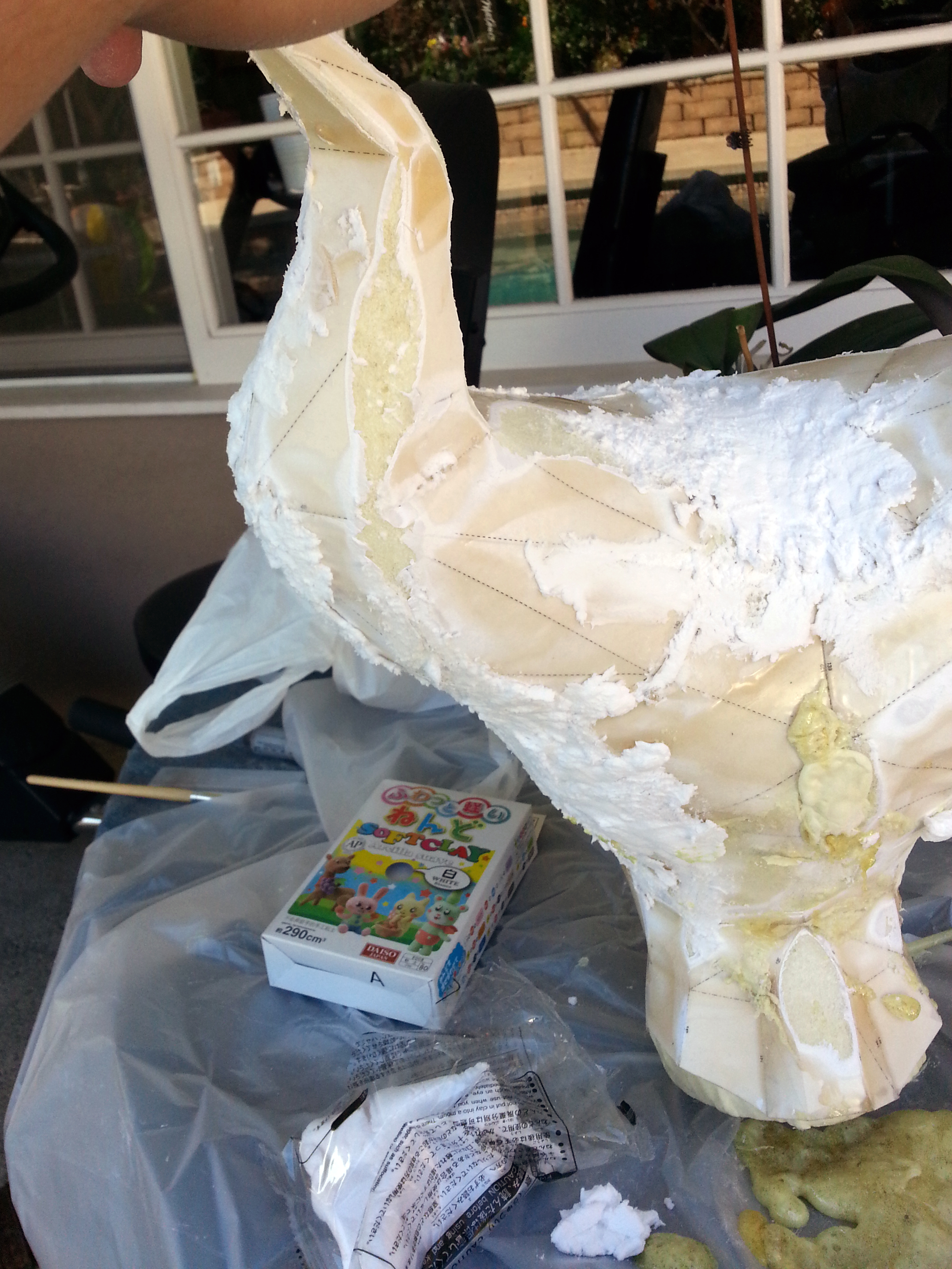

So this weekend was all about the horns. I took the head to my belt sander to start cleaning up all the foam overflow and round off the corners before I started sculpting on top of it. It was going well, until I started working on the back of the head. I had a big foam overflow back there, and when I removed it, there was a pocket of uncured foam underneath it that started pouring out everywhere. I ended up having to hold the head and let it drain the uncured foam for about 30 minutes before I could get in and close the hole up. Unfortunately, this meant that my goal of starting the thermoplastic forming on Sunday was out of the question, since I was going to have to wait for the foam to cure again before I could finish the sanding. I took the extra time to strip away some of the resined paper so my clay would have something to grab on to when I started sculpting.
Poor thing, she looks like some kind of alien. In the back picture, you can see where I've patched the hole left by the foam explosion. Since I wasn't going to be able to finish the back of the head until Sunday, I started sculpting over the forehead and horn. I used an air dry clay similar to Crayola's Model Magic that I get from my favorite Japanese dollar store. I prefer it to actual Model Magic because it's so easy to smooth out with wet hands, even after it has started drying. In the first stage, I smoothed out the forehead and the top of her head, then set her out in the sun to dry while I changed my smoothing water and rested my hands a little.
Stage 2 was about the horn and the back of the head. Notice I keep saying horn, singular. I'm only going to use one of the horns to form over, since I want my finished horns to be symmetrical. So I picked the horn I liked better, and started to sculpt over it. There were a lot of sharp corners that needed to get smoothed over, so it took me a little while to get done. I put some clay on the back of the head too, but since I was limited by the still-curing foam, I didn't do a whole lot to it.
I took her back out in to the sun for a little while, just so I could make sure she was doing ok. I did a little bit of smoothing out with water before I left her to dry for 24 hours. I ended up using 2 packages of clay to get her to this point.
So I came back to her on Sunday afternoon, and the clay was dry and ready for sanding. I powered up the dremel to take off the overflow of foam on the back again, and this time it seemed to be all cured underneath. Then it was on to hand sanding on the clay. It didn't need too much done to it, just a few nubs taken off here and there, but the bigger issue was all of the divots and low spots on the clay. I considered doing another layer of clay, but decided it was easier to use some spackle to fill in the places I wasn't happy with. About 30 minutes of spackling, and she was ready to cure again.
Fortunately, the thermoplastic I'm using doesn't pick up all of the little details, so she should be ok to use as a form like this. I might not get to do the forming until next weekend, but I should have her sanded down in the next few days.

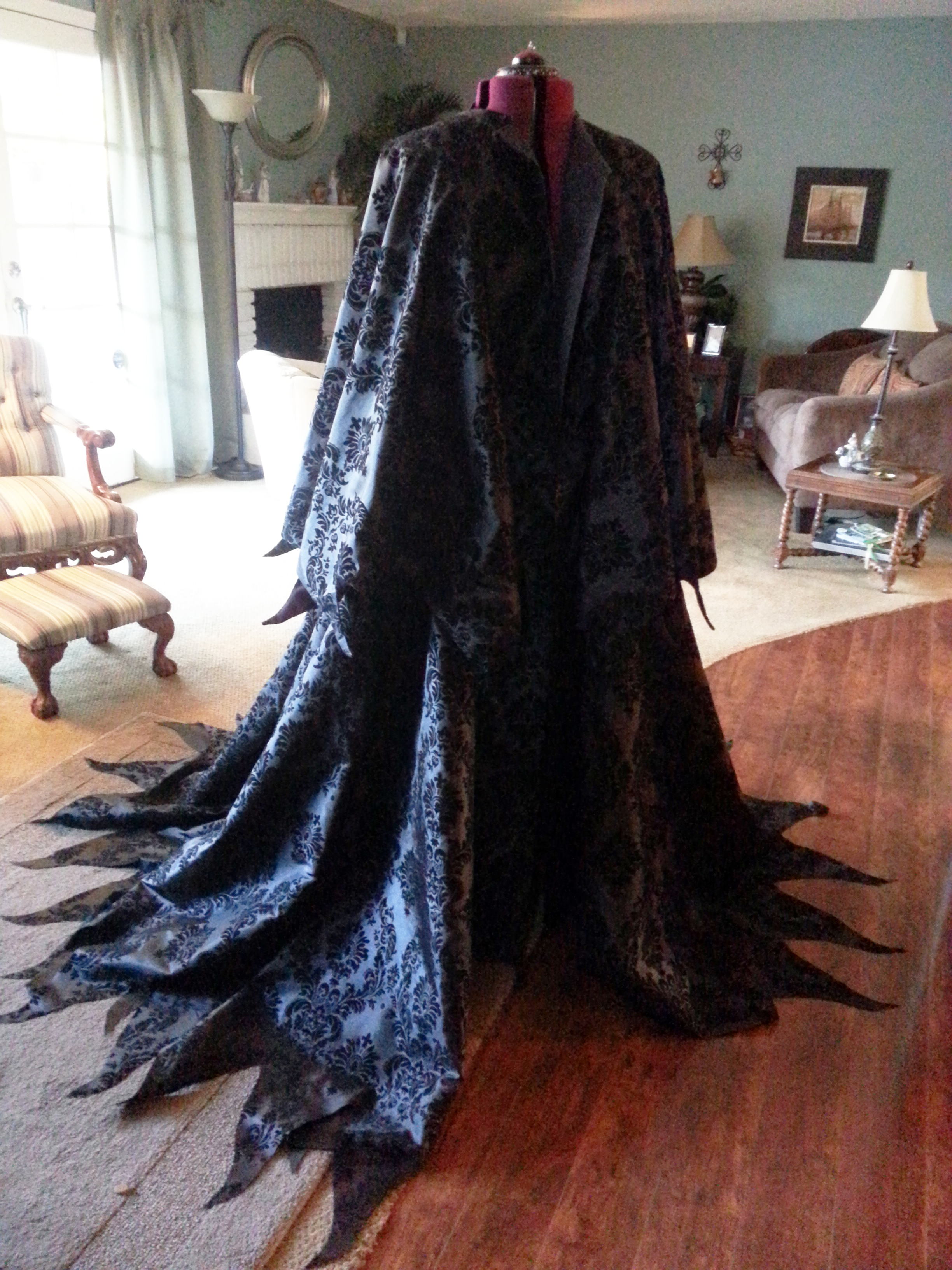

In fabric land, I finished with the robe. Her collar is on, the hem is finished, she's been pressed, had her zipper installed, and closed up down center front. I ended up hand stitching a piece of lining fabric over the zipper tape to hide it, since it will be visible at the neck and I didn't like the look of the tape being exposed. The only thing I have left to do on the robe is installing magnets on the sleeves so they snap to the gloves. I'm going to use some rare earth magnets so they'll be super strong, but tiny.
I'm still waiting for my horsehair braid to come in from China, but I've been keeping an eye on their tracking progress, and it looks like both of them will be here by the end of the week. I'll probably put that in the dress on Saturday (since I have to work in the middle of the day and won't be able to work on the horns) and call her done.

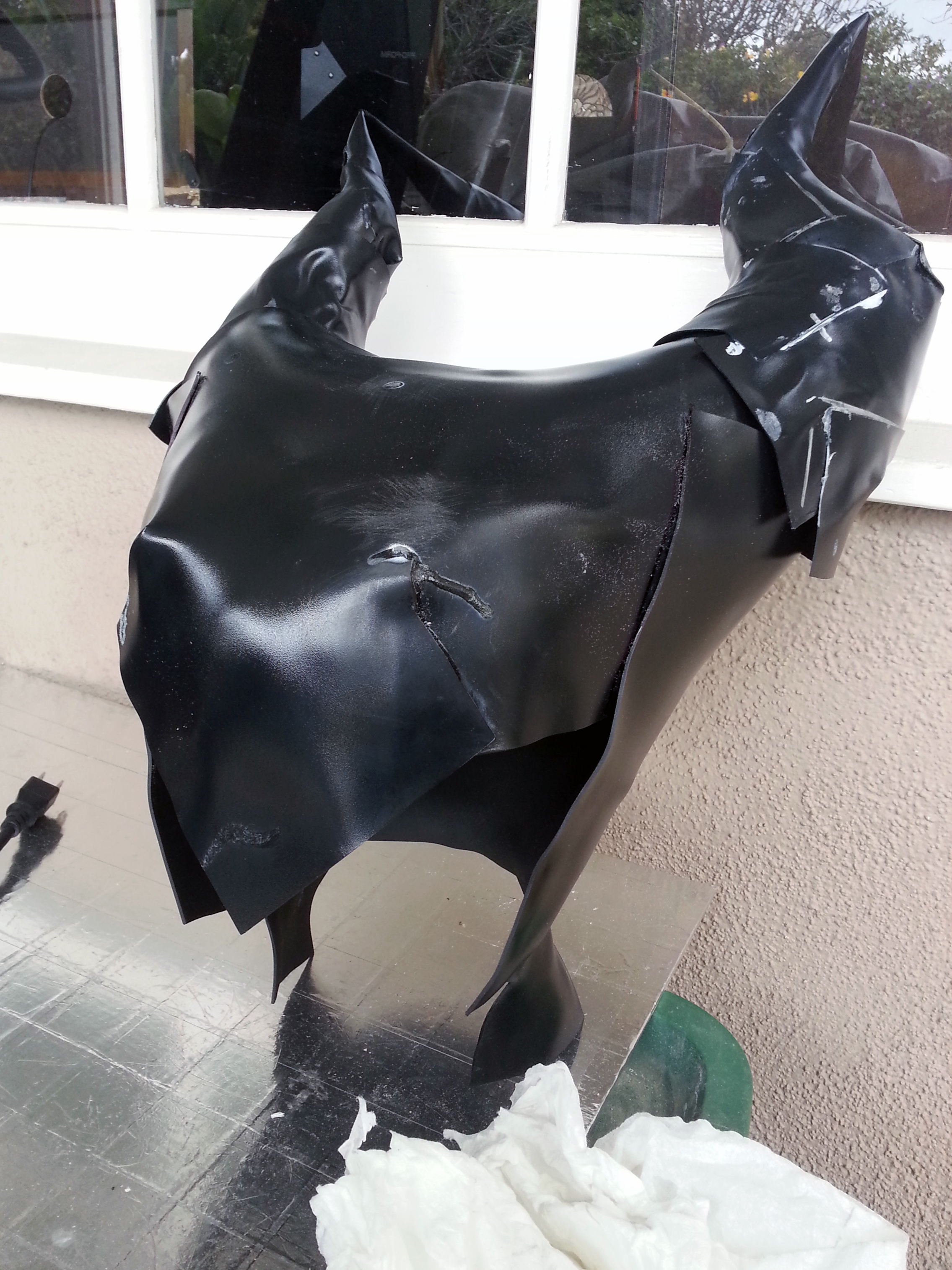

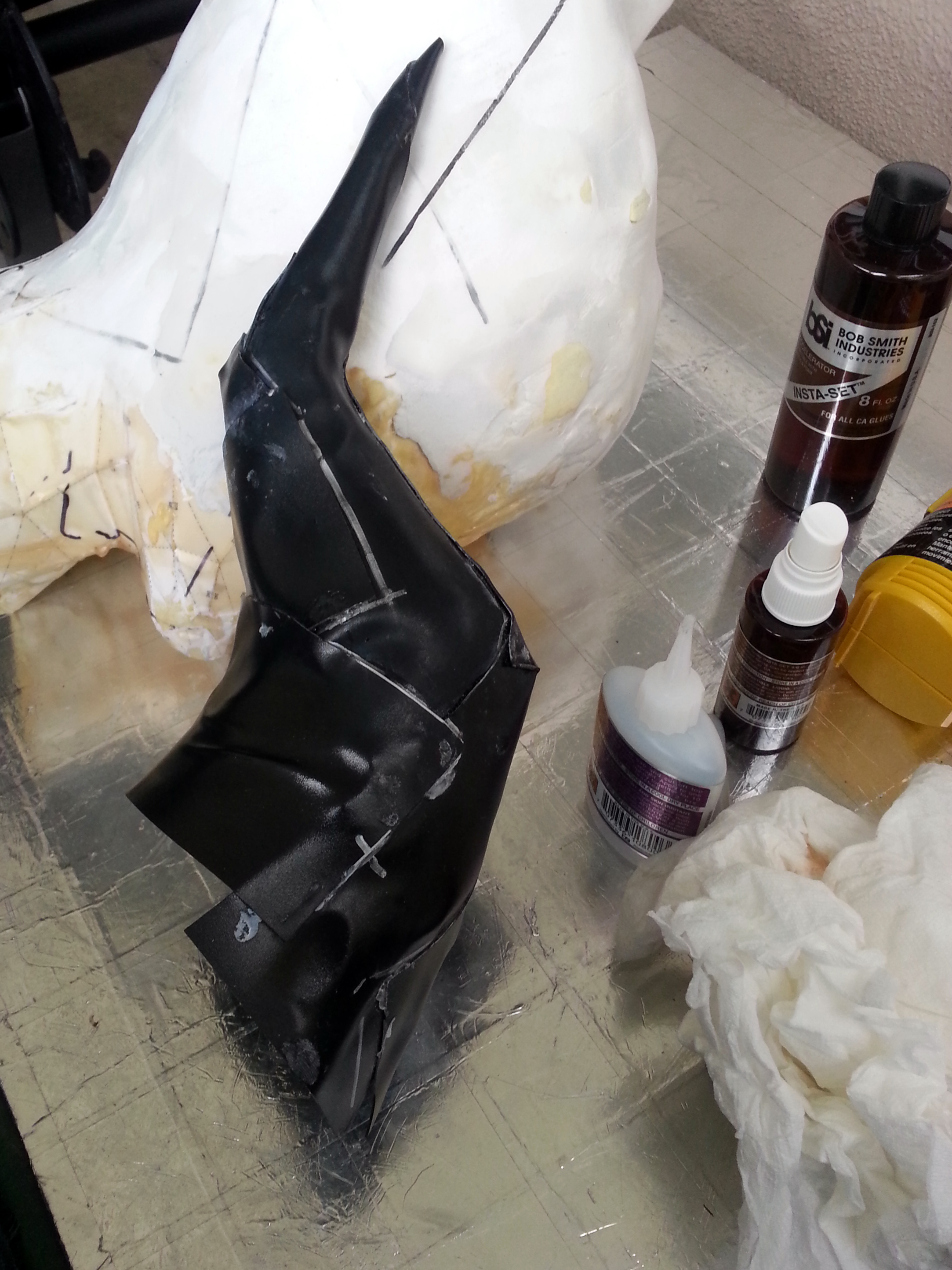

In horn land, I started shaping the Kydex to my base head. I somehow thought I could mold the horns from a single sheet of plastic, but realized halfway through the process that 1) Kydex is not as flexible as Worbla, and 2) there would be no way for me to remove the horn from the base. So I went to plan B and started wrapping strips of plastic around the horn.
This method is not as clean as I would like, and I have to mold each strip while it's independent from the others, then attach them later, but with some sanding and filling I think it will work out. Unfortunately, it was raining when I was trying to glue the first horn together, so the adhesive wasn't setting. I'll have to wait until later in the week to attach everything I've done so far.
I also molded some thicker sheets of Kydex over the skull part to form the helmet base. I had to form that in 4 sections, but once all the parts are glued together, I'll sand the joins and fill the gaps, and it will be seamless enough to cover with fabric.

I finally got the robe on the form with the completed dress as well, and she is magnificent. I decided that since I'm going to be wearing this at con, and in a potentially rainy environment, that I should put some pickups on the skirt. There is one at center back and one under each sleeve at the front so I can get the entire skirt up off the ground. I probably won't use the front pickups unless I absolutely have to.
20150301_120730.jpg 20150301_120359.jpg 20150301_120618.jpg 20150301_120535.jpg

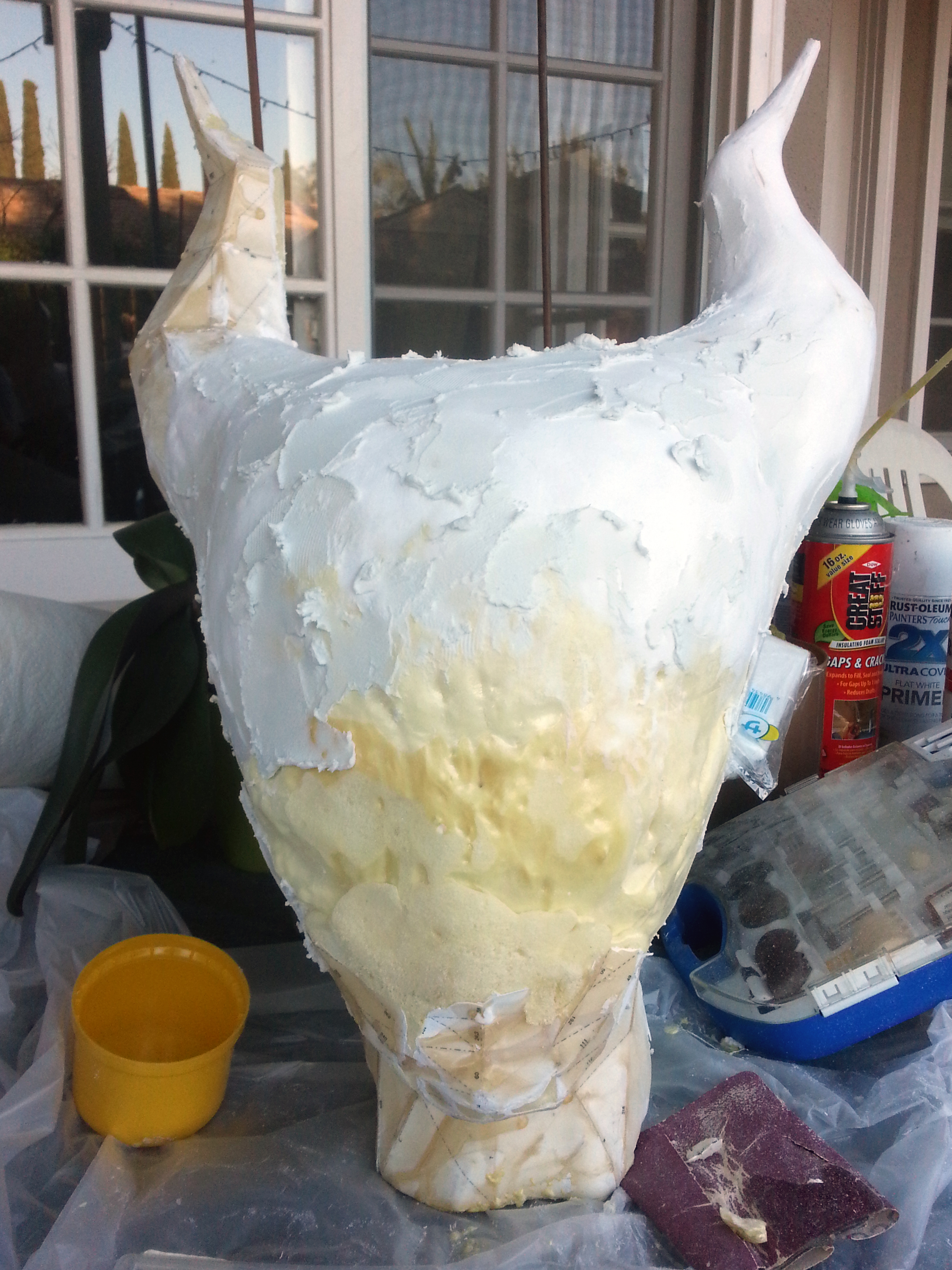

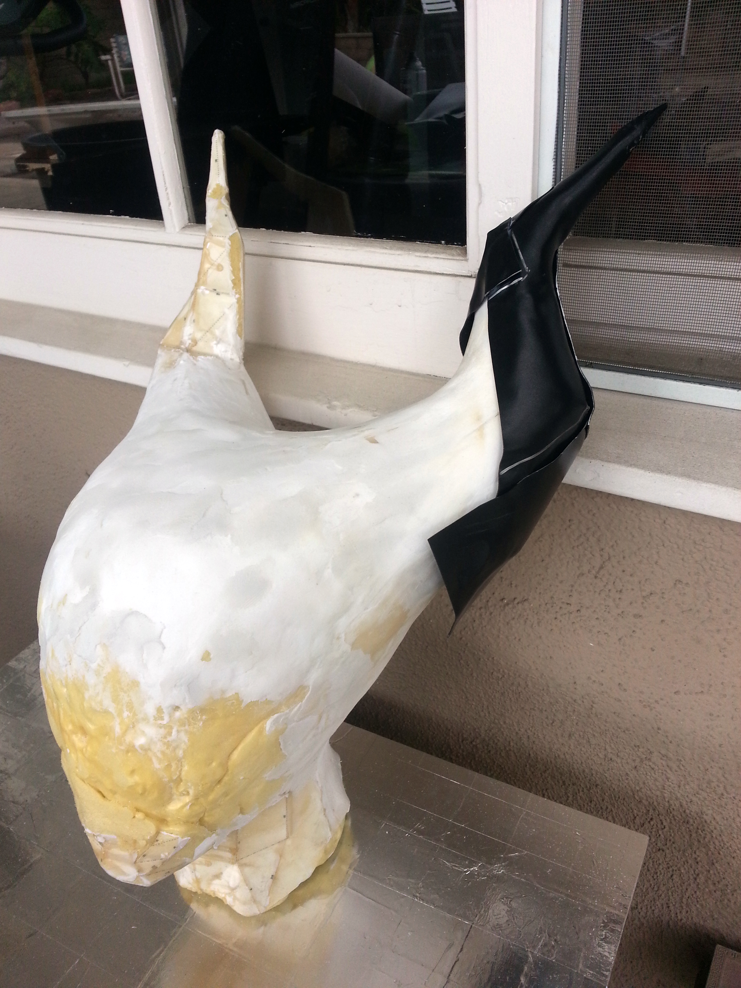

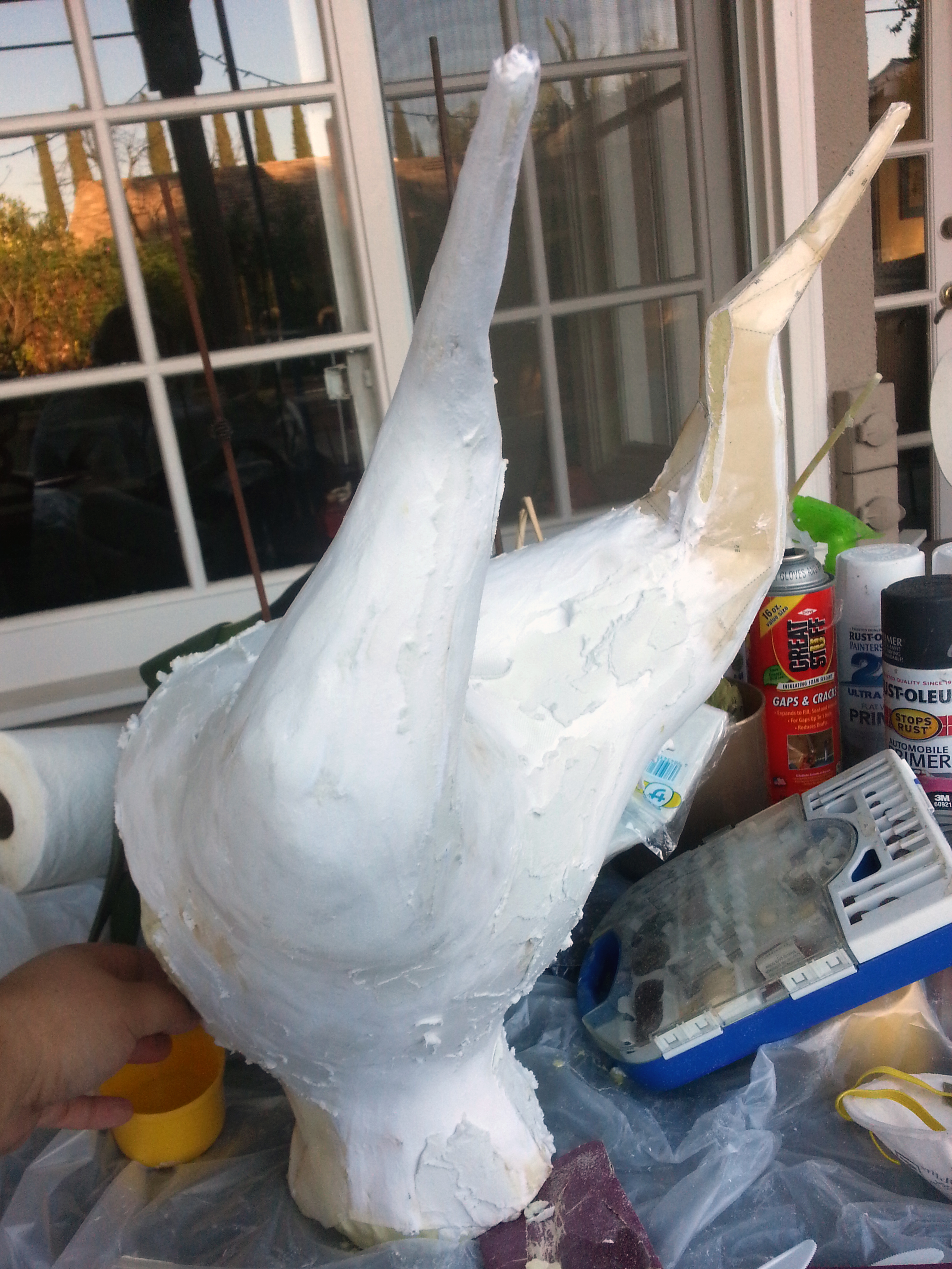

The biggest change was the helmet. Once the plastic base was all assembled, I realized that it was not only too big for my head, but it was impossible to get on without poking myself. I decided to move forward with the smoothing of the horns and make a new base for the horns to be attached to.
I used ligtweight drywall spackle to do the initial smoothing on the horns. Once it was sanded down, it was smooth enough for my needs. While I was waiting for the spackle to dry, I put together a new helmet base made of EVA foam. Once the horns were dry and sanded, I cut them off the plastic base and glued them to the new foam one.
With everything attached, I covered the horns in craft foam to smooth them out even more (of course, I was so determined to get it done that I forgot to take pictures of the foam and fabric stages). I then took some heavy nylon/spandex and hand stitched it to the shape of the horns and helmet. I attached a side releasebuckle and some nylon strapping as a chin strap, and a couple of magnets to hold the piece of fabric that will cover my neck closed.

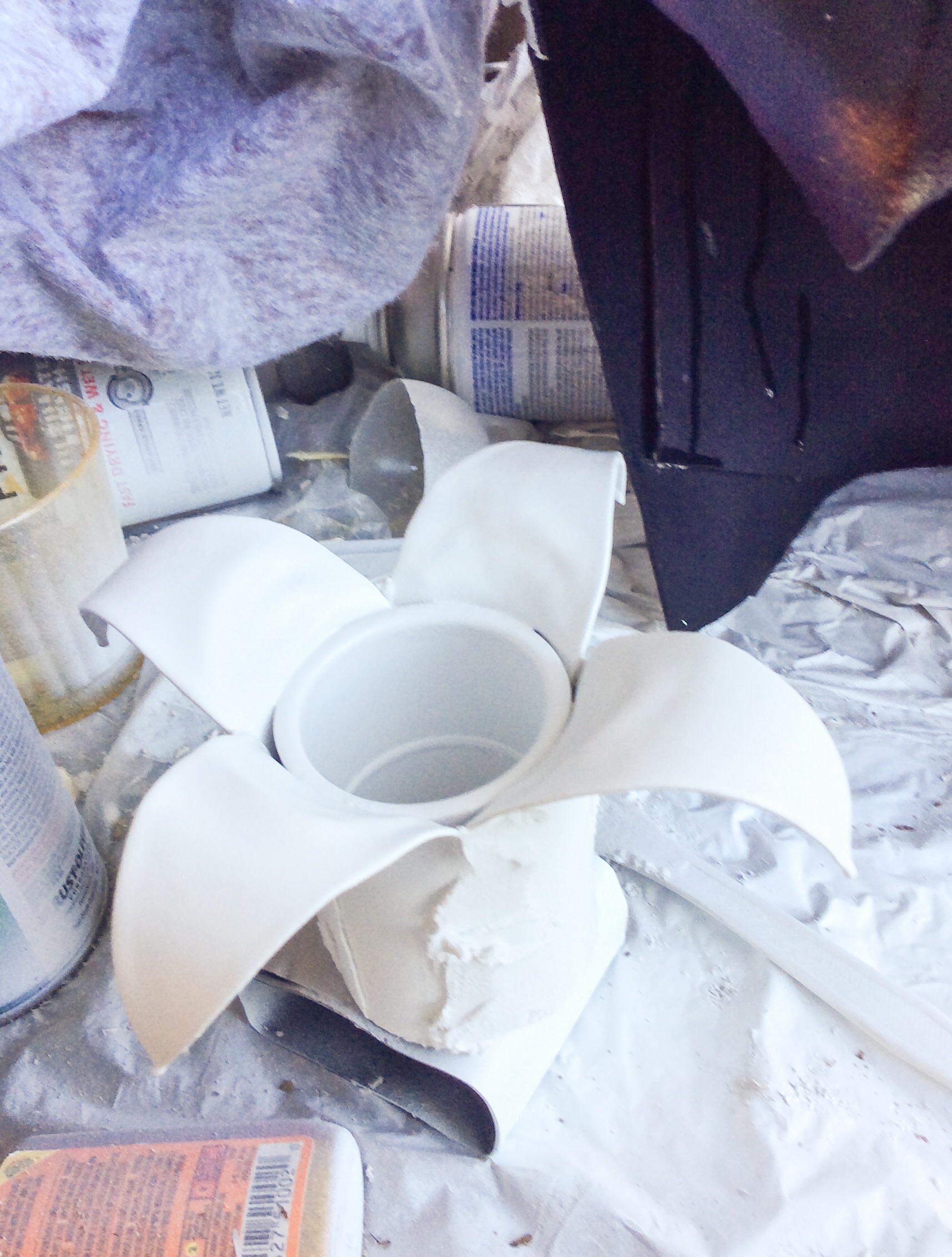

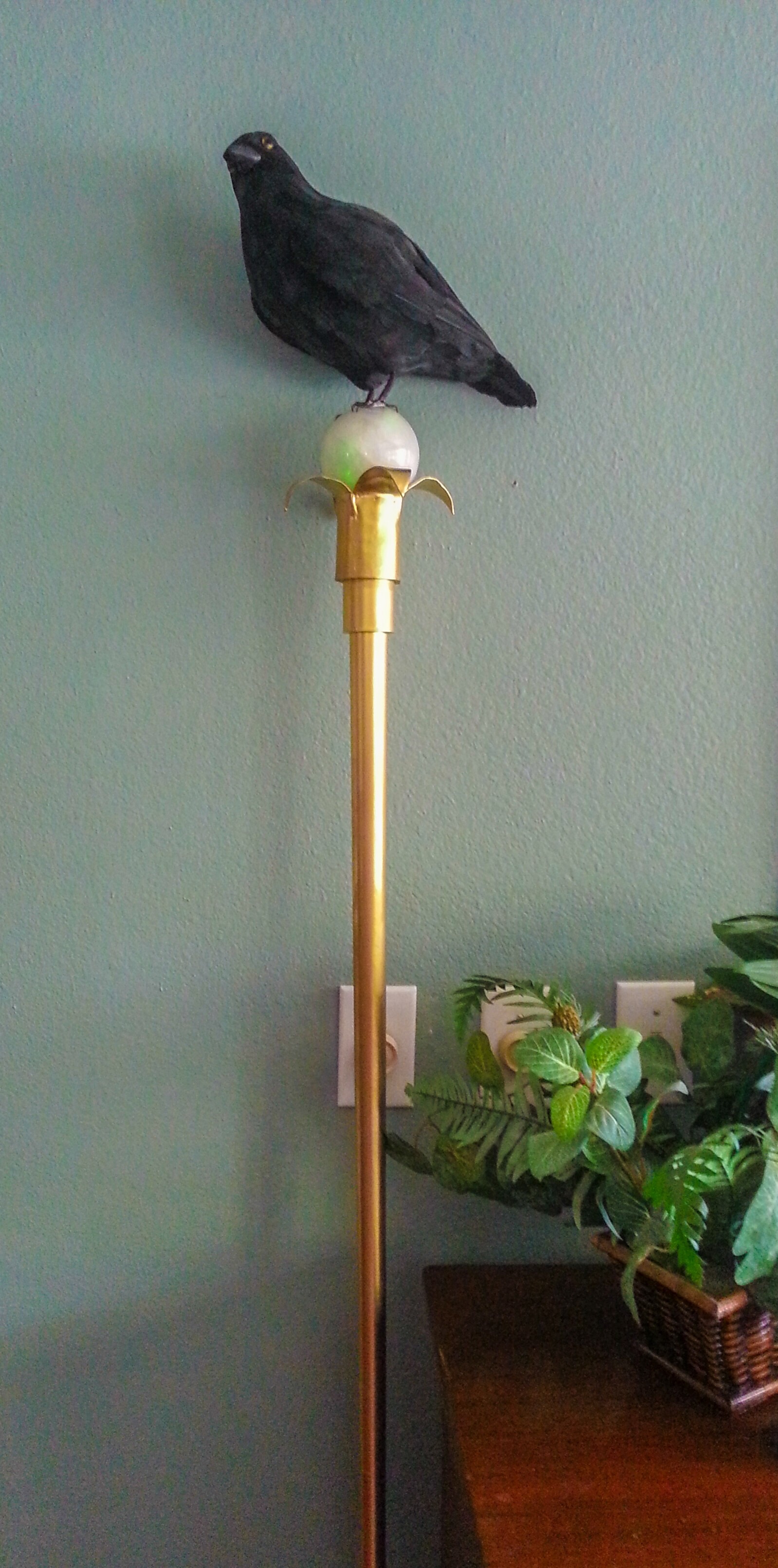

For the head of the staff, I cut 4 leaf shapes from my thermoplastic, and curved them around the PVC connector that I was using for the base. With the leaves attached, I then curved them out, using a space orb as a guide. Then it was on to the priming. So. Much. Priming.
I settled on using filler primer after my standard primer wasn't going to hide the plastic's texture. Once the primer was ssanded smooth, I spray painted the headpiece gold to match the body of the staff. With the paint drying, I opened up the orb and attached some magnets to the top of it and the bottom of Diablo's feet so he can sit on top of my staff.
I'm pretty happy with the result, even though it's a little bit too tall.
