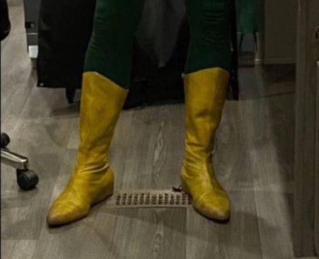

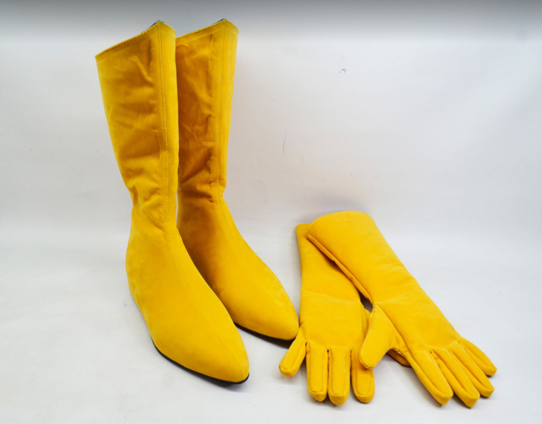

  • Boots - being done by Studio Boheme in a faux suede. Different than the leather(ish) boots in the episode, but same appearance.

  • Gloves - Also being done by Studio Boheme in the same faux suede as boots.

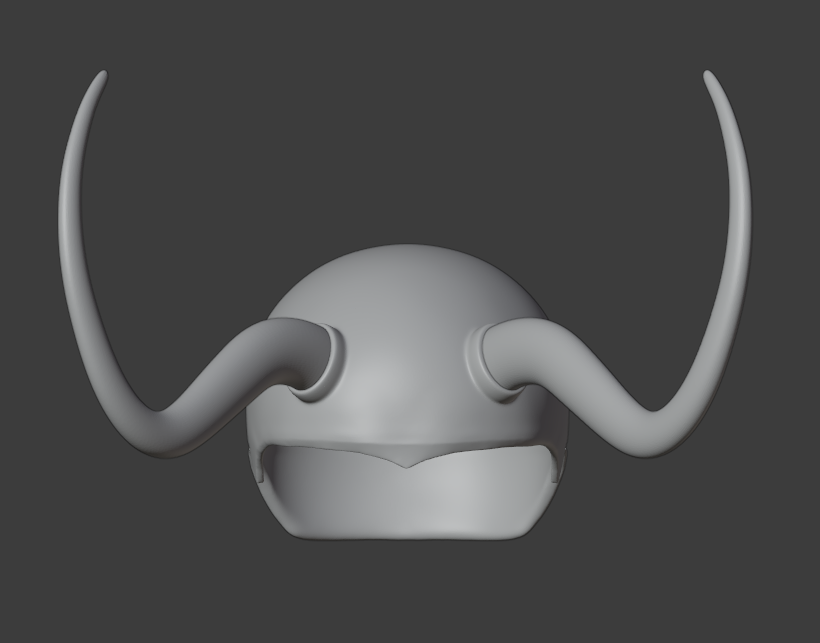

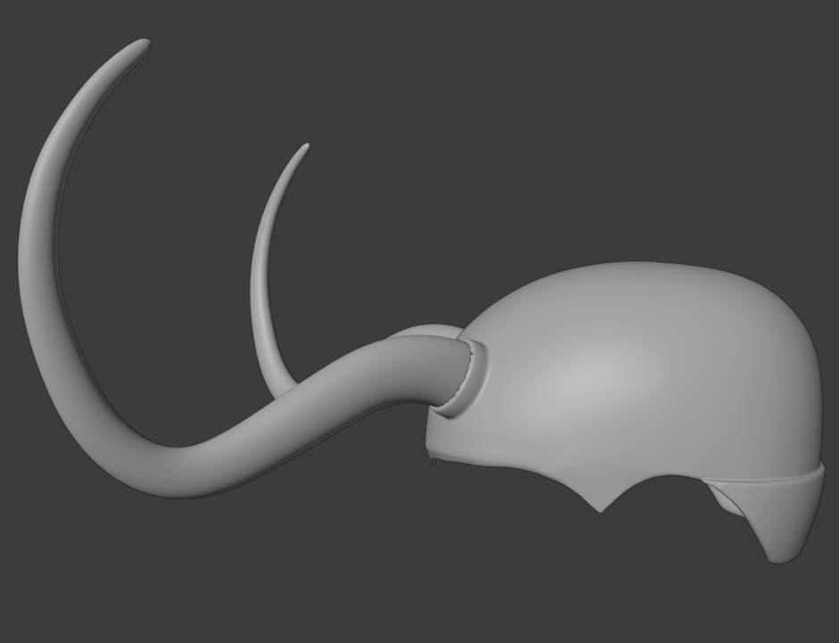

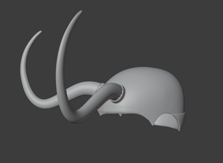

  • Helmet - 3D printed and gold chromed using my model.

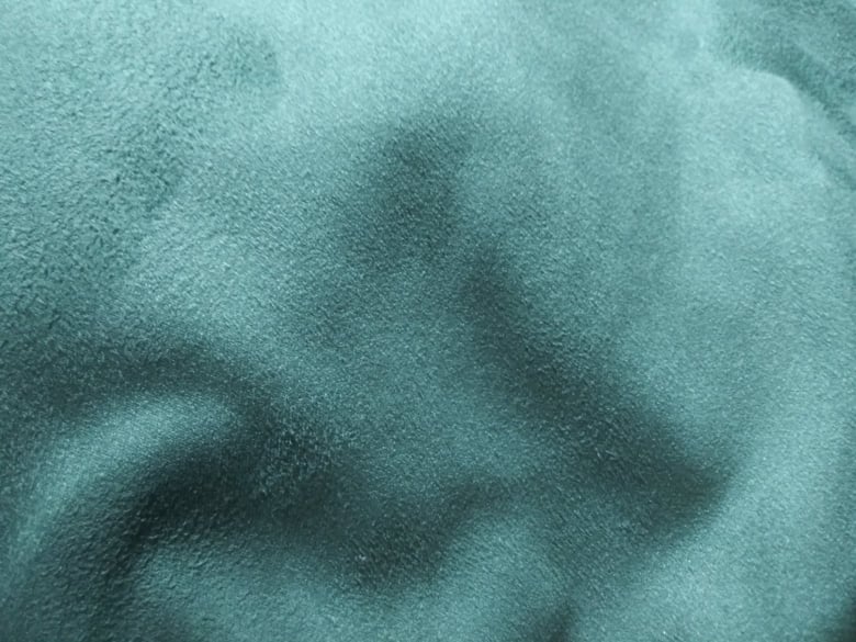

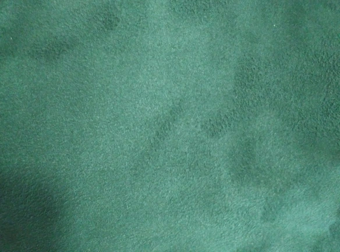

I decided on a fabric for the green body suit today - this is a stretch faux suede from JoAnn's in "Sycamor" color. It's hard to capture the color in the light with a crappy cell cam, but it is fairly close to the color in the screen grabs, maybe just a tad darker and definitely more green than the image below.

  • I'm not going to go for 100% screen accuracy. The costume in the show is a bit of a hot mess. There are three different fabrics being used - the suit and gloves are zentai, the hood and cape are a lighter fabric of some kind and the rest is a leather material. The chest piece just tucks into the belt and isn't mounted on the body suit at all. The cape and collar are all over the place in the episode because they aren't tacked/mounted. Because of this, I'm going to only use faux suede for the costume and give classic Loki a proper sense of style and uniformity and make sure the pieces of the costume don't just fly about freely.
  • I'm working with Studio Boheme to replicate the boots and gloves in a yellow faux suede. I'm going to pad the cuff of the gloves so they aren't skin tight.

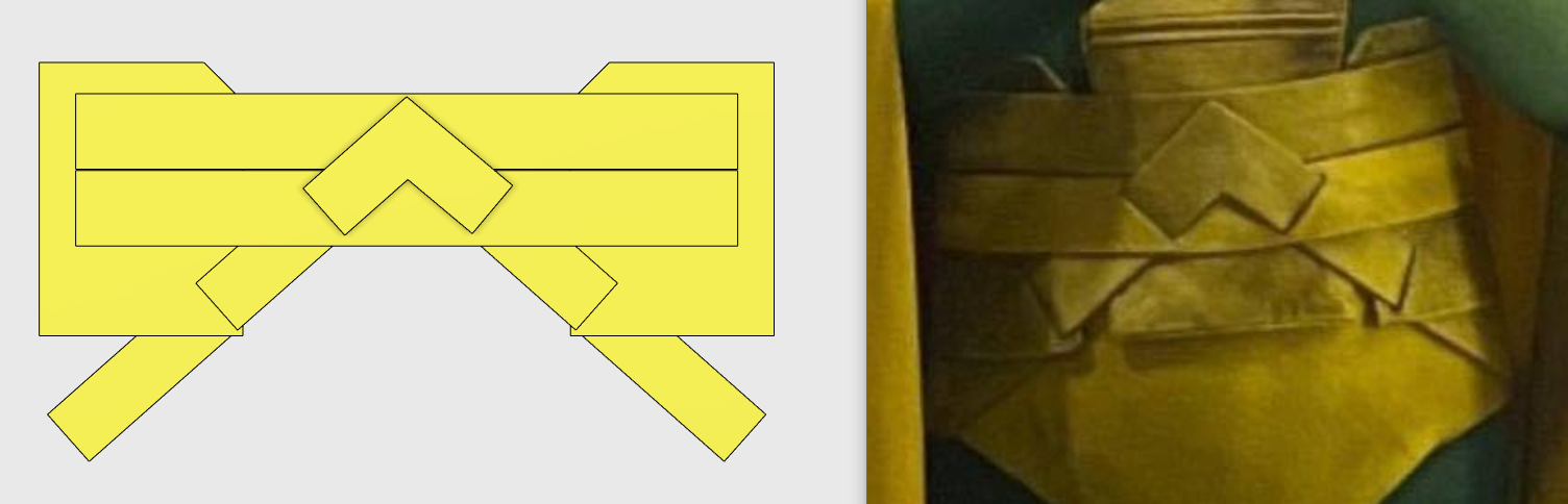

The helmet is printing on the printer right now and I have begun to 3D model the other pieces and will convert them into a 2D pattern I can use. Here's the belt with a side by side comparison of Richard E Grant's selfie:

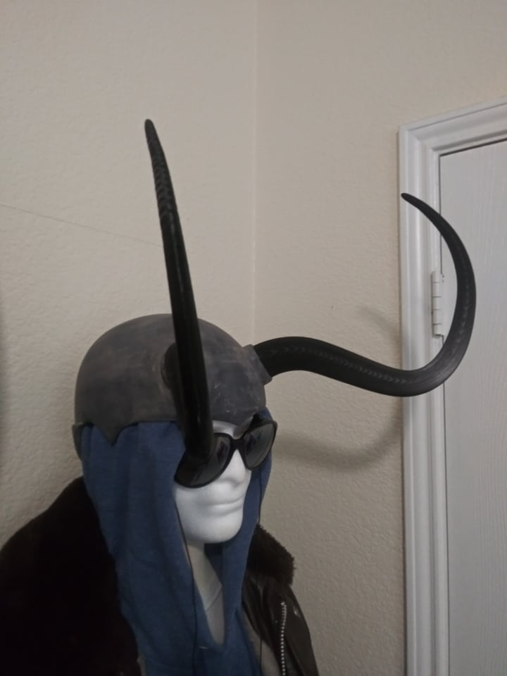

Helmet is printed and scaled right the first time! Need to reprint one of the horns because of some funky banding but then it's off to clean up.

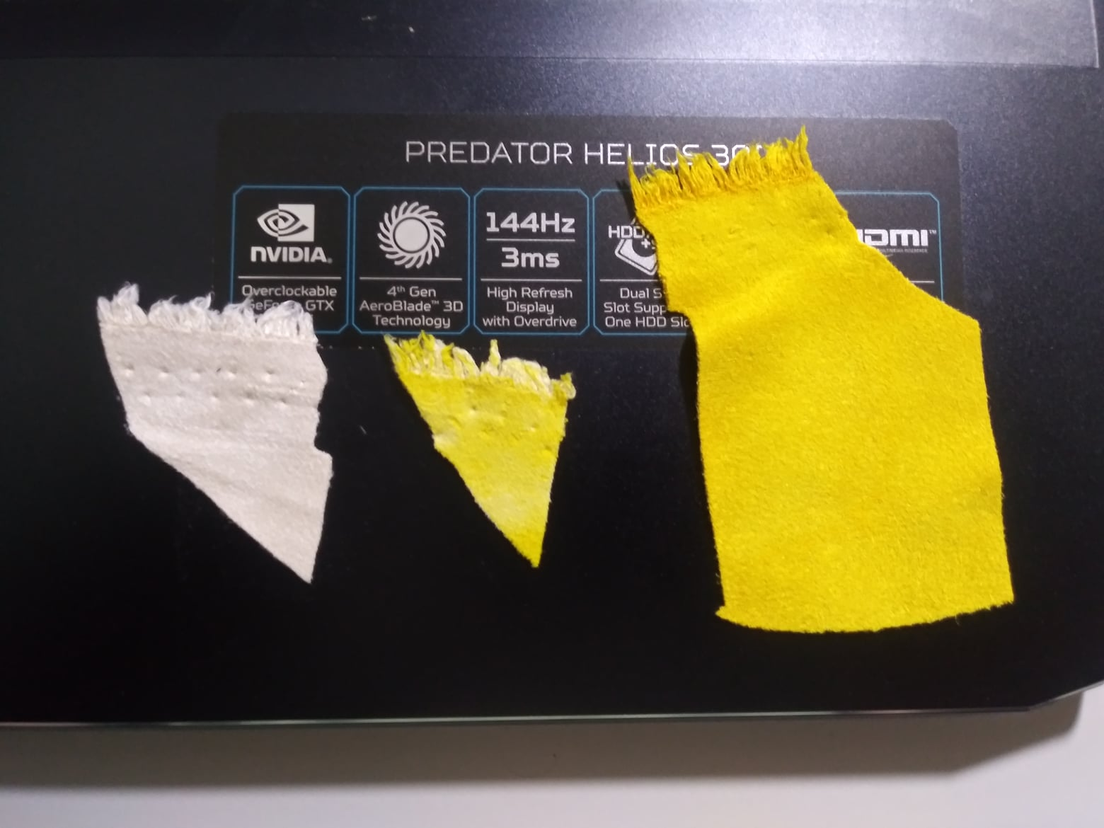

Finding a good quality yellow, stretch, faux suede has been extremely difficult so I decided to take a chance with a white stretch suede and dye it. These are synthetics, so dying can be difficult. I decided to test two products: Dye Na Flow (sun yellow) and Rit Dye More Synthetic Fiber Dye (daffodil yellow).
These are two different approaches to dying. The Dye Na Flow is actually a very thinned down, heavily pigmented paint. The Rit dye is an actual dye.
To apply the Dye Na Flow I airbrushed it on to the fabric until it was covered and then let it dry. It covers the fabric, but even after dried, I could see faint traces of it rubbing off on a white sheet of paper. The directions say it can be set using an iron on the opposite side of the painted fabric. I did not heat set this in my testing.
The Rit dye is done with the same method as their other dyes: put the fabric in hot water on the stove and add the appropriate amount of dye. The swatch was rinsed and washed.
Here are the results of the two pieces I tested. The fabric is a 90% polyester and 10% spandex blend. The original color is on the left, the Dye Na Flow in the middle and the Rit on the right. The choice is pretty obvious here: the Rit dye is much richer and saturated with no color coming off. The only issue I see with the Rit is that the color is not 100% consistent throughout. This won't be a big issue with this particular fabric since it is supposed to mimic suede, and leathers aren't always consistent in color, but other synthetics may be problematic. Also, this may not be an issue when using the proper amount of water and dye per the instructions. I just winged it with a little bit of water and dye for the small swatch.
