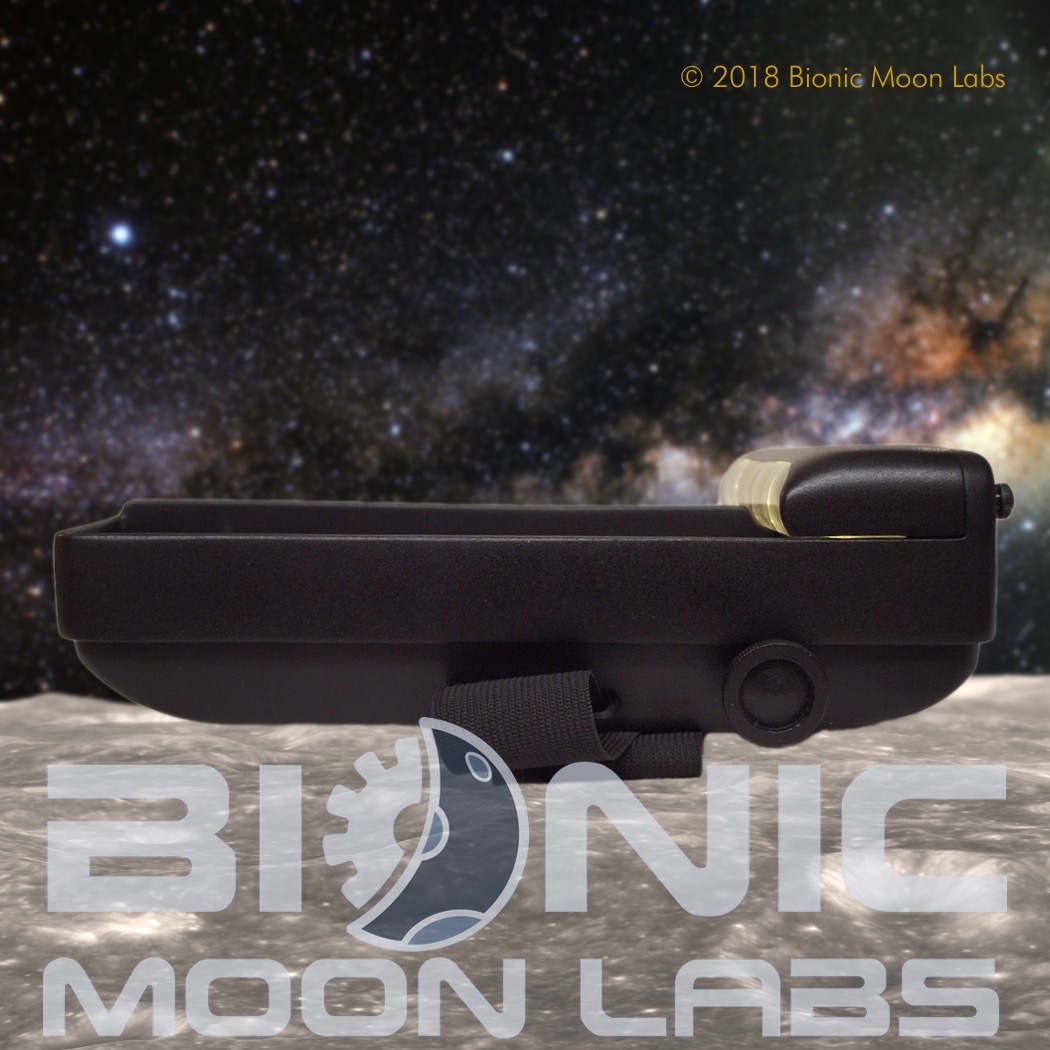

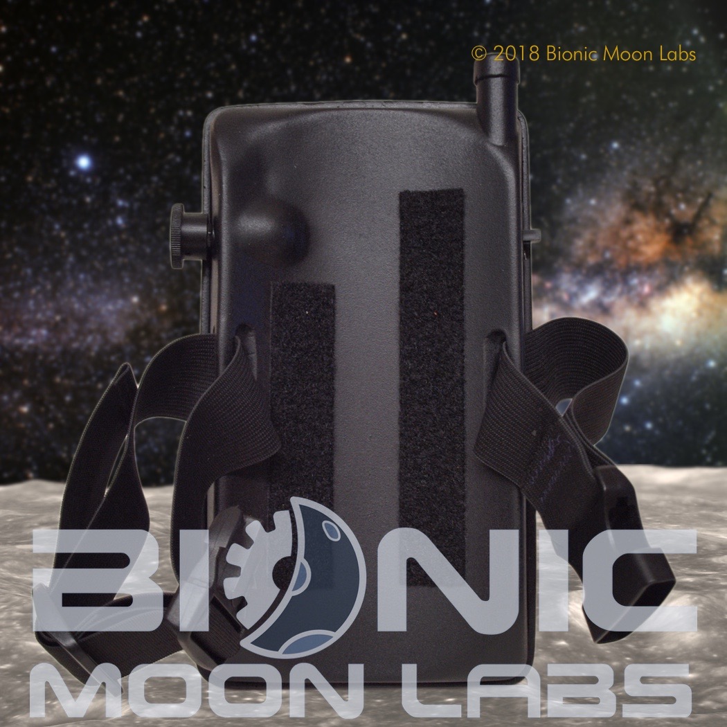

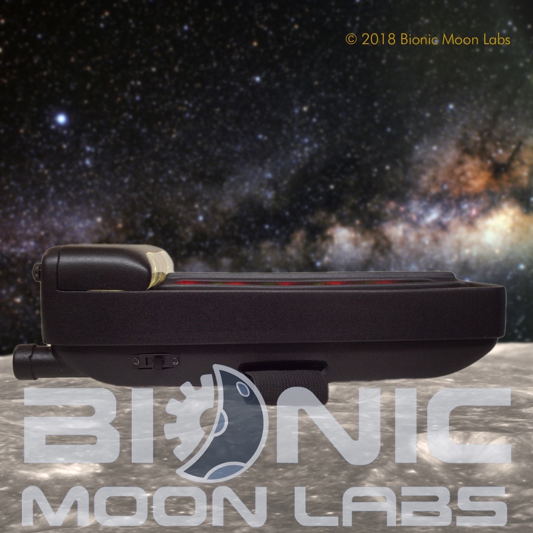

I decided to create an idealized version of this prop. Acquiring vintage kneeboards is bothersome and the price fluctuates quite a bit. Also feel a modified design would create a more streamlined and otherworldly look. Perhaps something that the production might have done with time and resources to further obscure the origin of this prop.
Using screen caps, I stared with the basic shape sized to fit my kneeboard base and hold two vintage calculators....

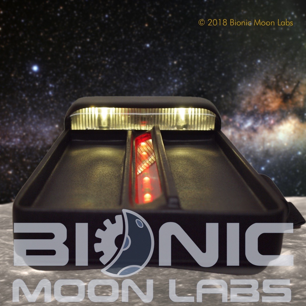

The blinky lights in the middle sit underneath a clear sheet which, from the screen caps, seems to be angled so I made sure to include that element. The map light lens is from my authentic kneeboard, stripped of paint. I'll be molding and casting that in clear resin...
Using the base plate of my kneeboard. Had to do quite a bit of repair work here, filling holes, etc...

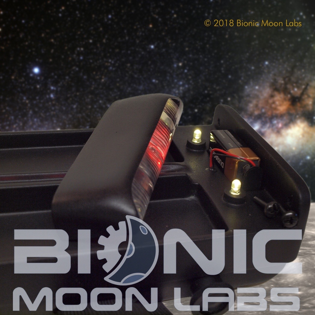

Design of the top tray finished and ready for molding. The clear lens will mount to the "L" and LEDs will be housed in the sockets. Also a battery compartment...

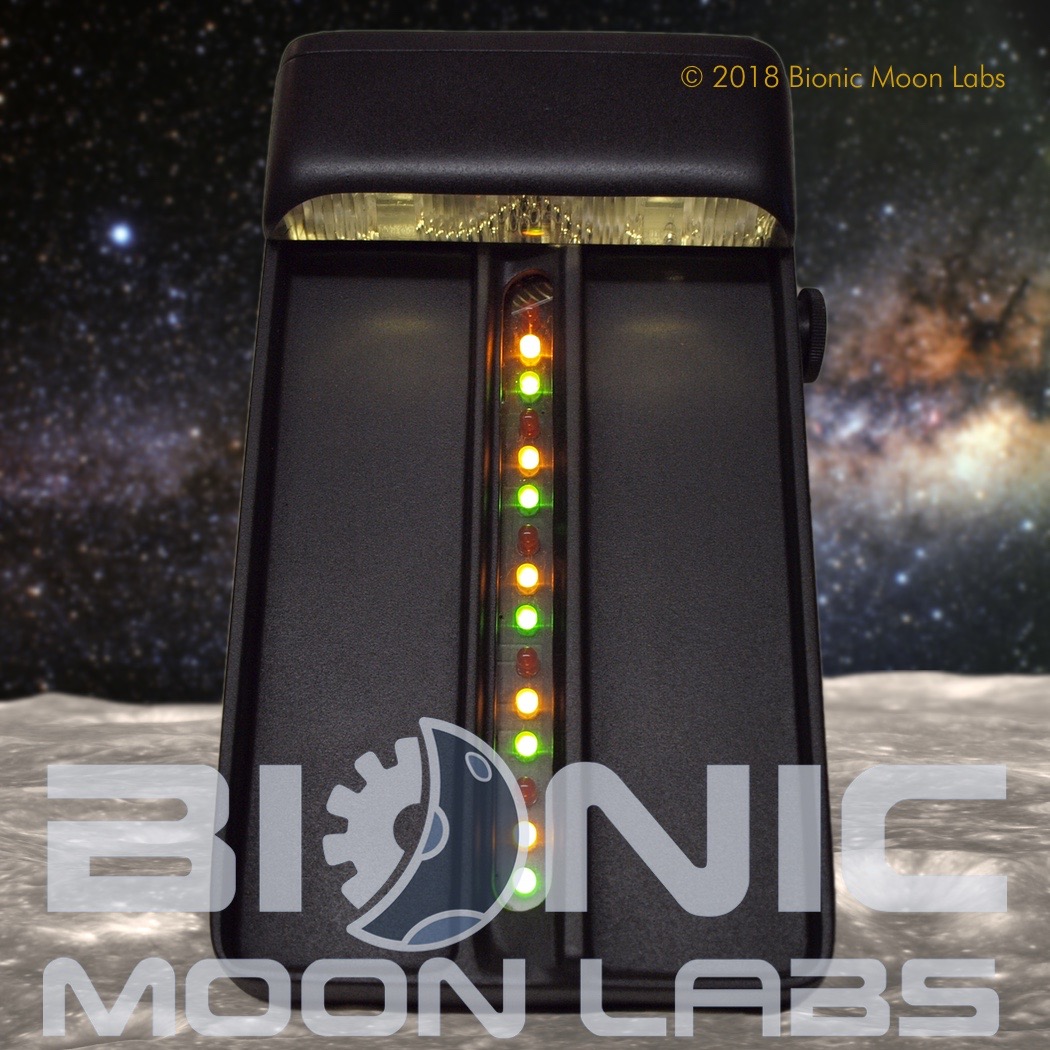

Time for the fun part. Building the electronic circuit. I did my best to sync the timing to that seen on the pilot episode, "Saga Of A Star World." A bit difficult given the original prop used grain-of-wheat bulbs that brighten-and-fade vs. the instant on-off of LEDs. After finalizing the design, sent off the Gerber file to the PCB house...

First cast of the top tray and test fit of an authentic EL-5804 and unfinished replica...
First prototype assembly with my authentic calculators. The original props used some form of metallic tape to cover the Sharp logo. I opted for a resin replica of the tape. I think it looks more substantial, perhaps like a heat sink or some other functional component...
