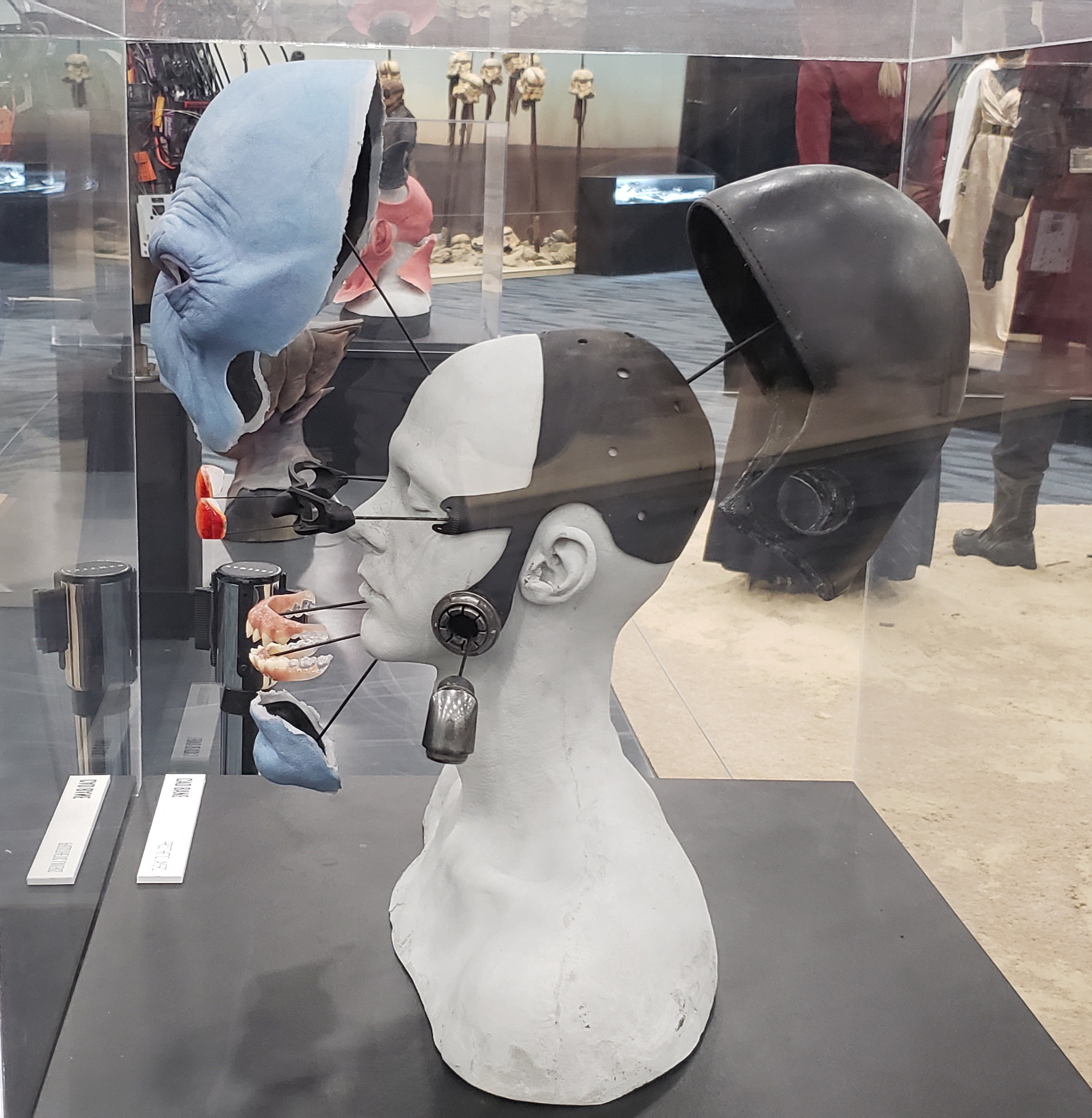

I looked through the aliens and decided on Cad Bane from Book of Boba Fett. There is great reference from Celebration and it allows me to do a complete face transformation. Bonus is my partner/model for the assignment is a huge Star Wars fan himself and couldn’t wait to walk around as Cad.

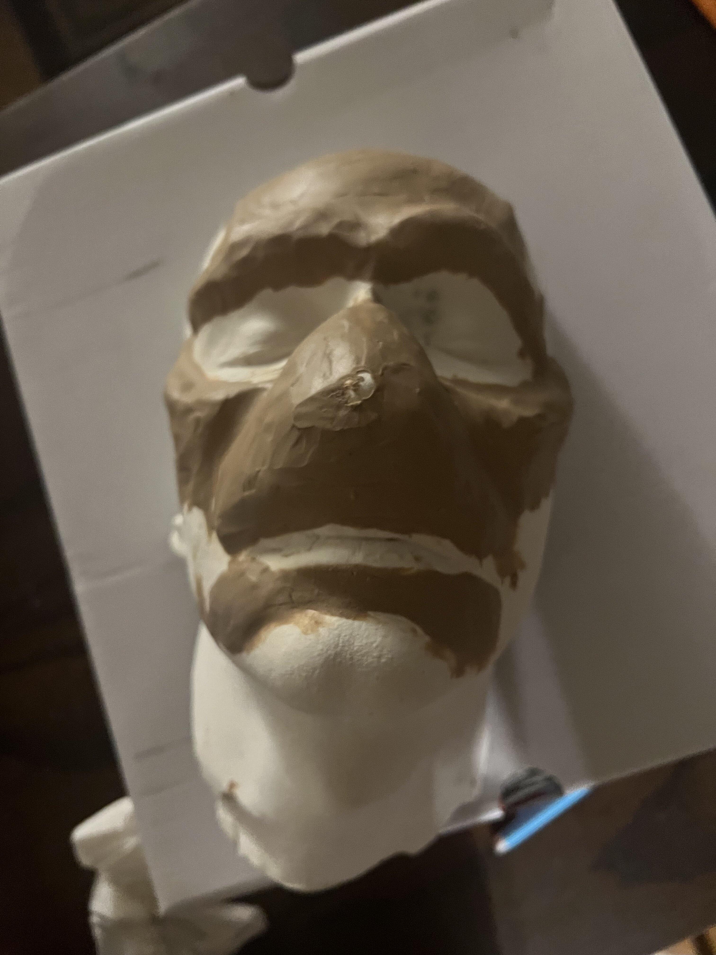

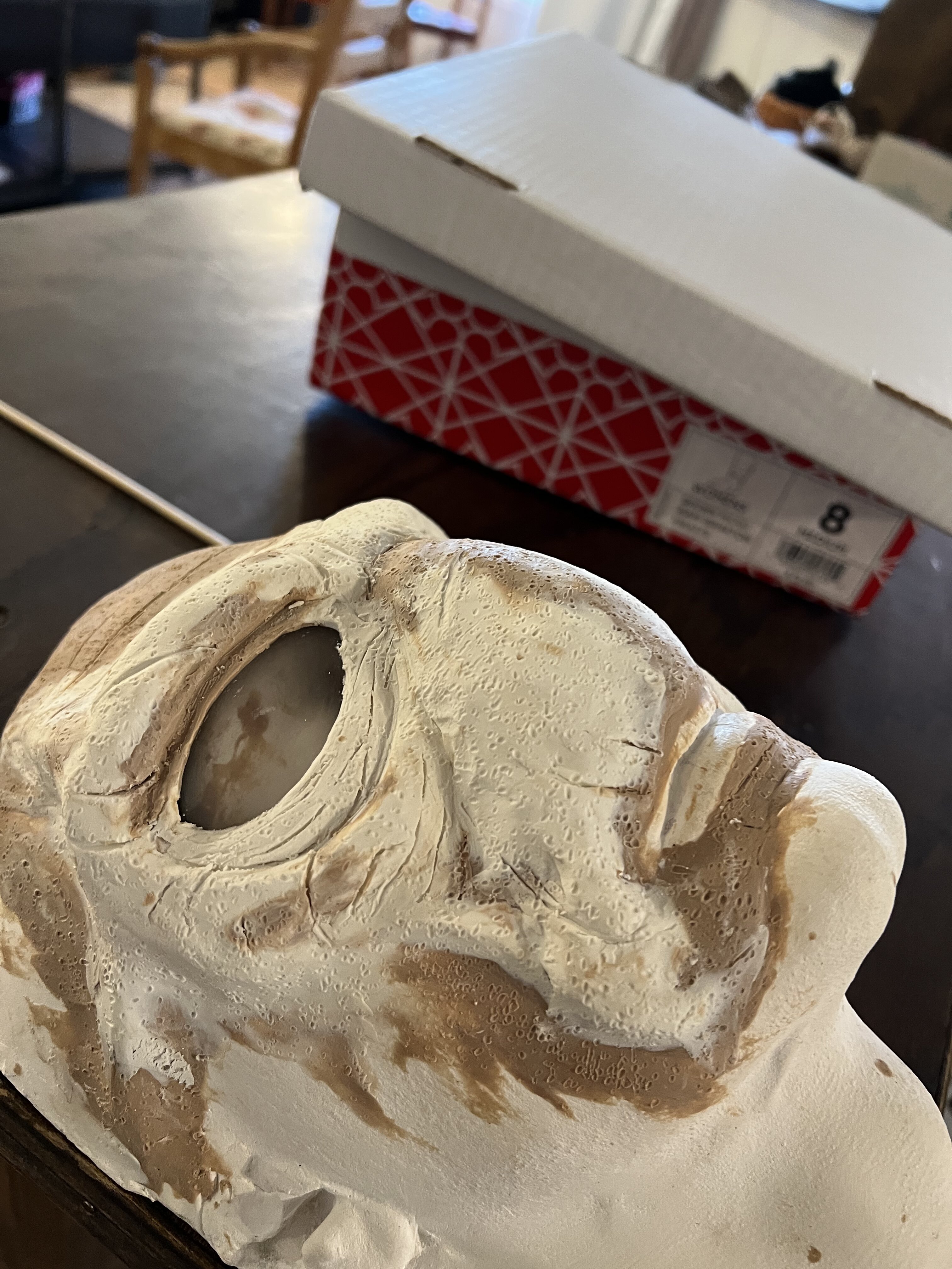

Jump to the next week, my mold of my partners face was pretty intact, a lot of noses were broke but mine survived, thankfully. Also because I was too excited to start on my sculpt I didn’t take a bare faced picture. As this build goes on, I do get better at documenting the process, promise.
The clay we used for the sculpt is plastecine/plastilina.

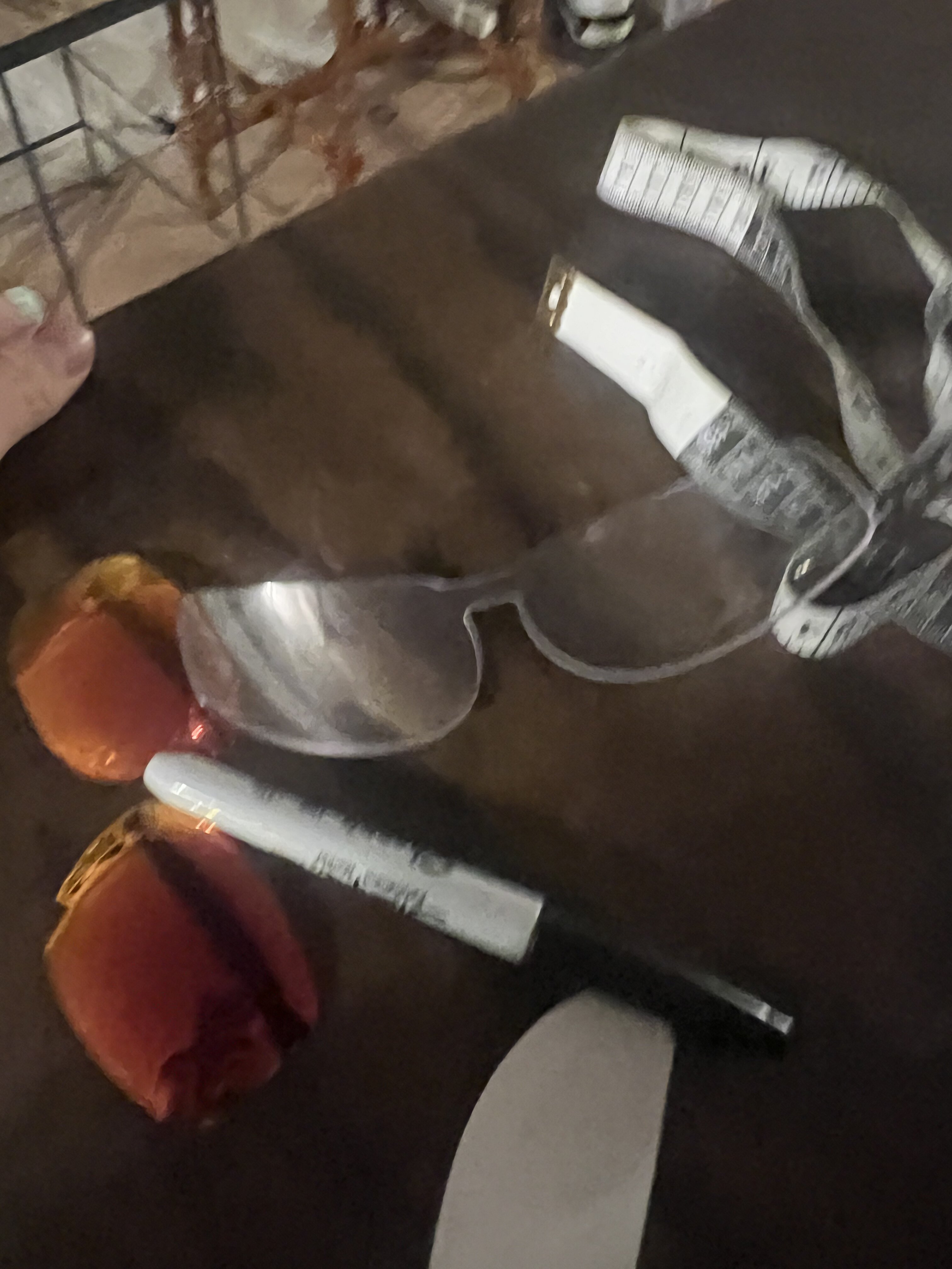

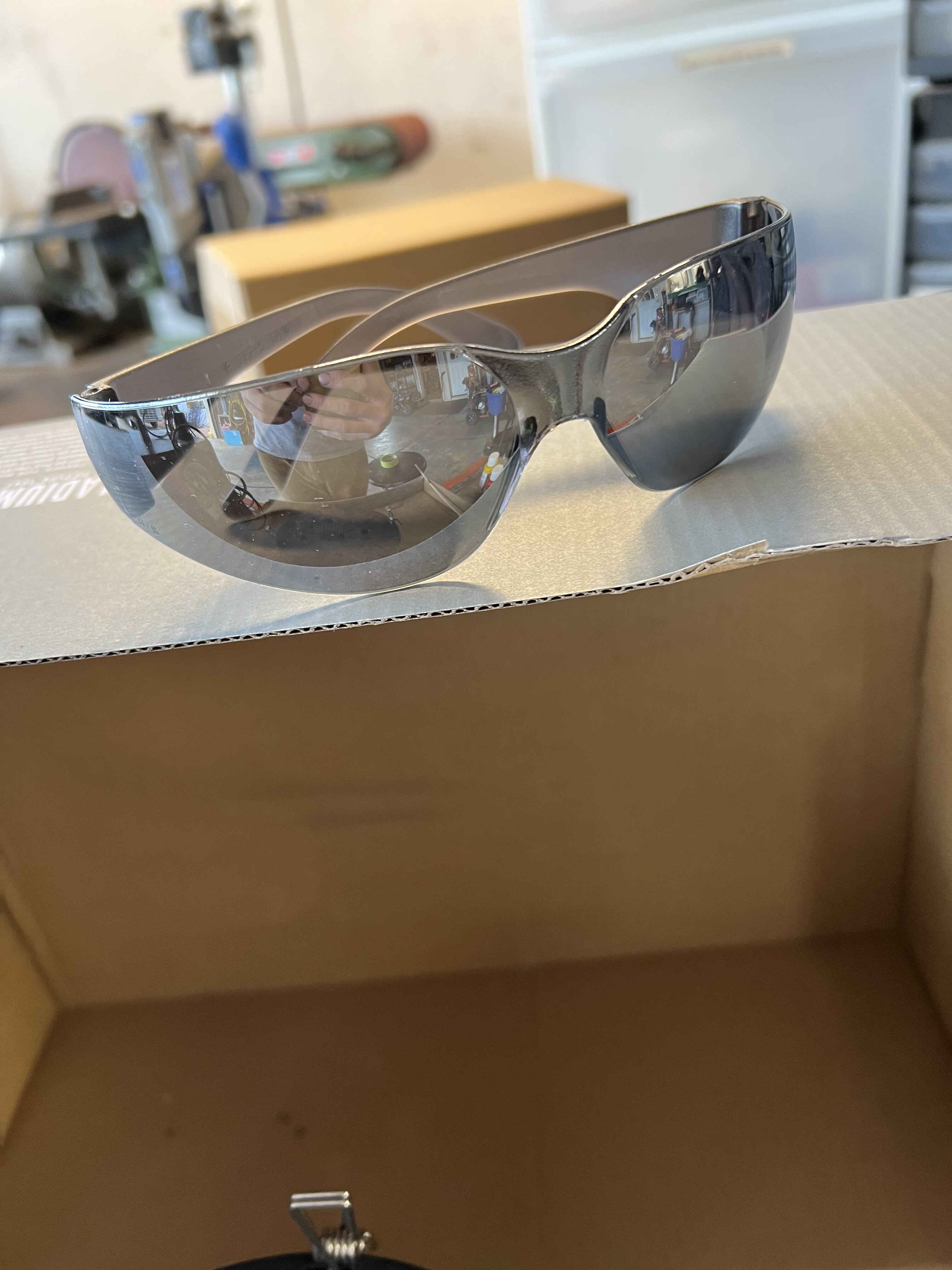

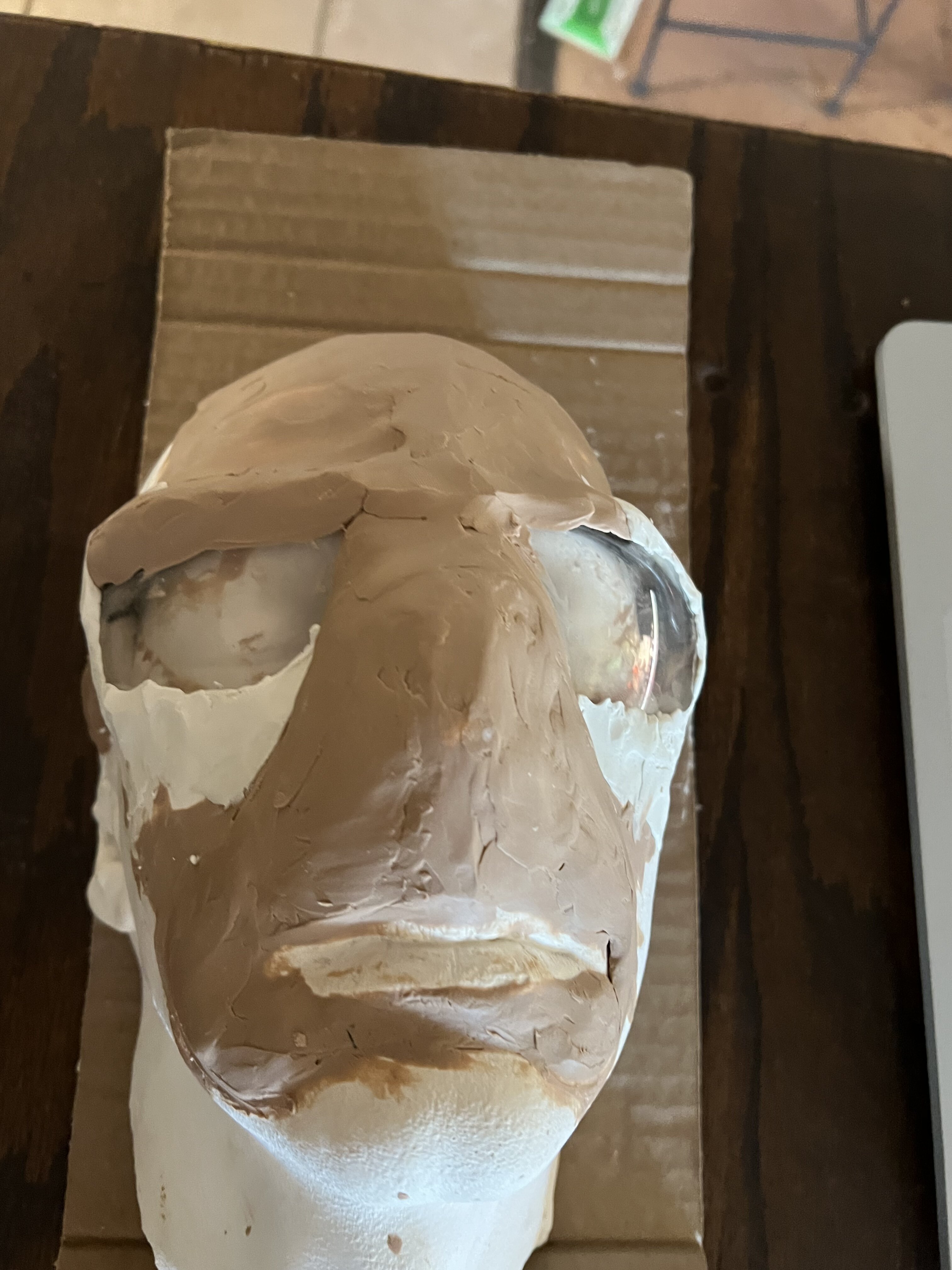

I had bought some red mirror sunglasses to do a similar rigging to how they did for BoBF, but after scaling my reference to my actors head, my lenses were a little smaller. They still would’ve worked but I think I came up with a better solution than even Disney, but we’ll get to that later.
Some background, I’m a great procrastinator. My best work is down the day before, so I needed to have this sculpt down and ready 10 hours before my I picked up where I left off. So all these upcoming photos were right before class, for which I was 2 hours late on a 4 hour class, but once I arrived to class, all was forgiven.

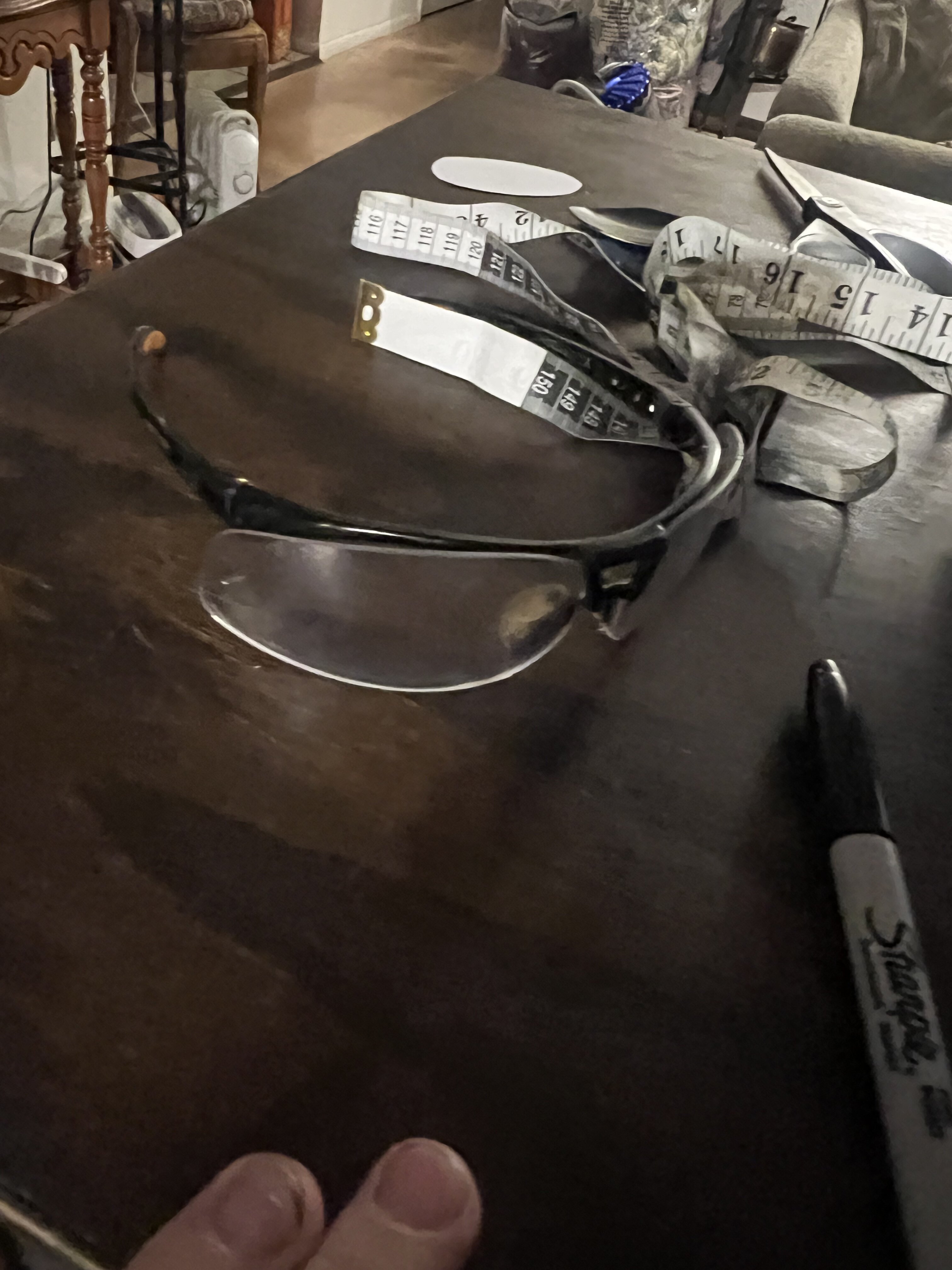

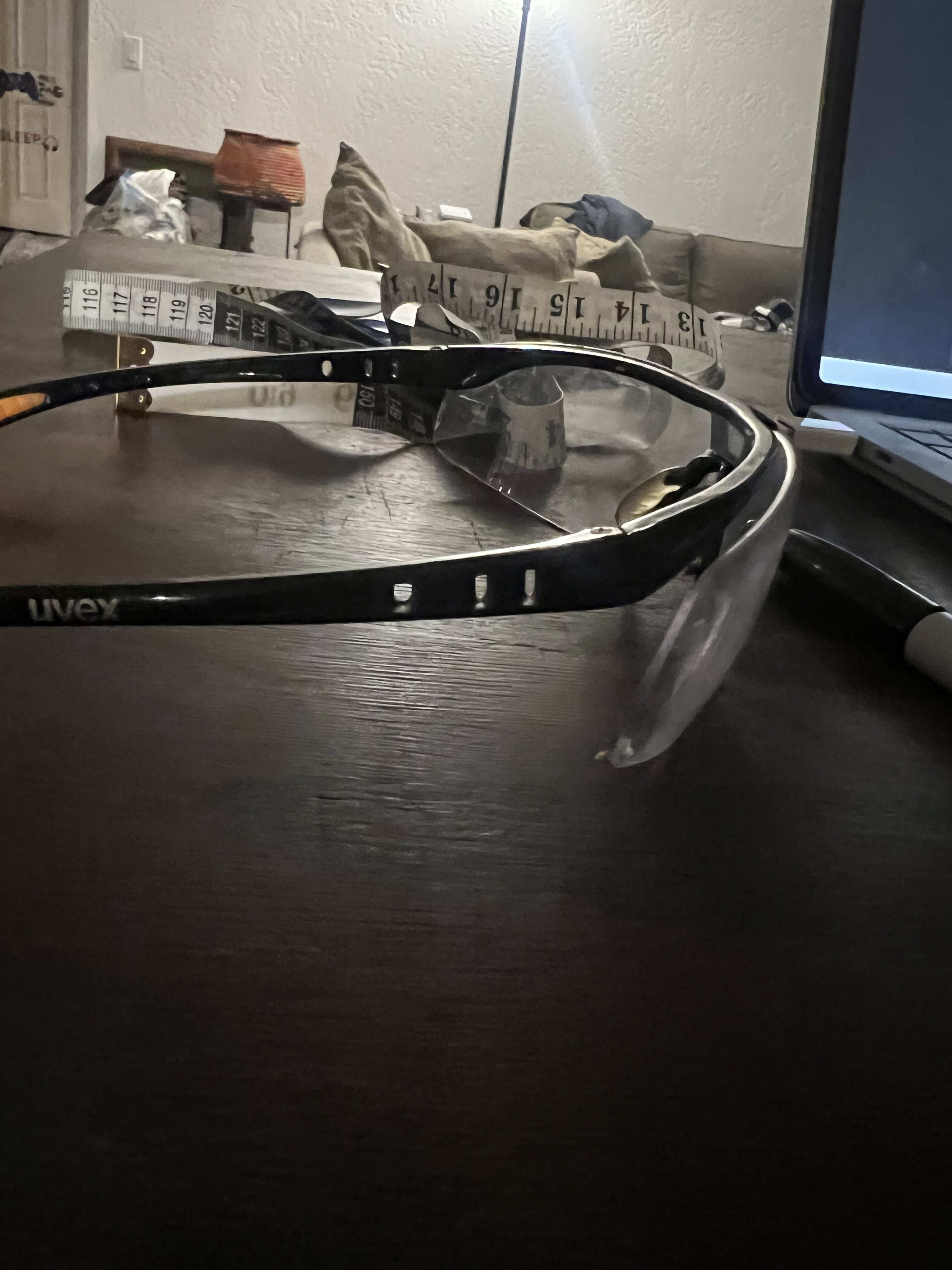

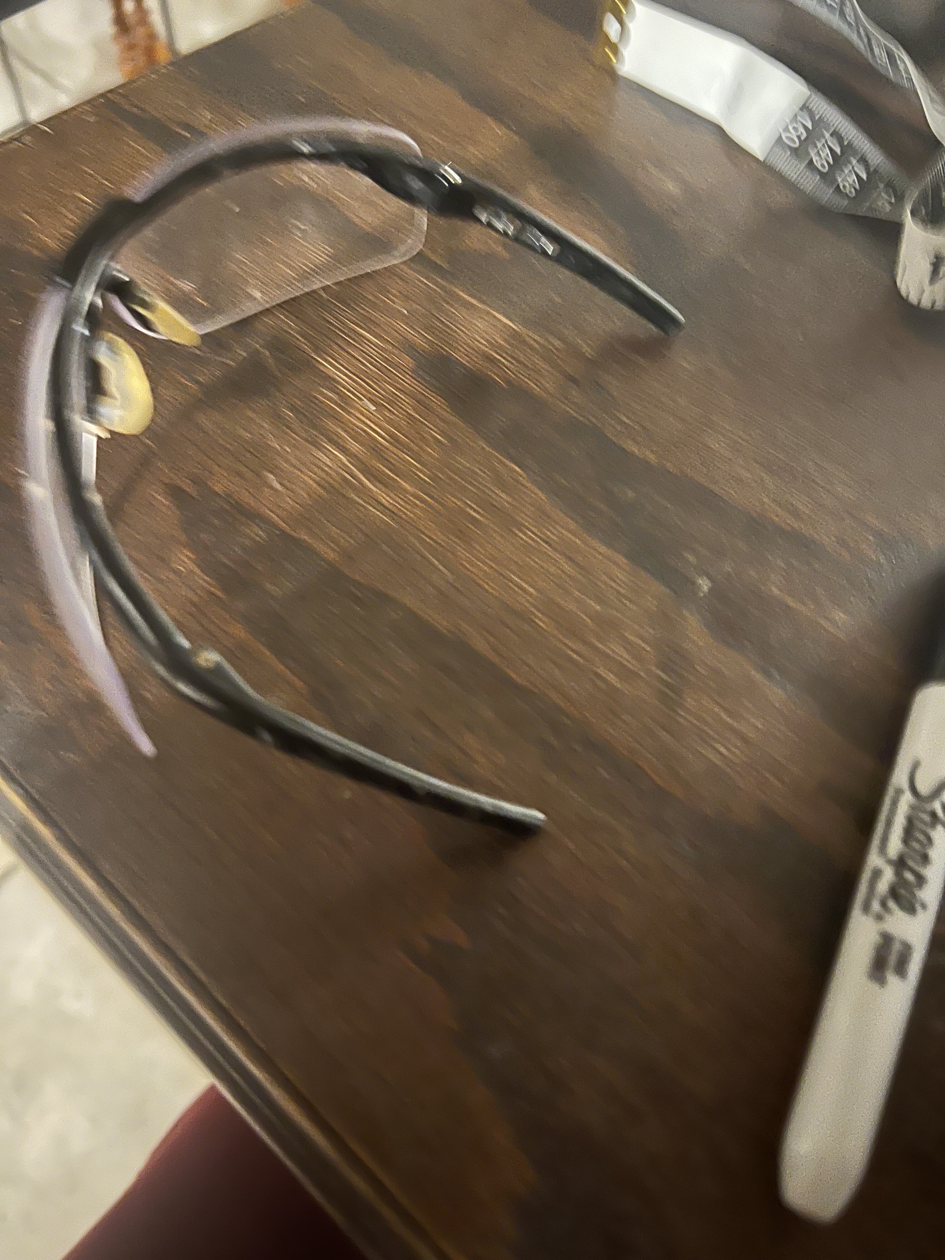

My glasses seemed too small so I grabbed the closest thing in arms reach that would work as a substitute at least for the sculpting aspect, which were safety glasses since they confirmed to the head much better that any other glasses and the lens were pretty close the the Disney made ones. Better lenses will be acquired/made after this step.
Because I only have a half head cast, I decided to clip the arms short on the safety glasses so the sculpt could still lay flat while sculpting and when I get to the mold making.

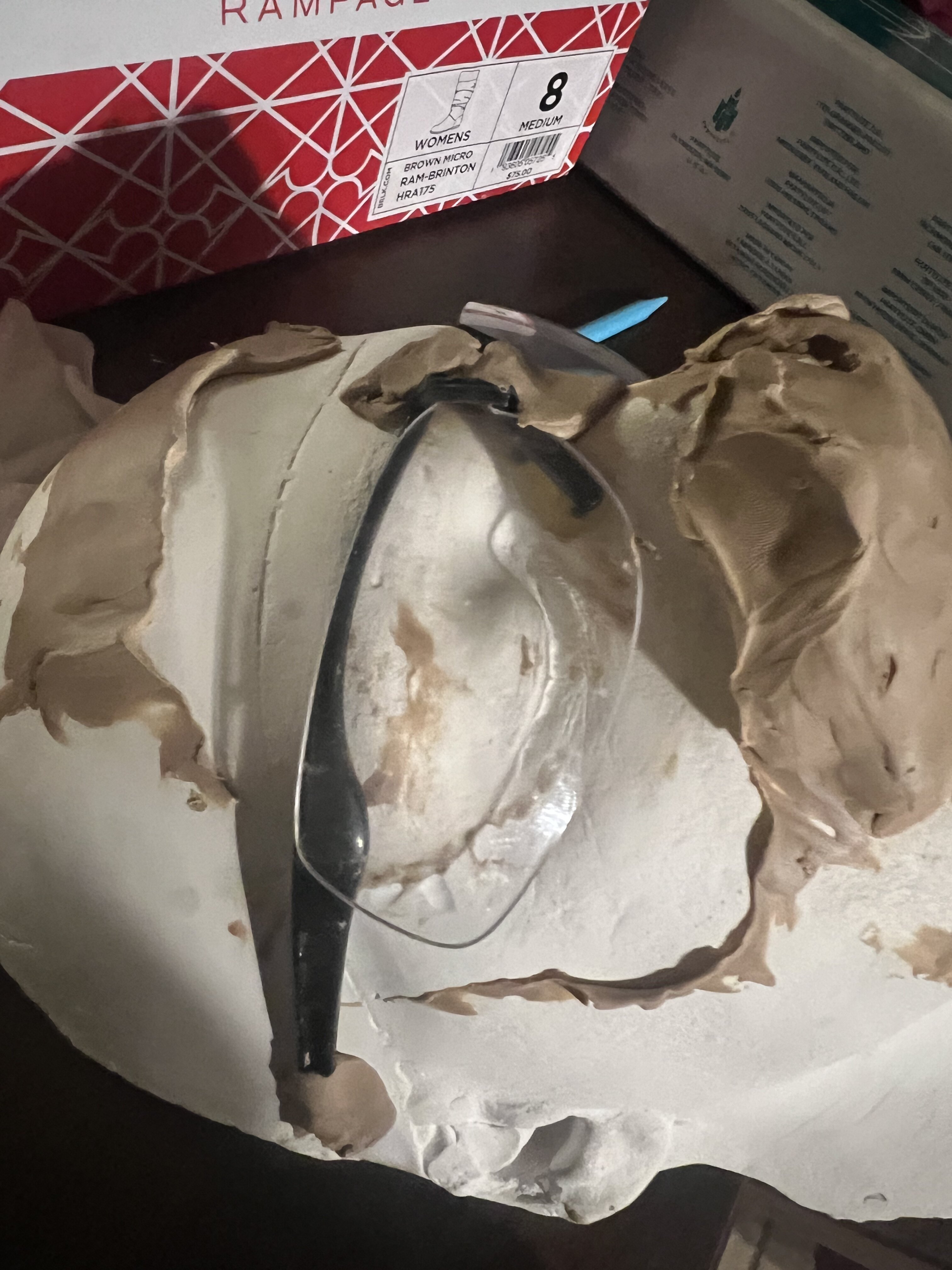

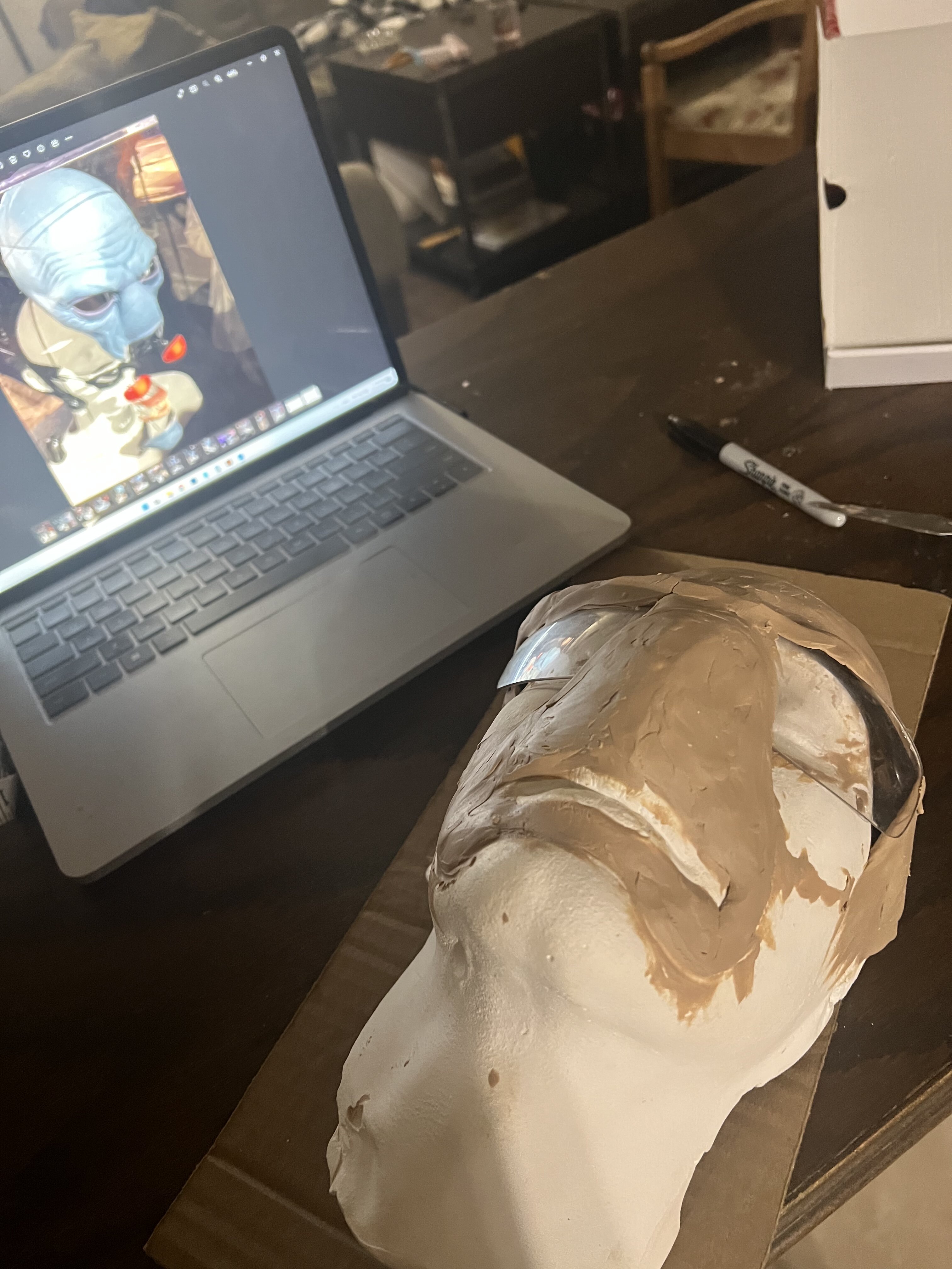

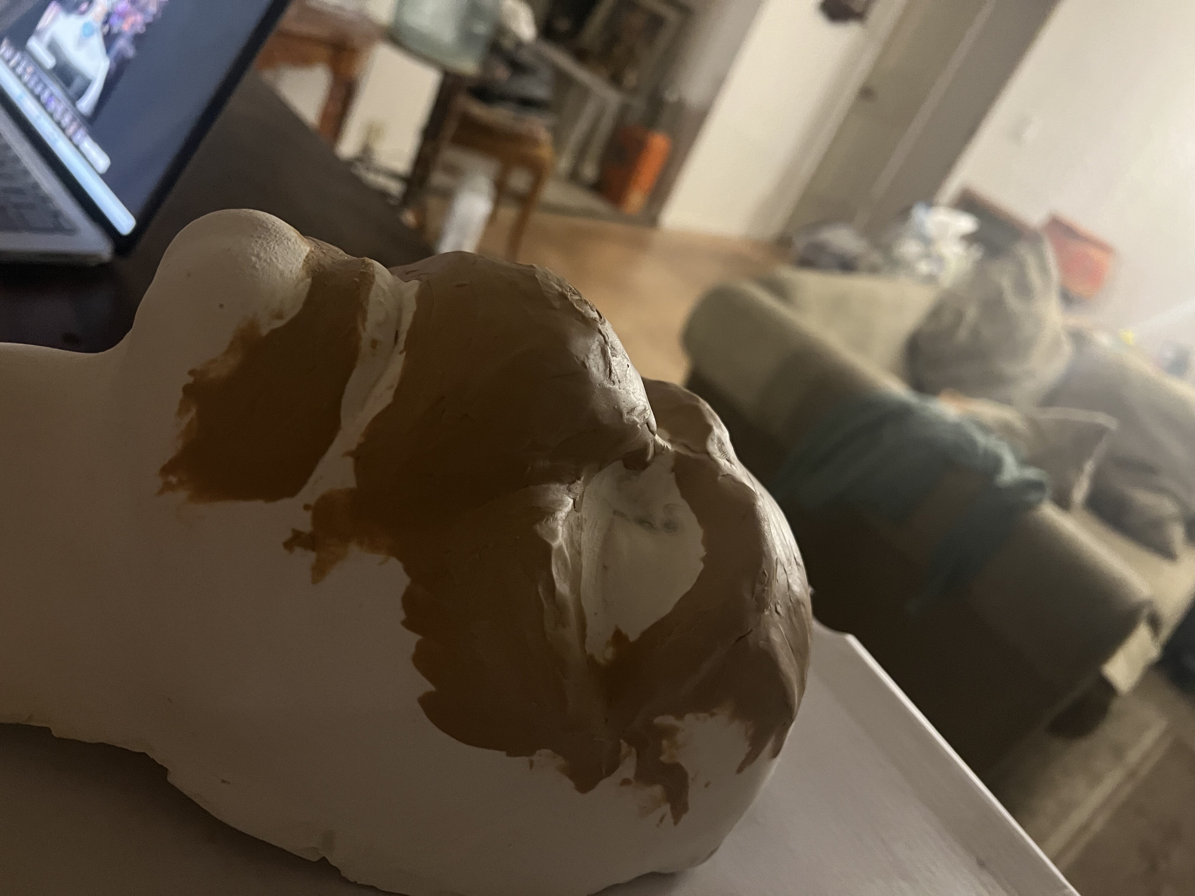

Unfortunately my initial modeling was mostly for not, as I hadn’t installed the glasses to model around I had to lift most of it off.

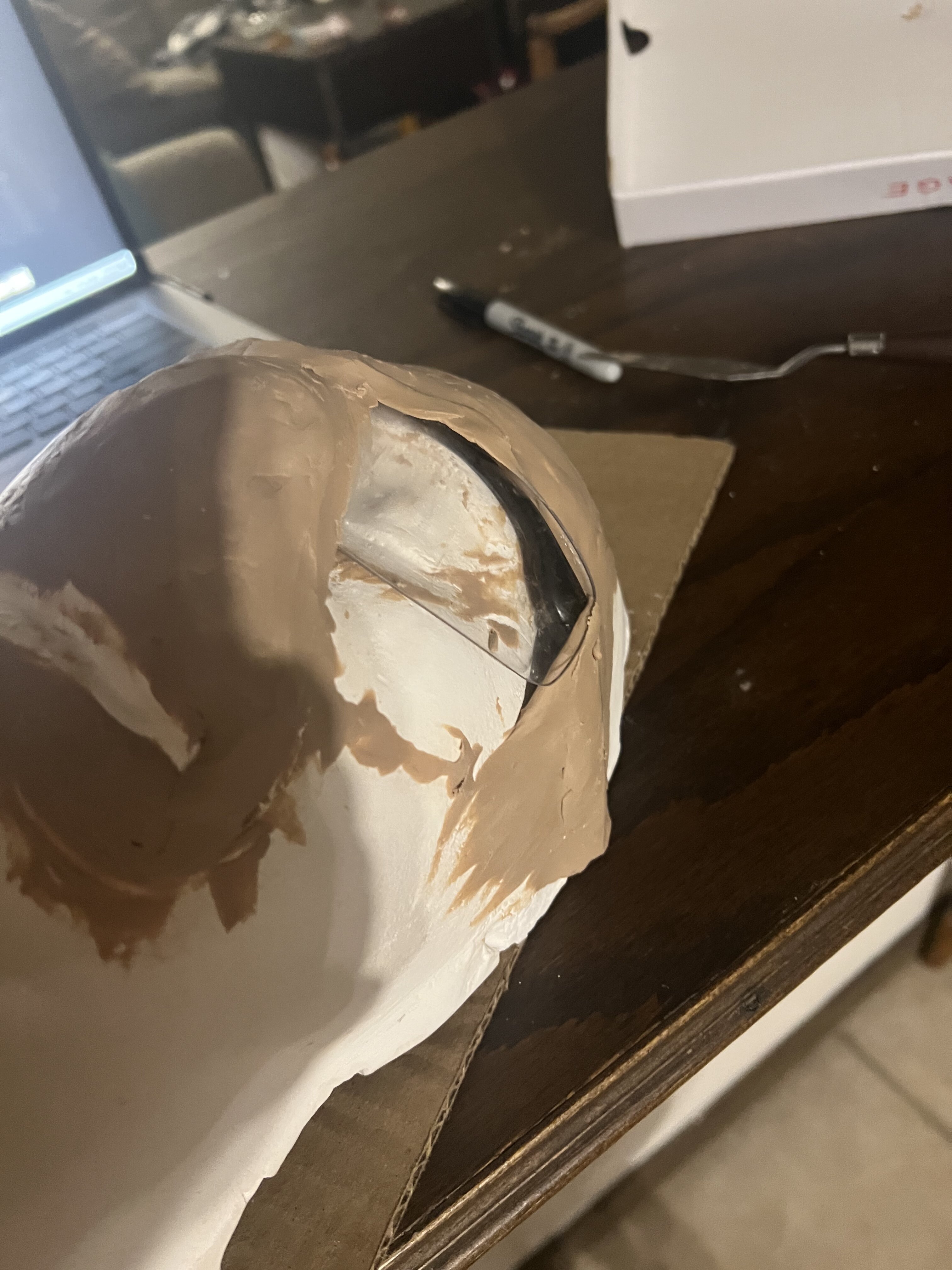

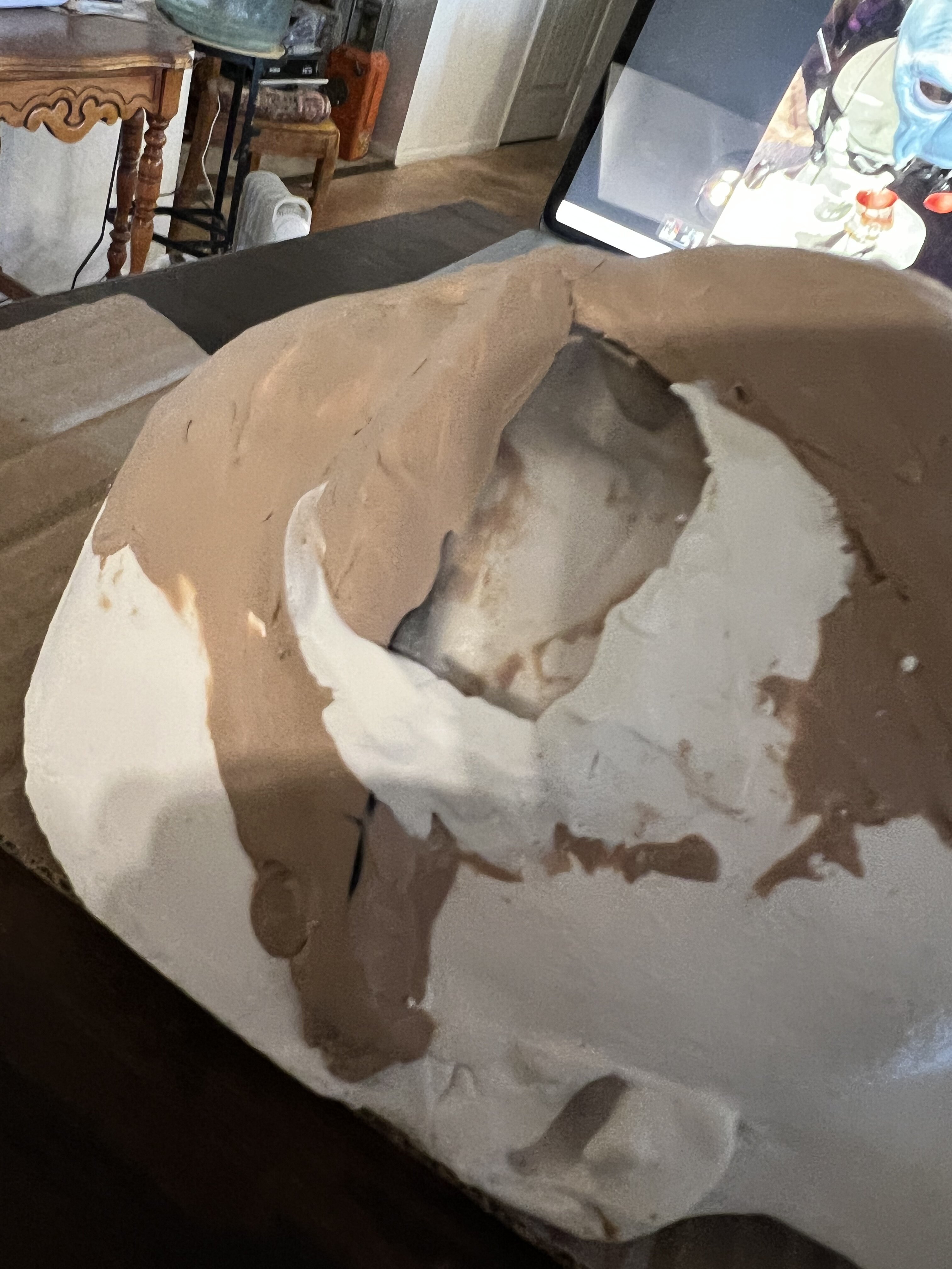

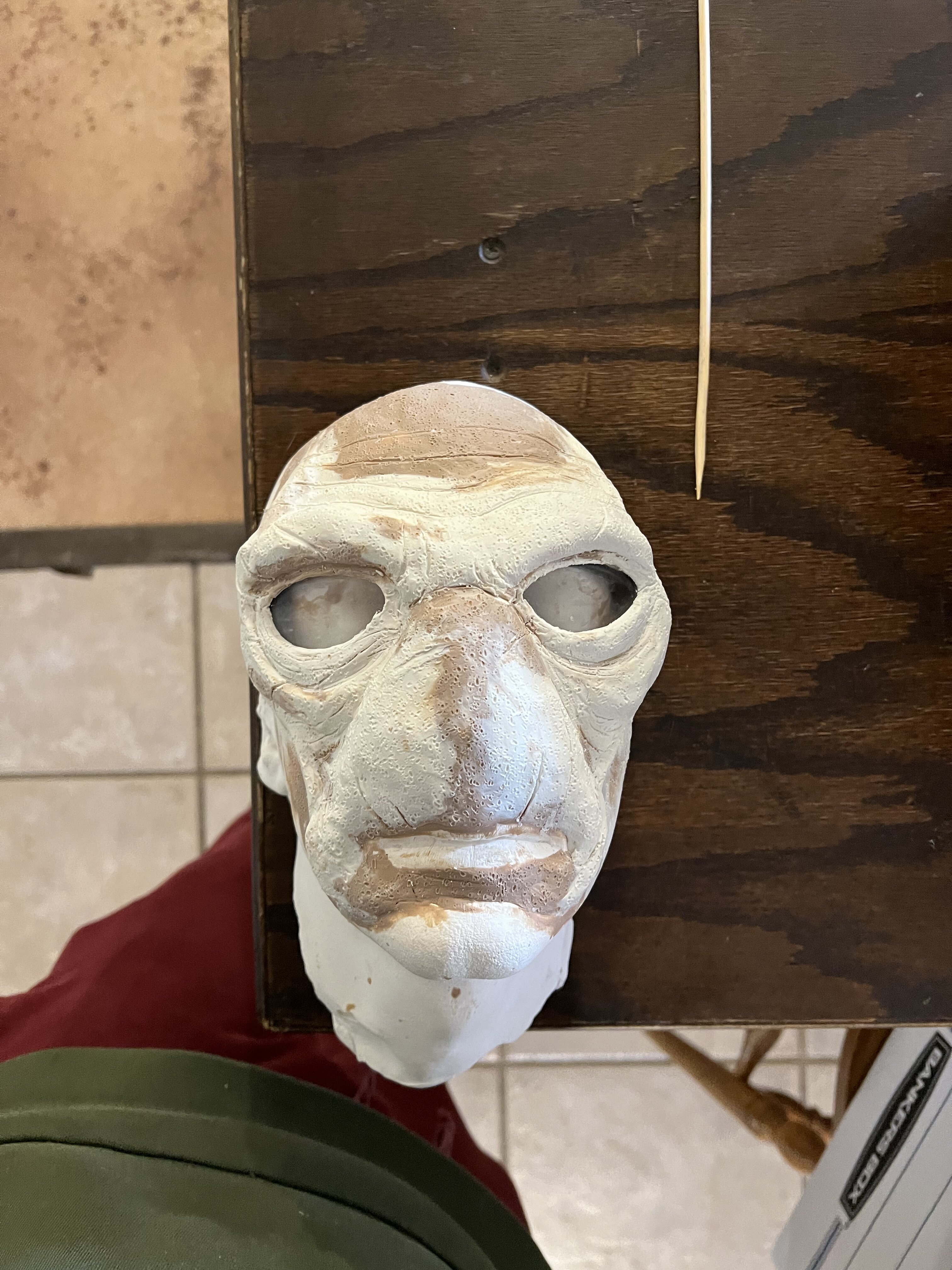

This is around 4am and my class is at 11am. Unfortunately I got this far and I didn’t grab enough clay from class to be even close to doing this sculpt. And to add more of a time crunch. All the Walmarts in my area aren’t 24hours anymore so I have to kill 2 hours until 6am to buy more clay. In the upcoming pictures the new clay is white instead of gray, so it’s hard to distinguish clay vs plaster until the end.

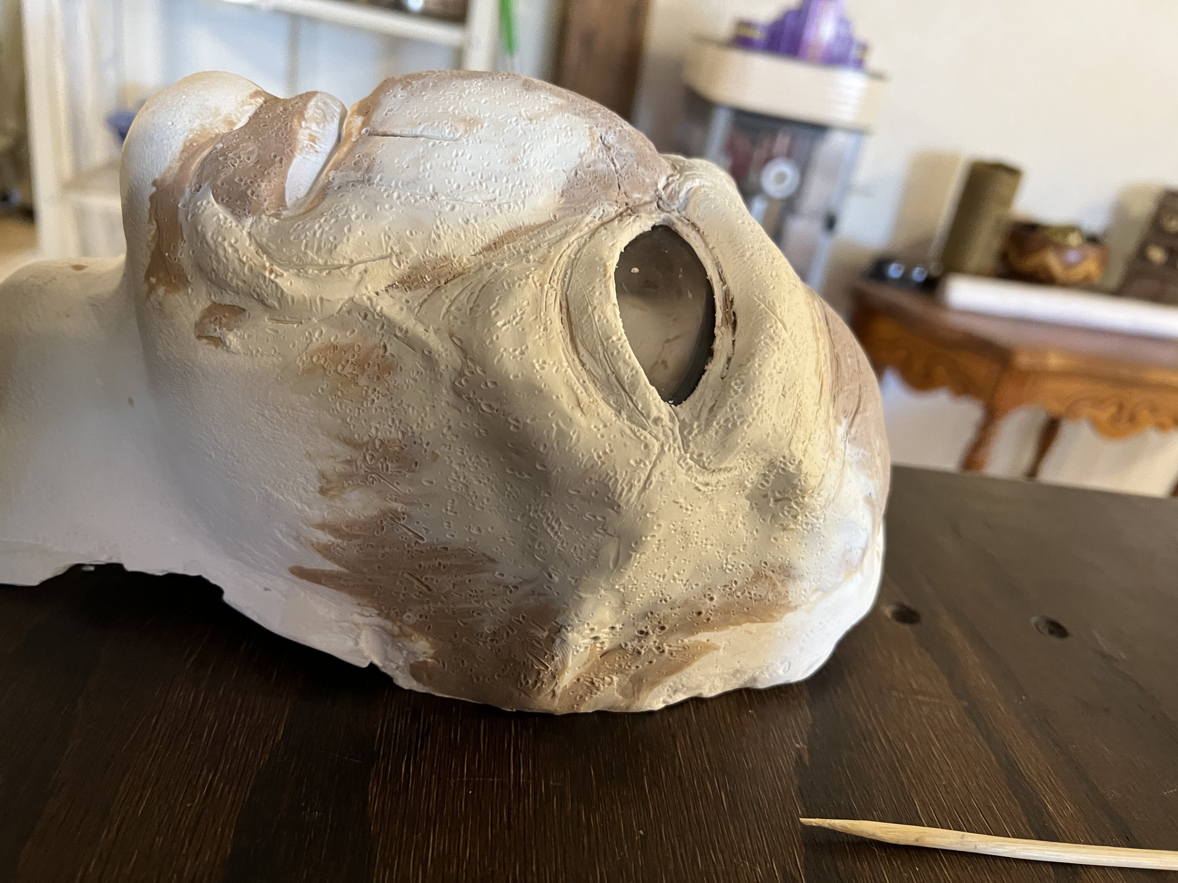

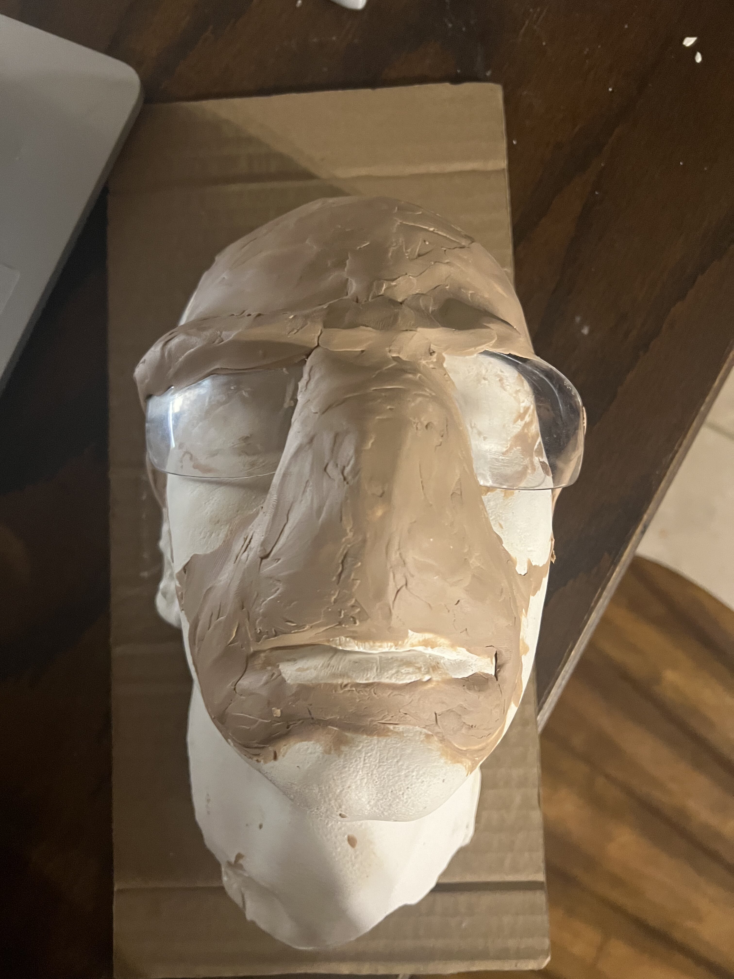

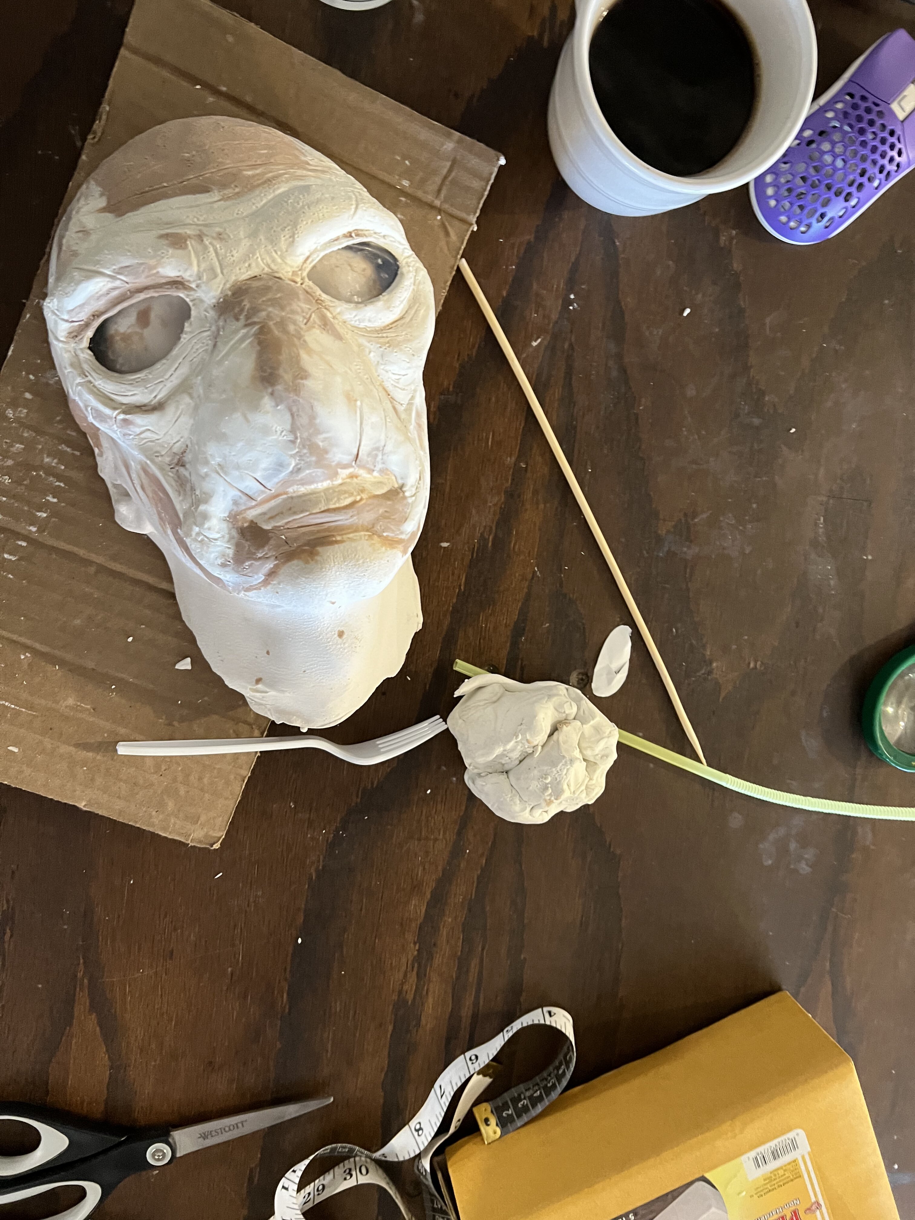

Aaaaaand BAM! I got here and pretty much ready for pore texture.
Here is some. I didn’t have any idea how to do pores, so I grabbed a plastic fork and pretty neat ch played drums until satisfied.
This is pretty much done and I took it to class 2 hours late, but the teacher was quite impressed, ‍. Right before starting the mold I added more pores and tweaked the eyelid shape a bit since I wasn’t 100% ready.
View attachment 1680862View attachment 1680863
View attachment 1680864View attachment 1680865View attachment 1680866View attachment 1680867
View attachment 1680868View attachment 1680915
Aaaaaand BAM! I got here and pretty much ready for pore texture.View attachment 1680871Here is some. I didn’t have any idea how to do pores, so I grabbed a plastic fork and pretty neat ch played drums until satisfied.View attachment 1680872View attachment 1680873View attachment 1680874View attachment 1680875
Let me know what you think thus far.
For the pores you can also use a plastic wrap (for food) and a good brush with sturdy hair. Place the plastic on your surface and dab the brush on an area to see how it looks.

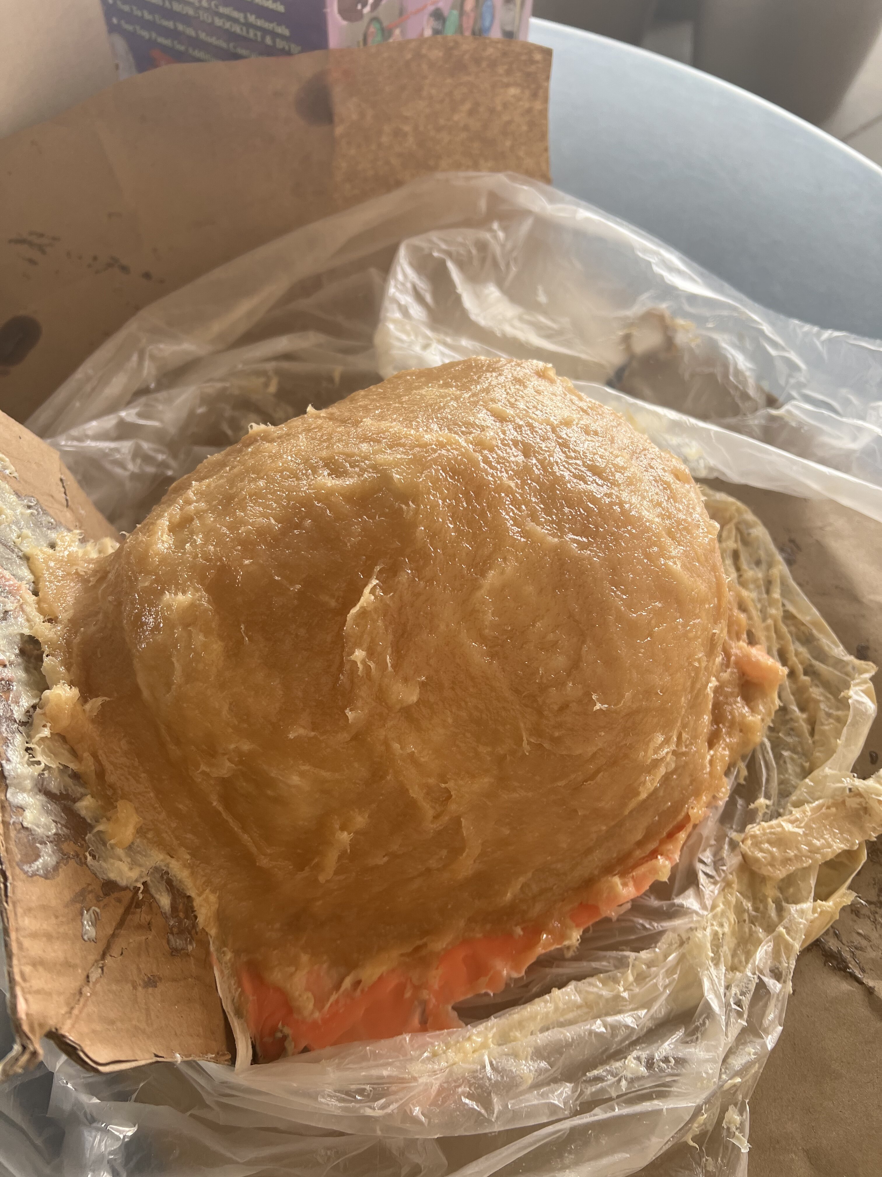

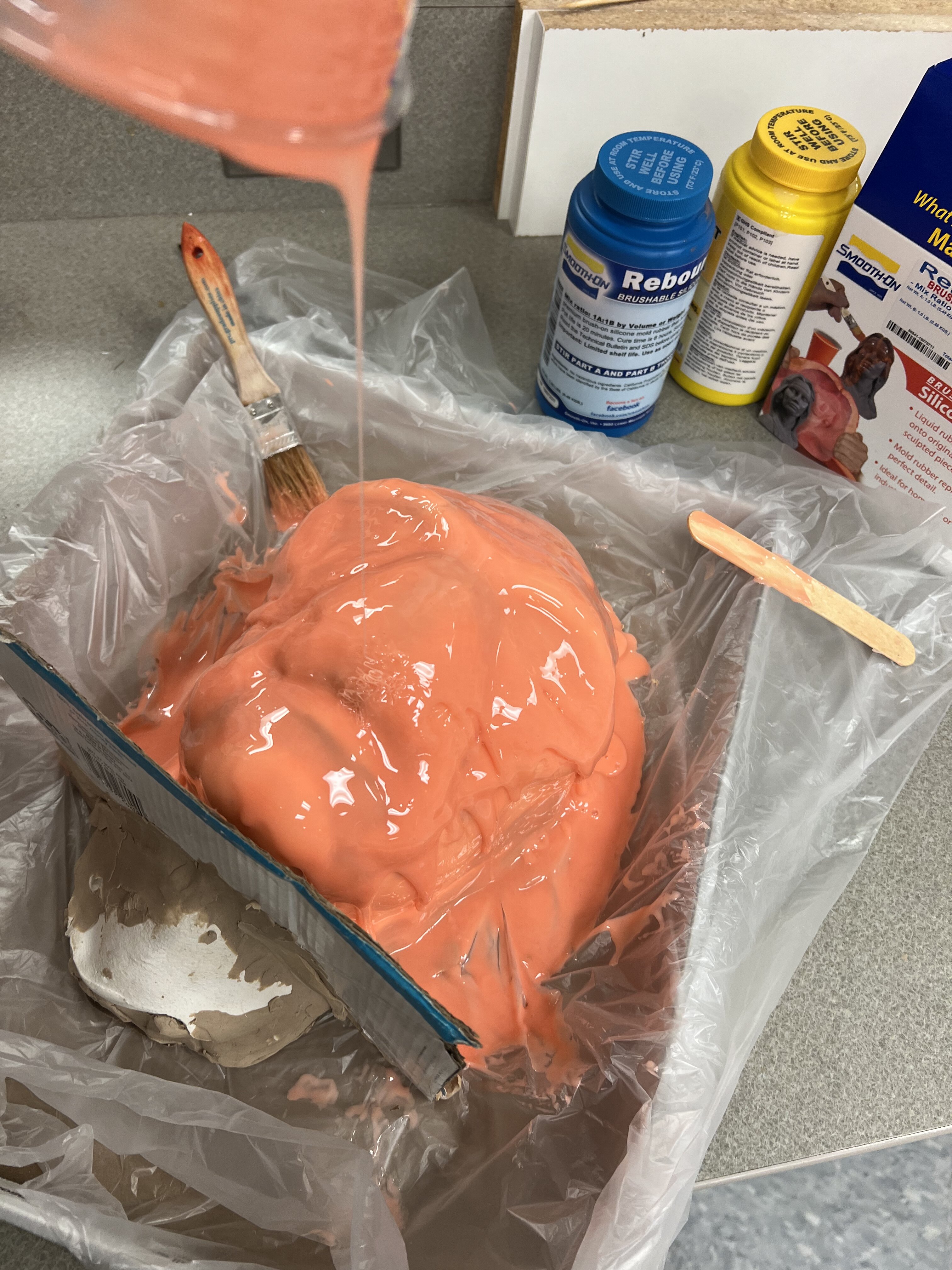

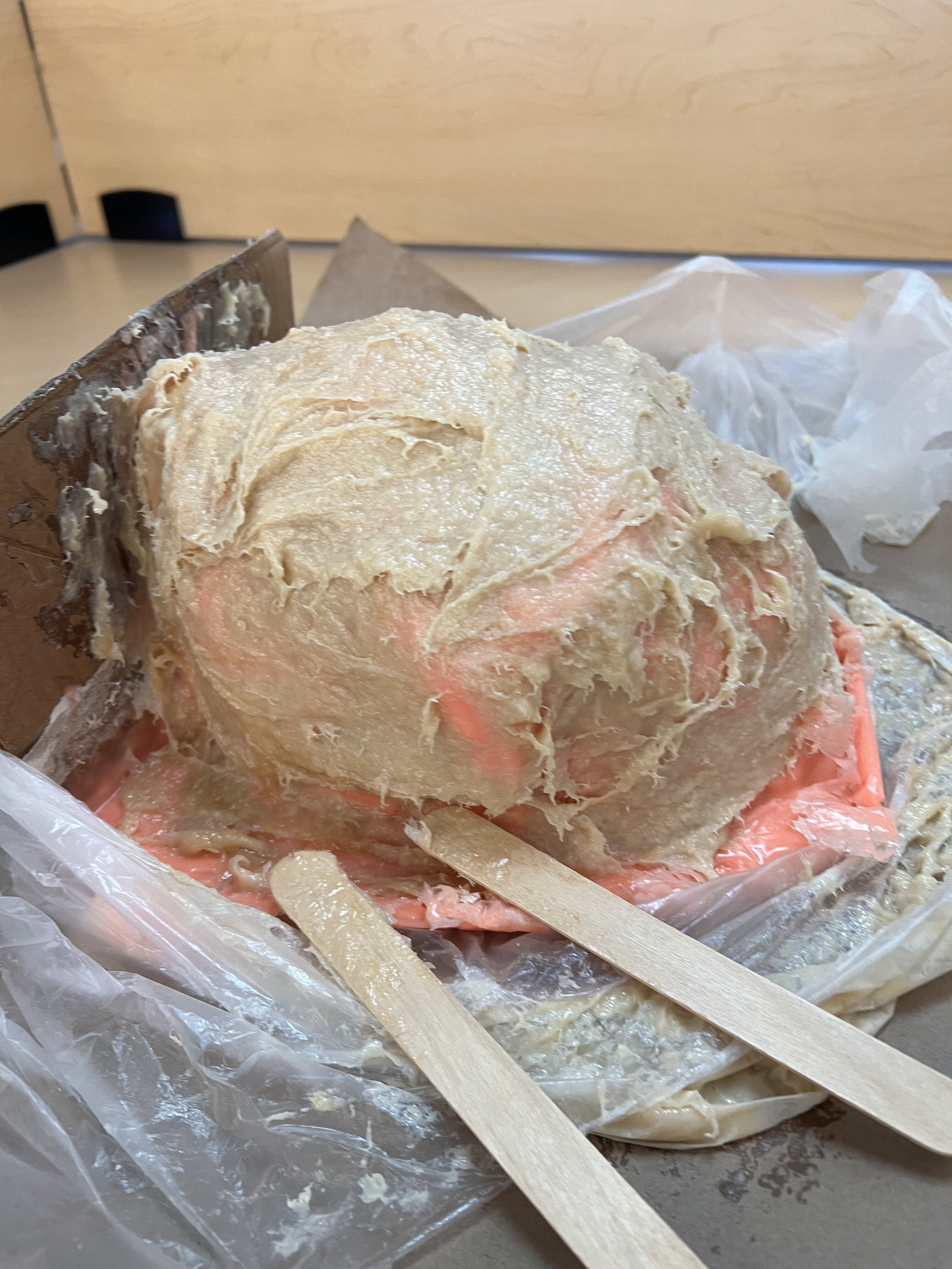

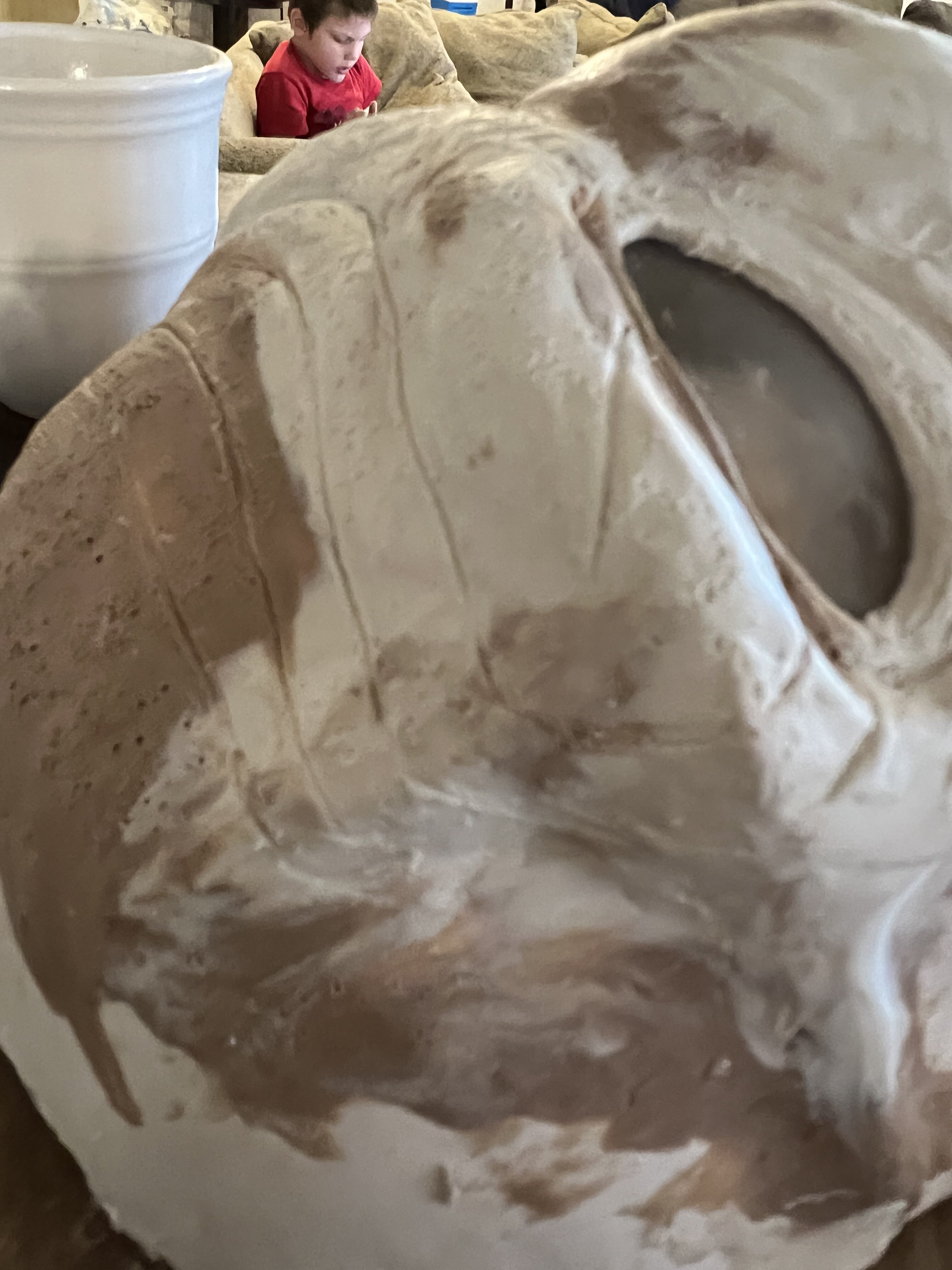

Mold making time. Other students used smooth-cast to do smaller molds for scars and such but me bringing in my full face sculpt really stressed my teacher out, . She got pretty nervous that we might ruin my work in any of the upcoming steps. She recommended that I do a silicone mold. I used Rebound and applied 4-5 layers to make sure the thickness was substantial. I did make my first mistake of not using a mold release, but I got lucky since it is silicone, it didn’t permanently stick to the clay sculpt or plaster cast.
Days later I made a mother mold using Plasti-paste. It’s a epoxy resin with fiber already embedded for strength. This time I did remember mold release…
I used the whole kit for this part also 4-5 layers.

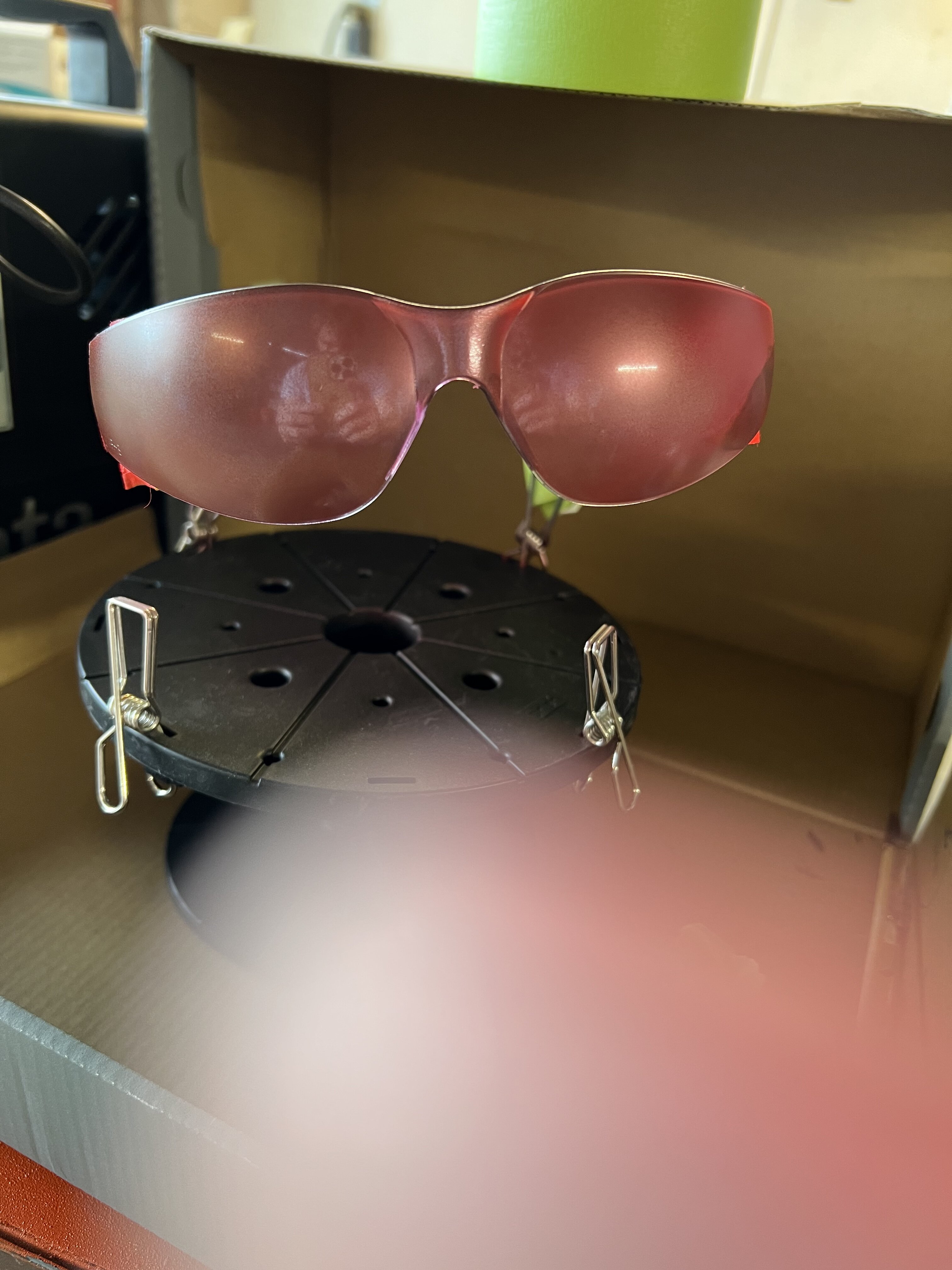

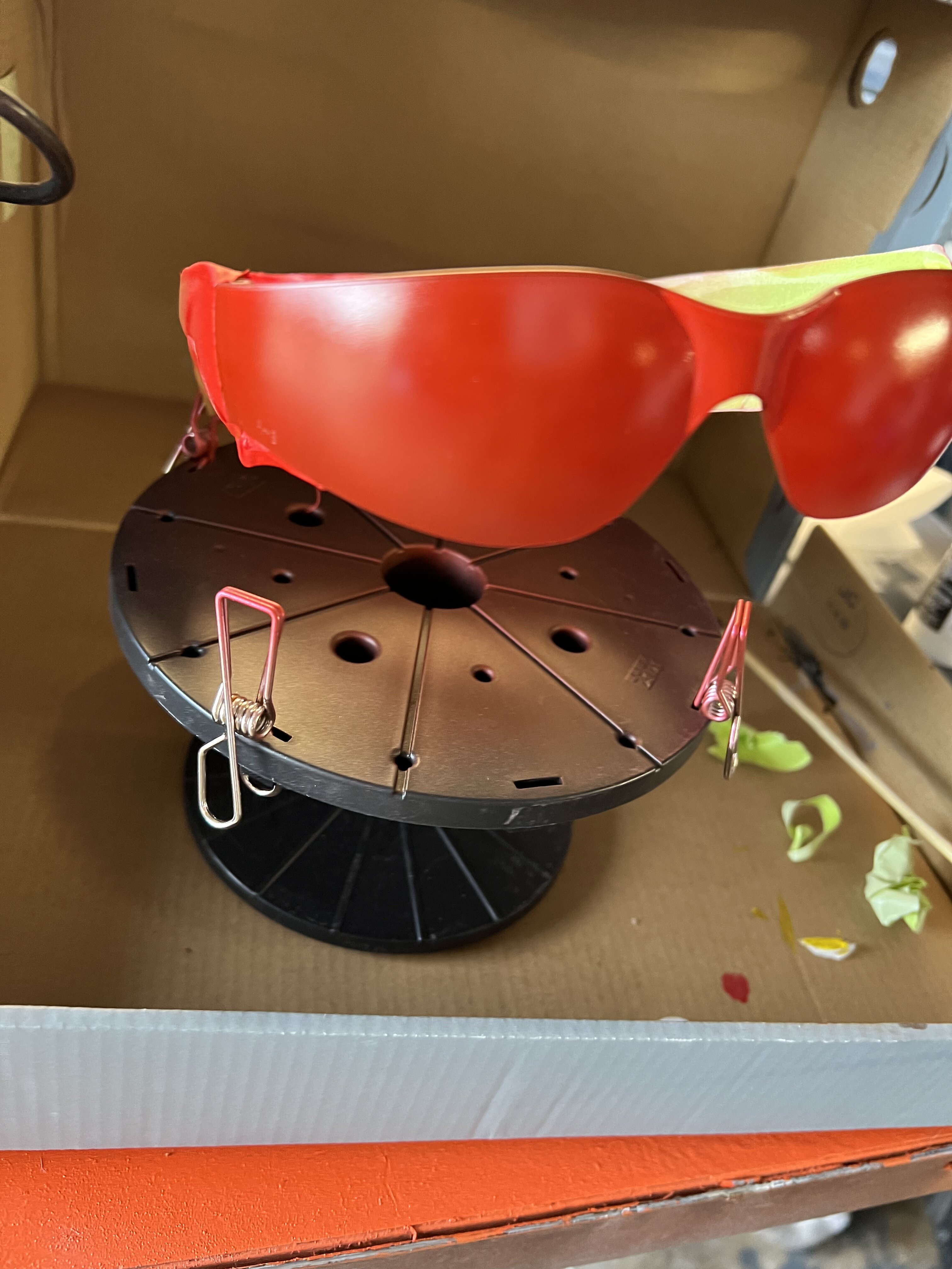

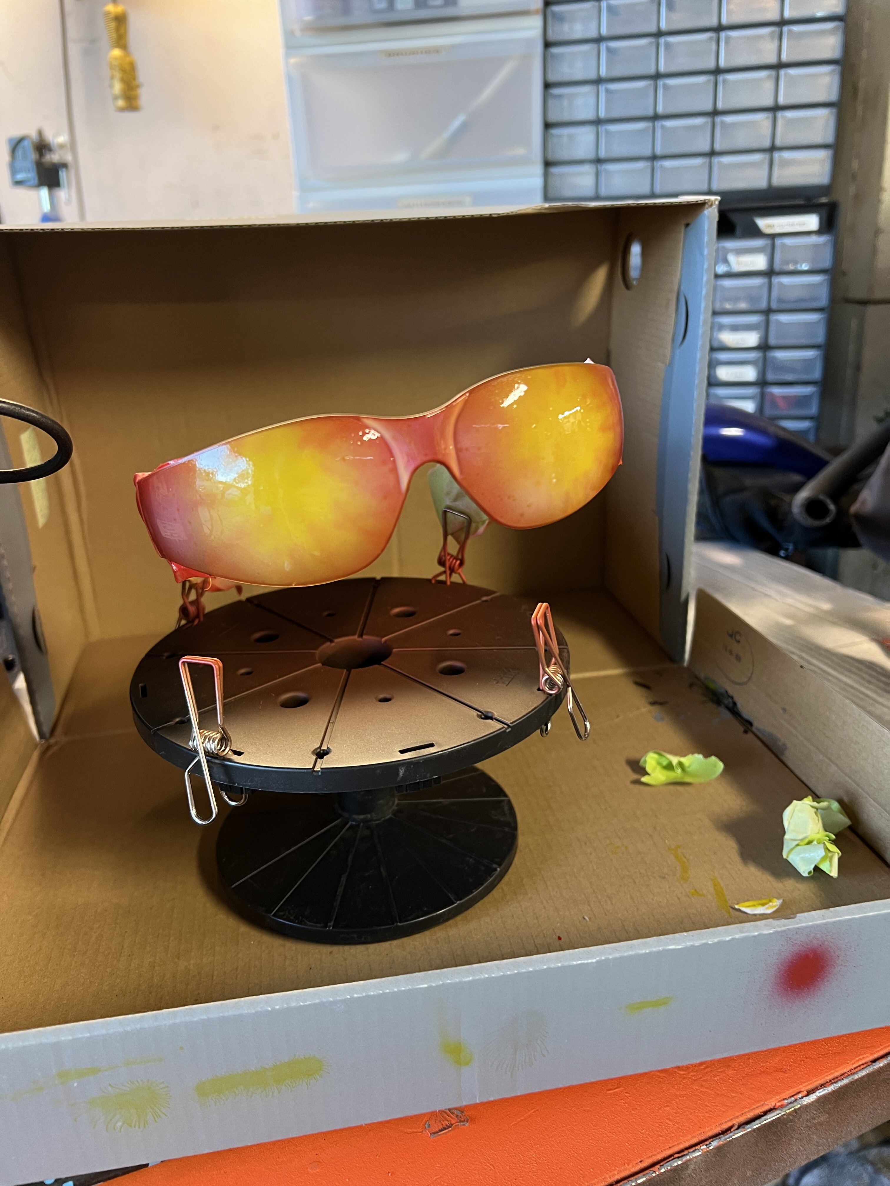

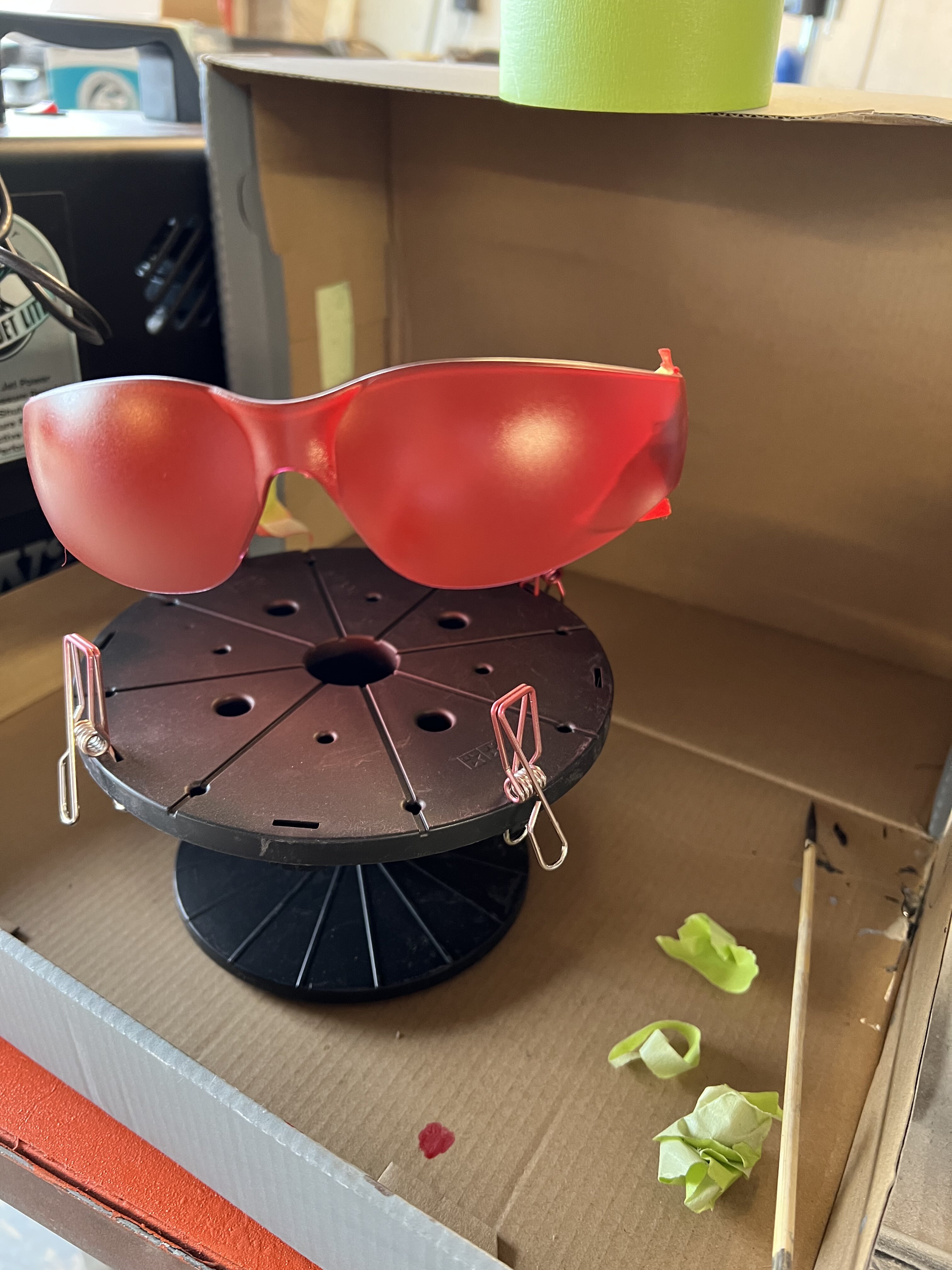

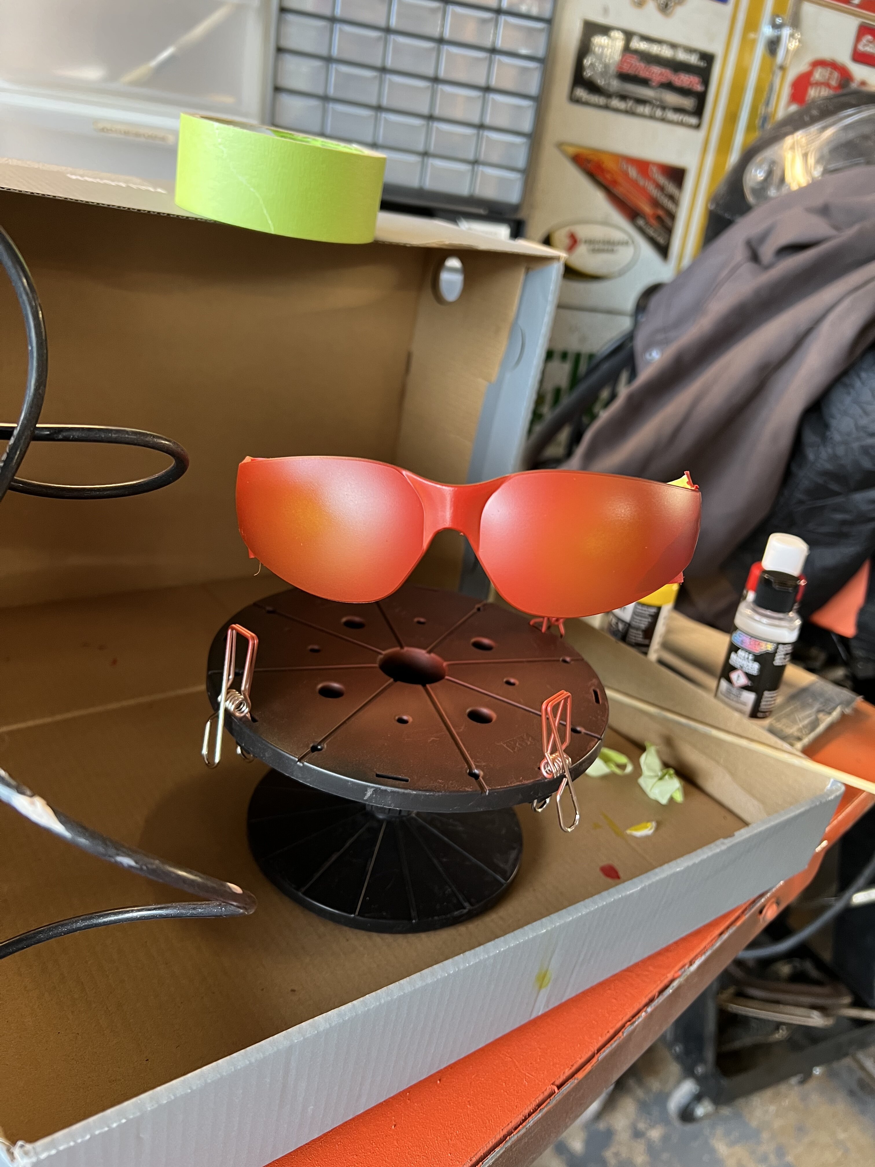

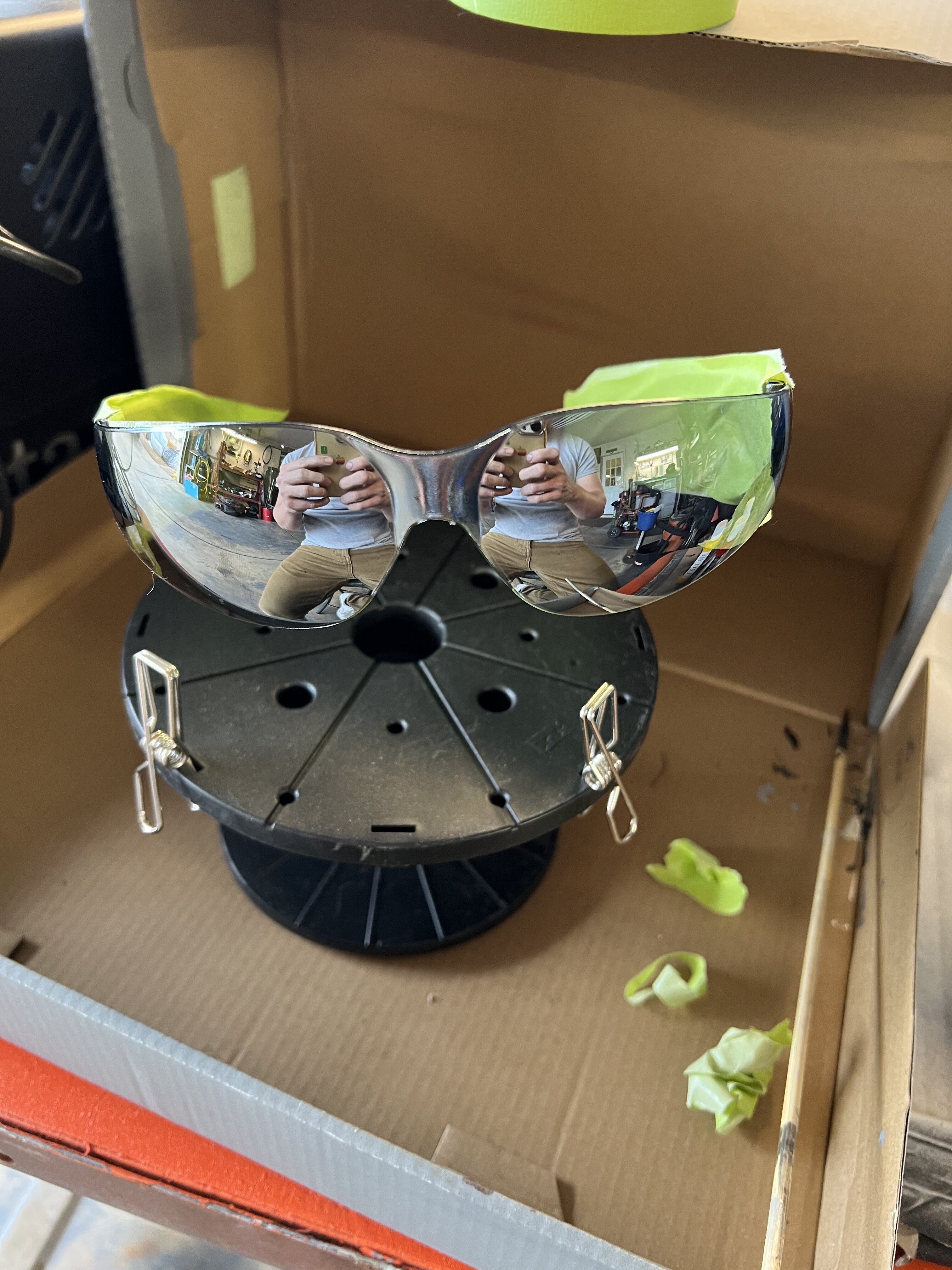

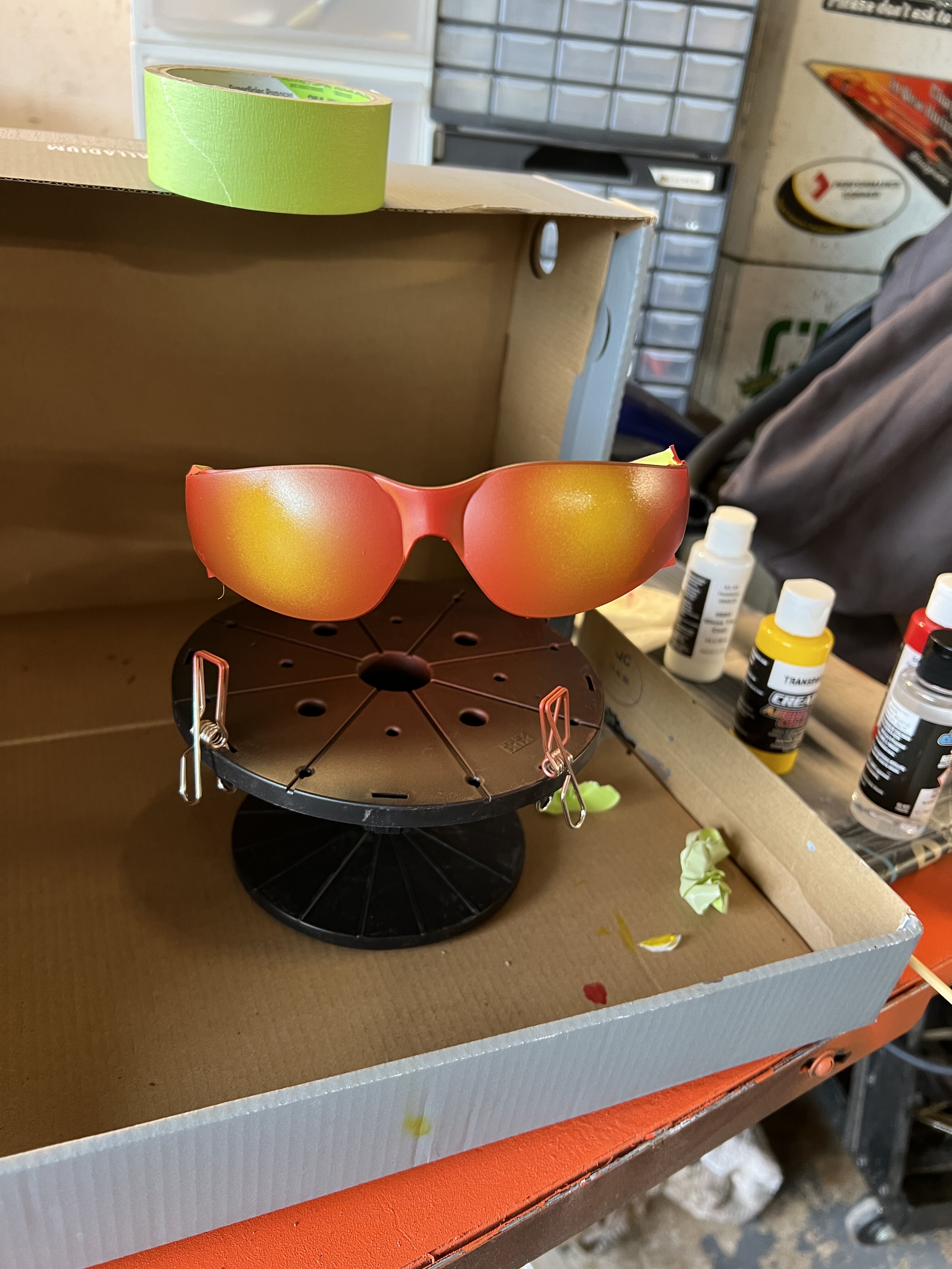

Now onto the new eyes. These safety glasses were super cheap ~$3 so I got some extra but I couldn’t find any that already had red tint.
I set them up for airbrushing with some transparent createx airbrush paint, red and yellow.
Round 1
Yellow round 1
Unfortunately though I think they look pretty spot on, the transparency is not transparent enough to see through them. Might be good for display, but for costuming I’d need another method.

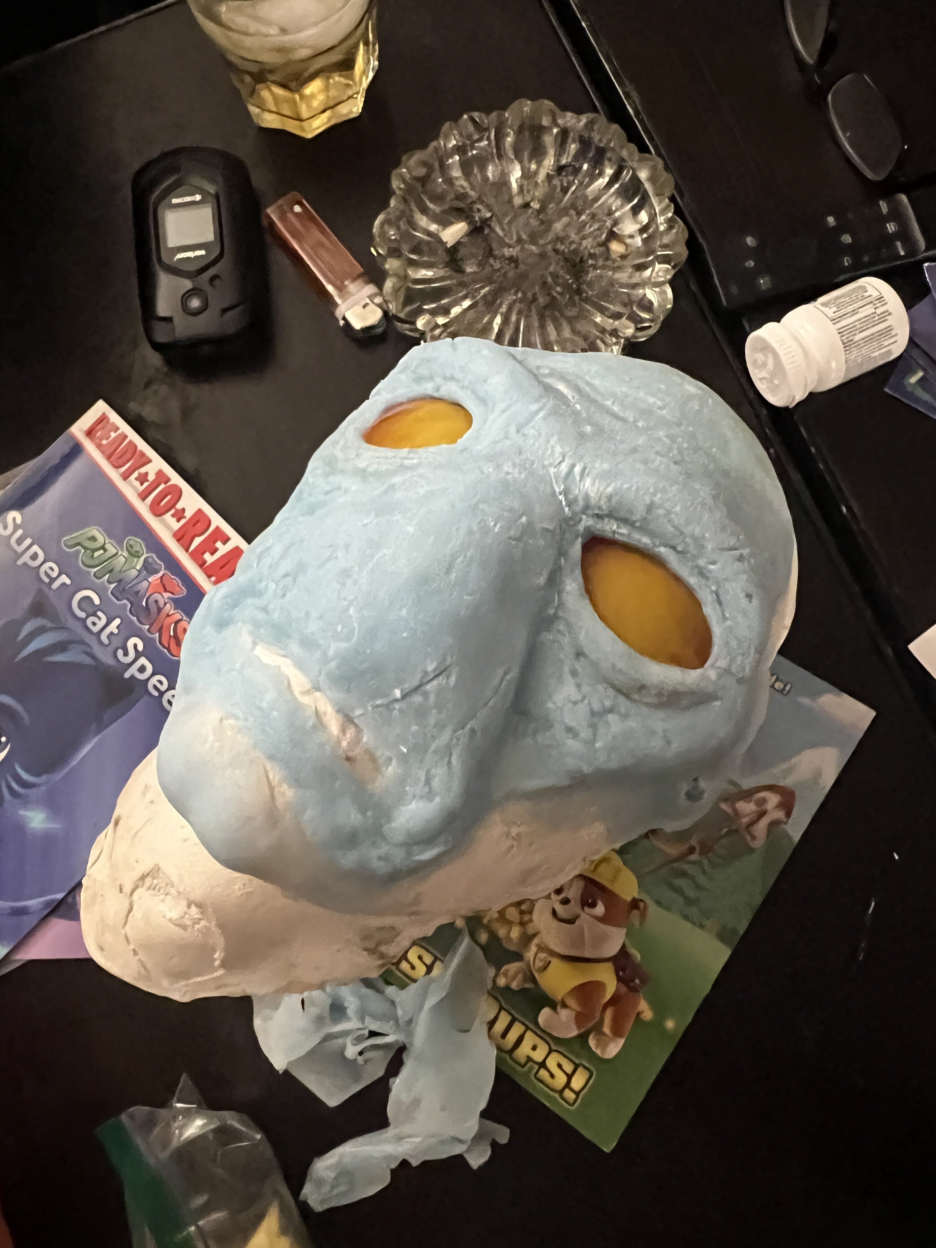

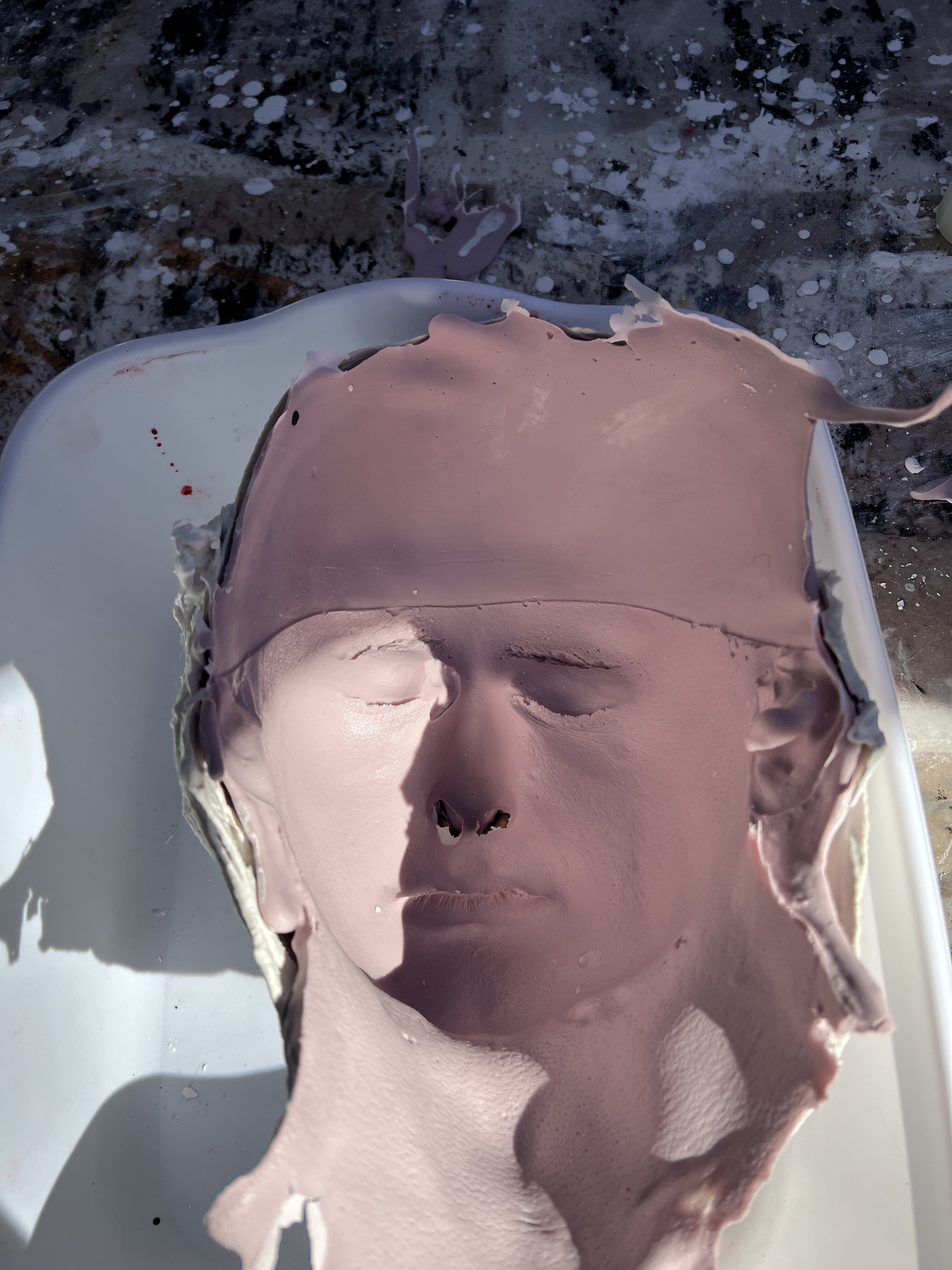

Time to prep for actual prosthetic cast. I put the spare glasses with clay to assisted the release of the prosthetic without locking the glasses and requiring too much cutting out.
Also I got my actor some appropriate teeth. Brand is Dental Distortions model Gaul.
Unfortunately this was when my karma caught up to me. I tried to pull this cast with my teachers help. Mixed the appropriate color in the separate parts and mixed A and B and mixed thoroughly. Poured and started to spread to all edges. About halfway through the pot life of the silicone, my teacher and I looked at each other, NO MOLD RELEASE! We immediately started scraping out the silicone like trying to remove icing from a cake. Unfortunately many bits of the silicone had set up and was permanently fused to the mold. Tears were shed and I decided to just go ahead and try to pull some prosthetics from the damaged mold. It will just to be an older more battle damaged Cad Bane.
Not too bad right*bawling*
Even though I thought the eyes were pretty good, they obviously have far too much yellow and overruns the red.

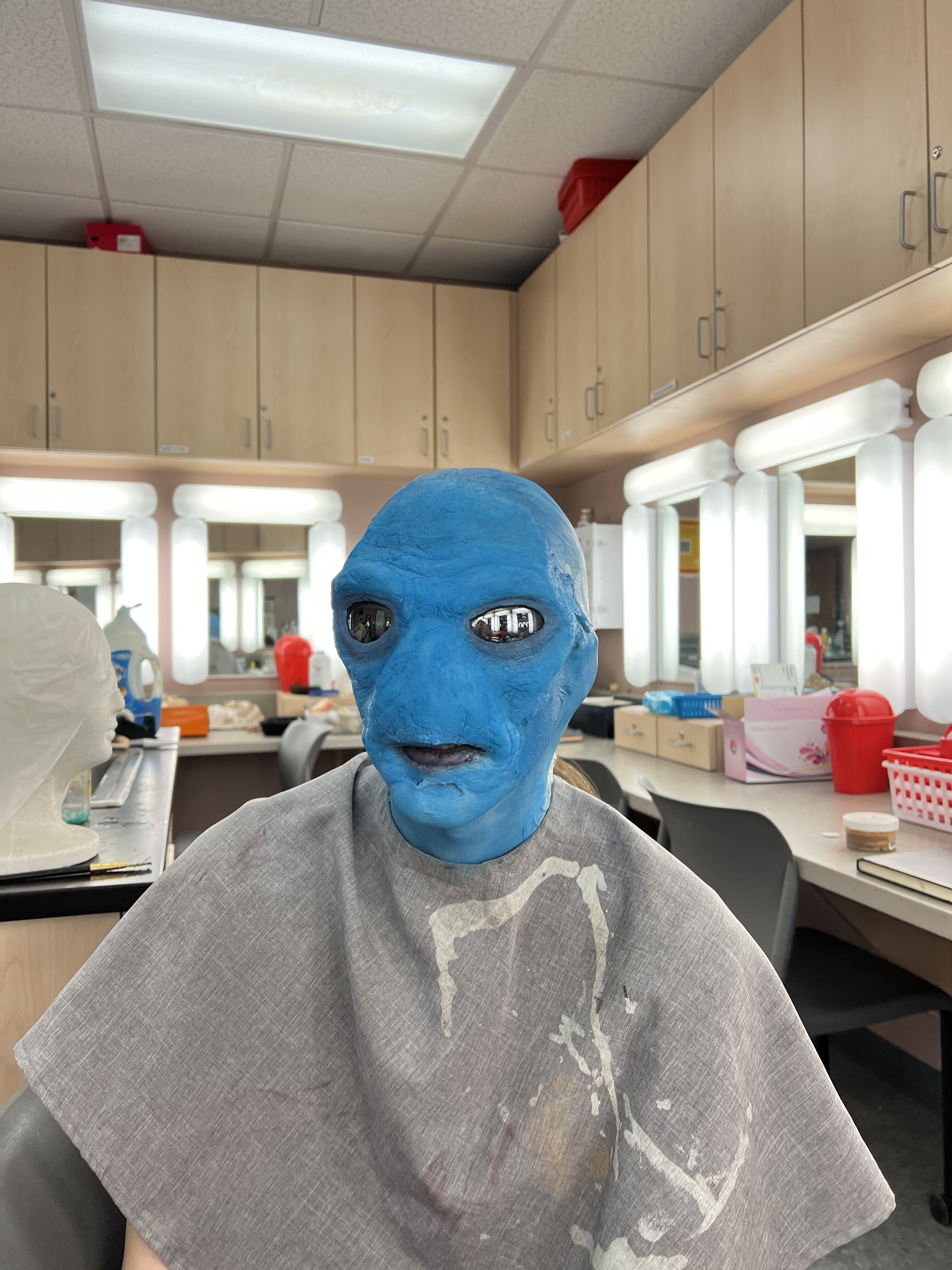

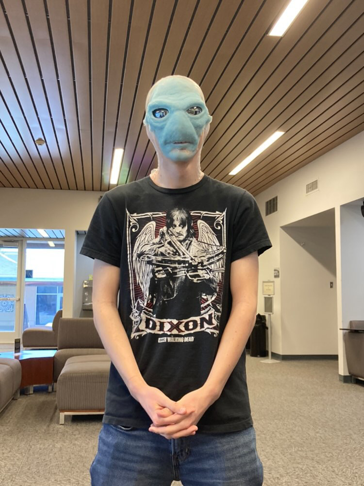

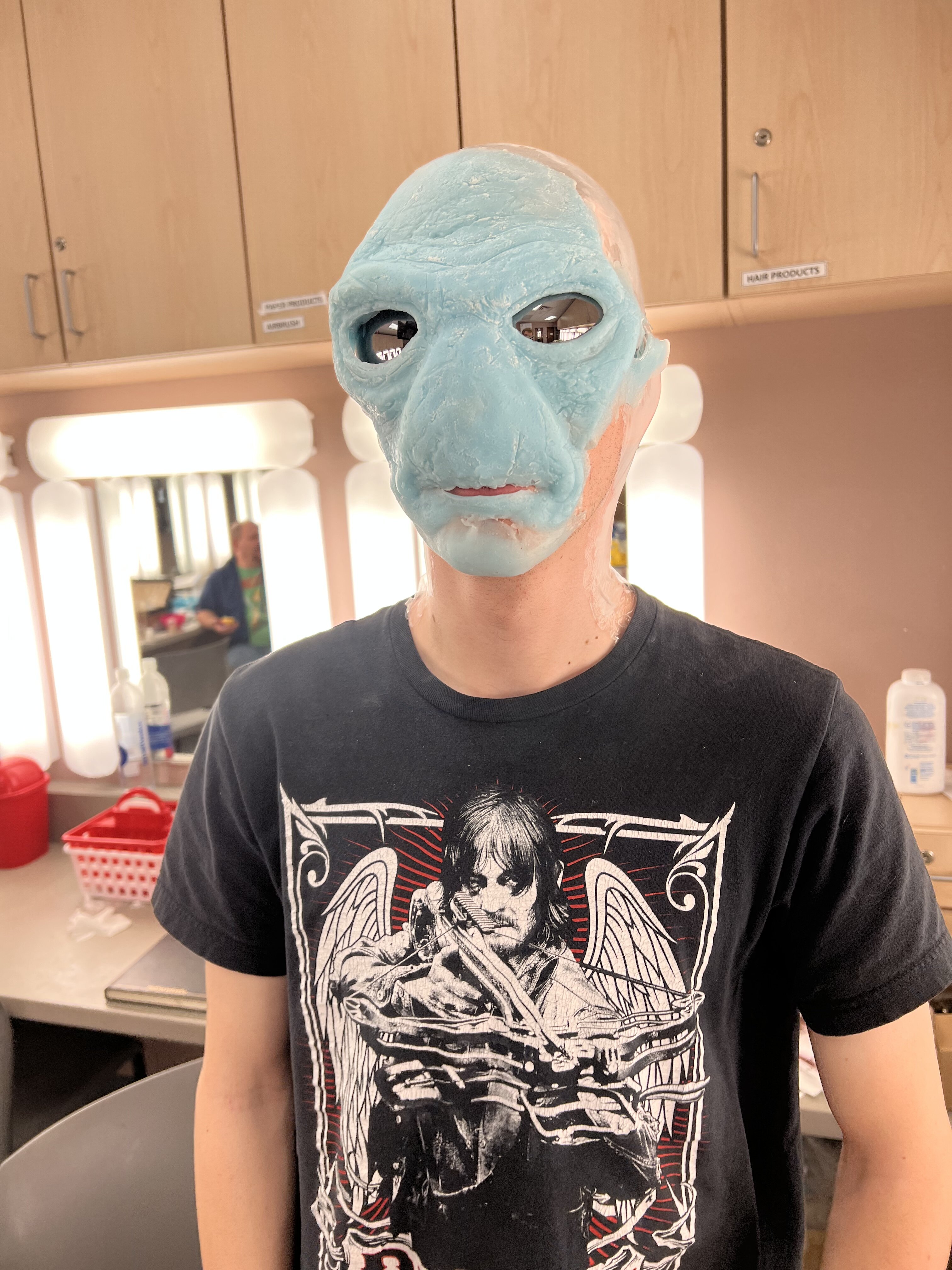

Todays the big day! This is application day and here is my actor all ready to become Cad!

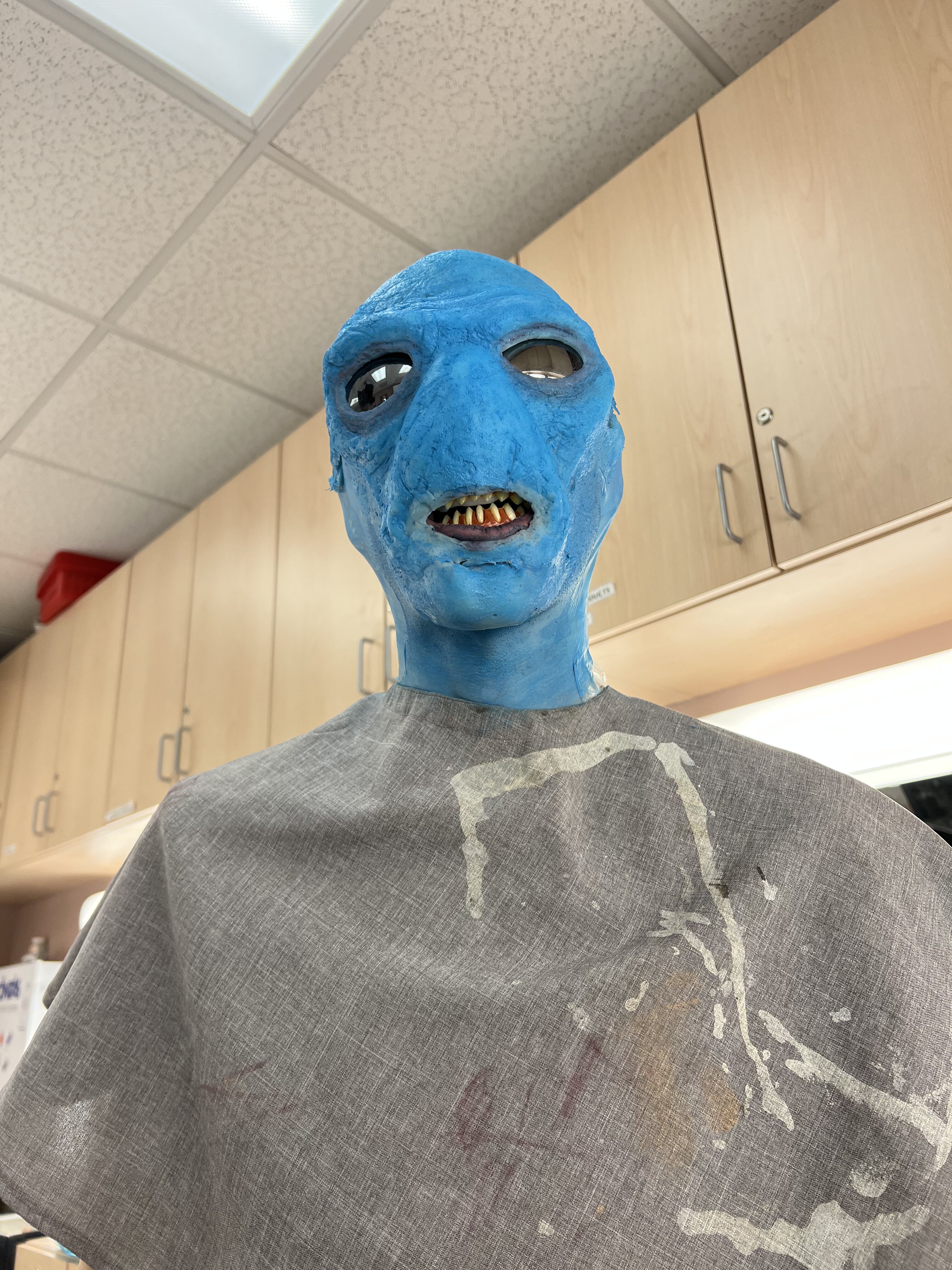

I first applied the Bald cap with Pros-Aide and made sure to cover his ears and install the glasses before installing the prosthetic also with Pros-Aide. I did wish I knew about Skin Tite to adhere the prosthetic and use it to blend the edges better. I found out about it with my Burnt Anakin project and it helped tremendously.
After airbrushing some blue. You can definitely tell that without the skin tite, the chin does not want to adhere very well.
Peep the teeth!
Bet you didn't know Cad could dance this well!
