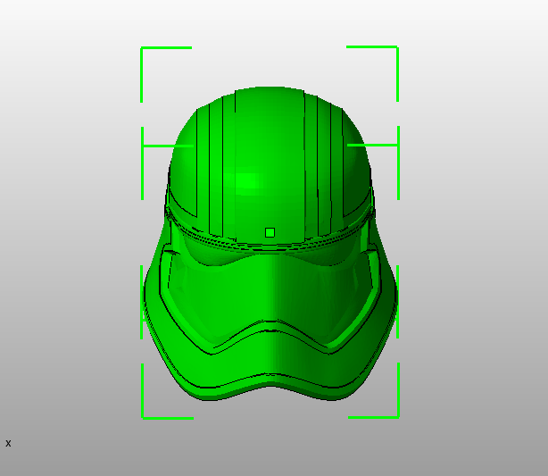

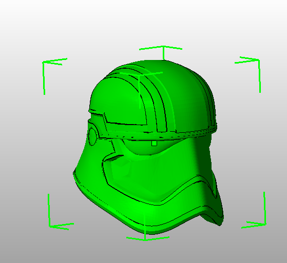

I haven't been big on building any Star Wars weapons or costumes in the past do to the overwhelming amount of great builders already working the **** out of that subject matter. However after seeing the new Star Wars trailer 4 days ago I figured I'd put together this chrometrooper character that briefly showed up.
I commissioned Jacob Morin one of my lead modelers over at Stony Props to see what he could come up with for a model based on the 1second glance we had on video.
He threw this together for me in record time. The model is now sliced up and on the printer. Sculpting over should begin in the next day or 2.
Some of the components are not being shown on this version of the model, but they are completed and in production.

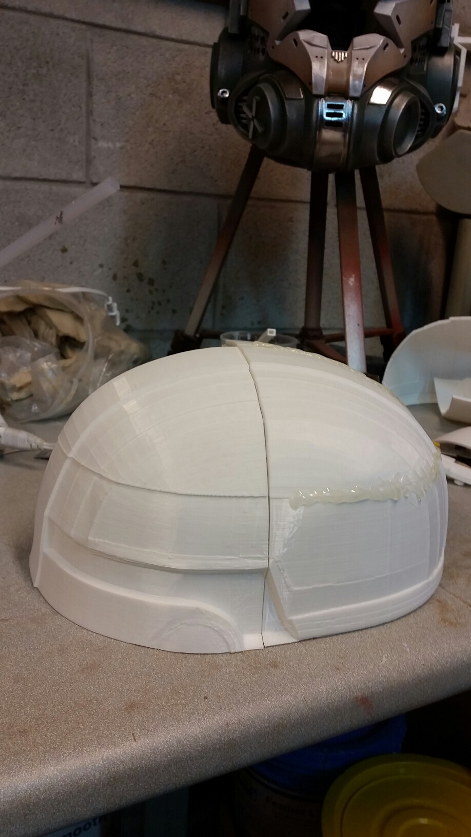

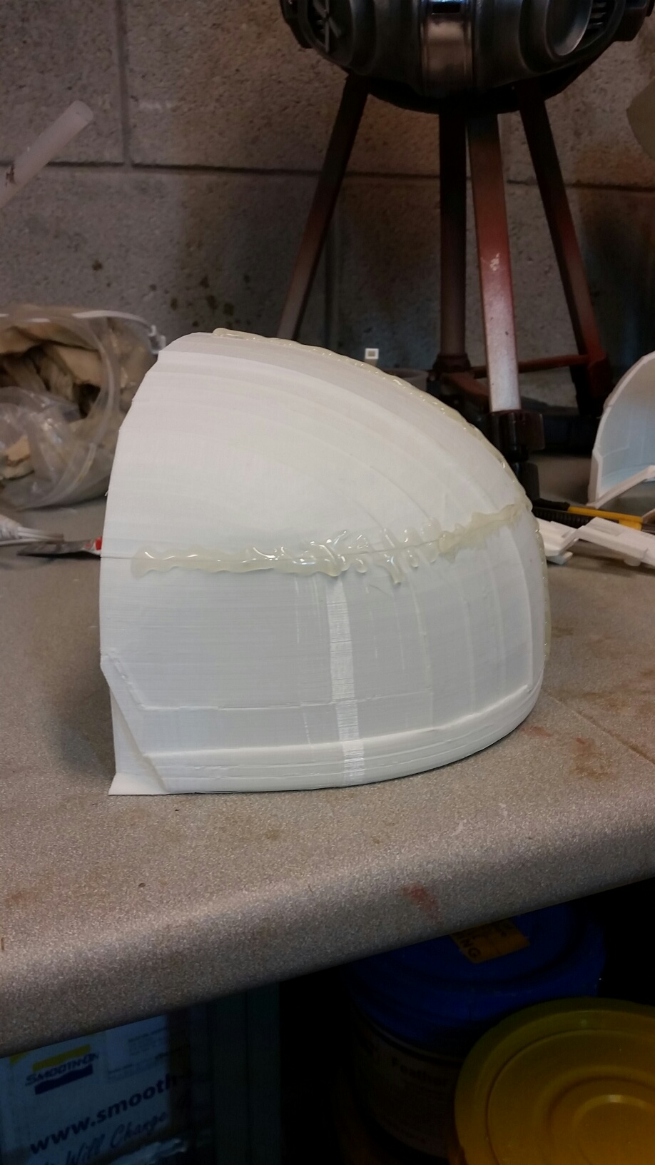

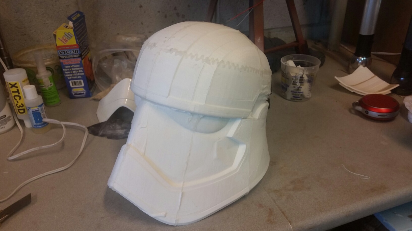

Here's a 24 hours later update.
I got home from work today at about 5:30 and the 3D printer just finished up.
The next stage was gluing the parts together and lining up the detail correctly (3D parts off a makerbot rep 2 tend to warp slightly & it's critical to re-alien everything correctly).
Heat guns help straighten things out.

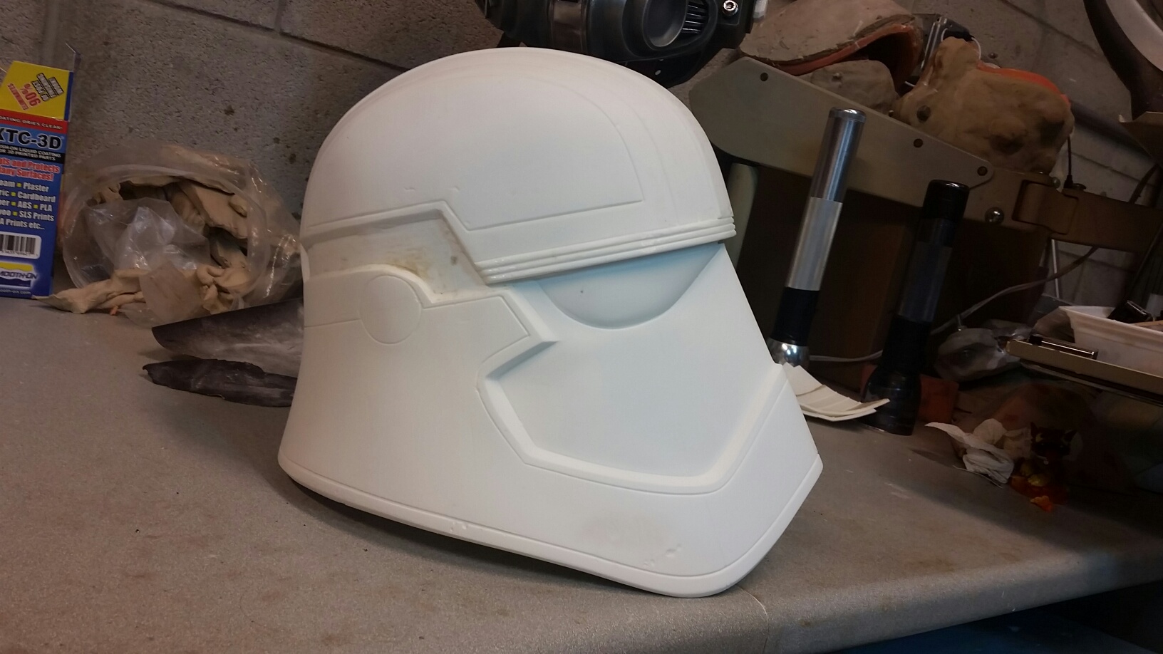

The next 2 hours or so I was able to start the ruff sanding along with re-detailing in some of the basic lines. I was only able to get started on one side for now. I hear the Star Wars guys can be real sticklers on details so I'll do my best to keep this one to being as accurate as I can based on few released images so far.

About 24 to 30 hours run time. It's a low-res print so it went fast. I sculpt over the top of most of the print so it makes no sense for me to print them in a higher resolution.

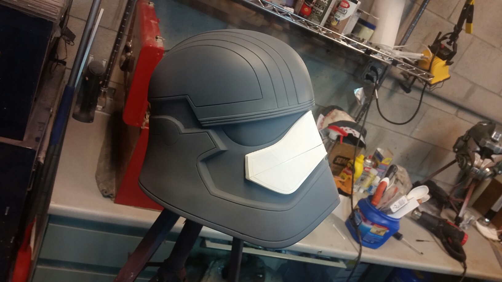

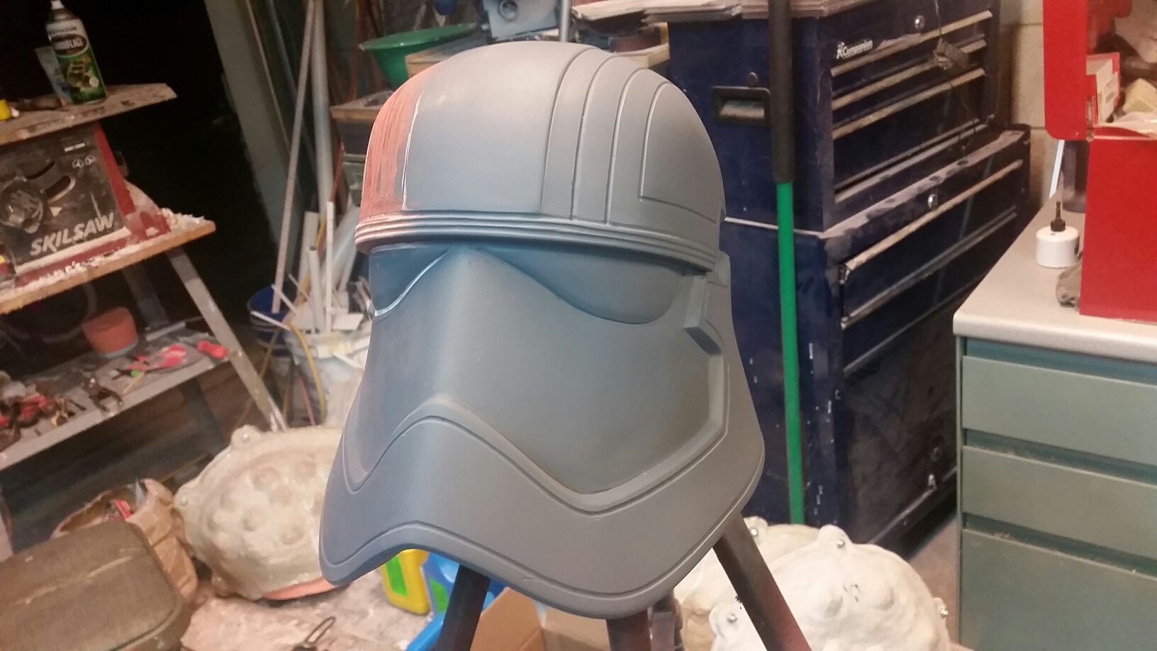

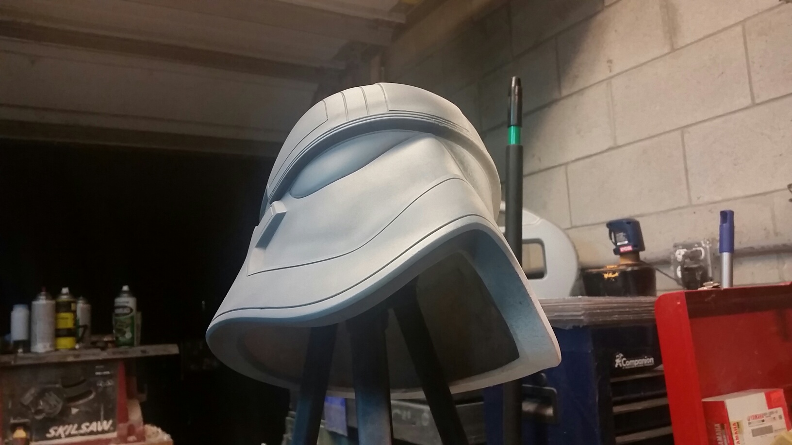

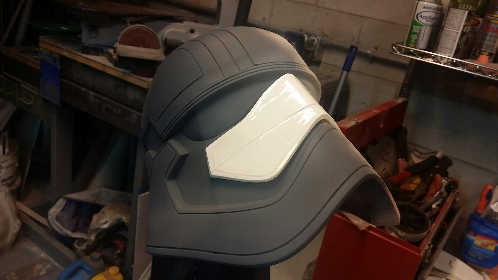

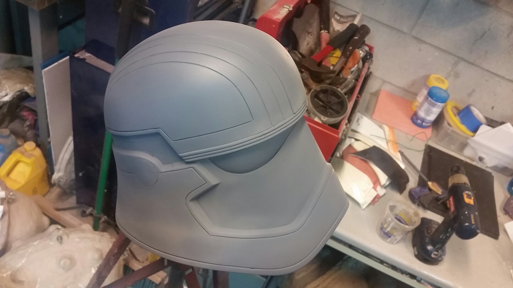

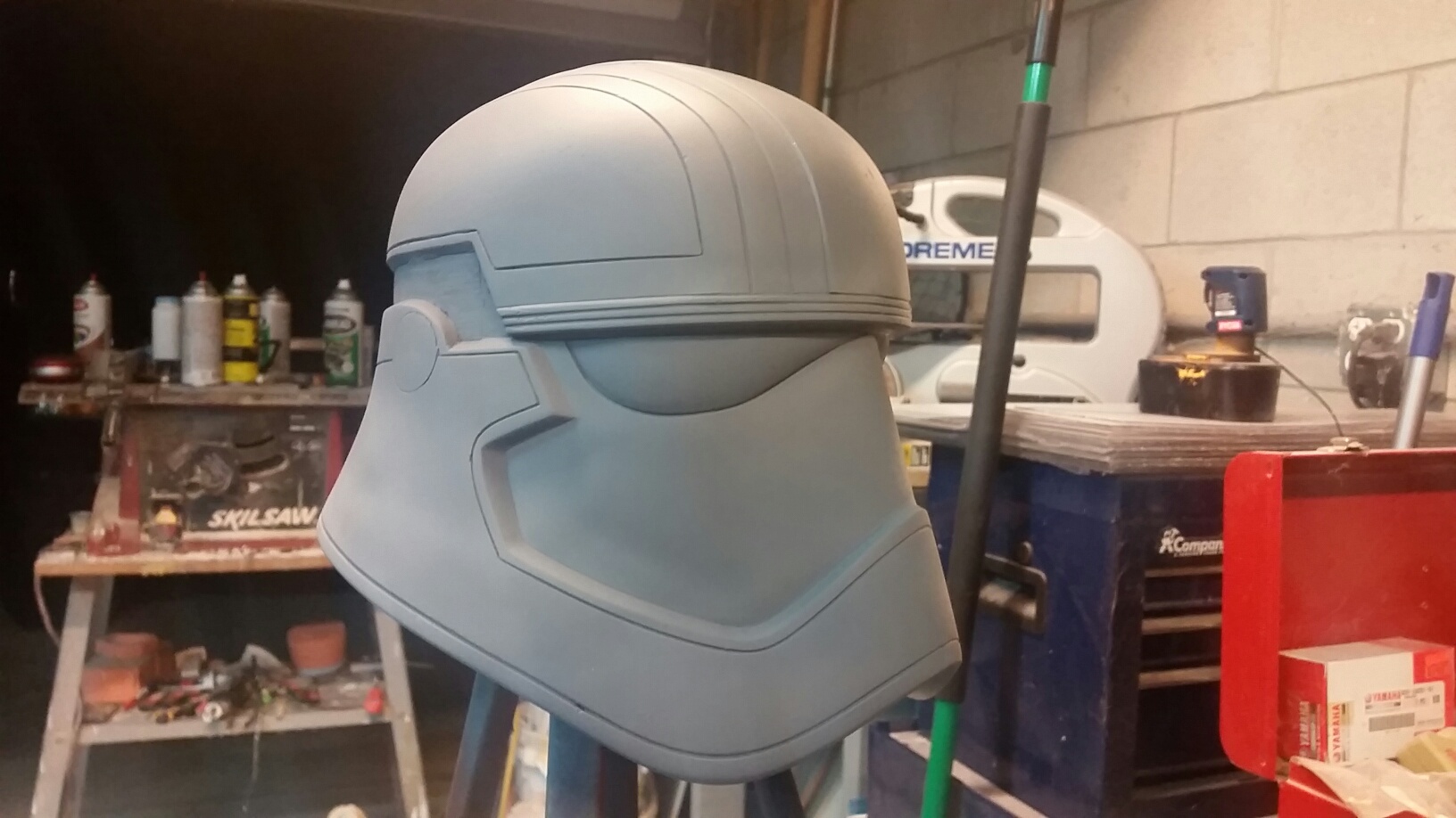

Day 2 on the helmet. Sanding Sanding Sanding..........& more sanding.
The foundation is working itself out slowly but surely. I add primmer on areas periodically to help me identify the bad spots so that they can be re-worked little by little one spot at a time.
The devil will be in the details but without a clean foundation all the finishing in the world wont save the build.
Any constructive criticisms or suggestions are welcome. I'd like this one to turn out great & with your input I may have a shot at getting it right.
Kerr Avon
How are you doing the chrome? Alclad, vac metalizing or actual chroming? Paint would be a pain to do as I can't imagine the amount of scratches that will occur.
AndyJ
A great suggestion that resulted from some other fan-helmets of the EP7 trooper (and as someone who's painted one) is to mold and cast the "duckbill" piece separately. It makes finishing 1000% easier.
Stony Props
My thoughts as well on the duckbill, It's good to hear you suggest that as well it helps me solidify that thought. I'm also thinking the same for the other 2 inserts by the corners of the mouth.

I really thought your first renders were way off...
I thought your printed parts looked off...
But WOW!!! I see what you did there!
After the added sculpting and "duck bill" it really looks great.
that really captures the feel of what we see in the trailer shot.
GREAT work thus far! God only knows what the under chin area and rear area actually look like...
Can we get a front on shot angled like the pics from the trailer?

This looks fantastic so far. A couple of possibly dumb questions... In the attached art, it looks like the lenses are set into a contoured bezel underneath the duck bill, will you be incorporating that? Also what are your thoughts about making the texture pattern around the mouth as part of the master, vs. attached after casting (assuming the goal is to cast this)?
Stony Props
I'Il sculpt out the hex details. The visors will be made to be cut out and I'll make vac formed lenses for it. They should be shaped as pictured.
