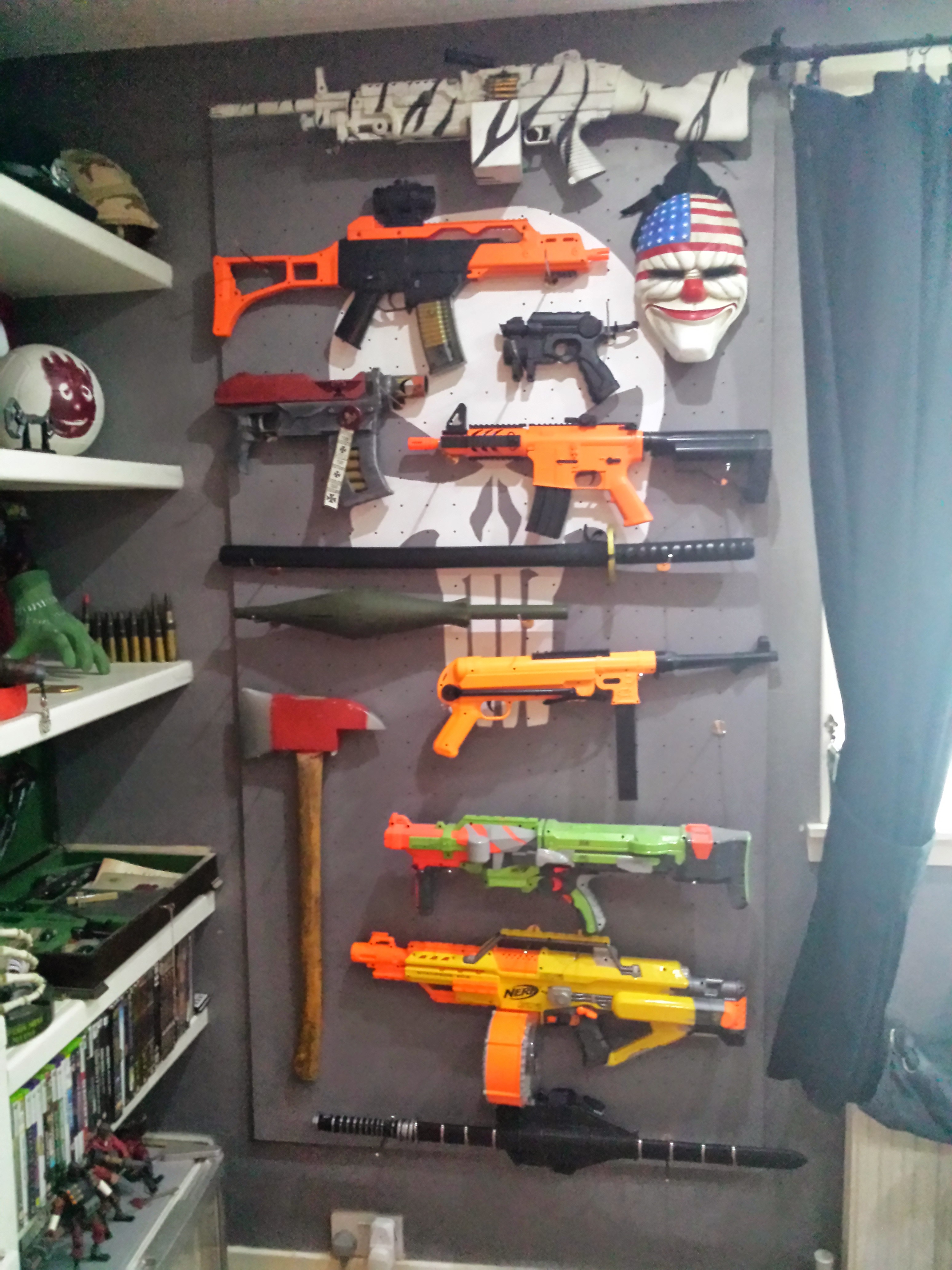

Storage is an ever growing problem in my sons room.
I had a trawl about and pegboard seemed to be a good idea as the pegs are readily available on evilbay.
The pegboard allows a very flexible layout.

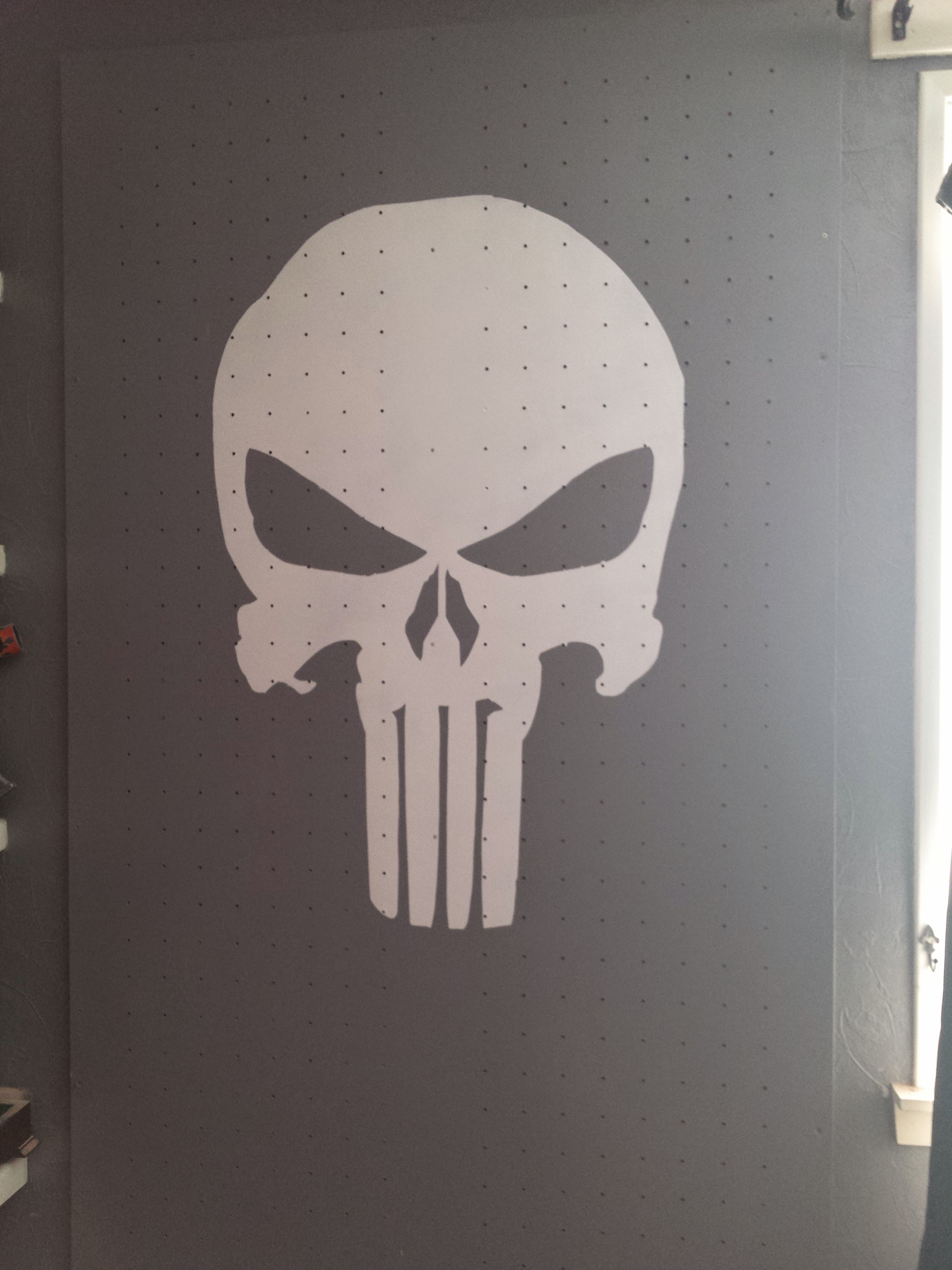

I bought a sheet of 1220 x 2440 which I had cut to 1m x 2m and some planed 12mm x 32mm.
I framed to back outer edge of the hardboard and down the middle for support. I then marked out the wood framing on the front.
The holes were marked out on 50mm centres and drilled. I know you can buy pegboard but sadly there were no local suppliers.
The frame was then fixed to the wall.
The Punisher skull was made from a stencil I enlarged and printed out on A4 paper.
