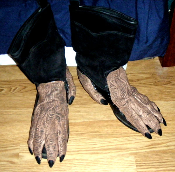

Here's a way to do 'em cheap and quick.
I start with a pair of slip on boots that fit me (or whomever you're building for) and get a set of "Zombie" monster hands. I sourced the set I used at Target during the Halloween season for 6 bucks, the boots I've had forever and wear about once every 4-5 years......so, time to re-purpose them.
First I cut the thumb off the hands keeping the cut smooth and symmetrical so that it can be re-attached to the boot later on. Then I test fit the remaining part of the hand onto the top of the boot and mark under the finger tips where the "toes" (fingertips) will overhang the end of the boot. Just like with the cheap hands I cut out the fingers and keep the ends smooth to minimize the risk of tearing later on (u-grooves not angles). Then to hold the shape of the toes and spread out the hands I cut and stuff craft foam (multiple layers as needed) into them. I then trim off any excess underneath where the fingers attach to the hands and go to town with the glue gun, making sure to glue all the layers of foam to the hands as well as any other layers to make sure it all stays together. Also at this point the fingers need to be glued to each other to form a foot top. Using goop and hot glue to hold in place while the goop sets up, I position the foot top on the boot and glue it down. Next is the former thumb. Also stuffed with foam to hold its shape, it is trimmed and glued in place with goop and hot glue to hold it's position while the goop sets up. As with the hands some latexing will be required to finish them up along with some accent pieces. The tops of the boots will be lined with velcro for the attachment of the lower leg armor (which will also velcro at the top to the legs making the appearance of one continuous piece but allow for easy movement and the ability to take off parts instead of the entire thing). These boots also give me 2 inches of lift.

Continuing with the feet.
I took a piece of craft foam and made a template for the toe dusters. It is approx 2.5 inches wide, square on one end and at a slight angle on the other. When I was happy with the fit, I transferred it onto plastic (once again a homer bucket). I only made one template and just flipped it to make the opposite piece. I cut the parts out, heated the bend location with my heat gun and used some 2 inch wide masking tape to hold the bend. This time of year in most places you can just leave them outside for a while, if you're in a warmer climate put them in the fridge for a few hours. They're held on with tape for fitment purposes in the shot (obviously there's some painting that still needs to happen), the duster spikes are made from some flat sign plastic and glued in place with goop. They are small and triangular to match with other features on the armor as well as minimize the inevitable damage that will happen through normal costume use.

Haven't posted much lately as I've been working like crazy at both a new job and trying to get ready for a run at the Phoenix Comicon. I made it........barely. Here's the finish up on the cheap feet build. After all of the above steps, I latexed the boot, painted it using an airbrush, and then affixed the toe dusters.
